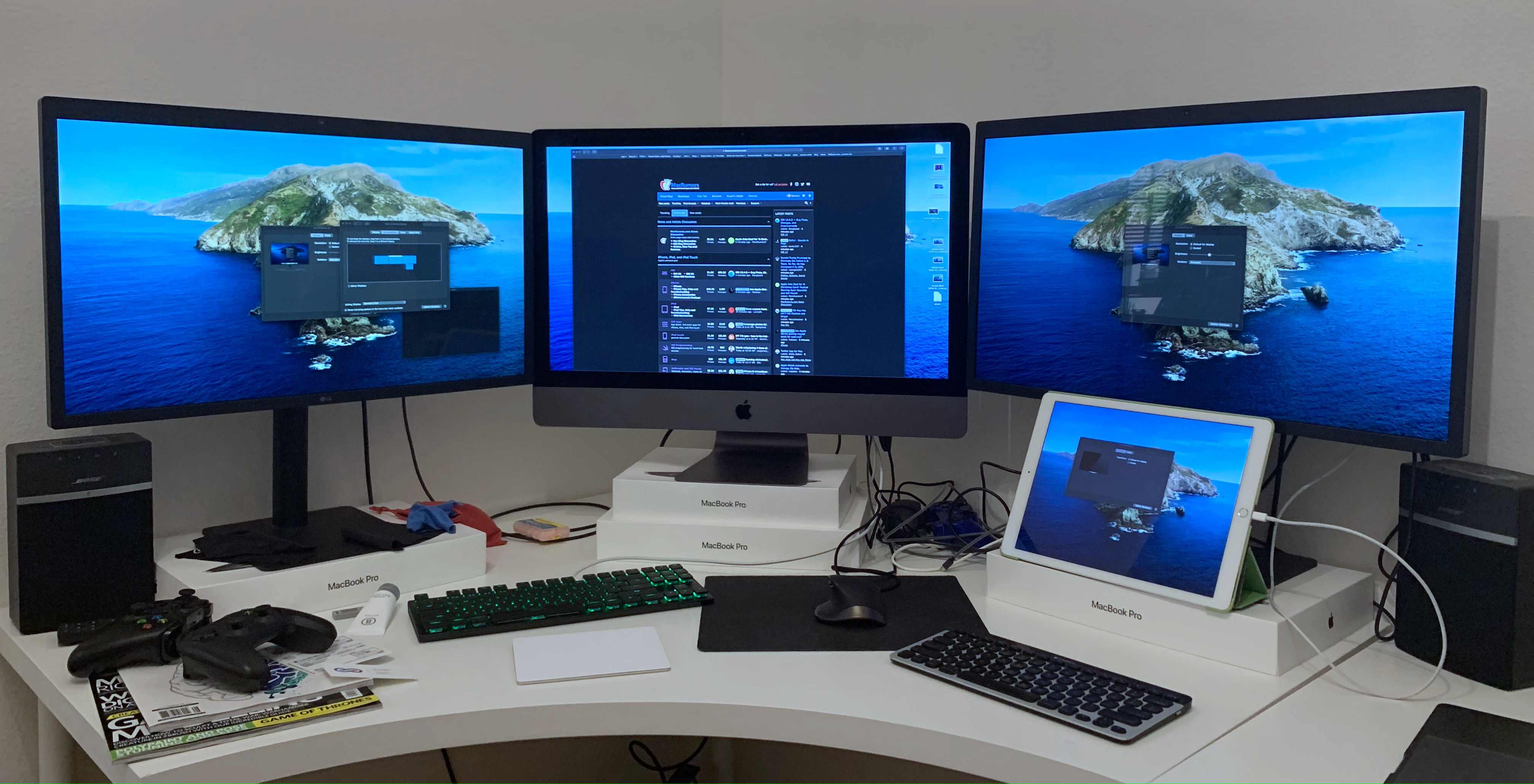

my 2017 iMac Pro can't see my 2015 13" iPad Pro :( They're running iPad OS 13.1.2 and macOS 15.0
It just doesn't show up. I'm logged into my Apple ID on both devices and they're in the same wi-fi. it also doesn't show up when I plug it in USB (although then it shows up in finder).
EDIT: Ok, I rebooted both devices. it works now :) Even though according to Apple the computer supports a max. of 2 external 5k displays (3 total), SideCar doesn't seem to count towards that limitation. Pushing 49831936 pixels now :D
