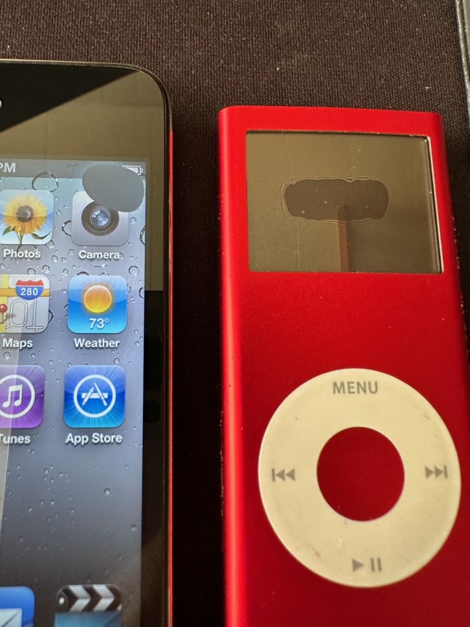

I checkout a few teardown guides of each model. The battery of the iPad touch (4th gen) locates just below where the lower volume button (roughly the second row of apps) is, it this battery or display panel related? On the iPod nano (2nd gen), the battery is underneath the display so I believe it's expanding. Am I correct?

Definitely correct on the Nano, and once the battery has swelled to that extent they're nearly impossible to repair because they can't be opened, at least non-destructively, and you shouldn't try. I'm not sure about the Touch, but a swelling battery is a good guess. iFixit rates battery replacement for the 4th gen as "very difficult." I would just use it until it stops working.

After your reply, I look closely and notice a gap on the top area It is not worth it to mess around a 2006-era product.
