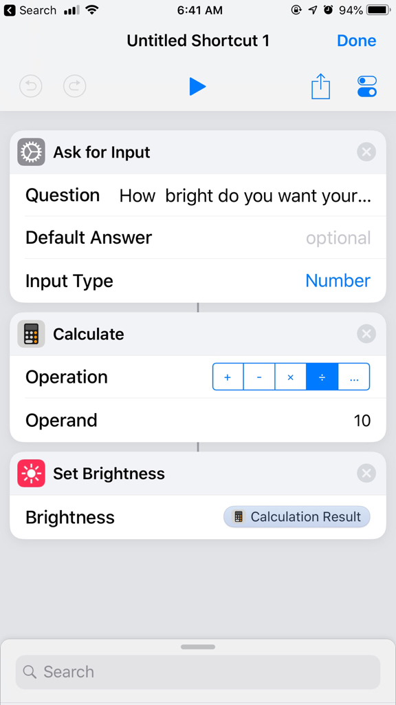

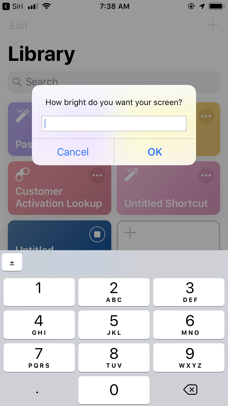

At the time I snapped that original screenshot I was trying to figure out how to use a variable to adjust the brightness control and just wanted to illustrate that there was, in fact, a screen brightness control.
That way didn’t work. But the one below, using a Magic Variable does work. It was not intuitive that you had to tap on the slider to bring up the “insert variable” feature. I added the “divide by 10” action so the desired brightness can be entered as a whole number between 1 and 10 (the slider accepts values between 0 and 1).
Thanks, that’s a lot clearer

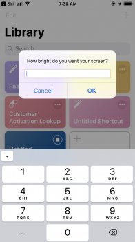

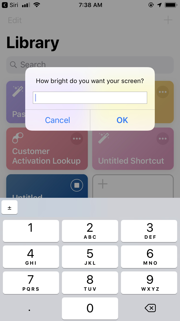

[doublepost=1534937061][/doublepost]One more question actually... what is the UI for the question/input? Especially when invoking from Siri. Thanks
In that case it will open the Shortcuts app and ask you for the input.
Thank you.

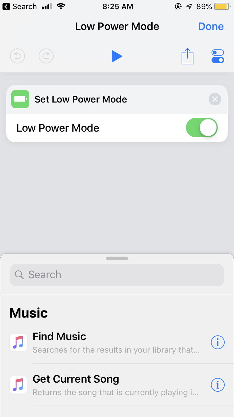

Yes you can 🙂 If I recall correctly, CPG Grey used Shortcuts in conjunction with another app to alert him when he's 'far away' from home to enable low power mode.
Is it possible to start a Radio App on the iPad and airplay to an Airport express with Shortcuts? It is something I do manually each morning.

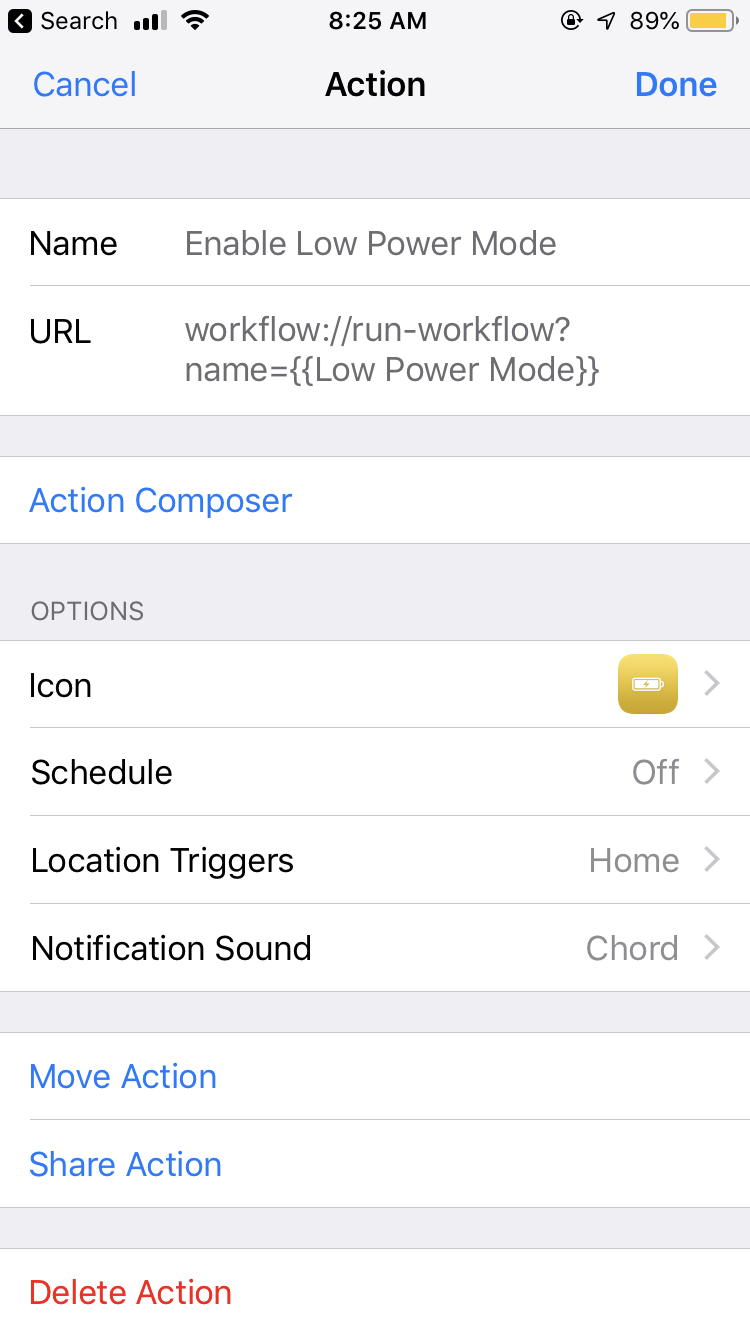

If anyone is interested in doing this you can use Launch Center Pro and the Shortcuts app.
  1. Create an action in Launch Center by tapping the edit icon in the top right-hand corner.
  2. Tap the plus icon on one of the tiles.
  3. Tap 'Action'
  4. The action creation screen will pop up.
  5. Tap Action Composer > Apps with Actions
  6. Search for Workflow, tap Run Workflow. Then enter the Workflow/Shortcut name
Then under options you can have a notification appear based on a schedule or based on your location.
I am using mine to alert me anytime I live home to remind me to enable low power mode. I can see others using it to remind them every weekday at 9:00 a.m for example.

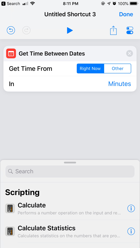

Does Shortcuts have any access to the Stopwatch? Can you start/stop it and/or read its current value?
I think I know why you’re asking.
Not per se. The following *might* be a way to synthesize it. I’ll have to play around with it to see how you can pass input into this function to make it useful for the use case envisioned in the other thread.
EDIT: there might be the kernel of something in this Reddit post: https://amp.reddit.com/r/workflow/comments/36c98r/persistent_variables/
EDIT 2: Yes. Assigning the start time to a reminder does work. You can use that as input for the Date Difference function above.
Reactions: GreyOS
