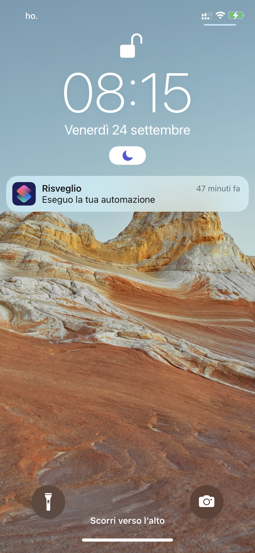

Hi Nicolas, as promised I tried your method and the good news is that it worked!
There is only a minor annoyance with automations: how do I avoid they show a notification telling me they ran the automation?

Unfortunately you can't. This is one of the downside of shortcut. I use it all the time for all kind of automations like this and I'm invade with notifications..
I hope one day I won't have them anymore. But until then..
There is however one "trick" to disactivate them, but it looks more like a bug from apple than something intended. If you do this, the next time you restart your phone, you will get the notifications back until you do this again:
go to "settings"
then "screen time"
then "see all activity"
then scroll down to "notifications",
then tap on "shortcuts" (note: if there isn't an arrow next to the app who allows you to tap it, tap on "devices" on the top right corner and choose another one if you have something else)
then here toggle the "Allow notifications" button
But as I said, this is not intended and more likely a bug. It will turned on again next time you restart your phone.

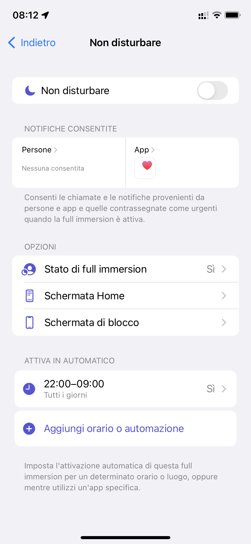

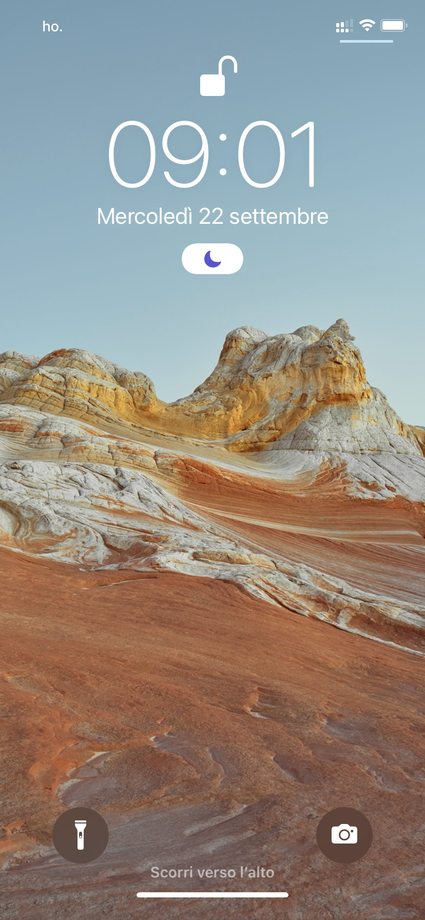

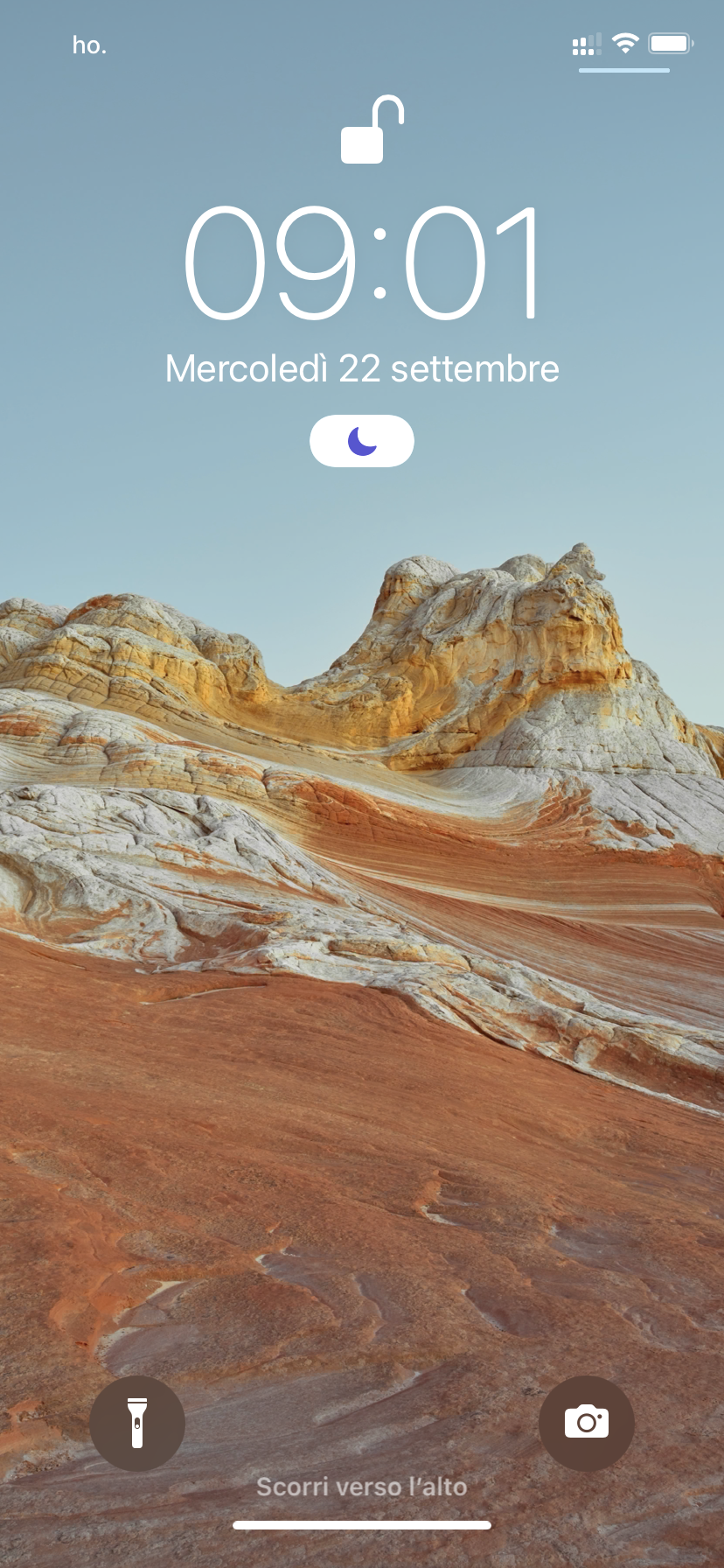

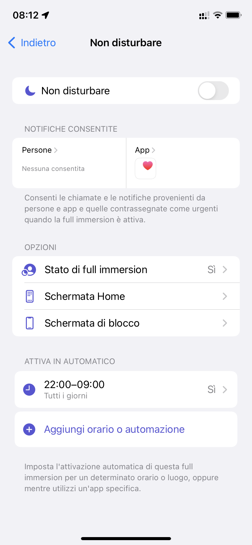

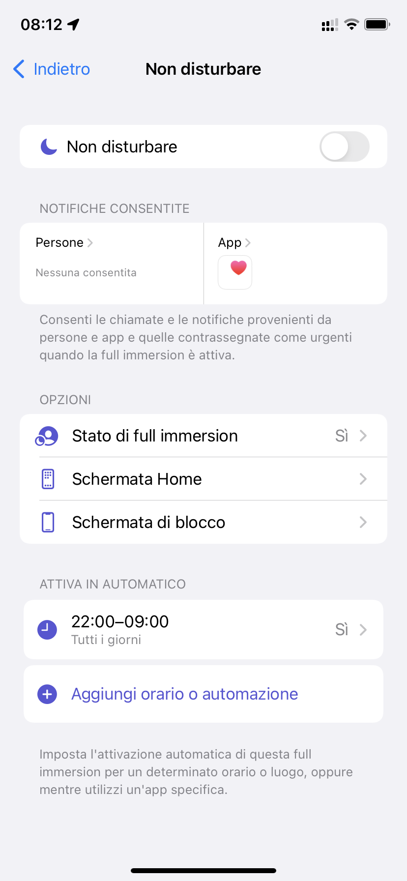

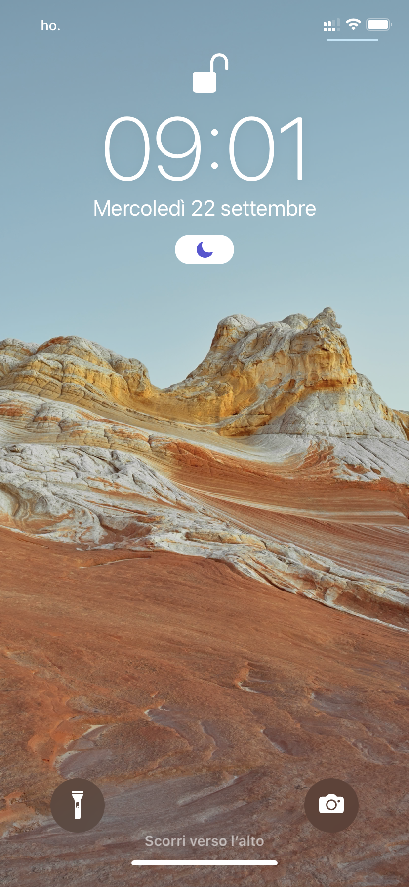

I think they completely broke "Do not disturb" in iOS 15.
Until iOS 14.8 I've always had Bedtime between 00:00 and 7:30 in the morning and DND between 22:00 and 9:00 in the morning. They always worked perfectly.
After upgrading to iOS 15 first of all I had to re-create my DND configuration: I set it between 22:00 and 9:00.
But... it didn't work at all! This morning, after waking up, I realised that around 8:00 in the morning, DND was already OFF.... why?! Well... I put it ON manually and I expect it to go OFF again at 9:00, but..... it doesn't work either!
Essentially I created a schedule for DND but it's being completely ignored.
See the screenshots:
In the left one you can see it's 8:12 and DND is already OFF. In the right one you can see it's 9:01 and it's still ON.
View attachment 1839991View attachment 1839992
