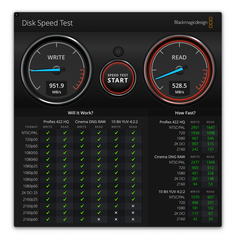

Not related to T7 but to the TB3 device I have posted above. It seems that MacMini with M1 chip do has a problem with TB3 devices behaving very badly. Speed jumping for read and write between 500 and 2100! When I test same device on Macbook Pro i9 zspeed is always at max and never drops! :( Very sad news for me
Here is a screenshot
I received an email from Samsung to say that there was no fault found with my T7 and they were returning it :(
It arrived yesterday and today I tested it (after reformatting in a Windows VM because Mojave Disk utility could not do anything with it)... the write speed is back to 979 MB/Sec :)
