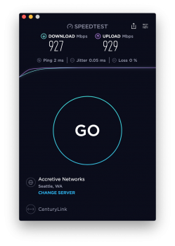

I can't say the speeds on my Mac are quite the same as my Windows PC, but 10.15 did fix it for the "most" part. I see 700Mbit downloads and the usual 900+Mbit upload.

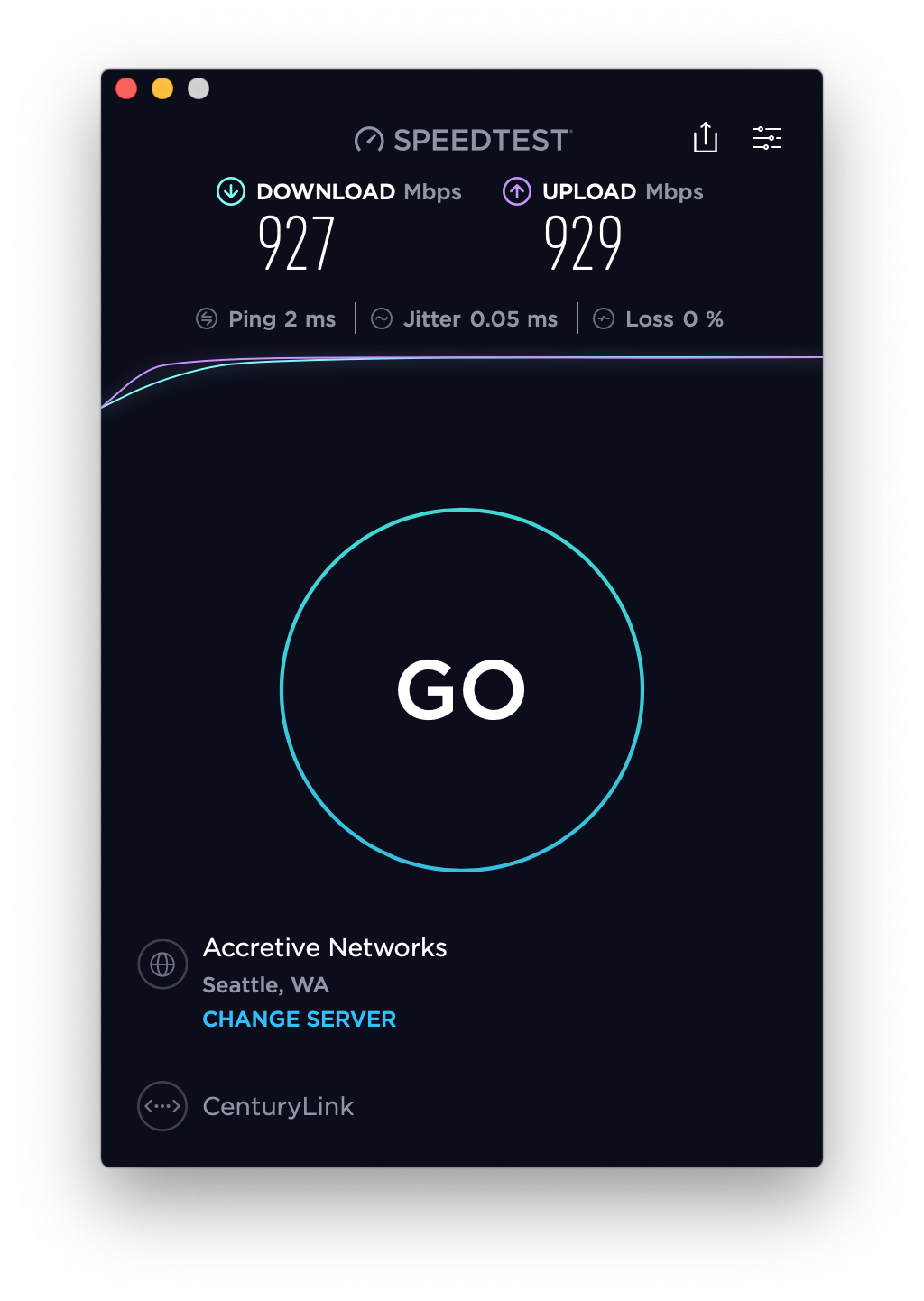

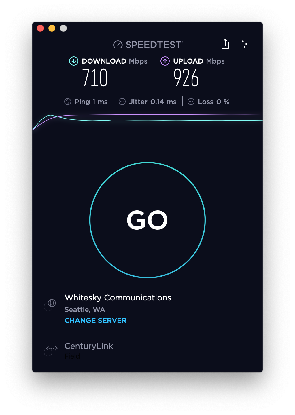

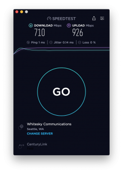

Updated from 10.15.2 to 10.15.3, and updated the Speedtest app, and I'm getting great speeds.

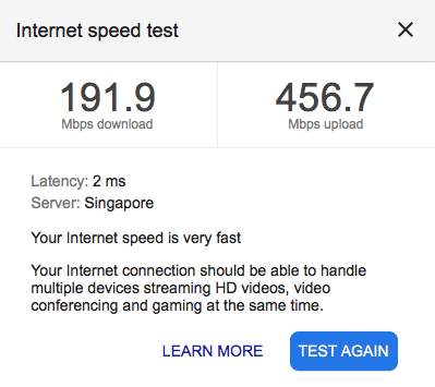

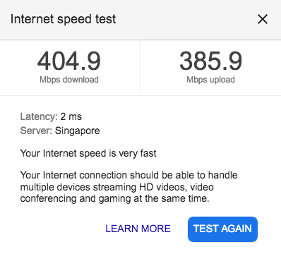

Don't ever do speed tests within a browser (at least on Mac) if you're trying to measure the speed of a networking connection > ~500Mbps. You will run into a CPU constraint (multiple cores pegged at 100% utilization) and the browser's networking layer will end up being a bottleneck -- thwarting the very connection throughput that you're trying to measure. Firefox is worse than Safari in this regard.
Funny, I had the same result using Safari:
And then installed Firefox as someone suggested, and surprise, surprise:
Note that the values differ each time I run the test, but they were consistently higher for the download when using Firefox.
