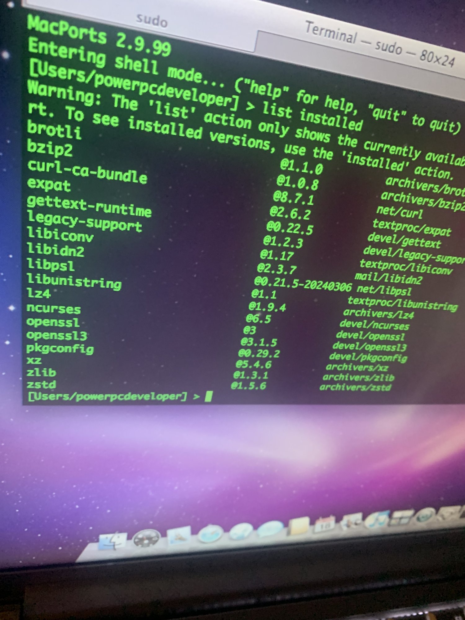

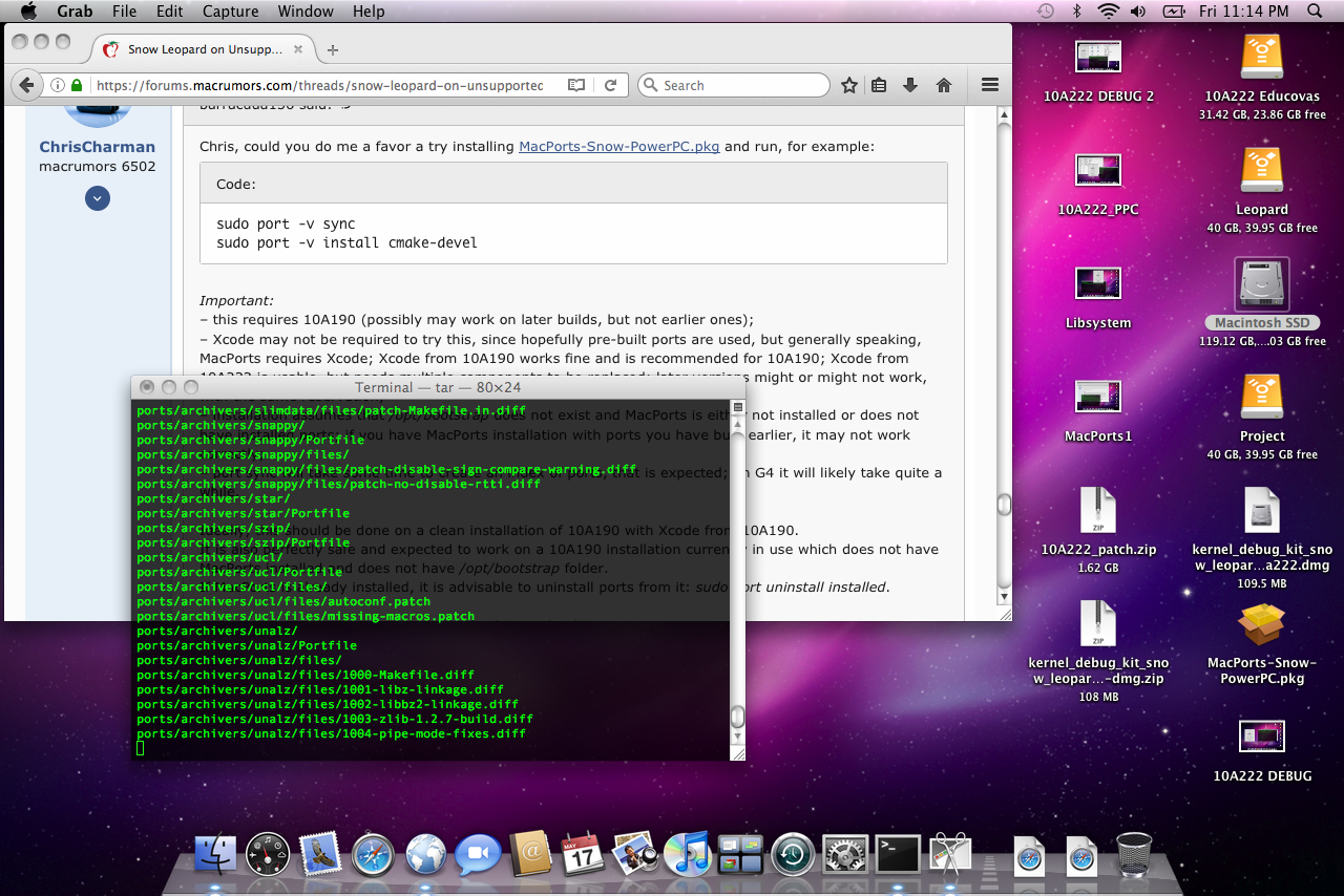

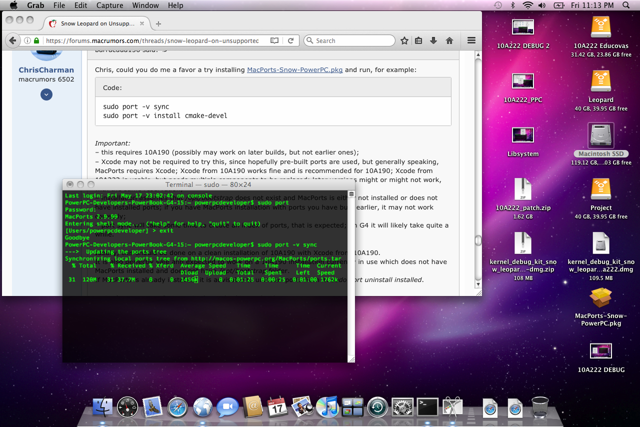

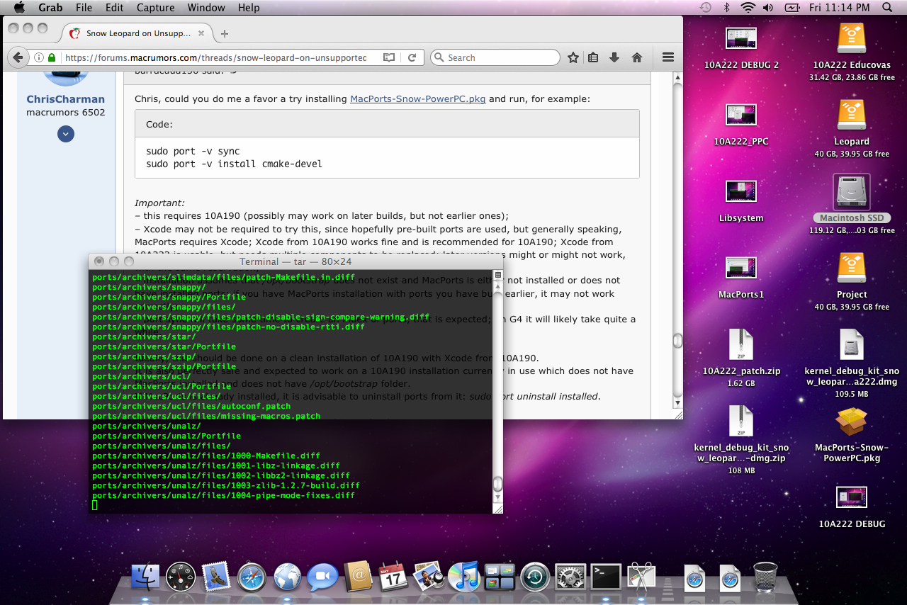

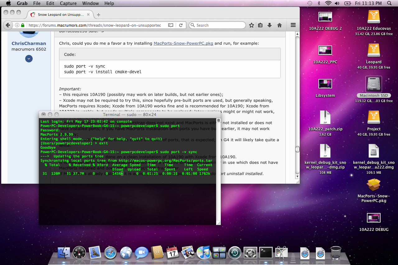

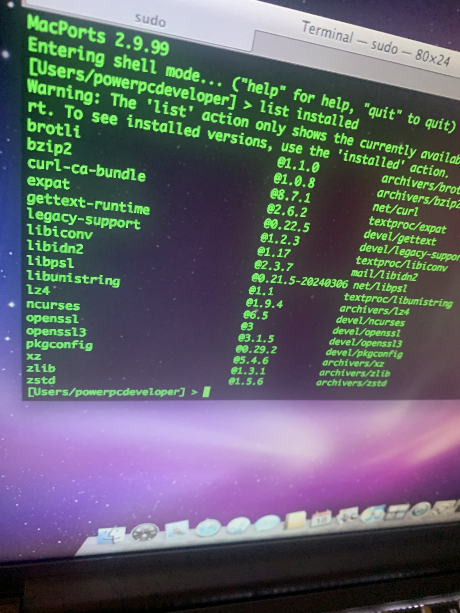

@barracuda156 seems to be working so far on @educovas modified 10A222 imaged to a PowerBook G4 (PowerBook5,6). Will report more detailed findings as i'm able. For anyone looking to do this, Xcode Command Line Tools must be installed.
View attachment 2379612View attachment 2379614
Awesome, thank you very much for trying it out!
If anything up to CMake does not install pre-built, that will mean I have missed building some default variant, so please let me know.
Myself I am using -devel versions of many ports, plus custom variants of cctools, ld64 and libgcc. So that is my concern here, we do not want a user to be forced to build libgcc or smth like that from scratch.
I will still need to provide G4-optimized version of some ports, but for now I hope that the set-up is functional.
