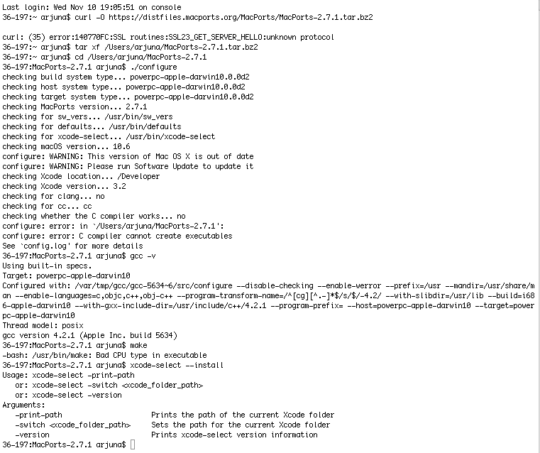

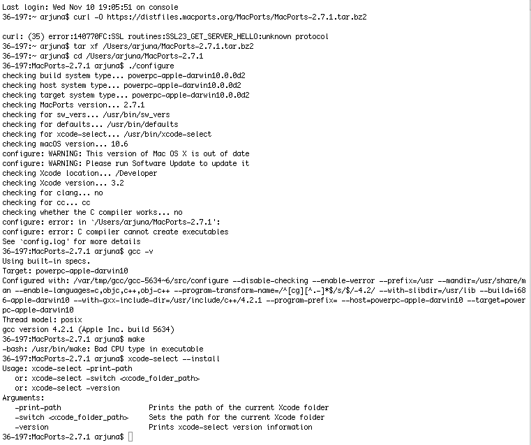

Is the GCC PowerPC compatible? Perhaps the parts of the 2.6.1 Xcode that are failing can be patched with the working components from 10A096 version, or recompiled?
It says the C compiler isn’t working but that’s not very useful - perhaps use ‘file’ on the binaries inside the Developer Tools and see what architectures they’re compiled for? It does look as though ‘make’ is intel on your system now. If GCC has been compiled for PowerPC then we can use it as a replacement for the earlier version, even without the rest of the IDE. I may have a look through the 10A432 version for later builds too actually, it’s something I hadn’t considered doing until now.As of now I am unsure gcc is functional. I tried to build macports on that system with Xcode from 10A261, and it fails:
How can I test gcc specifically?
I can also move some Xcode components under root from one system to another and find out when things start working. But doing that may take time, there are many components scattered around.
I’m unsure. Both @B S Magnet and myself would like to find a script that would easily achieve this as well.Will do that once back to office. By the way, what can I use to batch compare contents of folders with architectures and versions listed? Like, to find out what components differ between two Xcode installations at once?
TheAnd how to check architectures of executables, unless they are explicitly stated in a file name?
file command can do that. It also accepts wildcards. Unless you're referring to something else?Yeah there are a number of builds i’ve seen mentioned across the net over the last few days that we haven’t seen before - i’ve not seen 10A246 and 10A250 before though.I see. And how to check architectures of executables, unless they are explicitly stated in a file name?
It does eventually complete and show the number of hits despite the warning messages about files that it can't identify, takes 5-10 mins to run
Cheers,
Thanks. The command counted 104 hits for Build 10A96.
find . -type f -perm +111 -exec lipo -info {} \; | grep ppc64 | wc -l
reveals 24 hits on 10A190. On the other hand, on my 10.5.8 install, the same command reveals 1140 hits, although it's not really a clean install anymore. Indeed doesn't sound like ppc64 was sitting on top of their to-do list for SL.

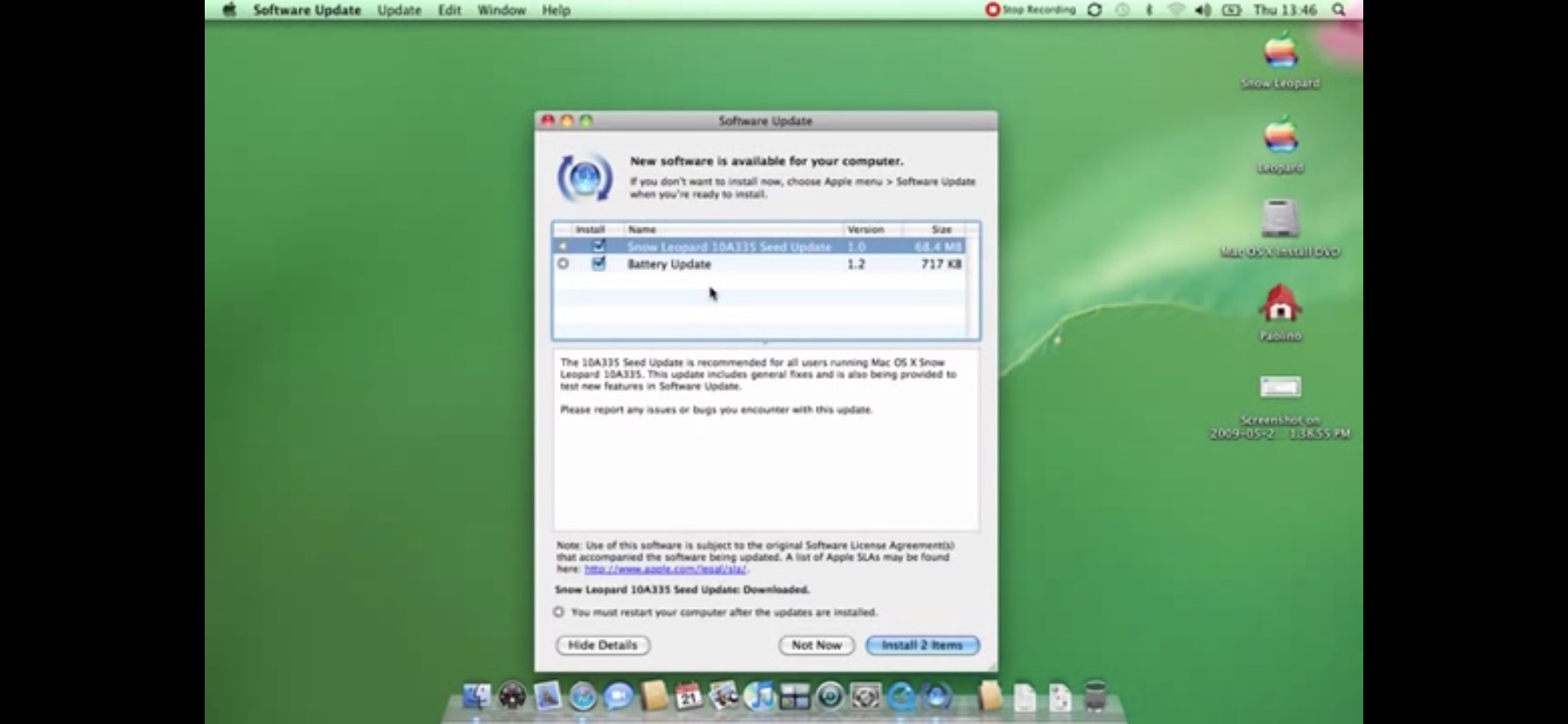

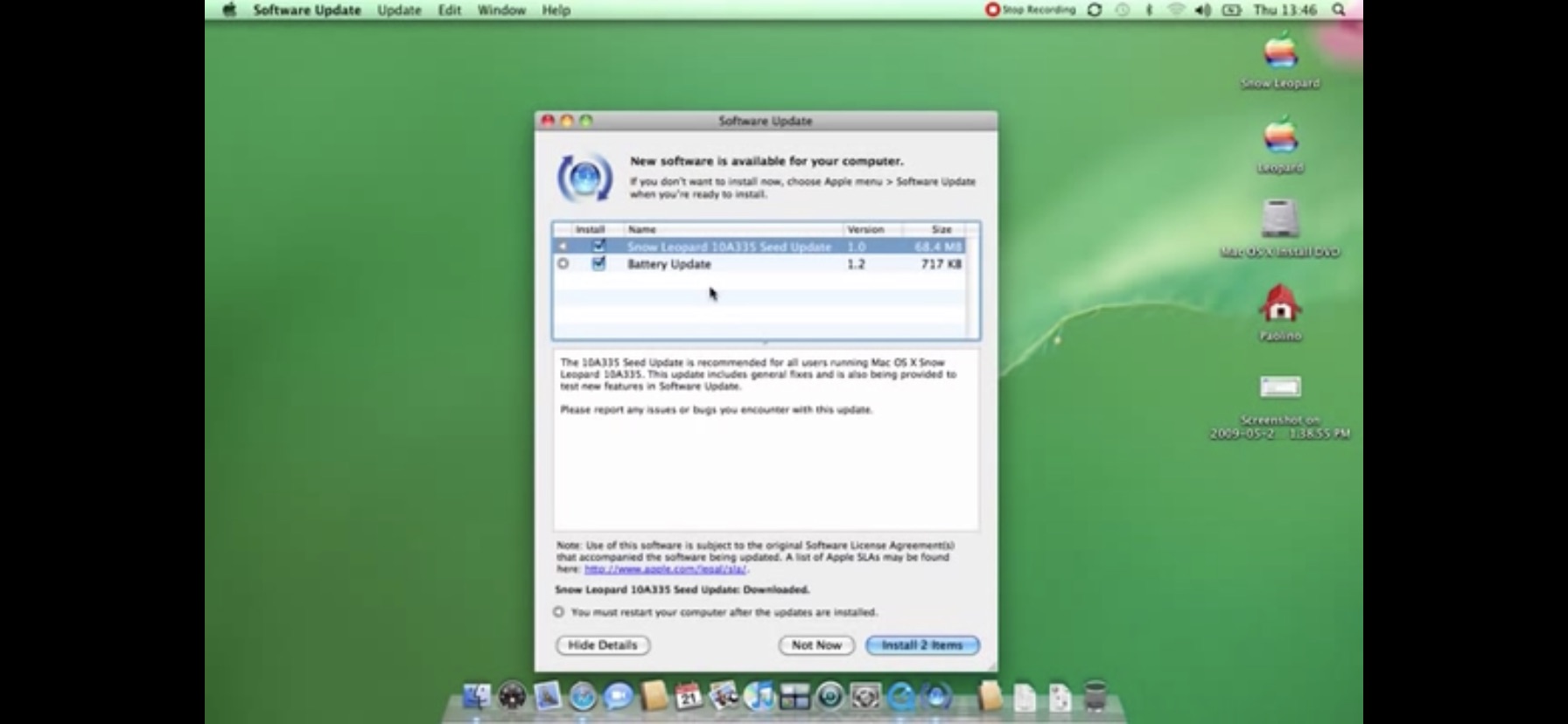

I would agree however i have seen video footage of the build on YouTube (screenshot below) though descriptions of experiences between the separate builds is more than likely error prone. It could be that 354 and 355 are updates to client and server?I’ve spent some time over the past couple of days to review threads from 2009. Mentions of a “10A355” appeared to be conflated with Build 10A335, as mentions of it preceded mention of a build 10A354 by several days and appeared in mentions very shortly after seed release of 10A335.

Very possibly, especially at that later stage of product development, though the screen cap here shows 10A335, not 10A355, and 10A335 is thoroughly documented by several independent sources and whose date of release comports well with the dates associated with other releases.
