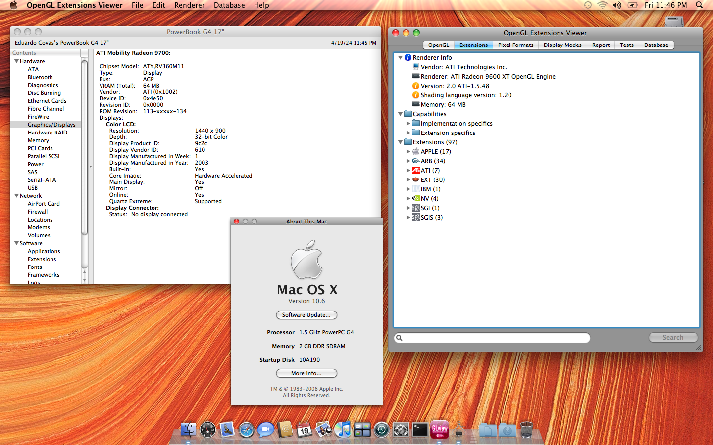

After 4 years, yesterday i finally fixed my PowerBook G4 and decided to test the 10.6 PowerPC developer beta and after playing a bit with 10.6 10A190, I was able to develop a patch set to enable QE/CI for my ATI Mobility Radeon 9700.
All binaries are from 10.5.8 and I had to re-add the 9700 kexts and bundles, downgrade OpenGL.framework, QuartzCore.framework and CoreGraphics.framework. Both QuartzCore and CoreGraphics required stubs to load properly.
I think these patches should work for other AGP GPUs if combined with the correct kexts and bundles but I can't test since this PowerBook5,5 is the only PowerPC machine I have.
This is promising, I will try it.
Do you think we could get ATI 1900XT (i.e. PCIe) to be supported?
