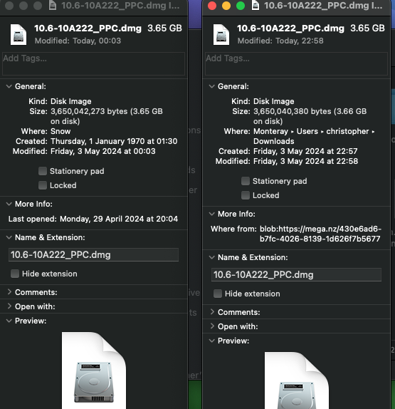

So i’ve now re-downloaded @educovas customised 10A222 .dmg and can clearly see that the file size is marginally different, so my first attempt may well have been a failure due to a corruption that occurred via Mega download service. I was unable to verify checksum on either of the disk images within disk utility on 10.5.8 but when looking at the details in the Finder ‘Get Info’ pane, the file size difference is clear.
I experienced the same issue trying to block level restore the .dmg using disk utility however on the newly downloaded disk image, with it reporting failure at the last instance. Much as @barracuda156 experienced.
I am at this moment in time completing a block level clone of the disk image using Carbon Copy Cloner 3.0.1. I will report back once i’m able to verify if it is successful or not.
I have also downloaded the zipped folder with all of the files that were used to create this hybrid build and will dig into those and investigate as time permits.

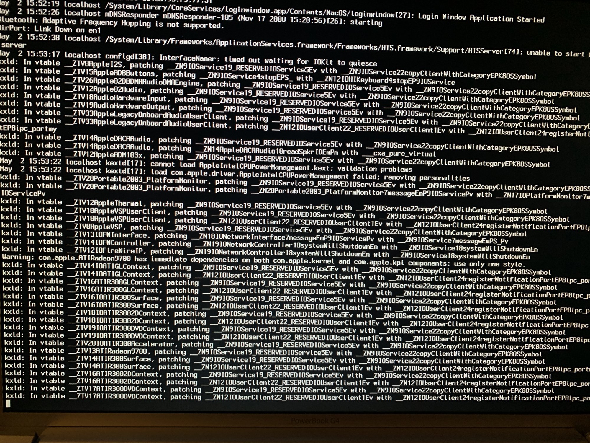

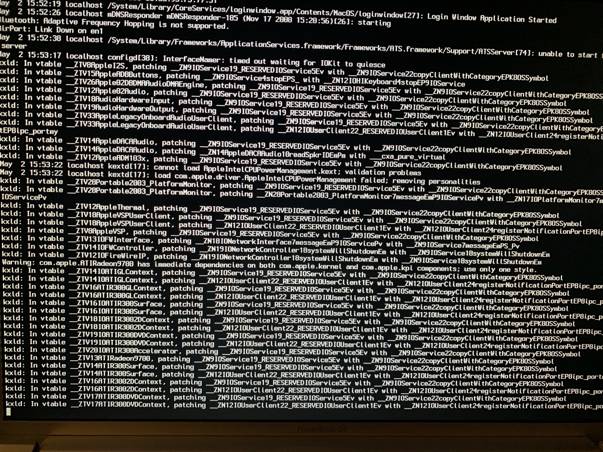

Then why the hell does it refuse to boot on my PowerMac G5?
