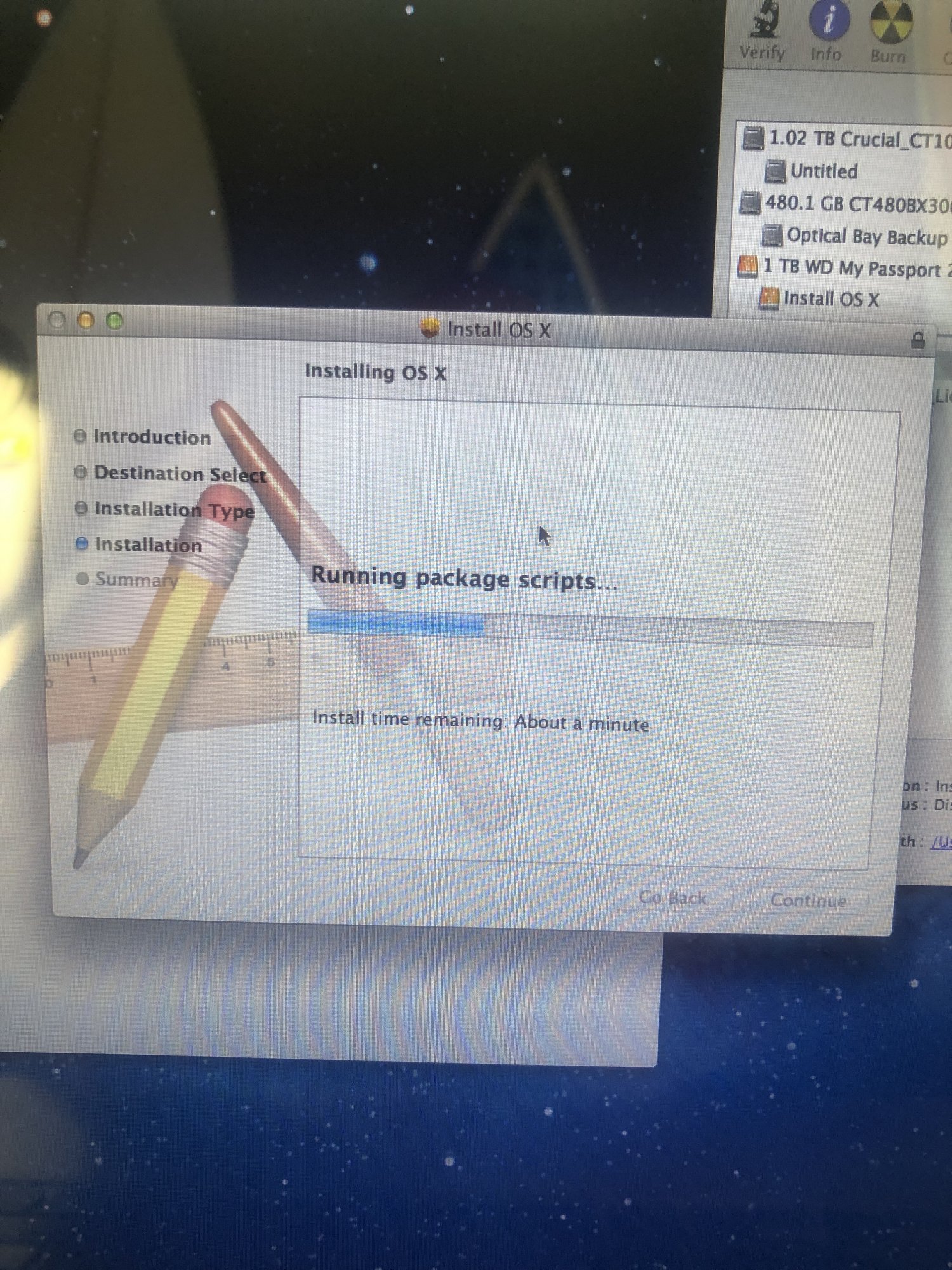

Dowloaded OS X Yosemite from the link above on apple support and all it did was run package scripts as seen in the photo.
What's next? I'd rather take advice from someone rather than running in circles with this. so very frustrating. UGH!
[automerge]1580180819[/automerge]
ok...once again, I didn't keep reading the instructions on the apple support page. Stand by. UGH! LOL! Install looks like it's going ok once I launched it from the Applications folder. (fingers crossed)
