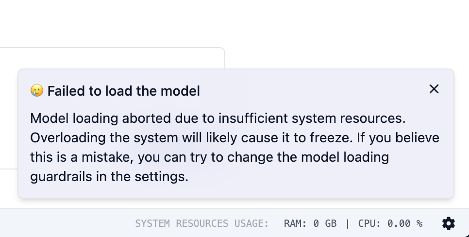

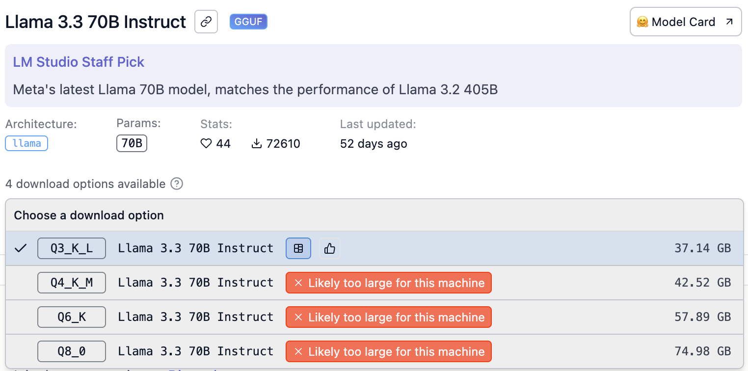

I've been trying out other LLM tools - so far that's been Ollama, LM Studio, and Jan. I'd like to use LM Studio and Jan more, but the more I ask them the more gibberish it comes out with. Maybe there's a setting to change that, but I don't get that from Ollama. More experimentation is clearly in order. :)
LM Studio says certain models that I know run fine in Ollama 100% in GPU are too large. For example, Q4_K_M below.
I notice that, which is why I’ve stayed small (below 5GB) on LM Studio and Jan. I don’t want to run anything too big because I’m also doing some image generation at the same time. Both together really push my MBP. I can see myself with a Studio in the near future!
Try Ollama. It seems to allow me to run bigger models on my M1 Max, so I use that. LM Studio doesn't even let me load a 43GB model (which is under the 75% limit GPU max memory available under my 64GB RAM). 75% of 64GB is 48GB.
I use Ollama most of the time. I’m just experimenting with what alternatives are out there.
