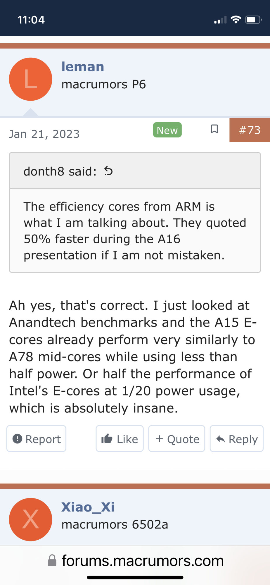

But that doesn’t matter what Apple is doing in terms of E core performance, they don’t even talk about it publicly. Our resident chip expert @cmaier explained how far ahead Apple’s E cores are from both a performance AND extreme low power consumption prospective a while back. I’ll see if I can dig that up after work.
Edit: Apologies, I mixed up users, it was actually @lemans (another hugely knowledgeable member in chip design).
It’s also important to keep in mind that Intel’s E-cores and Apple’s E-cores have very different design targets. Intel is about performance per area - they want to maximize multi-core throughout without making the chip bigger. Apples E-cores are about minimizing energy per task. Two very different goals, two very different approaches.
NT1440
macrumors G5
May 18, 2008
14,756
21,449
Very true, Apples done a ton of work in the logic of how and when the e-cores get used. It’s what they deliver at the insanely lower power draw that I still can’t wrap my mind around.
