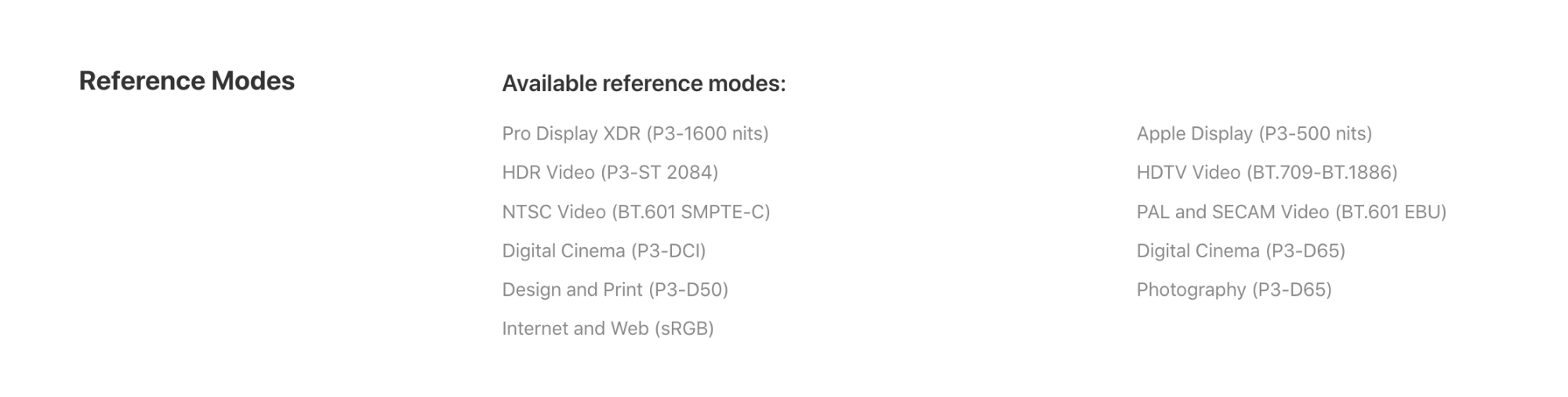

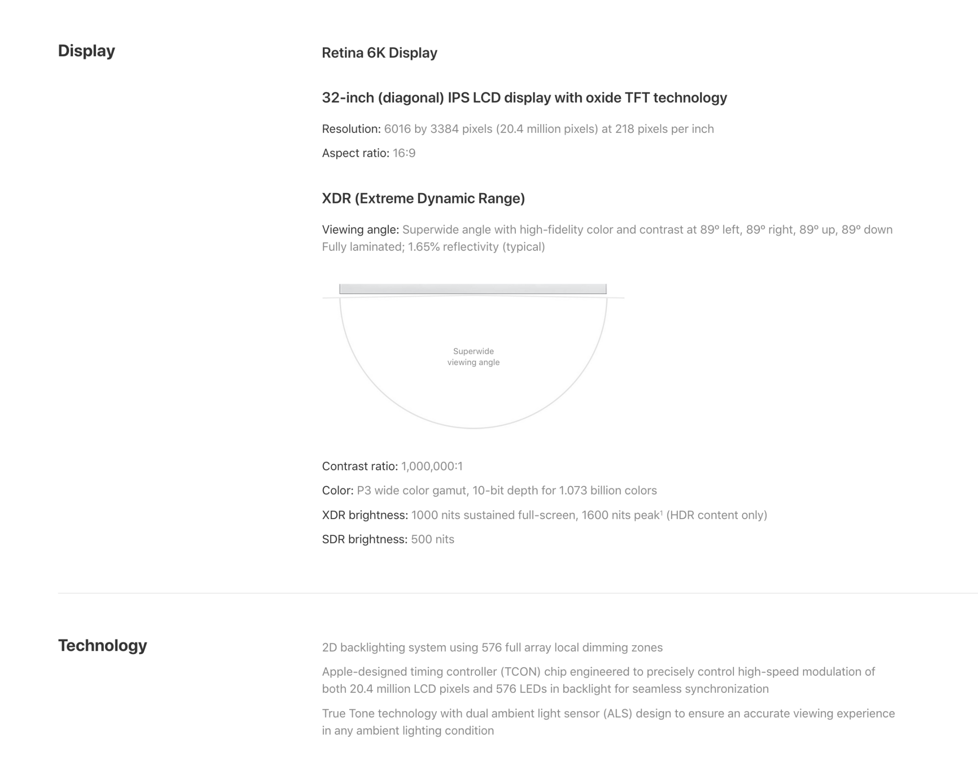

In addition to the above .. the specs of the XDR display truly seem first rate all the way....

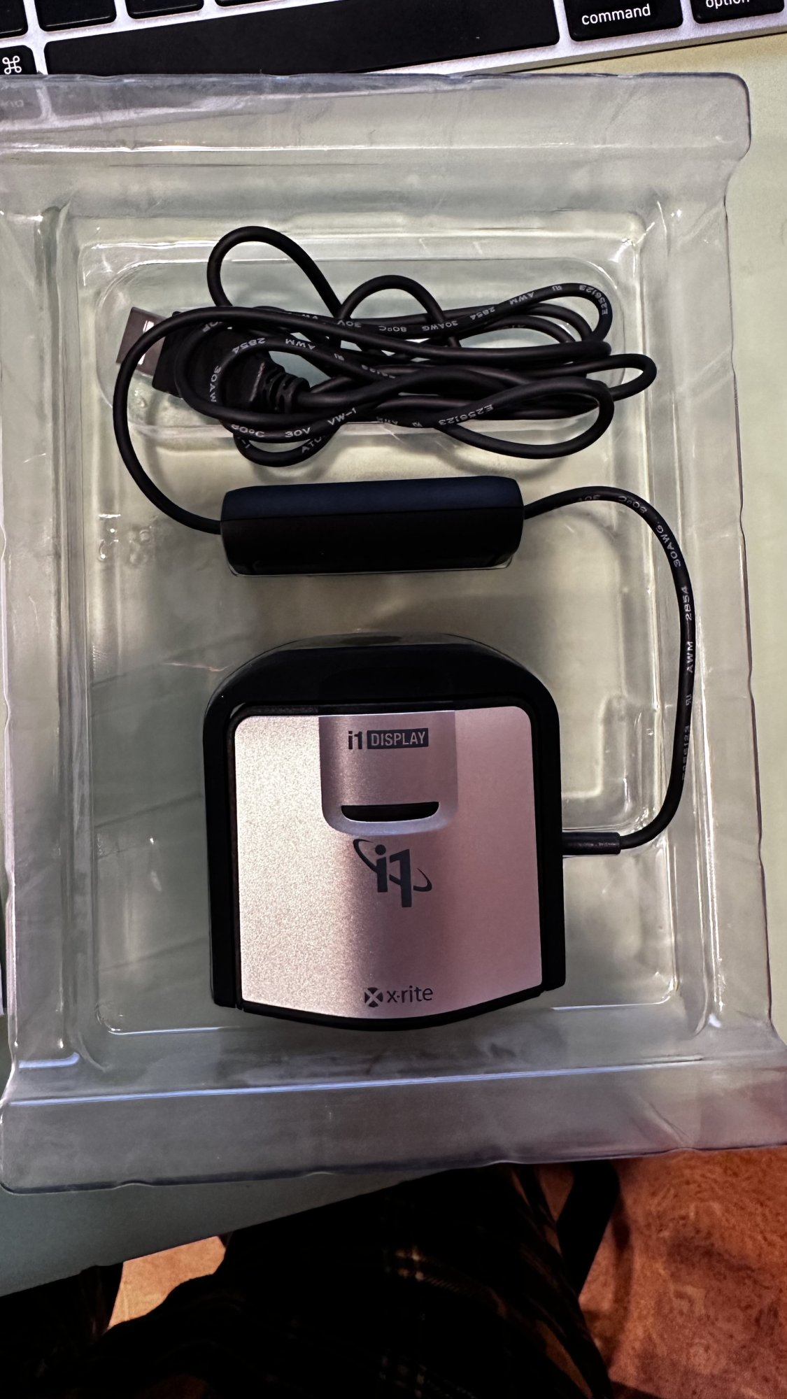

And reading on the calibration of the monitor ... seems the jury is out does the tech even need it or not ...
It's been a few years since I've use this for a computer monitor, I do use it to calibrate my basement JVC NX7 HT projector.
All monitors need calibrating as they drift over time. We sell the successor to the X-rite device you posted. You will need to purchase the Calibrite software if you run the latest OS as X-rite are not updating theirs any longer. They still build the devices for us. The latest HL (high luminance) devices would probably be a wise choice for your monitor.

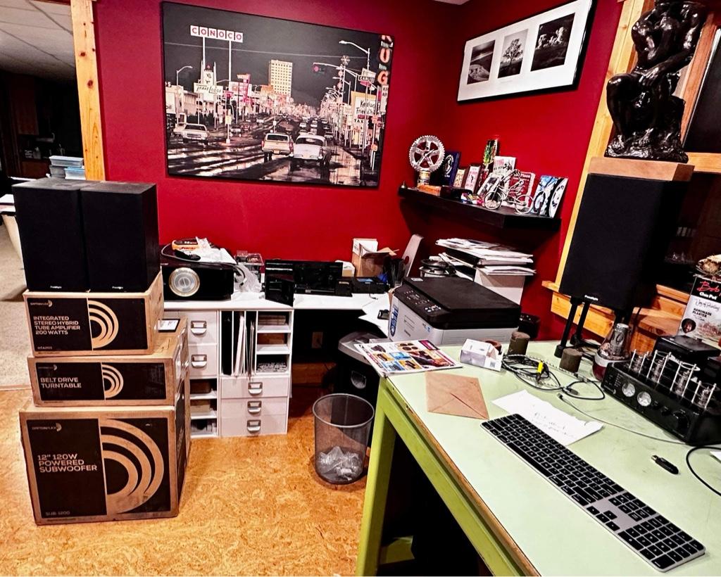

11 years ago I gave up on vinyl, having burned them to digital ..
My 21 year old daughter is part of the vinyl resurgence.. I got her the stuff below for her college graduation gift / apartment gift .
I did get rid of my 400 CD mega changer and the discs
So many of my fellow HT enthusiasts have moved from printed to digital ..
FWIW, I still print occasional big prints for myself.. but I am open to tech and not gimmicky but truly good photo displays, like Micro LED, come 2028 or so .
There, HDR will matter.
Just thoughts ..
