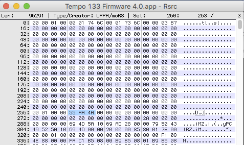

I don't think you can or should assume resources in a resource fork are stored in a single sequence of bytes. Actually, the file format description for resource forks does say each resource is contiguous.
https://github.com/kreativekorp/ksfl/wiki/Macintosh-Resource-File-Format
It also says the four bytes before the resource data is the resource size. In your screenshot - the number is 0x00010000 which is exactly 64K which is what you got in the fwre_136.txt file.
Oh, I see the problem. In the fwre_136.txt file there are a bunch of non-ASCII characters. DeRez is producing text with Mac OS Roman encoding (the encoding of classic Mac OS) where all characters are assumed to be a single byte. But sed is assuming the bytes are UTF-8 which has some multi byte characters - some of the non-ASCII bytes are being interpreted as multibyte UTF-8 characters but not all combinations of bytes are a valid UTF-8 byte sequence.

Regarding the compression, the example firmware I have has 64193 bytes of fcode in the first step (63K) and the decompressed fcode is 93816 bytes (91K) so you see how it can be useful if the rom chip is only 64K or if the rom chip also contained a BIOS or EFI image.
Anyway, it's possible that the decompressed fcode does not require anything of the first fcode, in that case you could load just the decompressed part if you are able to extract it.

The way I did it was that I had the sonnet card and a compatible Mac.
- Boot into OpenFirmware.
- Capture the RAM for the Open Firmware dictionary.
Code:
# Set the terminal width to 130 and make sure the unlimited buffer option is selected in the window preferences.
# On the G5, type " enet:telnet,192.168.1.150" io
# Then in the terminal type the following:
telnet
open 192.168.1.150
: dumpbytes cr bounds ?do i 3f and 0= if cr then i c@ 2 u.r loop cr ;
0 > ' <init-world> . ff845730  ok
0 > ff844b00 here ff844b00 - dumpbytes
ff84d168ff84d168ff84d168ff84d168ff84d168ff84d168ff84d168ff8a16e0ff8a1690ff8a1640ff8a1600ff8a1510ff8a14e0ff8a1488ff8a1460ff8a1430
ff8a13e8ff8a1390ff8a1358ff8a1300ff8a12a8ff8a1250ff8a1200ff8a11b8ff8a1168ff8a10d0ff8a1060ff8a0fe0ff8a0f70ff8a0eb0ff8a0e30ff8a0de0
ff8a0da8ff8a0d68ff8a0d38ff8a0cf8ff8a0ca8ff8494a8ff849490ff848a90ff848a70ff8489f8ff8489c8ff848888ff8487a8ff8484e8ff8484c8ff847c28
ffa3bdb00000000461646472657373000000003b00020000ffa3be58ffa3bde8ffa3bdd40000000466626f666673657400000000000000000b037f0806103292
0a0006400aa00a2f0a4f0000066e0642064800000ff95b0000000100000000000000000000000000000000000000000000000000000000000000000000000000
0000000009d5b3400200000000000000000000000000000000000000ffa3be68ffa3bdf80000005c4e564d5400000000669955aa00000000ffffbc6084b7ffff
0964756d706279746573000000000000967efffc7e6802a64be16b014be1127d4be0b2014800003c4be0c3014be0a6f50000003f4be0e1354be0dbe94be0b16d
480000084be16ad54be0c2e14be0c35d4be0d2d14be1b4854be0b2214bffffcc4be16ab94be0a5bc
 ok
0 >
All this stuff in the dictionary includes compiled fcode, the device tree, device tree properties and methods.
In the above example, <init-world> is the first word in the dictionary (it is the last word output by the words command). On my PowerMac G5, it's at address ff845730. ff844b00 is that address minus ≈ 3K. I think I chose this as the start because it looked interesting?
- save the hex into a binary file.
xxd -p -r < compiledfcode.txt > compiledfcode.bin
- Parse it using my DumpMacRom MPW script. It will put fcode that it finds into a separate "Part2.of" file.
DumpMacRom -d -s $FF844B00 compiledfcode.bin
This might not work if you don't have a Sonnet card with the rom. I would try just dumping the contents of the driver-buffer word since you said you were able to get that far. What method did you use to load the FCode ROM in that case?
At the end of the rom is this code:
