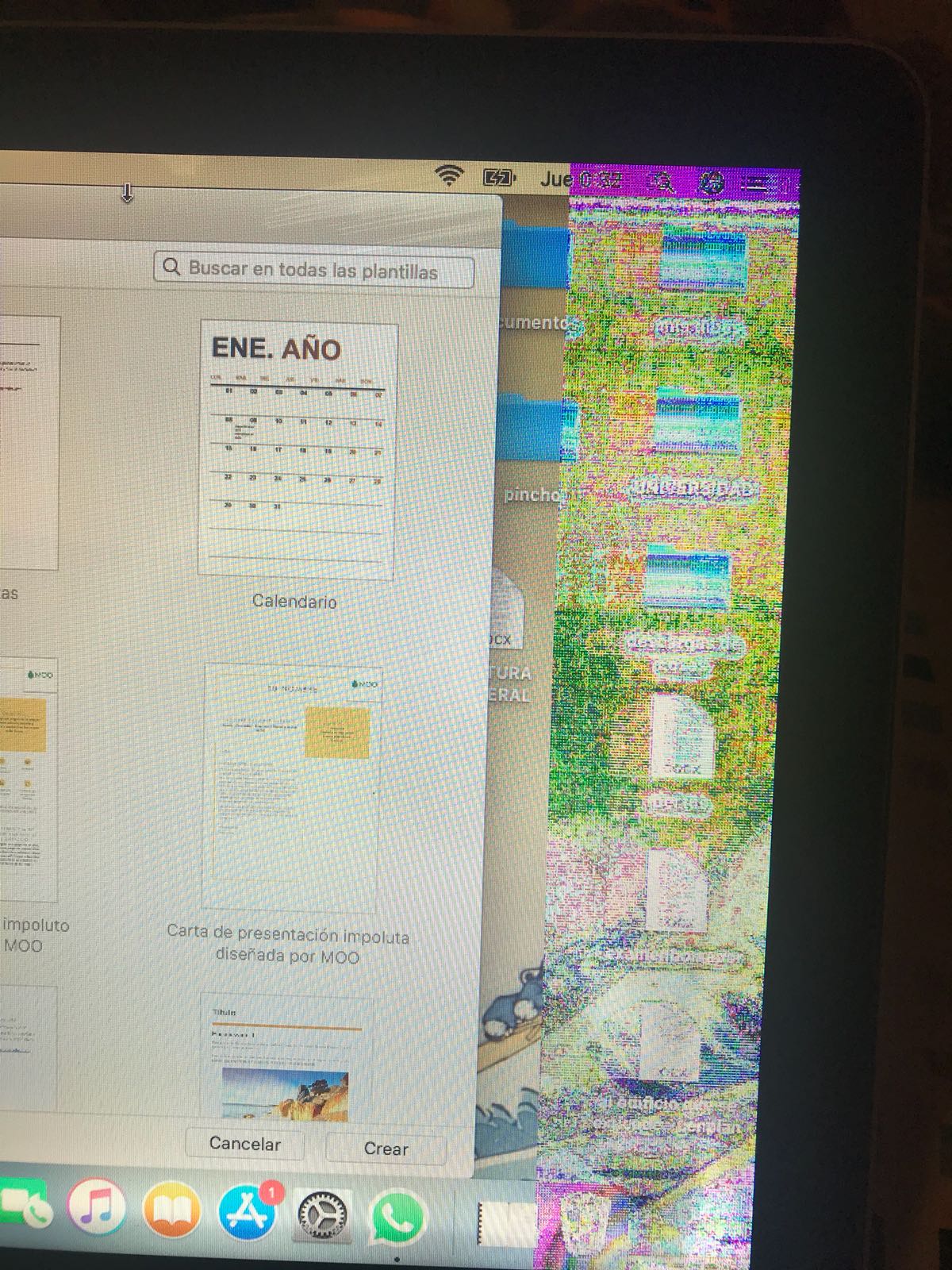

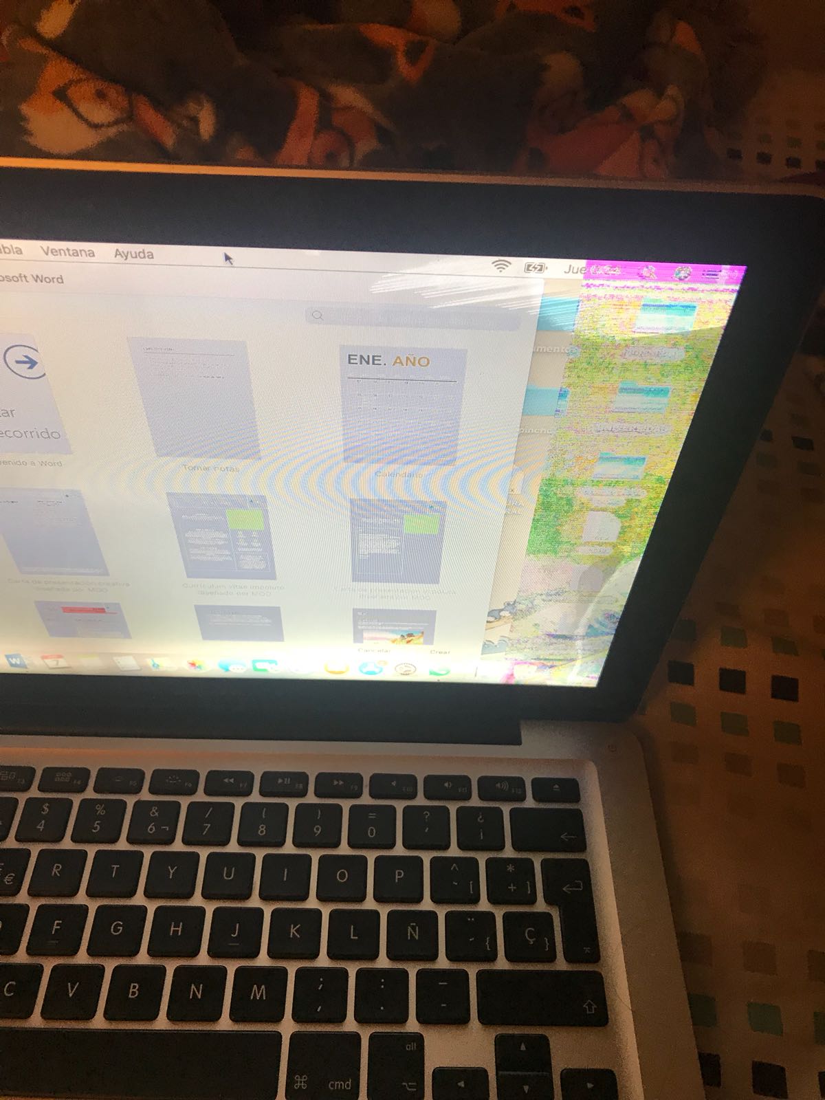

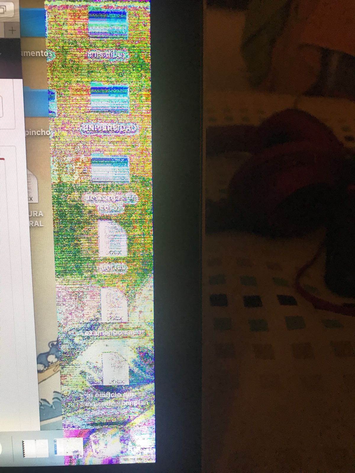

Hi, do you think this is a problem on the gpu or the screen?

The gpu is integrated into the cpu; therefore, I think it is a problem with components on the logic board or connections on the logic board.
But I think it might be the screen because in the corners are signals of liquid and the rest of the screen works perfectly fine. so I hope is the screen and I can replace it.
tomorrow I will connect de Mac to a screen with thunderbolt so I can see if it is the gpu or screen
It's not the screen. You might luck out and have it work fine for a bit through thunderbolt if it is just the connections to the screen that are damaged rather than other parts of the logic board, but if it is not disassembled and cleaned components will corrode and it will get worse.
