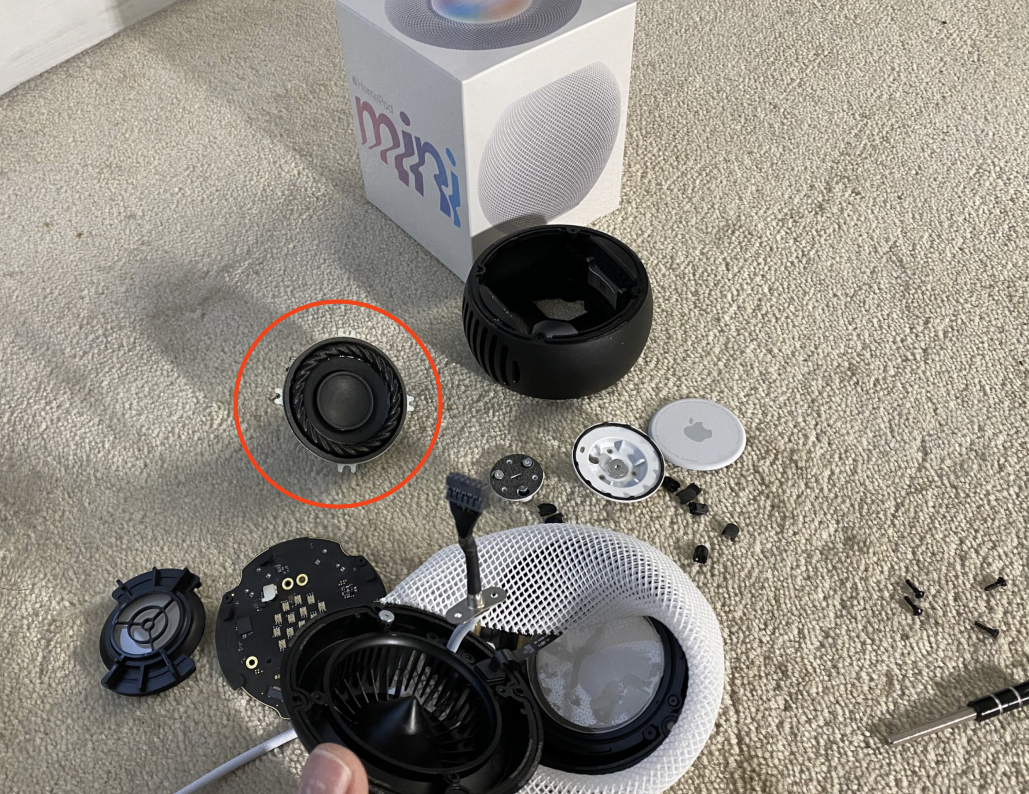

HomePod mini are good small speaker, but it is practically impossible that a small full range speaker can make you hear the medium-low frequencies well, although the use of DSP can deceive the brain, it is a question of displaced air, that little speaker cannot go low in frequencies.

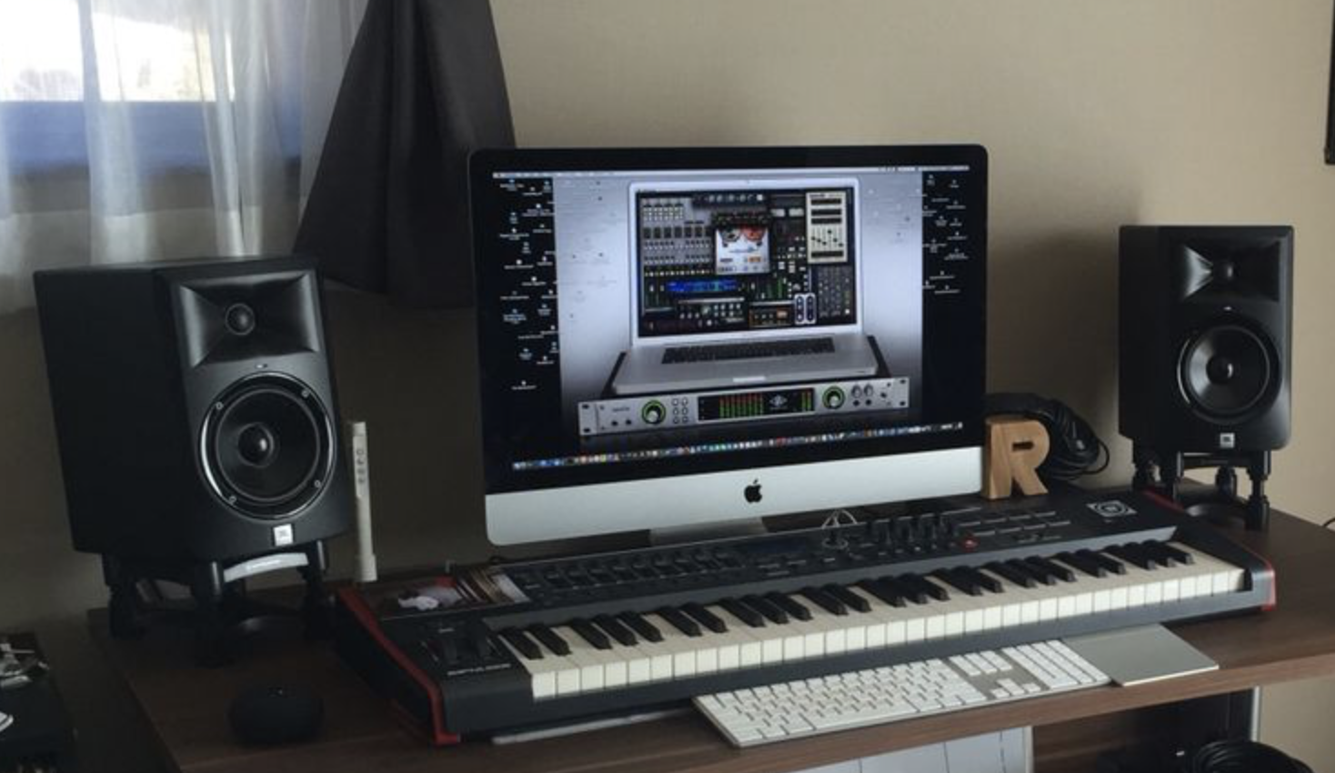

The JBL 305 studio monitors with the 5" woofer already provide better bass performance, quite a difference in size.

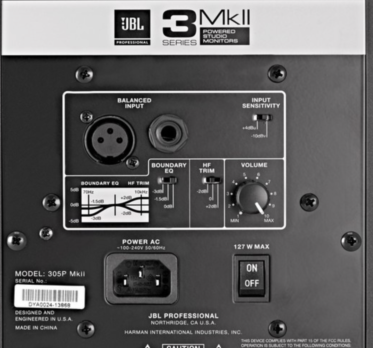

How would I connect the JBL 305p MKII to the mini?
Any further suggestions also welcome. I didn’t focus on passive speakers because it gets very expensive very fast, sure, the speakers might be cheap, but by the time you get your amps/preamps you quickly go over budget. My budget is about $600 tops, which is why I thought $200 DAC + $400 active speakers. Of course if I don’t need the DAC, that leaves $600 for the speakers, which kinda means active, no? Otherwise I don’t see how I can get decent quality passive speakers + amp/preamp for less than $600, no?
I pointed out speakers costing 250-500 dollars and a 100 dollar amplifier.
Look what I reported to you, read carefully, do your research.

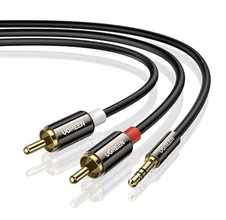

the cables you need cost less than $10 for jbl305.
you don't need adapters.
