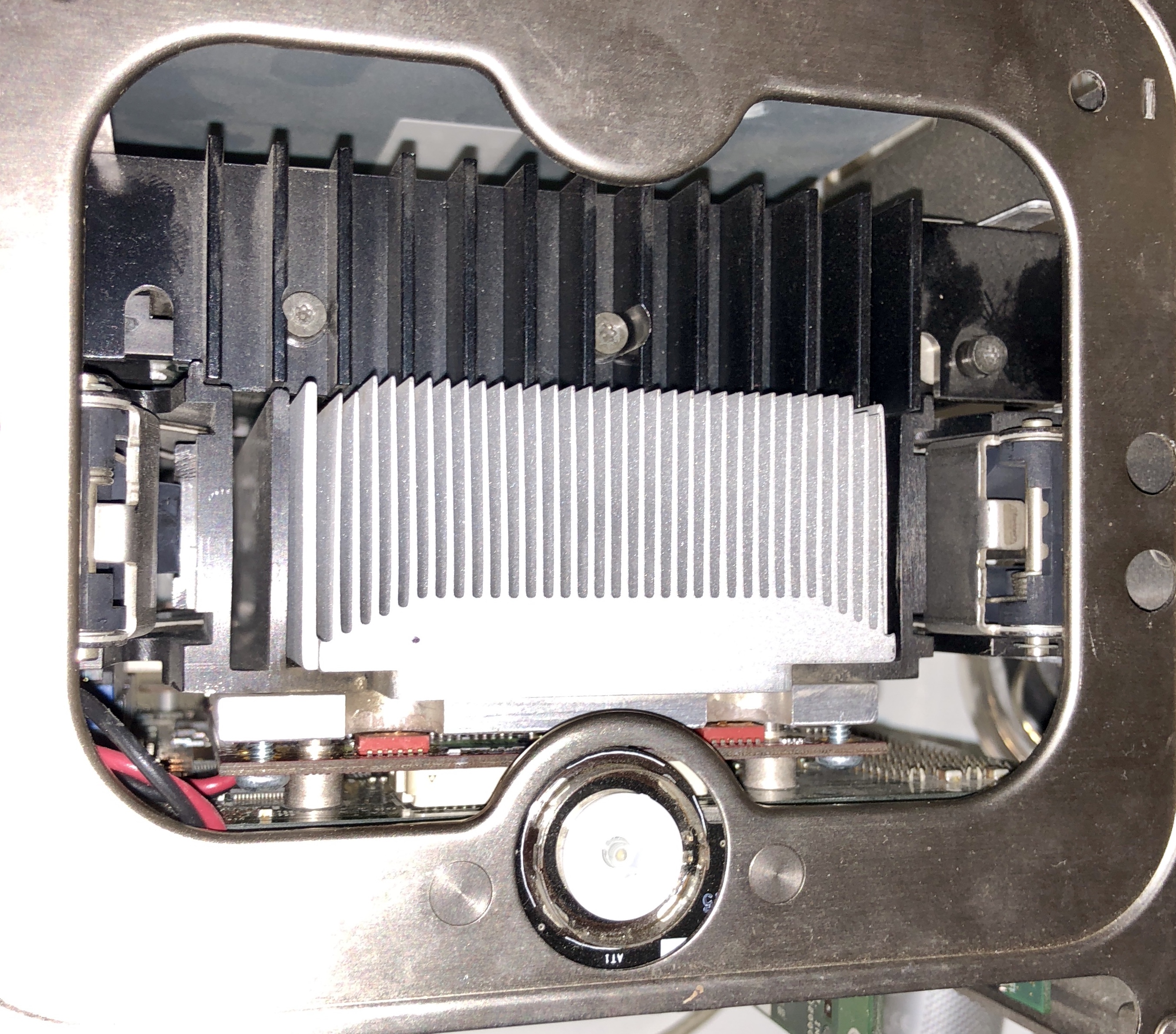

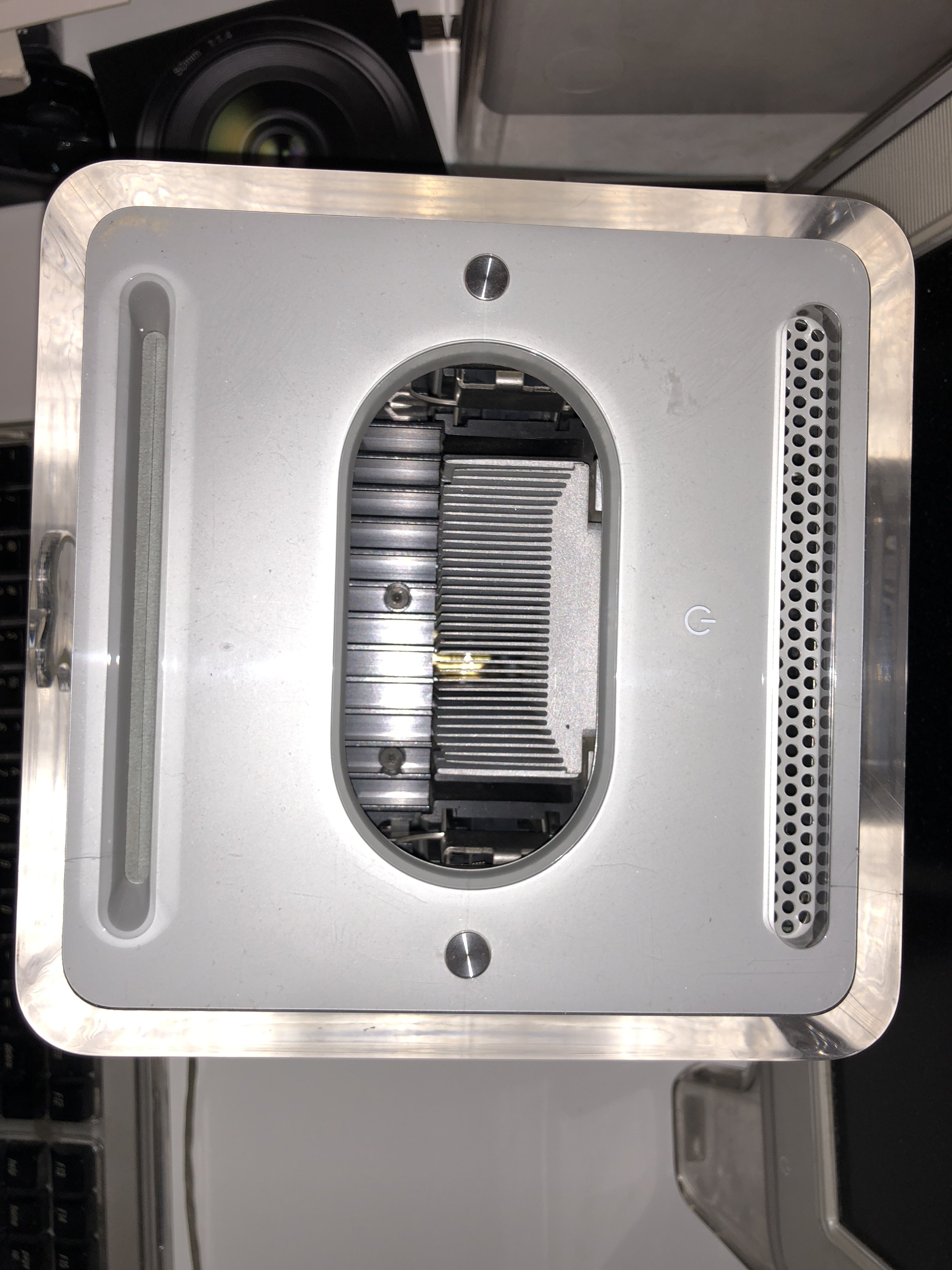

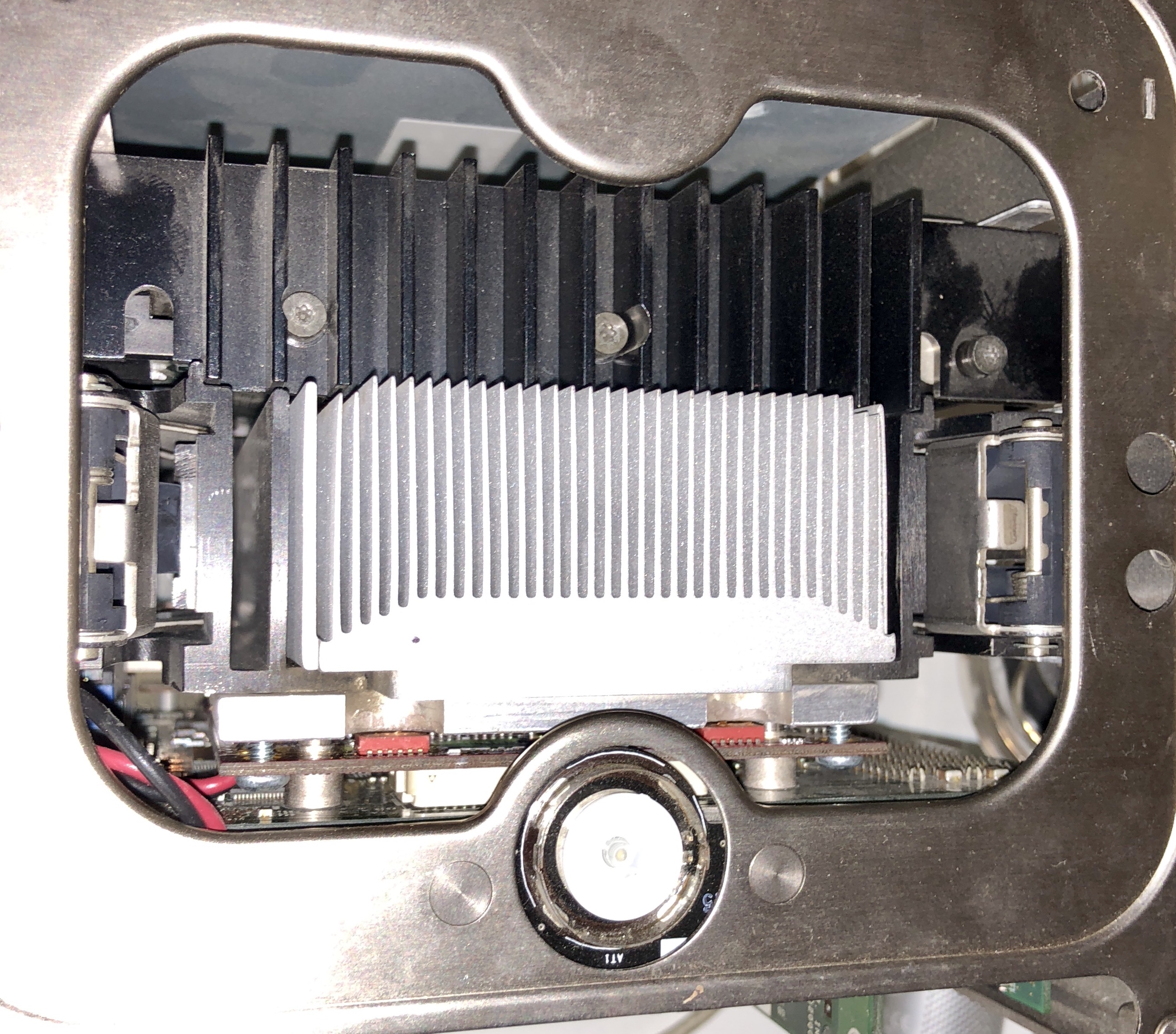

I purchased one that has a 1.7 GHz G4 dual processor already installed with the VRM bypass. It runs extremely cool and geekbenches around 1100-1200. I can get some pictures tomorrow.
The heat sink is definitely custom and the top grill is removed to make room for it it also has a base fan. Going to stick a GeForce 6200 in there as well. Really a beautiful machine that is quite capable.

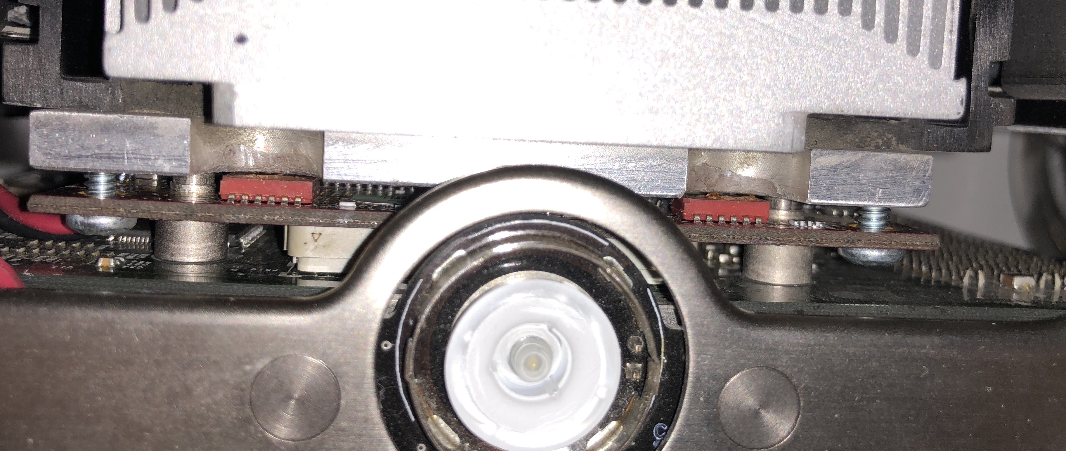

It it came with a VRM that was specifically designed to run the CPU board off of the power adapter bypassing the VRM.

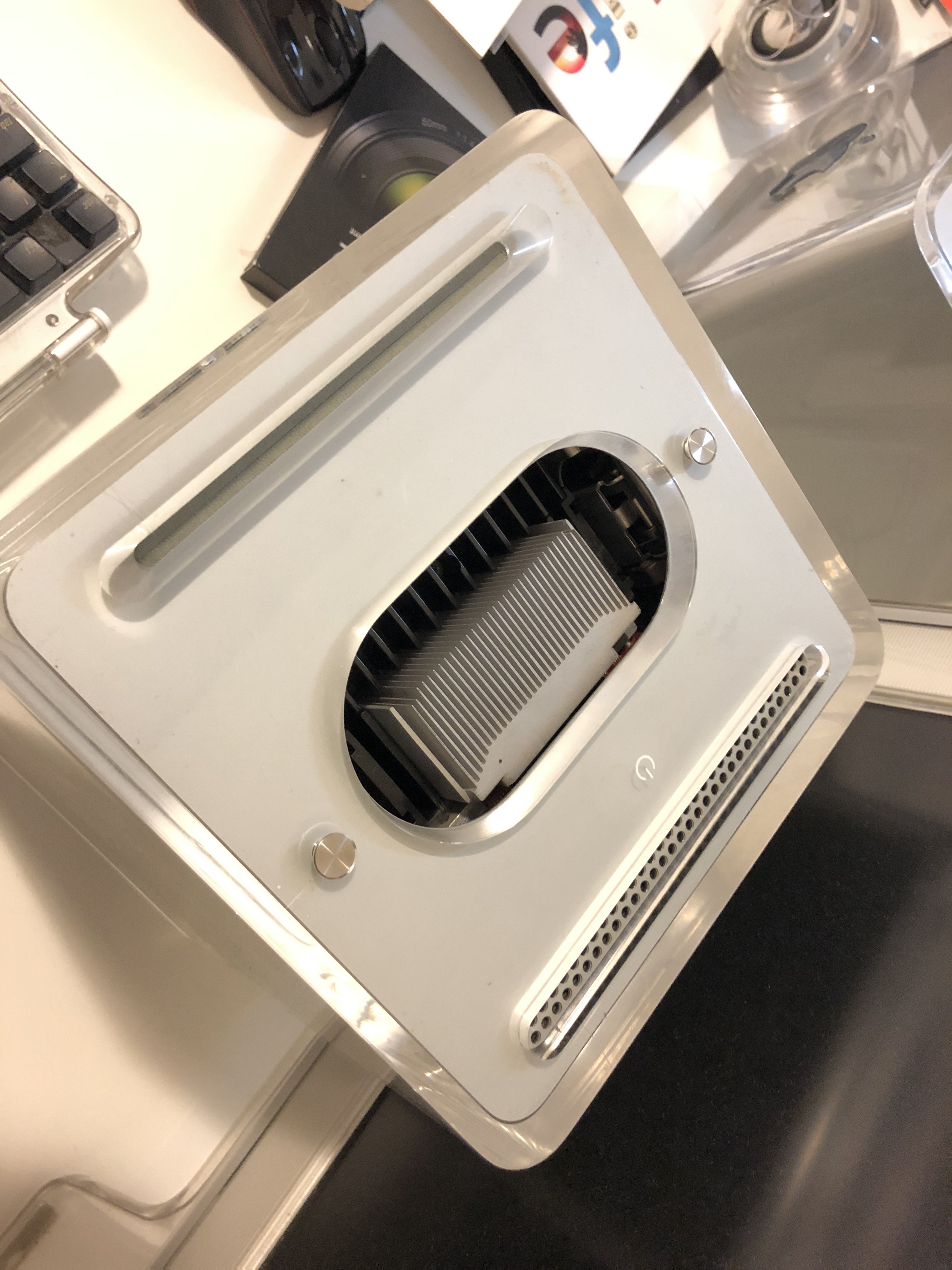

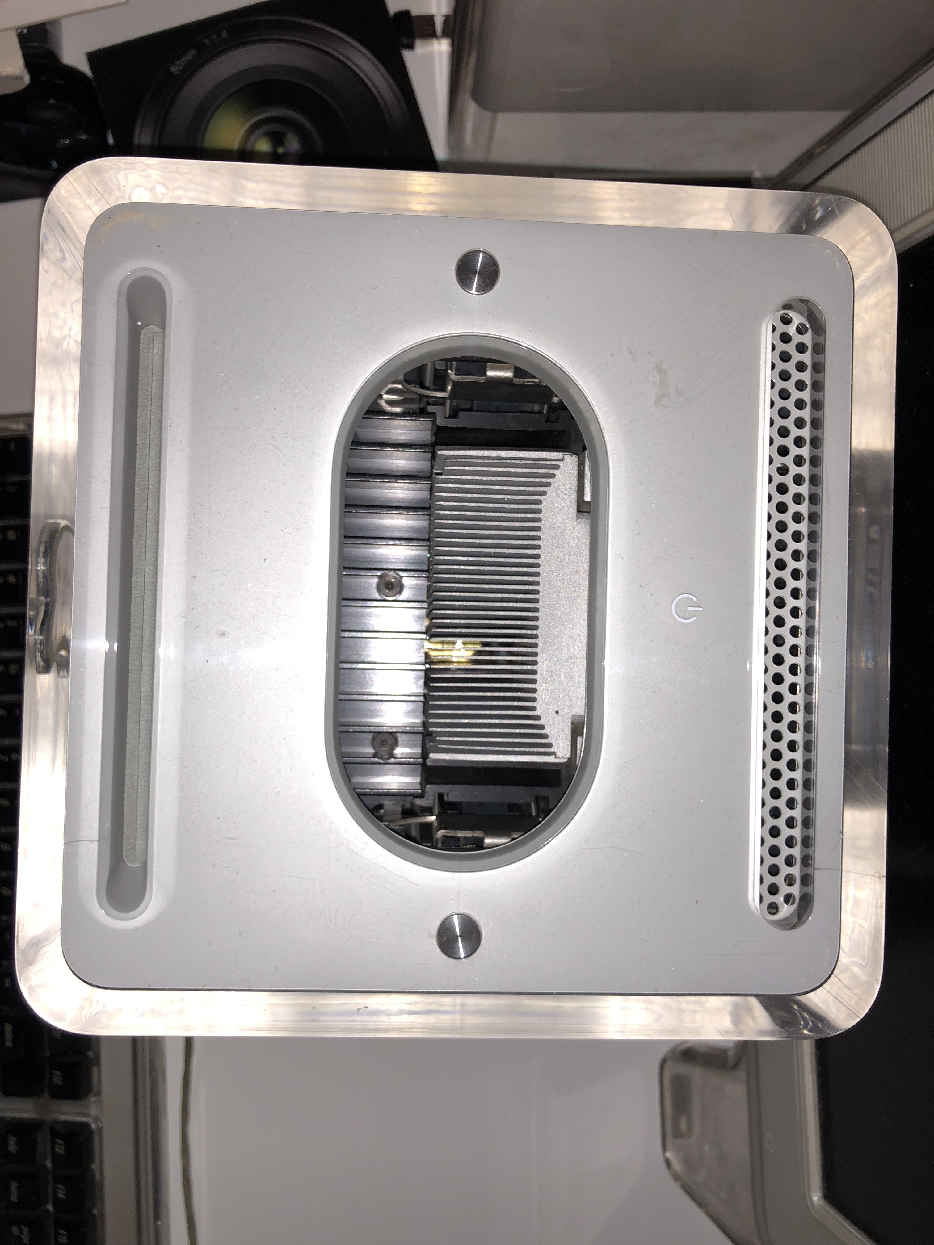

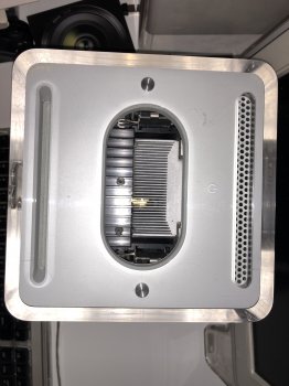

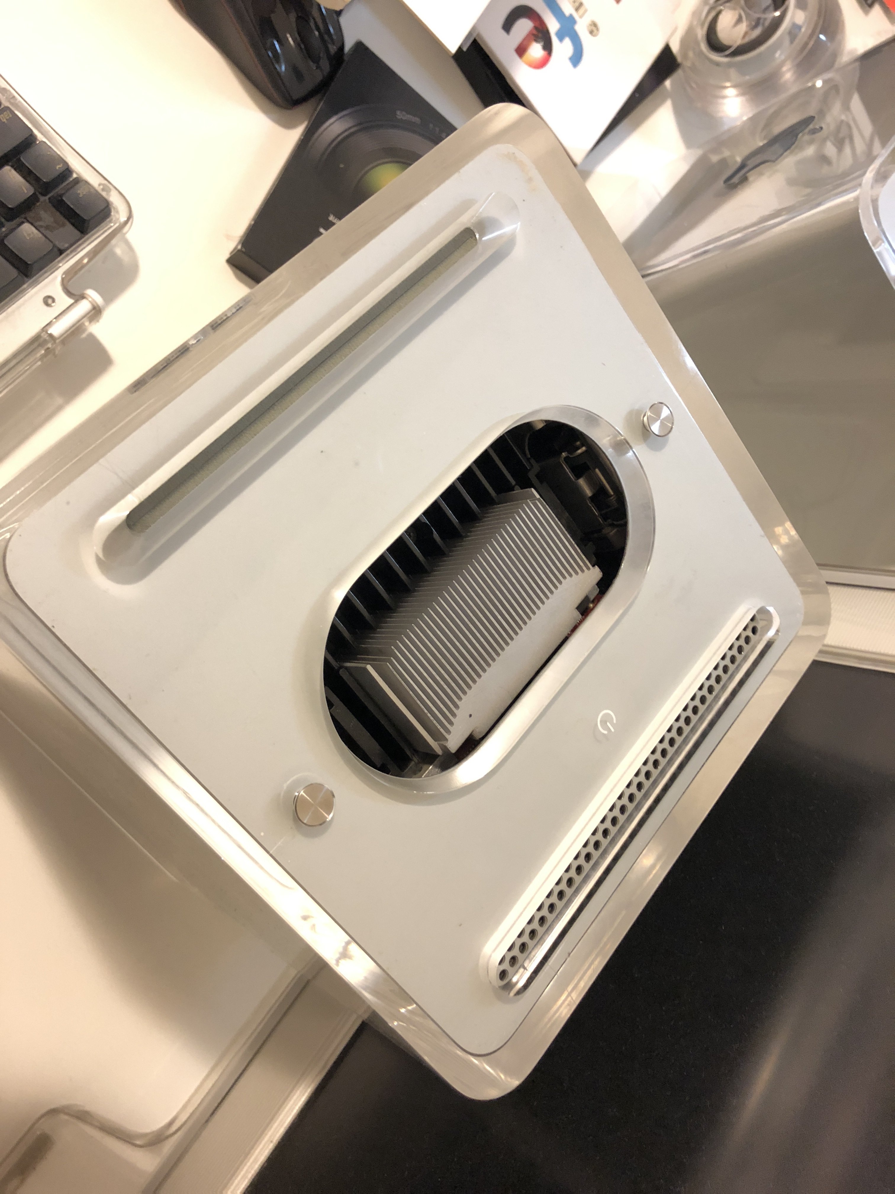

And as promised here are some photos of the heat sink. I can take more after Thanksgiving dinner of course. 🙂

its worth noting that I do not believe Sonnet CPUs need any sort of fiddling with the VRM, so as long as you sort out the heatsink and fan thing, a sonnet CPU should drop right in 🙂
Appleish19 has a non sonnet CPU (notice the red PCB) so his requirements will be different.
of course if you have the means a beefier VRM is always a good thing to have

thanks for that.. it doesn’t look like I’ll be able to find a heatsink easily..
Is it possible to modify the standard heatsink? Any suggestion?
