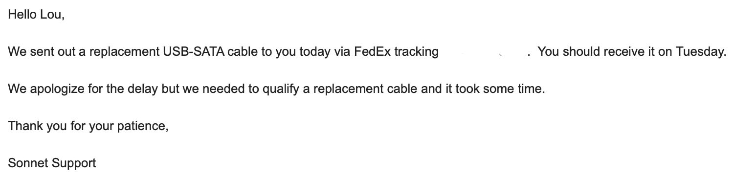

I have this issue too. I contacted Sonnet and they said they will be "in touch" about a cable replacement.
Late last week I started having the issue, five times in one day. Twice today. I sent an eMail to the address above on 7/18. Have not heard back.
Lou
Reactions: typecase
Just received this eMail 👍
Lou
Reactions: OkiRun

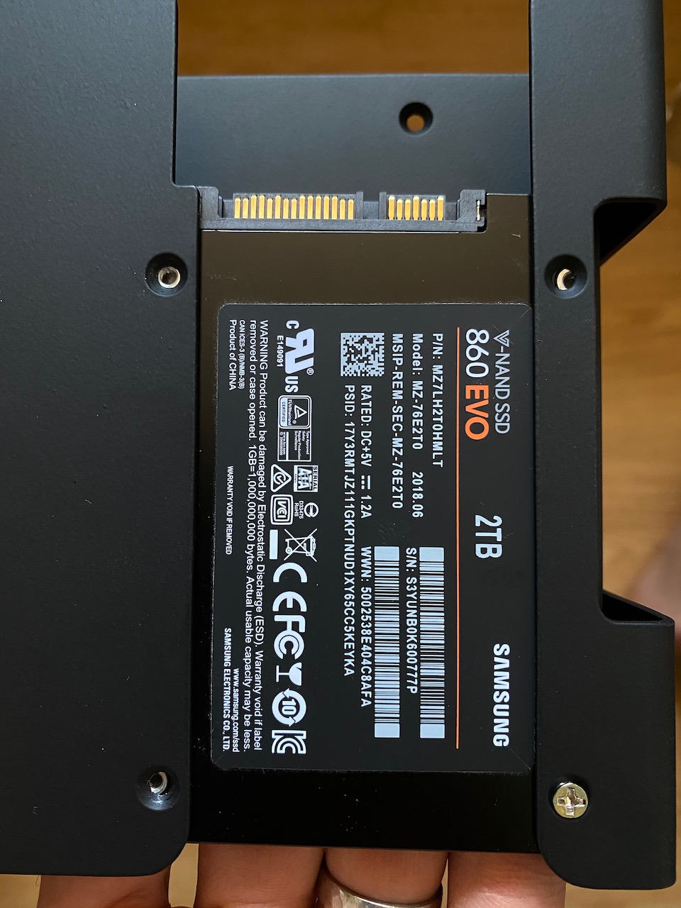

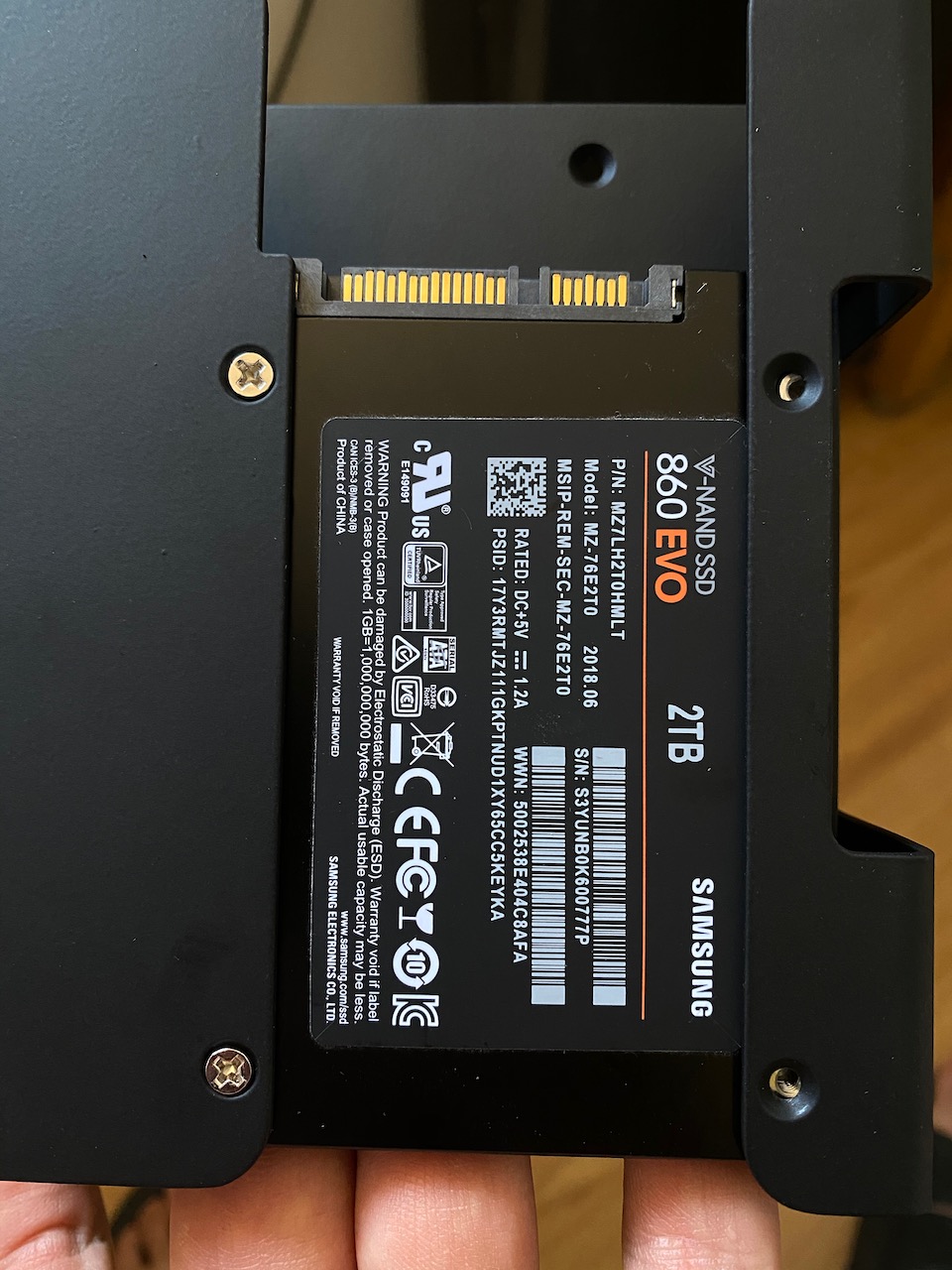

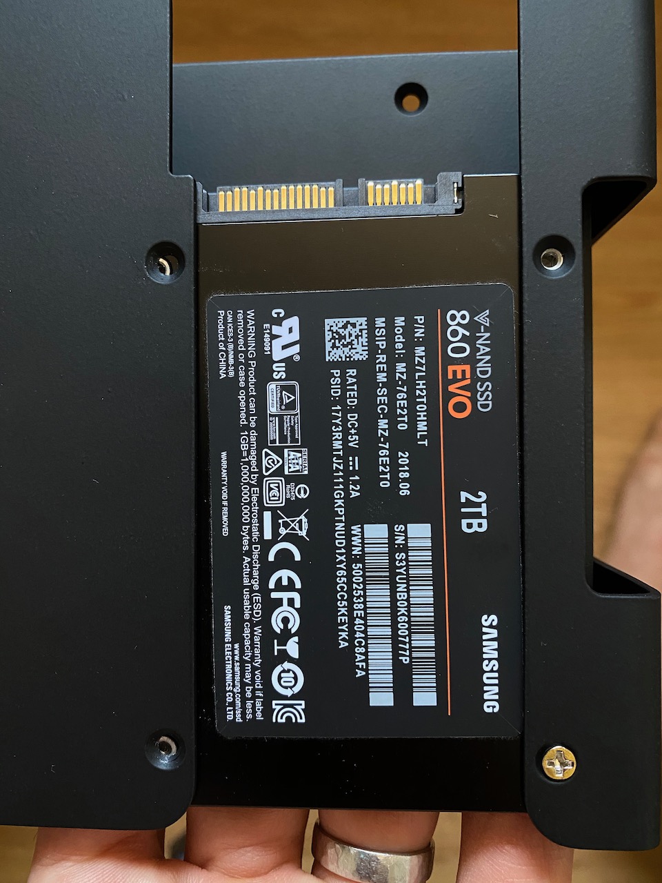

^^^^Mine aligned fine with my Samsung 840 EVO. Did you have the drive mounted in something else before the J3i?
Lou
Yes, I'd been using it in a blue OWC drive sled in my 2012 Mac Pro. I was able to bend and move the J3i to force it to align. Pretty lousy for a $200 piece of sheet metal.
