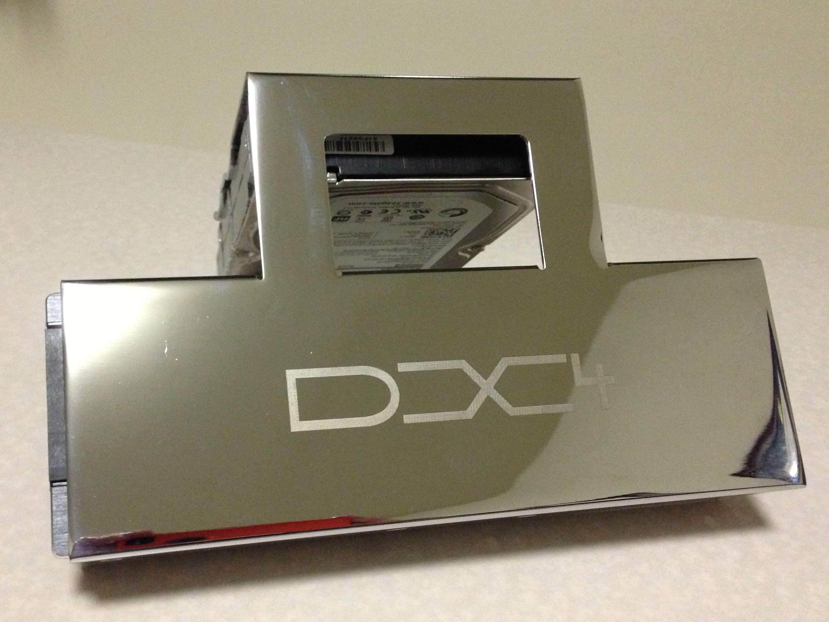

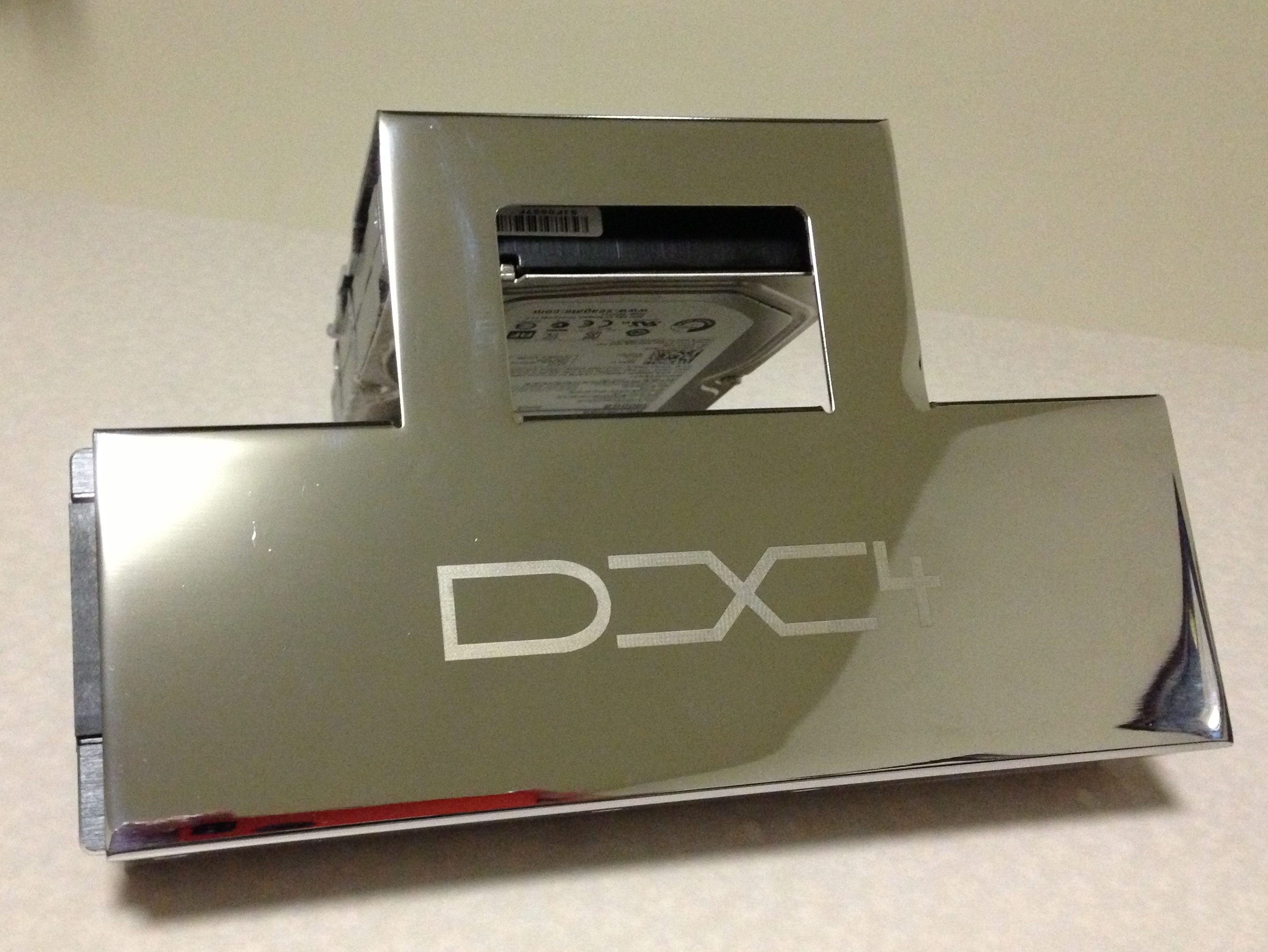

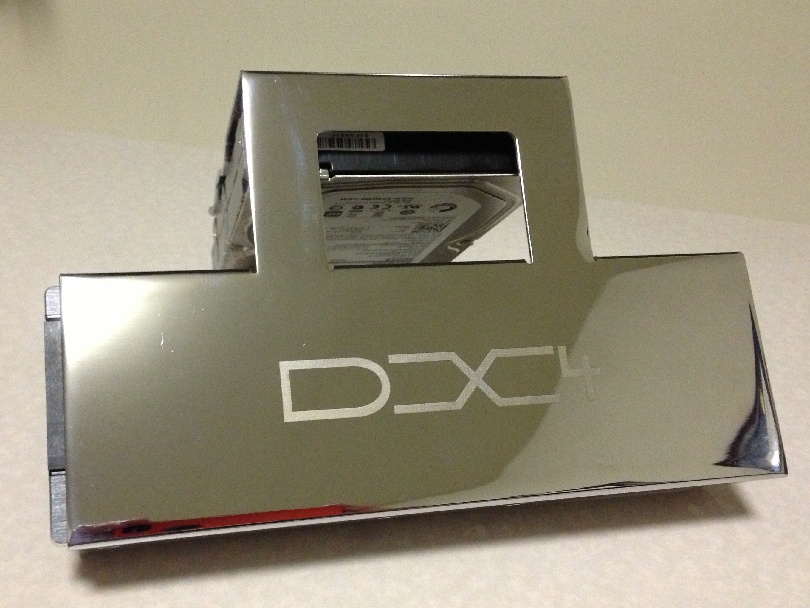

I added a PCI card and rigged two SSDs under the bays and connected them there. I had them in the optical bay drive but added a blu-ray drive. I think I posted this question a long long time ago and added pictures. I have to find that thread to see if there were pictures because I haven't had the mac pro in several years.
EDIT: Found what I had.
I had this http://barefeats.com/hard128.html
It was a sleek way to house SSDs that were connected to a PCIe sata card. I think it was like $120-$130 and not sure if you can get them anymore used somewhere. I had all 4 bays and the two optical drives full so it was one of my only options.
