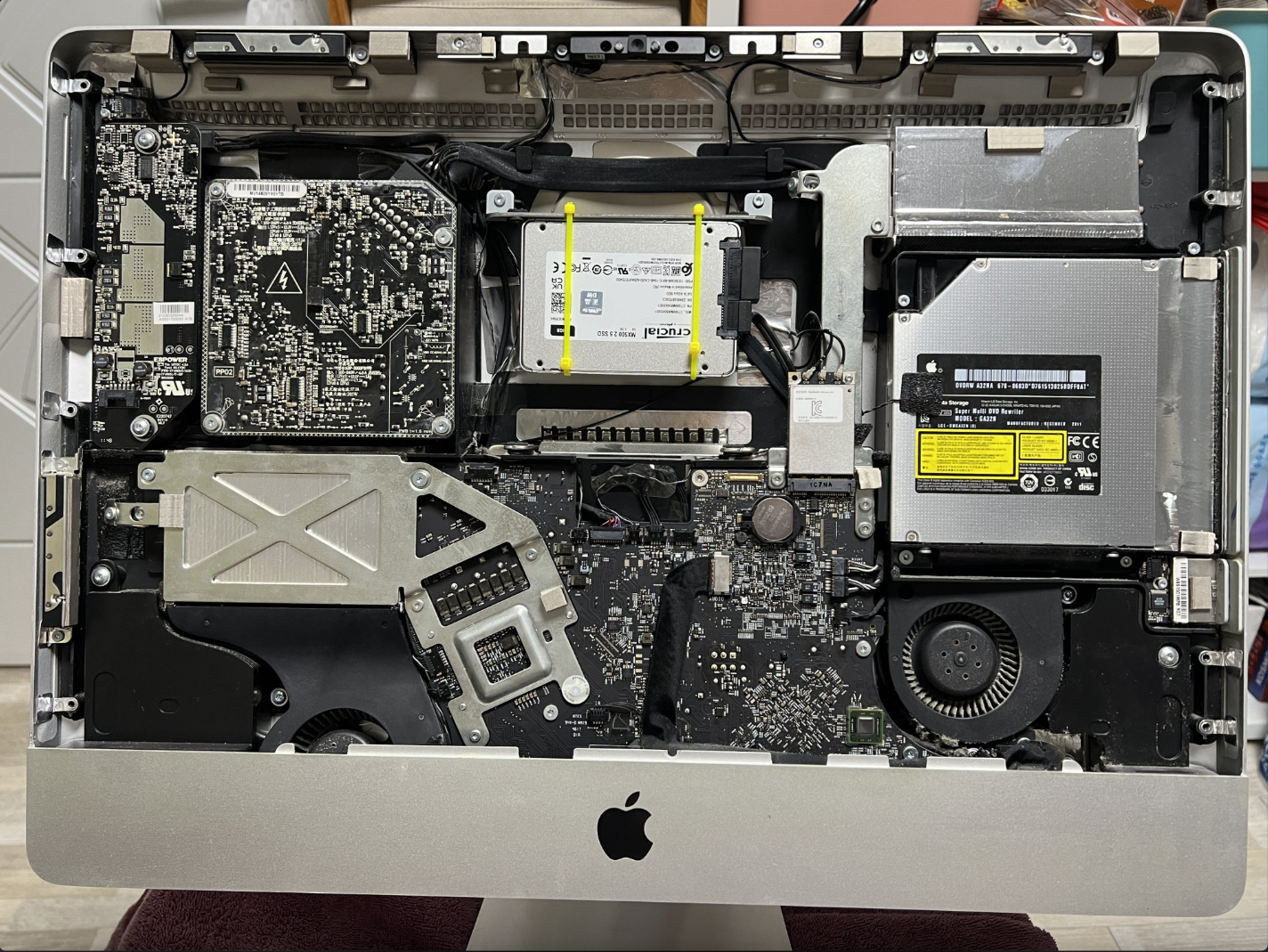

Hello guys,
I just replaced the original HDD with a new SSD last week. There is HDD fan noise caused by the thermal sensor.
I tried a couple of tricks, but they didn't work at all. Besides that everything is fine.
My next plan is to return the original HDD and move the new SSD underneath the optical drive.
I expect to resolve the fan noise issue and have an extra storage space(500GB).
- SSD for booting
- HDD only for data storage
I was wondering if the dual storage system could slow the booting or overall running speed of the iMac.
What do you guys think?
Thanks,
Ryan.

It might boot a slight bit slower depending if initialisation is serial or parallel. Not even really sure there. But shouldn't really be meaningful if you configure the SSD as the first option in the boot order (i.e. default startup disk).
Though the optical disc bay may have a slower SATA connection than the default drive bay - I'd check up on that before doing the hardware swap

OP may have a mid-2011, 21.5-inch -- which does, in fact, have a reserved location for an SATA SSD underneath the optical drive. It does not replace the optical drive, but it will probably need the correct SATA power and data cables, which have dedicated connections on the logic board, near the HHD SATA connections. An SSD has brackets that are easy to find, I think -- but then with the light weight of an SSD, you can probably just tape the SSD in place, without buying those brackets (unless you really need that "neatness" of having all the right parts)

Well, possibly. The A1311 is also 2009 and 2010. Neither of those early A1311's have that reserved space for SSD under the optical drive, only the 2011 A1311. OP mentioned that space, so the 2011 seems likely.
Hopefully, the OP does not have the Late 2011 iMac, which is also an A1311, but is somewhat crippled compared to the Mid 2011. It does, however, also have the reserved SSD space under the optical drive, same as the Mid 2011 A1311.
Finally, it's probably a lot simpler to simply get the HD temp sensor working correctly with the SATA SSD. The SSD slot under the Optical drive would mean adding the SATA cables, which are on the back side of the logic board. The logic board (and some other parts) have to be removed to do that.

Buy an internal DVD player for your imac, even broken, it doesn't matter.
Gently disconnect the temperature sensor from the DVD drive and glue it to your SSD, then connect the connector to the mother board.
With 10 dollars you have solved all your problems by original hardware.
