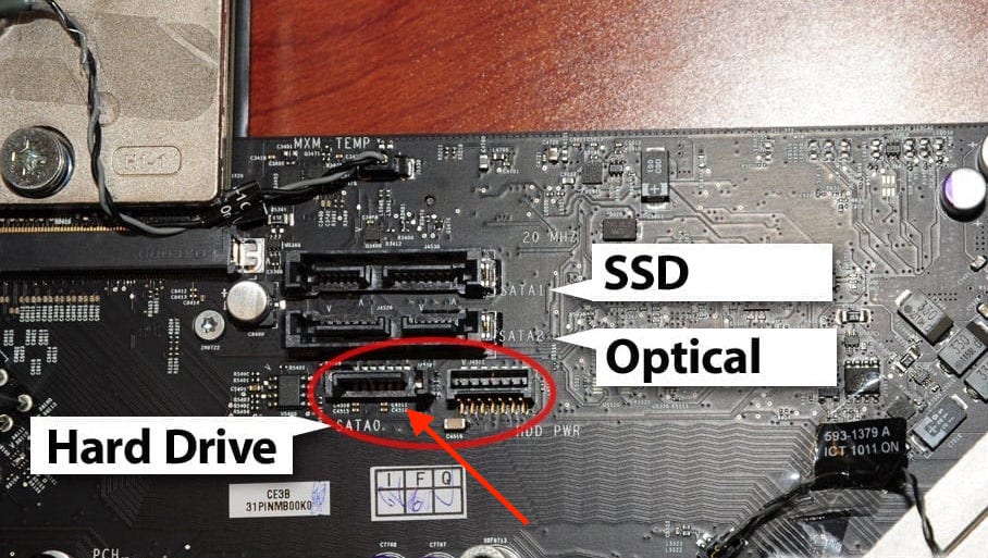

I just wanted to make sure I had this SSD plugged into the right port. Maybe it matters and I don't know it. Currently it is plugged into the port labeled SATA 0 (red arrow pointing at in the image) where the original mechanical hard drive was plugged into. Thats fine right? I don't have to plug it into the SATA 1 port? Image below is from OCW. The DVD drive is currently plugged into SATA 2 and SATA 1 is empty.
The Samsung 860 EVO 1TB has been ordered. This mystery around this drive being spent is driving me nuts, I think I just need to emotionally let it go and keep an eye on the new one. I hate not knowing why something happened - it drives me crazy. ;-)
There are three SATA ports. It's normal to have a spare port if you didn't get it from the factory with a ssd. The spare port can be used to add a second SSD at full speed and place it under the optical drive. The optical drive SATA port is limited to SATA II (3Gbps) so you should only put a SSD where the optical drive is if you want to have 3 internal SSDs.
If you look at the iFixit guide or OWC video they use strong adhesive tape to secure the SSD beneath the optical drive to the iMac case and you have to add a SATA cable to use the port. To get at where to install it you have to remove the optical drive.
By far the easiest thing to do is to leave the spare port unused and optical drive installed and just use the port that the factory hdd used. SSDs are cheap enough these days that one should be sufficient for internal storage.
I've never opened my iMac but it would make logical sense for port 0 to be the one used by the factory hard drive.
