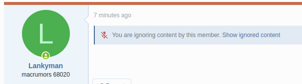

Hi Lankyman,
You must have discourages others too often for me to blok you...

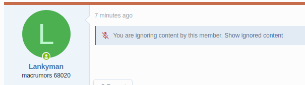

Hi Lankyman,

It’s the first time I’ve discussed doing this so not sure what you mean by discouraged others? The problem isn’t installing the software it’s successfully installing the GPU. Glad it worked out for you though.
