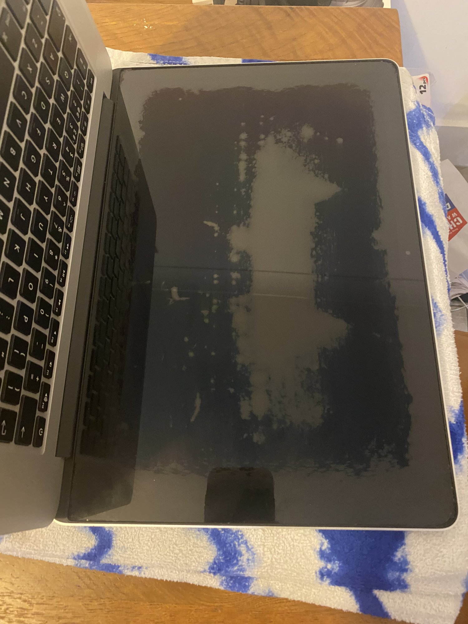

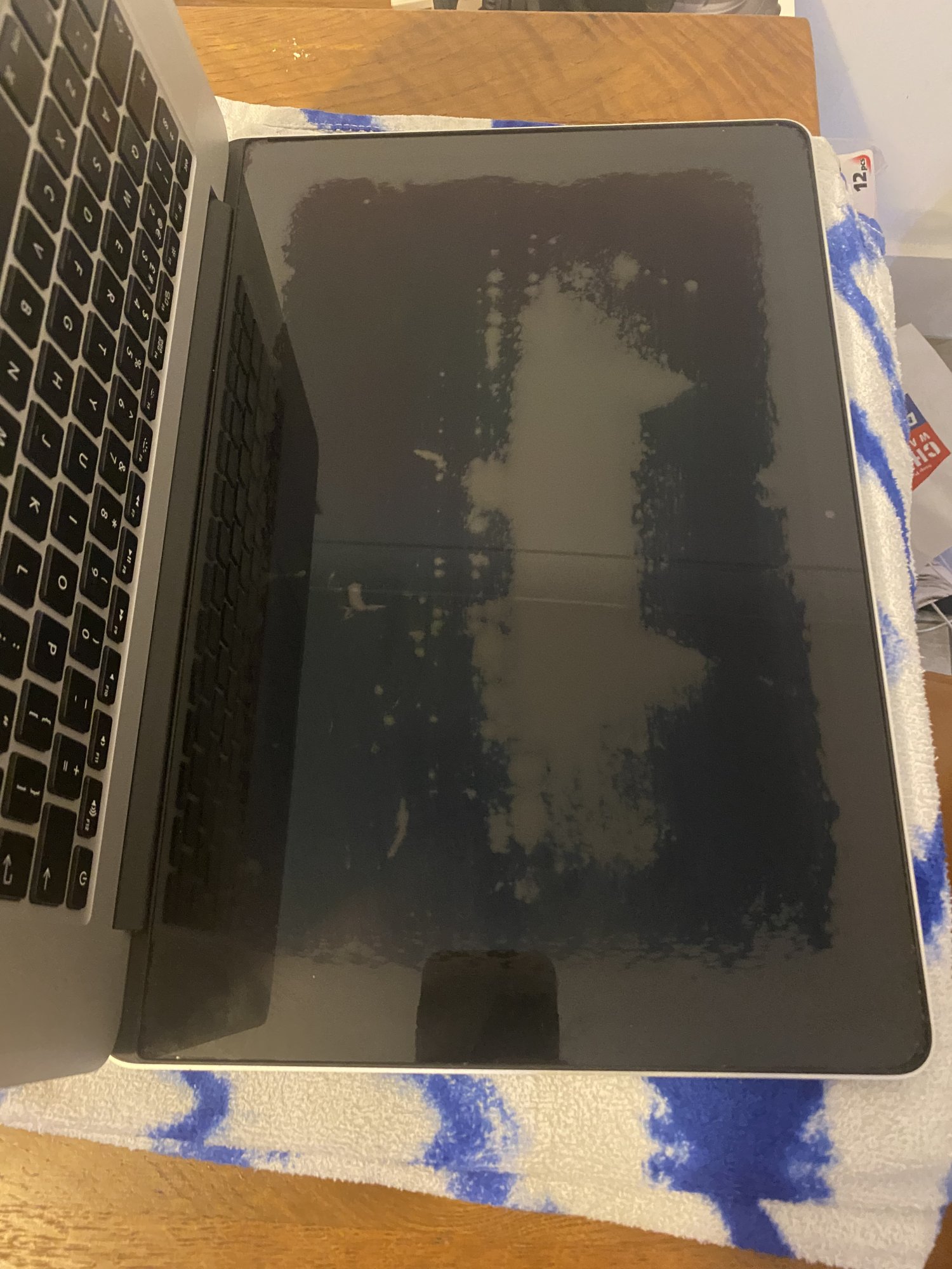

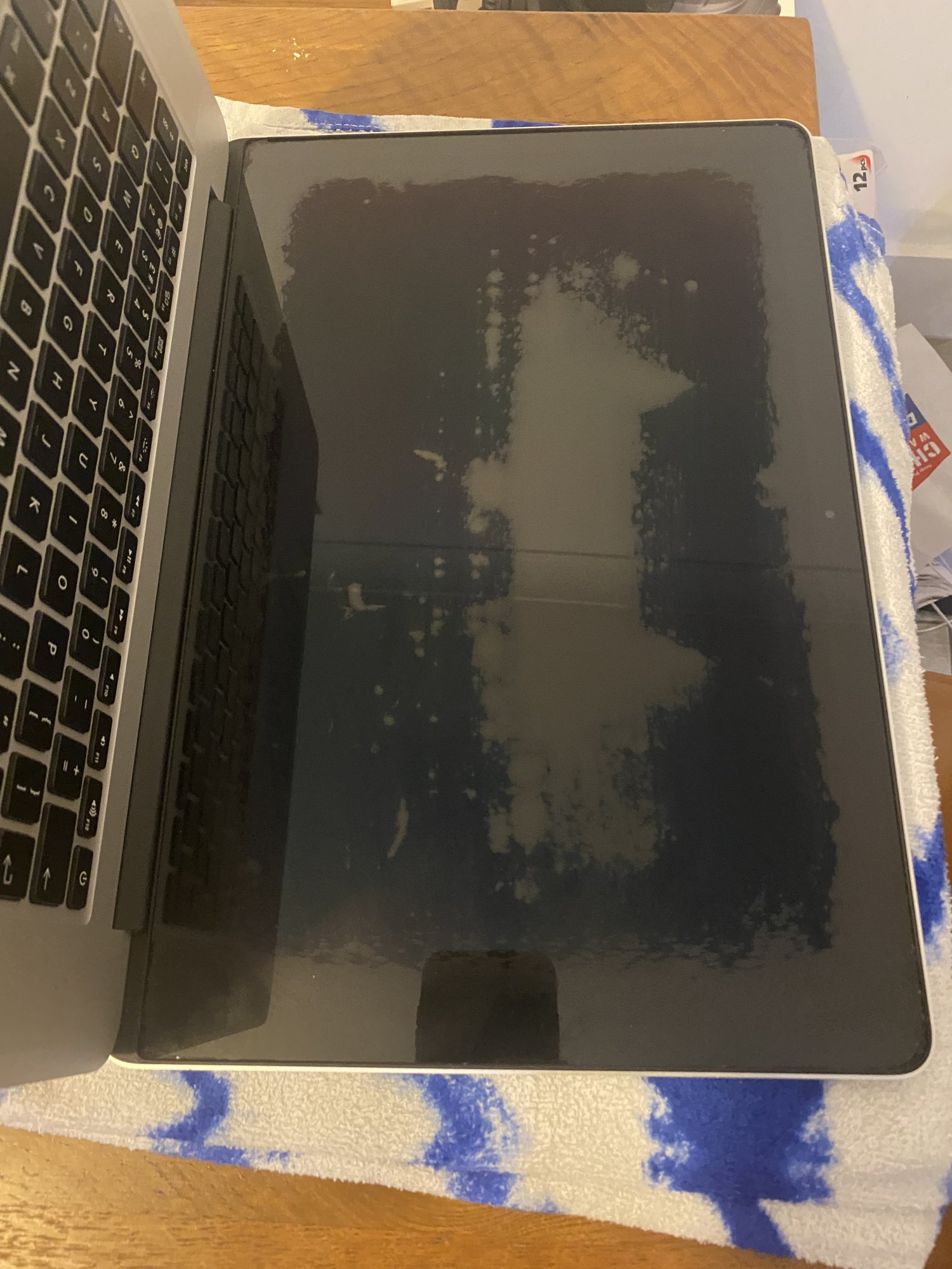

Ok. Have tried everything. Baking soda paste. listerine. w5 wipes. baking soda wipes. white vinegar spray. four hours of elbow grease.
I got most of the edges off. just the middle part. is there any official products that you can buy that will blitz this back into oblivion?

Hi!
Unfortunately, what you are experiencing are stains behind the glass.
It's not possible to remove those.
You frontal glass is clean and have no residues of the damaged coating.
