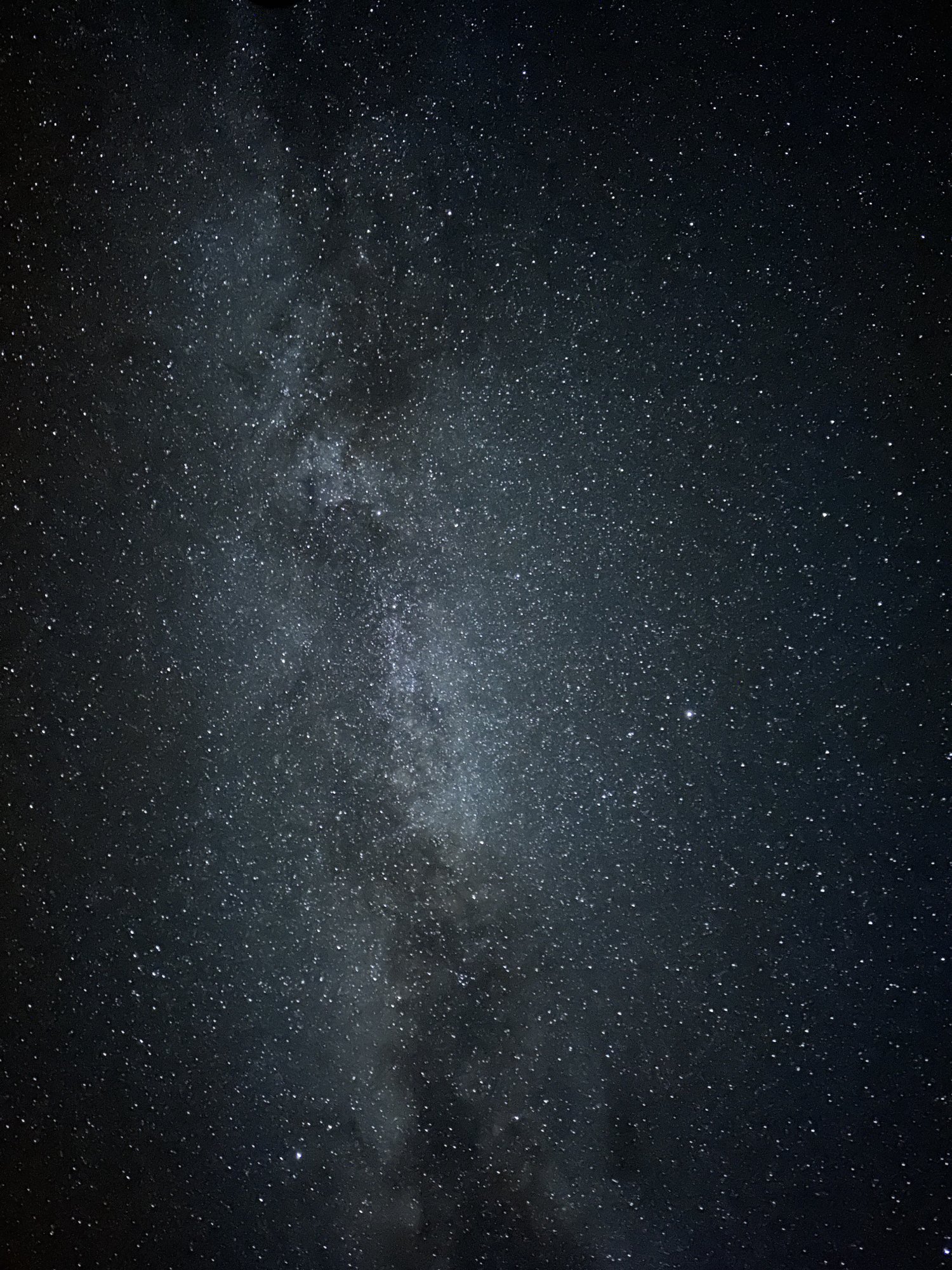

I happened to be near Great Sand Dunes NP a few weeks before upgrading from 14Pro to 15Pro. These shots were with the 14Pro on the cheap pocket tripod I keep in my backpack, and make me extremely excited to retry with the 15Pro and a legit tripod. As an amateur photographer, I'm very impressed big-picture with the fact that you can get photos like these with the everyday phone you carry in your pocket. View attachment 2287880
View attachment 2287881View attachment 2287882View attachment 2287883
Those are great!! The andromeda galaxy looks great. HEIF or ProRAW? Raw looks best as HEIF or JPEG applies too much noise reduction and creates a mushy look. I like the fact that you place foreground objects in the shots… good job.
As the 2 phones use the same sensor for the main camera, the improvement is achieved in software…which, to be honest, is still pretty amazing. A great upgrade.
The only bummer is that Apple could probably have applied the software improvements to the 14 Pro too.
Still, nice to see progress.

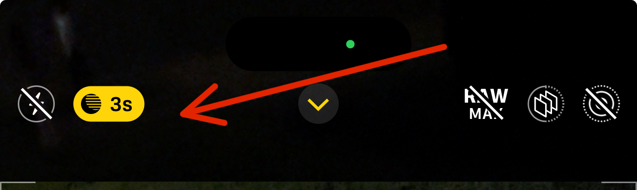

So are you using the stock camera app or a special app. If stock how do you set it to stay open for a set period of time?
Yep stock camera app. Once it’s dark enough and the phone is stabilized, which is key, you can manually adjust the Night Mode from the default 10 secs* (when dark enough, so when I’m doing some night sky shooting) all the way to 30 secs.
*Default Night Mode varies, but under the darkest conditions it’s usually 10 seconds, so you can adjust that out to 30 secs to achieve max exposure.
Yep stock camera app. Once it’s dark enough and the phone is stabilized, which is key, you can manually adjust the Night Mode from the default 10 secs* (when dark enough, so when I’m doing some night sky shooting) all the way to 30 secs. View attachment 2290349
FYI:
The 30” option is only available when the iPhone is on a tripod.

How does it know?
The built in accelerometer can tell when the iPhone is being held or at rest. When in night mode, you’ll see the maximum exposure time switch from 10” to 30” when on a tripod and still. Night mode defaults at 5”, so to obtain the maximum exposure time, the exposure slider (looks like a ruler directly above the shutter button) has to be swiped to the left to achieve maximum exposure time. To better explain…. Watch this short video.
Thanks. So it doesn’t need to be on a tripod, just at rest. That’s what confused me. It also needs to be sufficiently dark, from my tests, otherwise the maximum will be lower.
