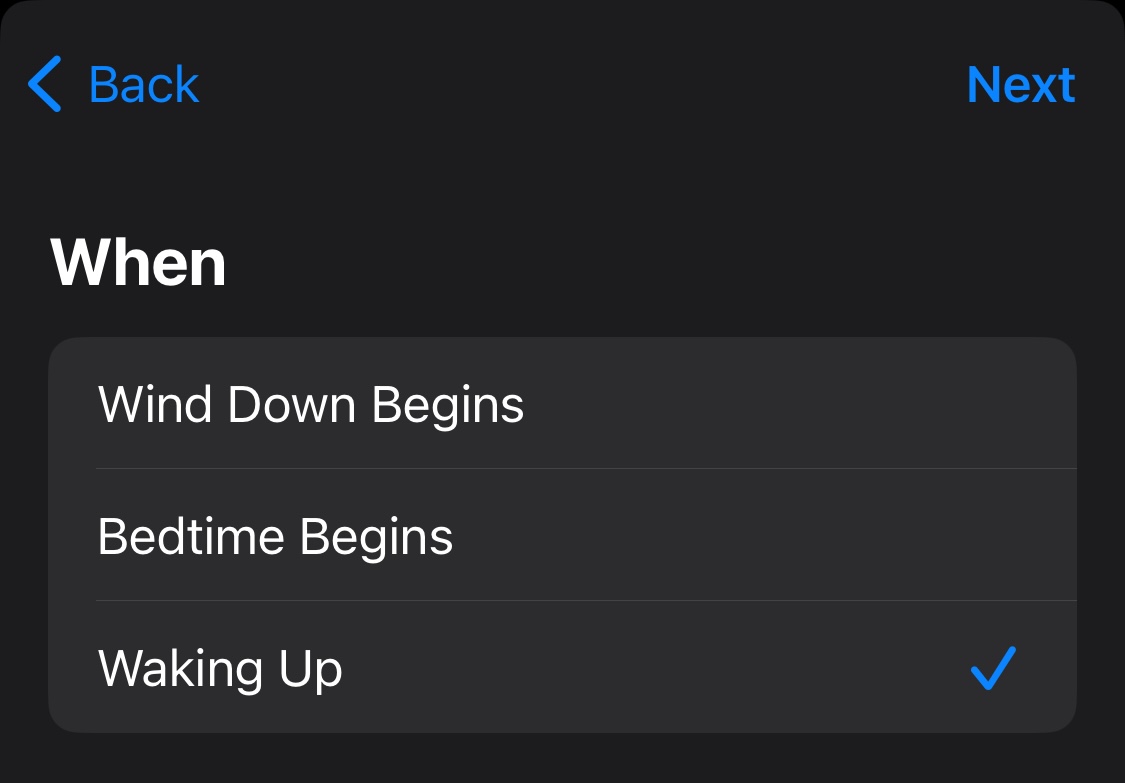

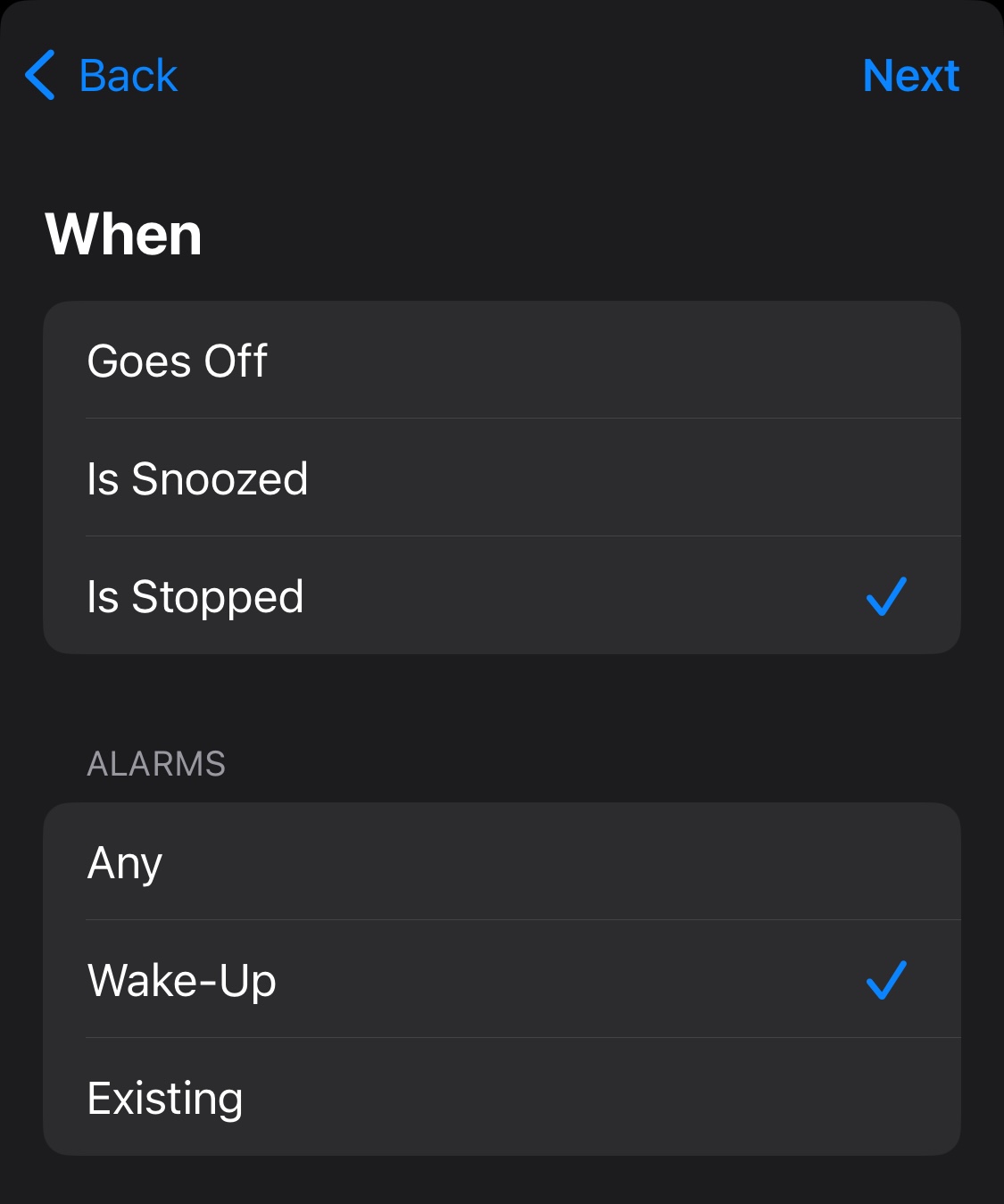

You can do this with Personal Automations in the Shortcuts app. Start creating an automation and you can see all your trigger options. There are a couple that you could potentially use...
Alarm:
Sleep:

That looks good! Would there also be a way to run that automation with a condition that says “when the alarm on my or my wife’s phone goes off, whichever is later?”

You would have to do something creative with multiple automations. For example, both of you could have an automation to check the state of a smart plug (or perhaps a single light bulb) when waking up. If it's off, turn it on; if it's already on, then turn on the lights and open the blinds. The smart plug would keep track if someone already woke up in order to know if it should do the other stuff. Of course this wouldn't work if one of you were away from home though.
Otherwise, there are other options that are slightly less automated, but simpler. Could stick an NFC sticker (or AirTag) by your nightstand or door. Tap that with your phone(s) to run an automation associated with that tag. Or get a physical button/switch to run an automation/scene.
