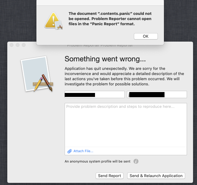

The "blinking" I experience is not a big inconvenience, just wonder if it indicates another issue. The black/blinking screens only take 2-3 seconds usually (like it is loading ColorSync custom profiles, etc.). My big issue is the computer logging out 1-2 times a day while I am trying to work usually; however, last night I experienced my first auto-logout during "sleep" apparently. When I tried to wake up the machine this morning, I got the login screen followed by the warning dialog again...
Ok, so you are using DisplayPort. If they only blank once then it sounds like it isn't the HDCP issues I've described. Unfortunately USB-C (Thunderbolt 3) and DisplayPort connections can take a while to negotiate I think. (I've looked for DisplayPort EDID copiers, but they seem to be quite rare, plus I don't have experience with them so don't know if they'd help.). As for logging out and your screen shot, you've got applications crashing. There are so many reasons that can happen that you'll have to step through the debug process. Quick question: Do you have any external storage hooked up? If so, do the problems go away when it is removed?
