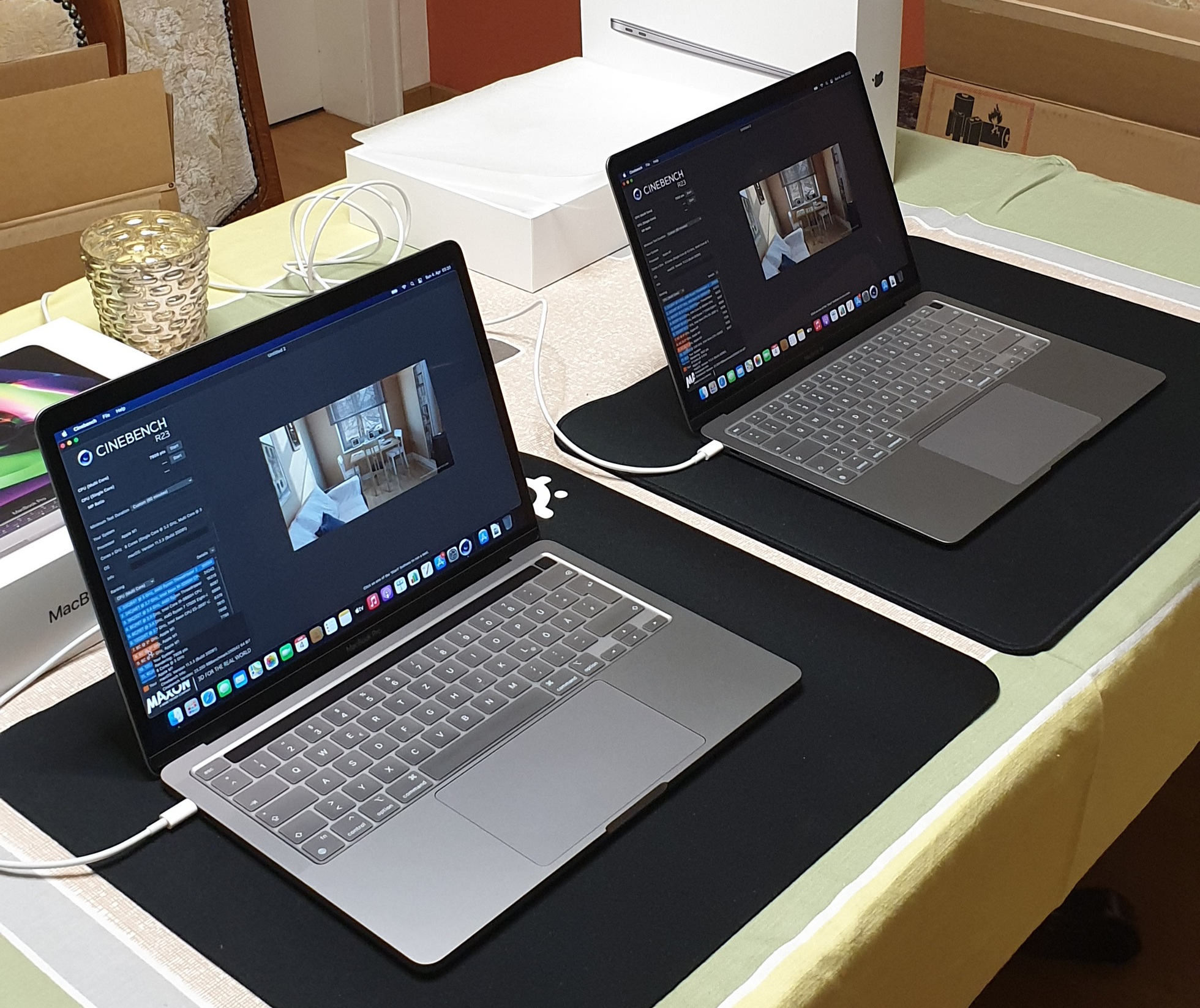

However, I've just tested Cinebench for 1 hour, scores didn't change much, still 7800 and 7200 for the MBA.
I HAVE NO CLUE how the **** they made the M1 Air score 1000 points less (6600) than the Macbook Pro (7800) because when I run Cinebench, it's a completely different score for my Air (Do you think I have a better binning?), going in at 7200 points.
When I saw reviewers score about 6600 with the Air on the 30 Minutes run, it did made me consider the M1 Pro more strongly, losing about 15% Performance.
But running the test myself, I only lose about 8% performance and just as I expected (I ran both in battery mode), the Air had more battery left than the Pro because the Pro runs the CPU at 25 watts, where the Air was at 67% after 1 hour of Cinebench R23 stresstest and the Pro at 62%.

So basically, running Cinebench is the best 100% CPU pure performance test which you can run.
On the first run, here are the results:
MBP: 7815
MBA: 7212
That's a 8% performance difference after 1 hour of Cinebench.
This was followed 2 Minutes after it had stopped by one another 1 hour run (2 in total then) with the following results.
MBP: 7805
MBA: 7034
That's about 10% and you gotta remember, the MBA is fanless and the Pro runs the fans at 4000 RPM, which is noticably audible.
But I want the 10% 😭 I guess nobody can help me, personal choice. But I think just based on pure reason, I should go for the Air. On full load 100% CPU usage, the Air has a better battery life.
And since nobody would believe me, here I am, testing them against each other side by side at 3 AM:
They have a key cover on them from EeeCoo, I can eat my Pizza and don't worry about prints. One of them has to leave my house by Tuesday though 😭
Reason tells me get the Air and anything else the Pro.
However, I would've chosen the Pro over the Air if I had scored 6600 points versus 7800 but after 2 hours of Cinebench, which is super unrealistic and hefty, the difference is 10% (7034 points versus 7805, maybe I have cought a well binned chip) and during a more reasonable hefty usage of 1 hour, the difference is 8% and the Air has even more battery life than the Pro, given that the Pro uses 25 watts under full load vs the Air max 15 Watts.

How if you test again and check their temp with this app.
Have you found any appreciable difference between the two in screen quality or keyboard quality?
Screen quality is the same and not a deciding factor for me, the higher brightness is never used. I even turn town the Air's brightness.
Reactions: Wizec
I did, during lower loads the Pro is obviously cooler but when they are stressed, they are equal in temps. The Pro is slightly lower, 2-3 degrees on the cores individually but it doesn't affect responsiveness or anything and you can hear the fan running at 4000 rpm.
But on the other hand, due to the passive cooling design, the battery is actually cooler on the Air before the fans engage...
There are points on the Air that are generally cooler versus the Pro so there is nothing gained between them on the cooling side.
Yes during heavy load it is about 3 degrees cooler than the Air but you hear it obviously and it doesn't hurt stability.
I've used Seinsai or whatever it is called to monitor the temps and I couldn't see an actual advantage over having a fan run at 4000 rpm.
