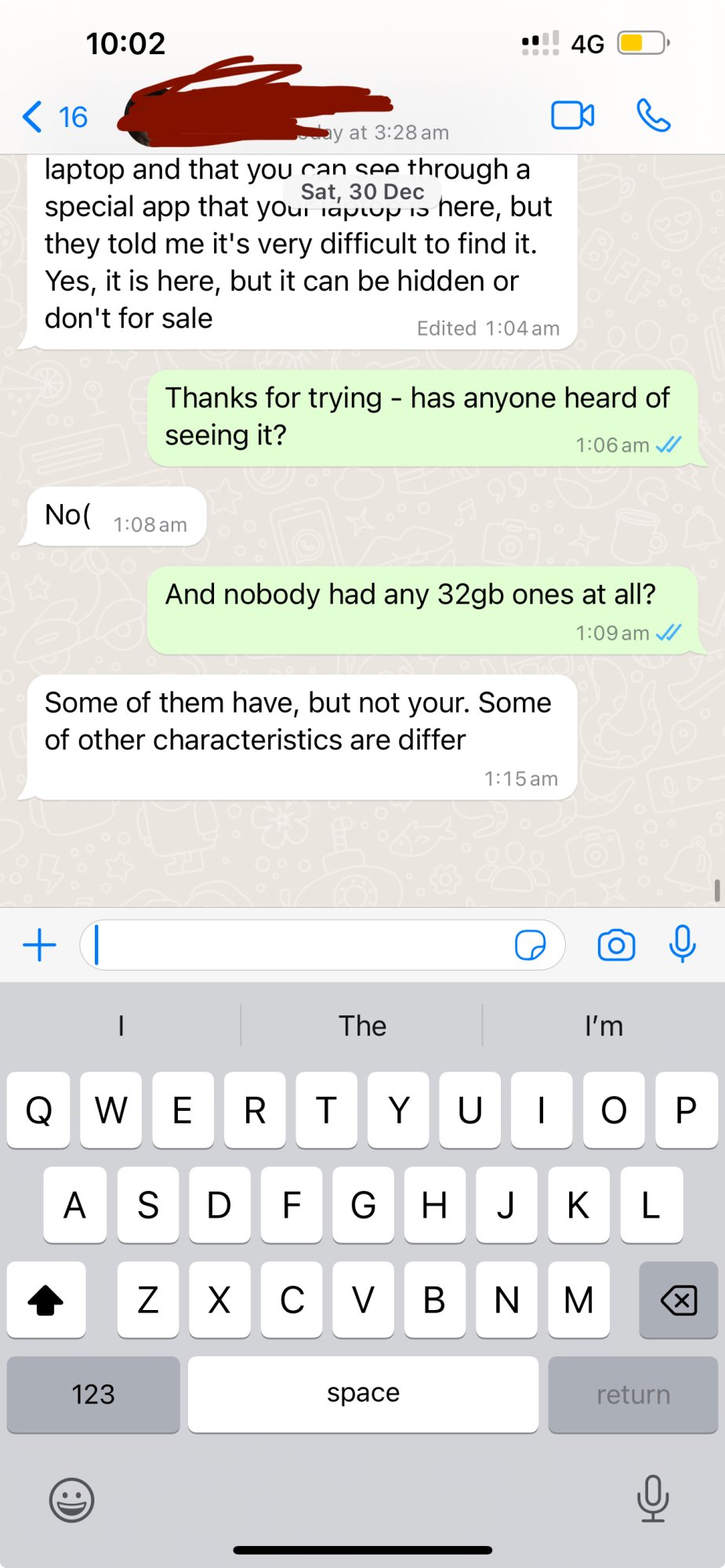

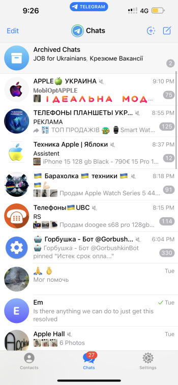

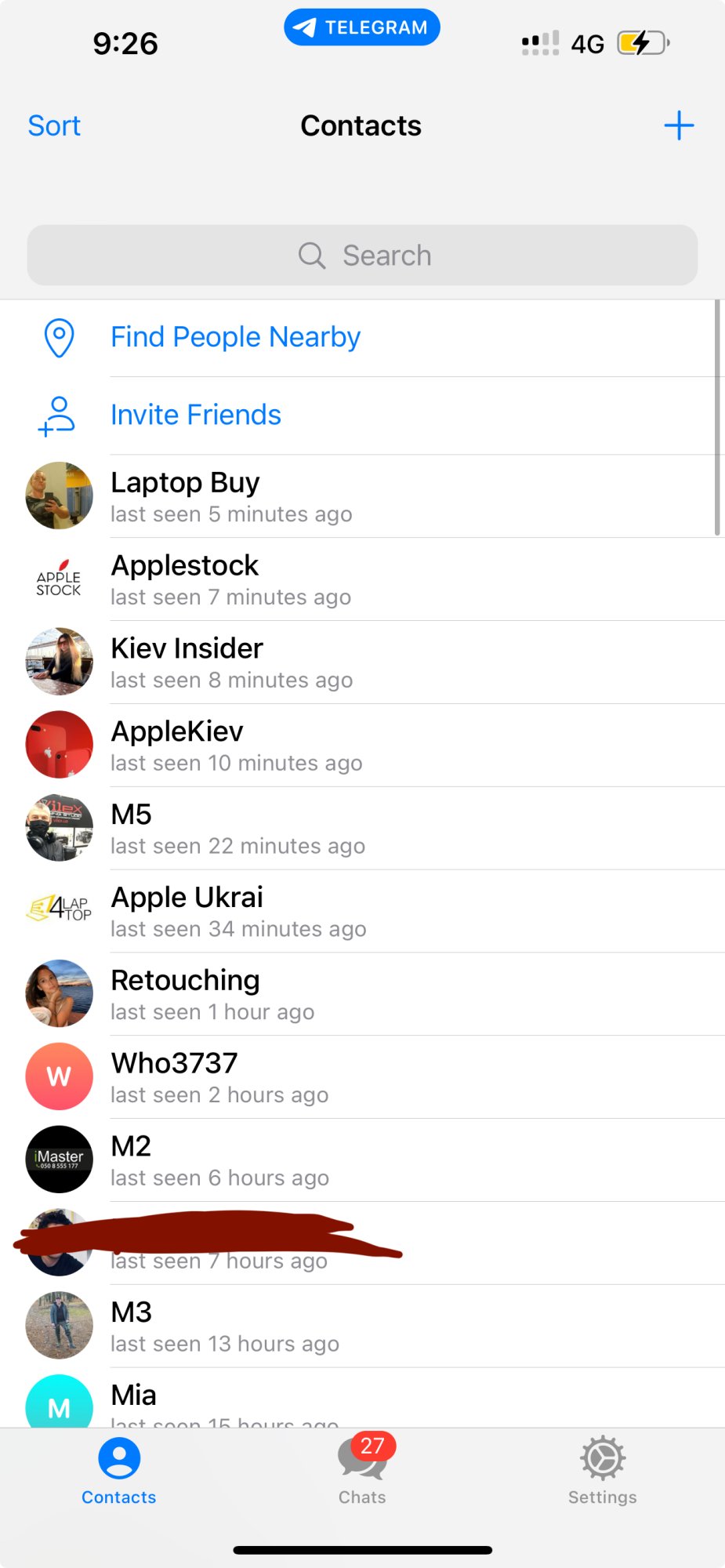

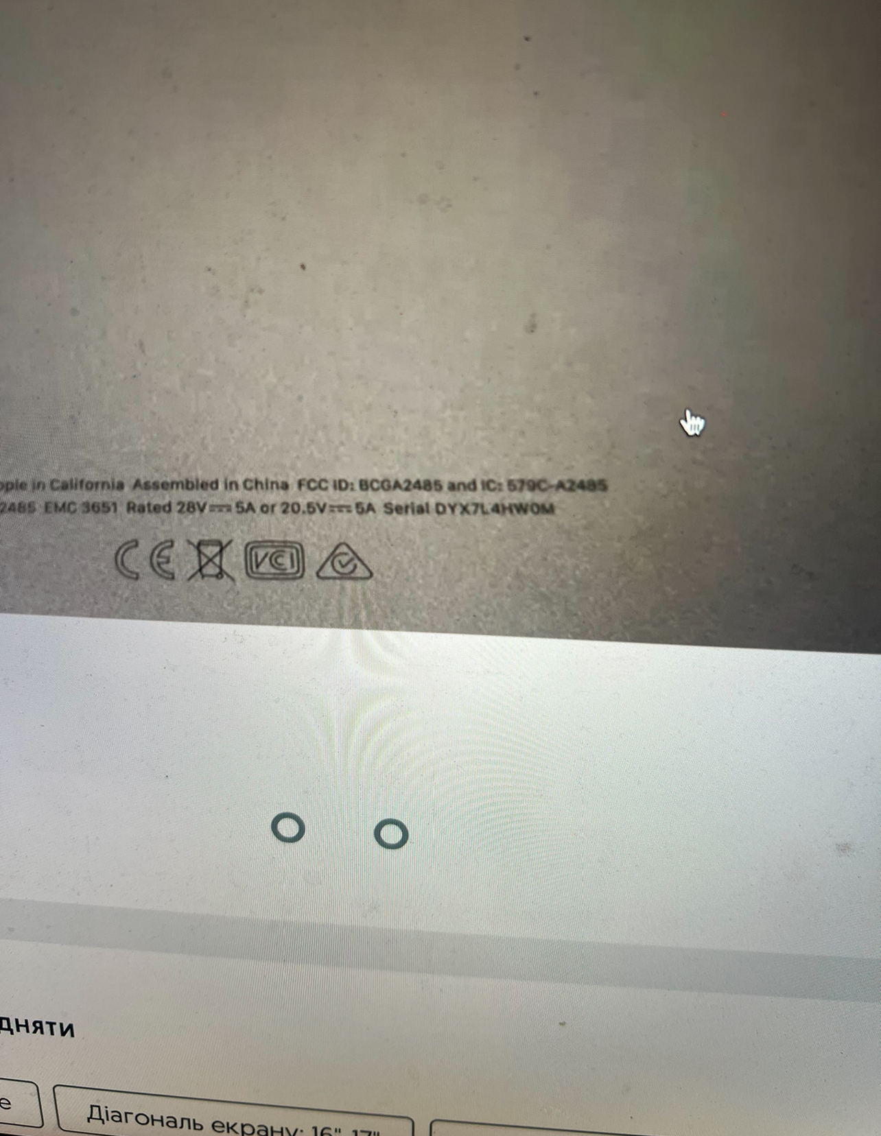

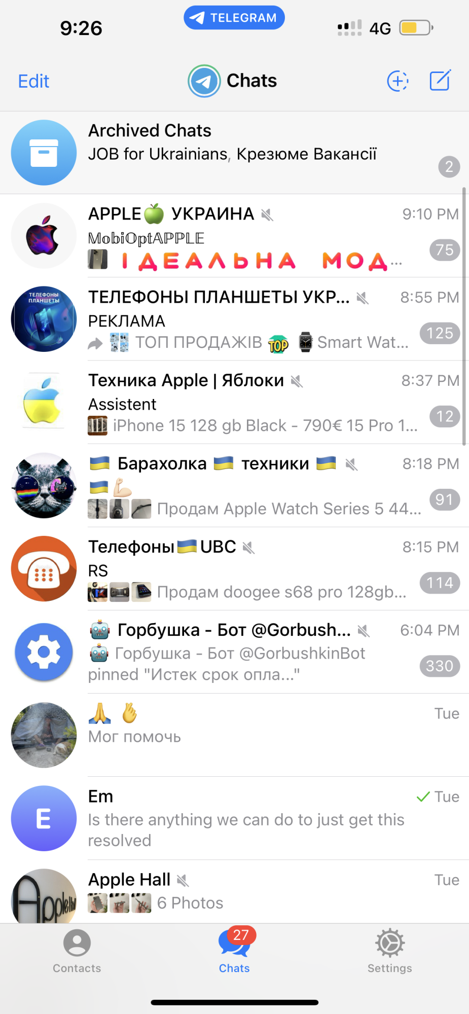

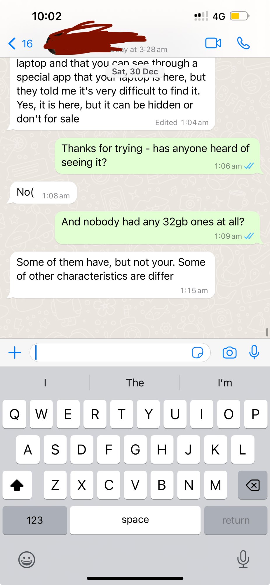

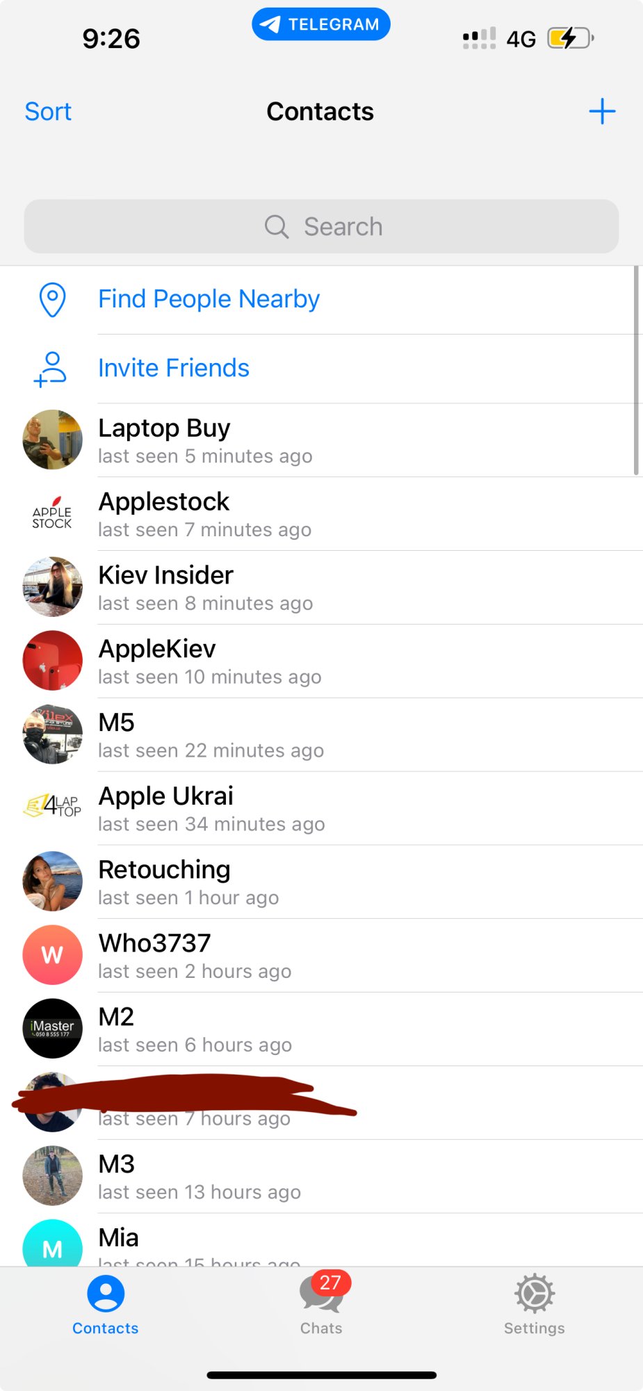

I’m really not sure why anybody would have the time to be making up stories for the sake of it? Not that it matters but just a small trail of the dealings

What is not clear about what I said? I was in Europe for the last 8 weeks working. The laptop was stolen two weeks in, whilst in Copenhagen it randomly showed up on FindMy that pin pointed it to a specific location that was a notorious market. I organised someone to try and buy it back for me there which was unsuccessful as nobody would present it (per screenshots). I did a complete investigation into the market there to understand the platforms of where products are sold, along with eBay etc globally every day - nothing appeared for the last few weeks. During this routine process last week I finally came across a match on the Ukranian platform that matched the serial. So I was able to organise someone to purchase it back for me… Hopefully that is more insightful.
