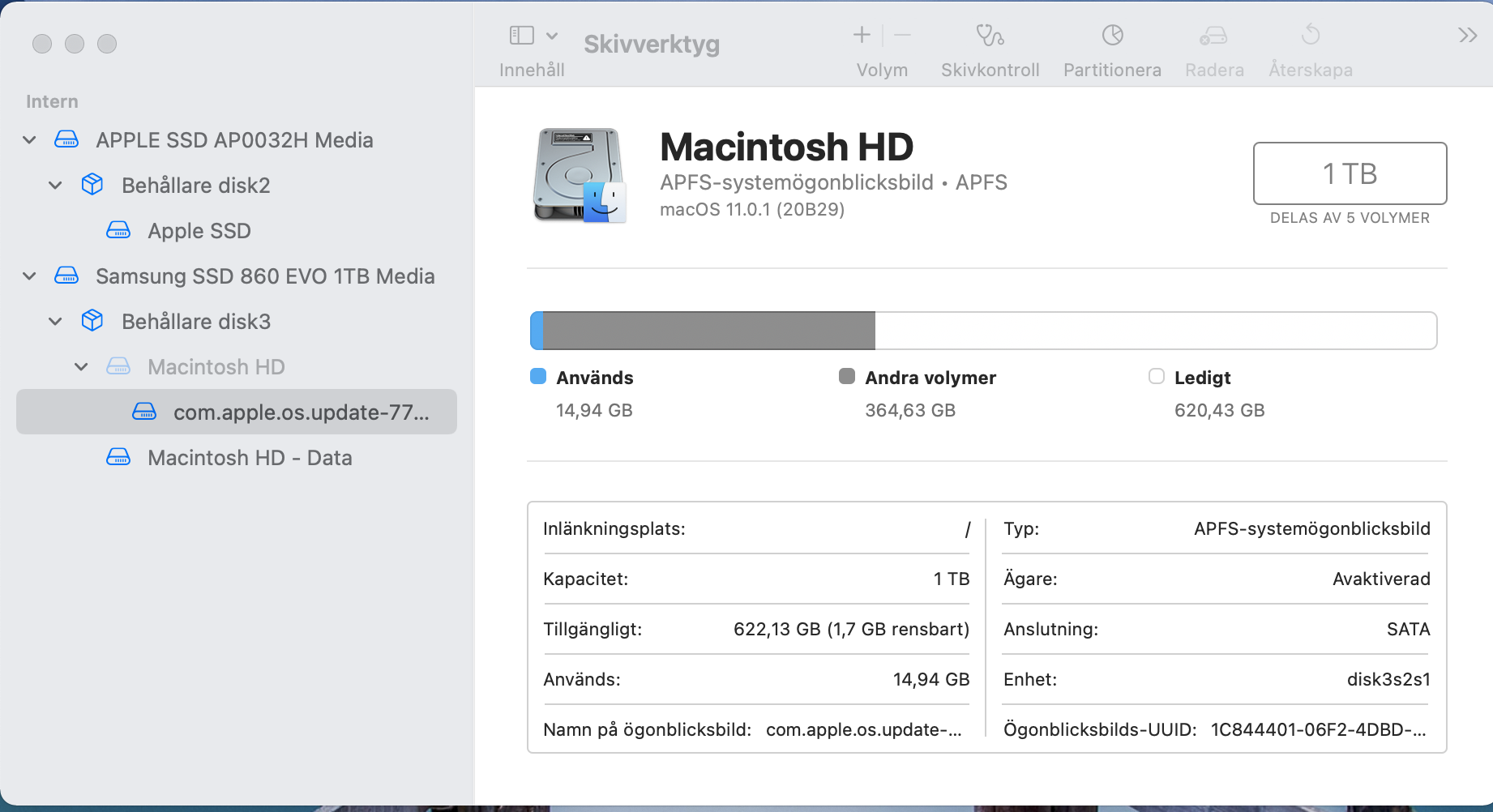

After I had upgraded to MacOS Big Sur in this morning I saw a strange partition in disk utility with a name "com.apple.os.update-77..." , see picture.
Is this a normal partition or is it just me?

I had a similarly named partition but that changed after a couple of boots and a backup to just "Update"

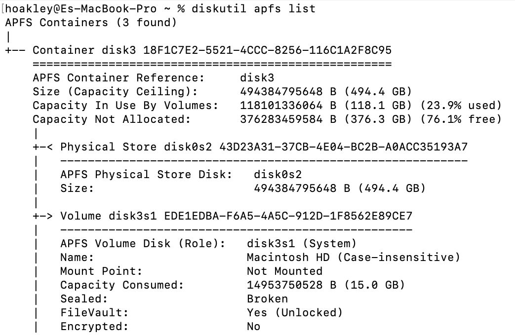

Hi w1z
Thank you for that info, but do you have any official apple info supporting that ? Just curious, and trying to understand what that line means.
Also, how is it possible that my seal is broken on a fresh Big Sur install (again, I used Internet Recovery, deleted « Macintosh HD » and « Macintosh HD - Data » volumes, erased APFS container, recreated an APFS container to reinstall - did I do something wrong ?) ?
Quoting https://eclecticlight.co/2020/06/25/big-surs-signed-system-volume-added-security-protection/
The seal is verified each time your Mac starts up, by the boot loader before the kernel is loaded, and during installation and update of macOS system files. If verification fails, startup is halted and the user prompted to re-install macOS before proceeding.
Do you have Apple Secure Boot disabled? If so, re-enable it and attempt another installation.

I have no warnings during boot and the snapshot the system uses to boot - is - sealed so maybe this is just normal.
csrutil status reports « enabled » and I did not disable it on this setup.
SOS ran from disk utility in recovery on « MacHD » said « the volume /dev/rdisk3s5 appears to be OK. » I’m not too worried, will report back if the first update available can’t be installed.

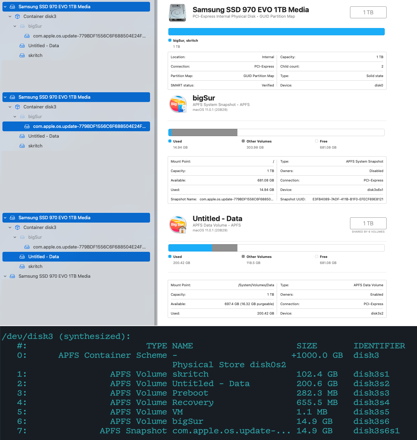

Not sure how all this stuff above computes and relates yet but I also have a very strange arrangement of drives on Big Sur (unsupported Mac Pro) - On my desktop there is an icon named "Big Sur" which seems to all intents and purposes as the HD. But in Terminal DiskUtil and DiskUtility its very weird (see screenshot).
All would have been fine except for some reason I have lost USB on input devices (keyboard / mouse) and if I hard restart my Mac boots into Mojave (on another HD) and Big Sur is nowhere to be found. No option on desktop or Startup Disk. In Disk Utility there was only a single a greyed out volume "disk3s6" that could not be mounted on the SSD that Big Sur was installed on. Only the other APFS volume 'Skritch' appeared properly (and was mounted).
When restarting in Catalina (I have all 3 installed), all seems fine except for no Big Sur. Took a few restarts in Catalina and then suddenly there is the disk "Untitled" mounted - and also appearing in Startup Disk choices, which when chosen and restart booted Big Sur. I have no idea wtf is going on but its certainly a sign of something amiss here!

Something else struck me : the snapshot is marked 'Snapshot sealed : yes' but the original Big Sur 'System' Partition is marked 'Sealed : broken'.
That's normal
Hey Guys and gals, just a quick heads up after 11.1 update, even if we were, I guess, already convinced this was normal, but : everything is fine, the new snapshot is still sealed, and the original volume's seal is still in 'Broken' state.
