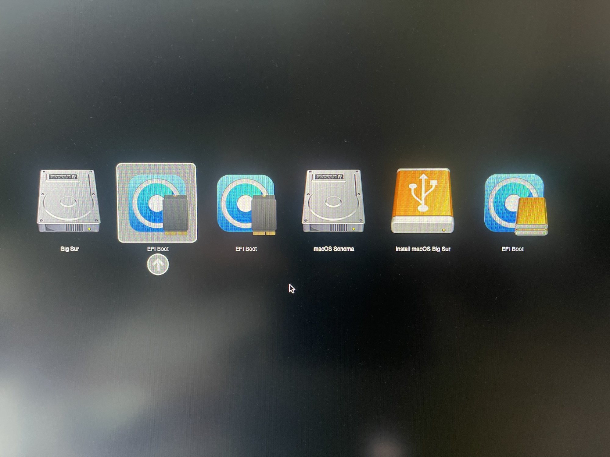

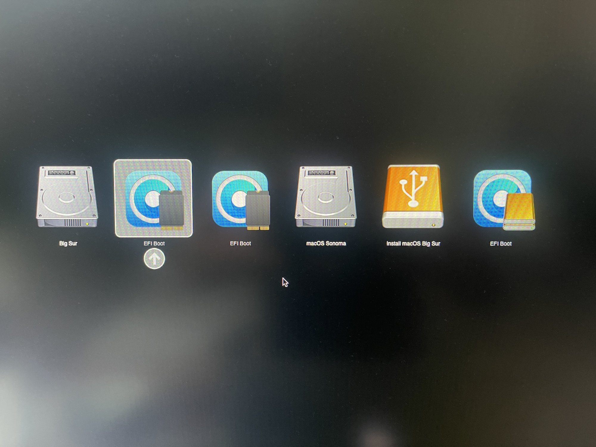

Something else I tried, is to add another internal drive, and install OCLP onto it, but the end result is the same, it is just stuck at loading the EFI Boot.
Just as an illustration, here's a photo of what the problem looks like
