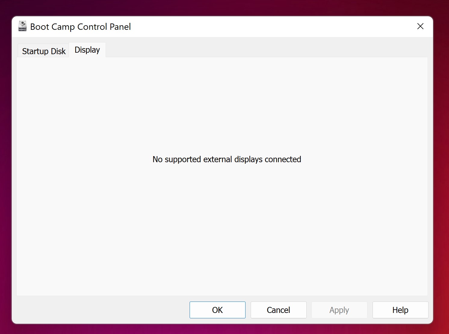

Followed the instructions here, was able to get the brightness (kinda) working for XDR and Studio displays. Here are a few caveats I ran into:
- When connected directly to an Asus Thunderbolt card (looped back to a 4090 via DP), both the Studio and XDR are detected by the BootCamp control panel & brightness is adjustable, but I can't set a resolution above 5K on the XDR.
- When connected directly to the 4090 via a Belkin VR cable, the Studio display is detected by the BootCamp control panel (and brightness is adjustable), but the XDR is not; however, Windows correctly IDs the XDR & the 6K resolution is available.
- When using an AngusPlay USB-C switcher, connected to the Asus Thunderbolt card, the Studio & XDR are detected, but brightness adjustments are disabled. The XDR is again limited to 5K.
- Using the AngusPlay USB-C switcher w/ the Belkin VR cable, connected directly to the 4090, neither the Studio nor XDR are detected in the utility, but Windows correctly IDs both & 6K is still available on the XDR.
Side note 1: I could not get the WJESOG cable, (often mentioned as an alternative to Belkin's), to work under any condition.
Side note 2: When using the AngusPlay USB-C switcher + Belkin VR cable with an eGPU on an Intel Mac (under macOS or Bootcamp), brightness adjustments are also disabled. Taking either the switcher or the VR cable out of the loop restores brightness control.
Conclusion: Ultimately, I gave up on brightness control in Windows. I ended up connecting my 2 Studios to the TB card through AngusPlay switches & the XDR directly to the 4090 via the Belkin VR cable through another AngusPlay switch. The brightness settings carry over, so switching back over to the Mac to change it isn't too terrible.
