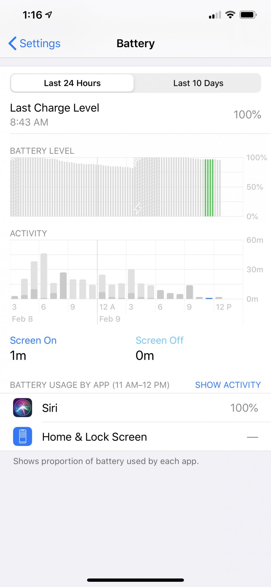

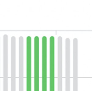

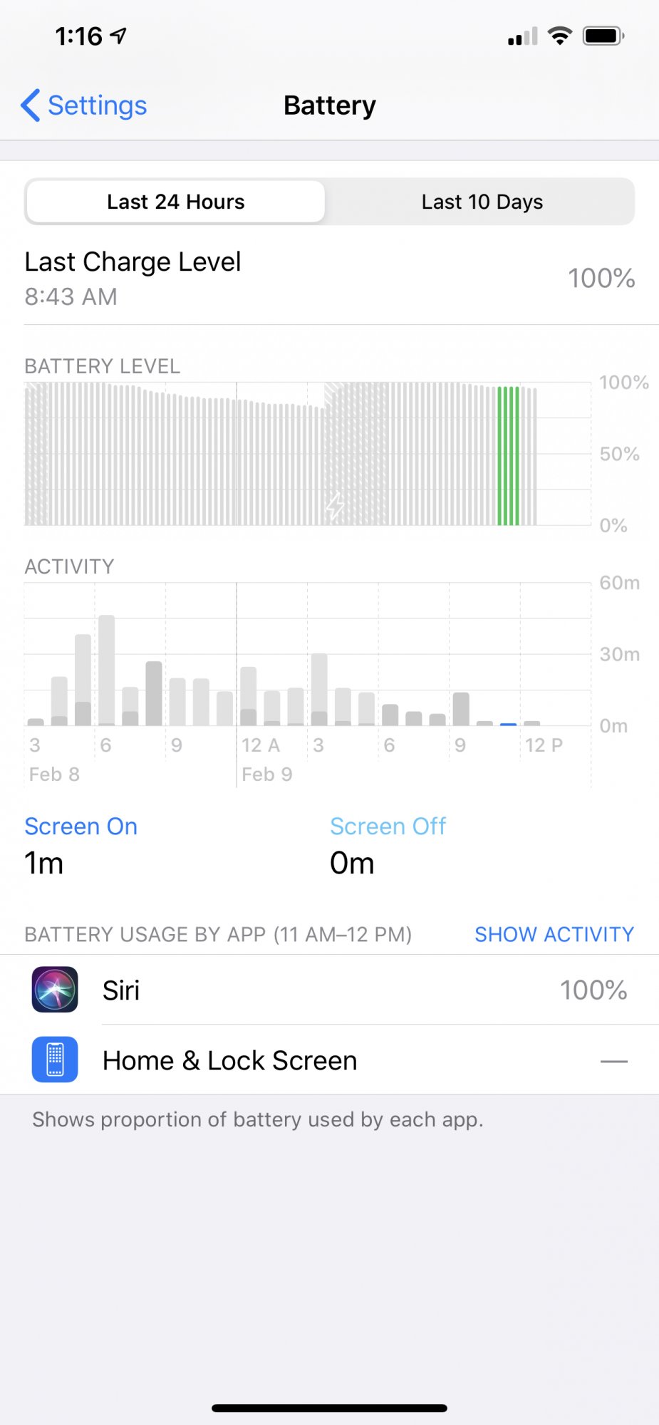

You are misinterpreting the battery data. The percentages are proportions of battery consumption when compared to other apps during that time period. 50% can be a lot but then again 50% can be literally 1 mAh of battery consumption if 100% is 2 mAh. Allow me to demonstrate....

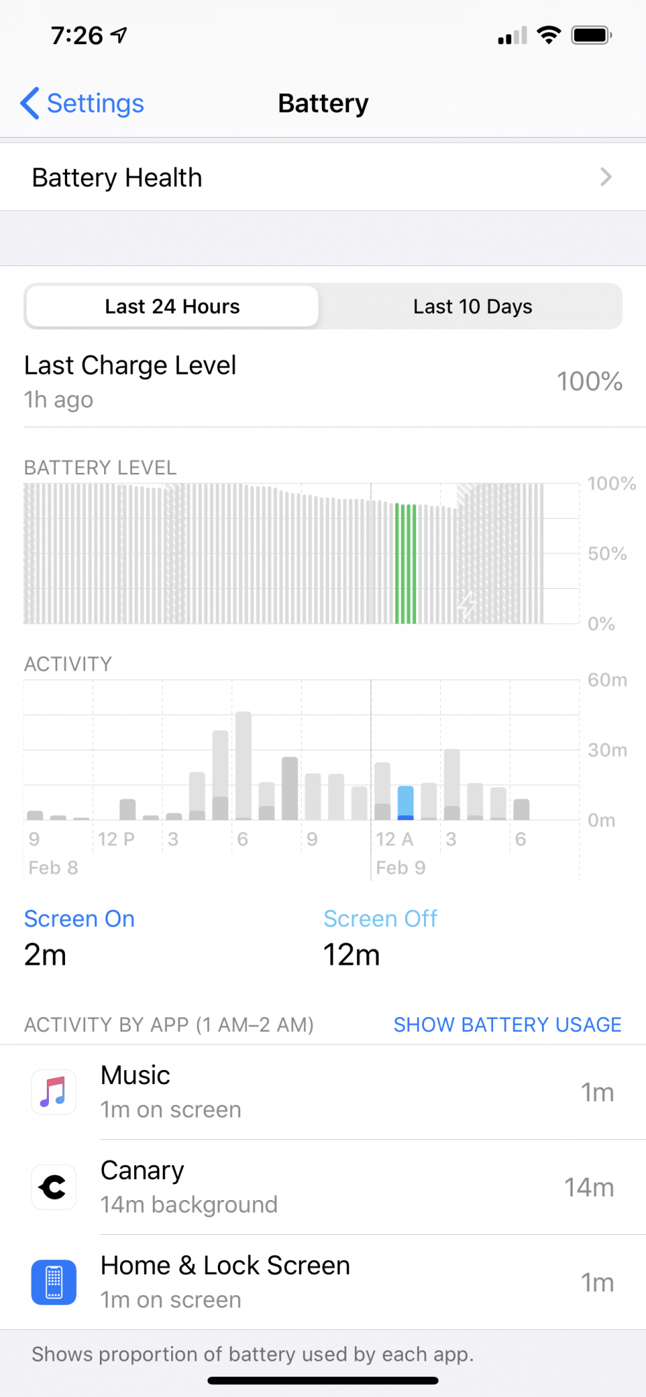

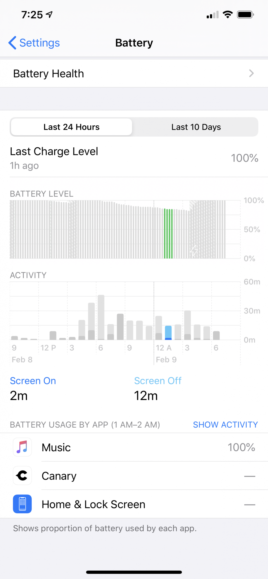

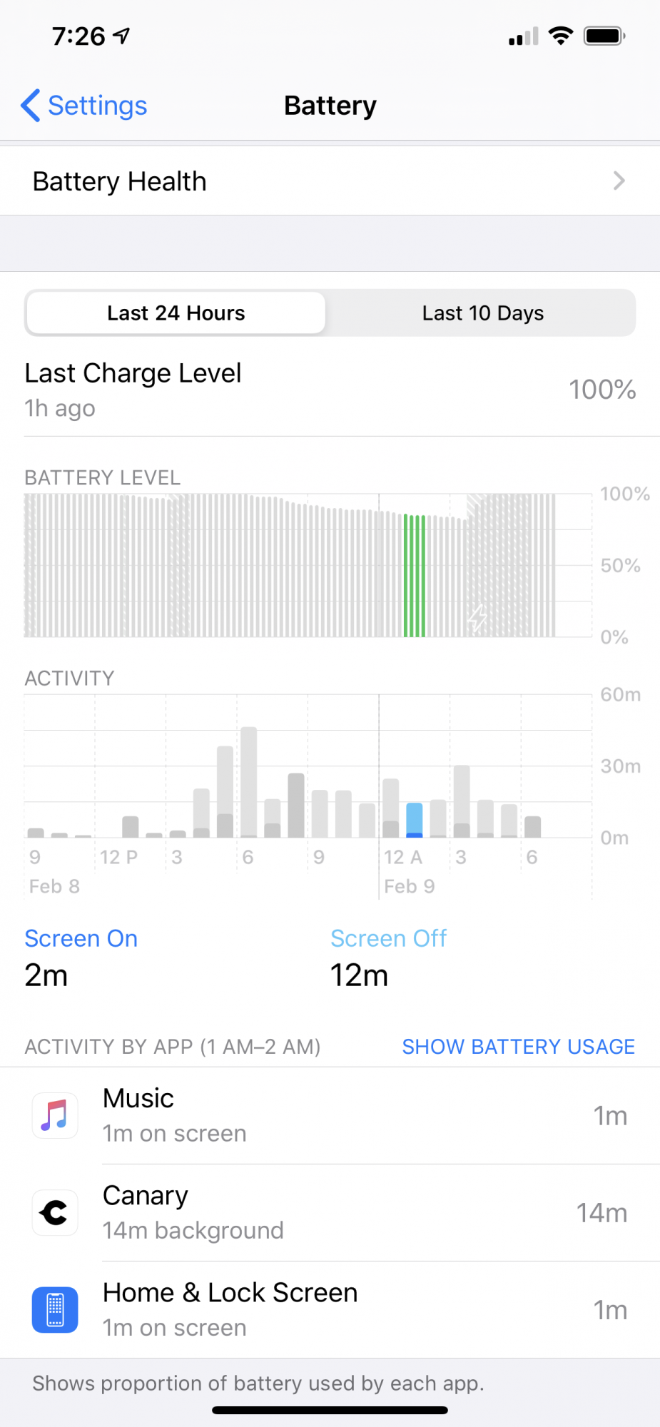

Between 1am and 2am my Music app 100% of my iPhones battery.
Like your Siri usage my Music usage was 1 minute.
Even though Music was 100% of my battery consumption between 1am - 2am the fact I wasn't doing much on my phone mean 100% of nothing is equal to nothing.
Siri did use more than your Golf game and thats common Siri does a lot with Siri suggestions, and its AI usage throughout apps like Safari, Messages, Sharing window, Spotlight, Parked Car using Bluetooth and GPS, etc etc etc.
Your battery drain overall is a fairly linear line as it drops which means Siri wasn't using much more battery then when she isn't being used.
Also consider the time. Even if Siri maxed out every single iPhone resource (CPU, GPU, GPS, BT, LTE, Wifi, etc etc) battery consumption would be negligible if Siri only did that for 1 minute out of your entire charge cycle. But we know Siri isn't maxing everything out and therefore logic should indicate that its impossible to have "substantial battery drain" with a usage time span of 1 minute.

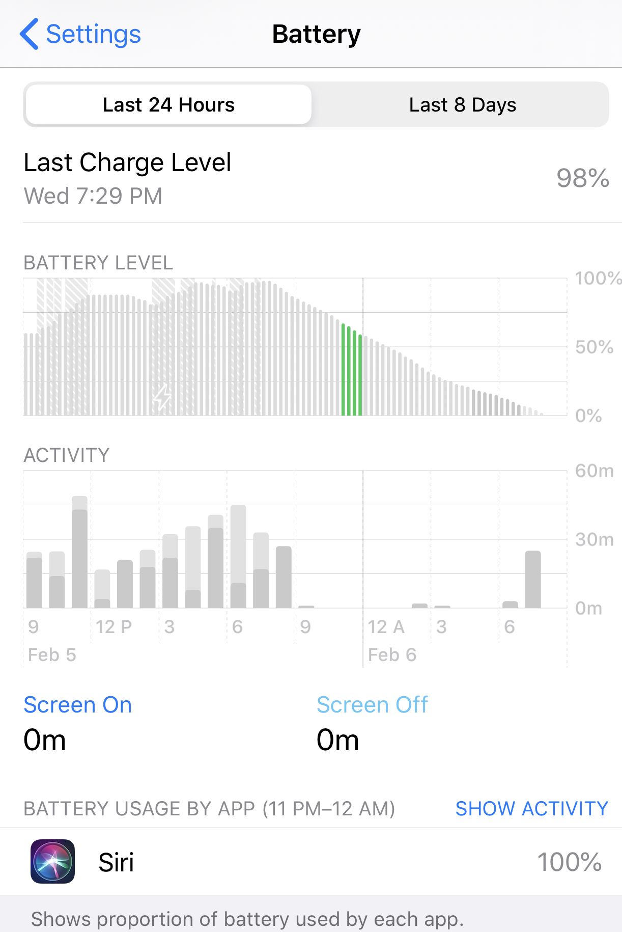

can you explain the rapid battery level decline then? Yours shows a fairly consistent curve whereas my battery usage and other people’s shows a sharp decline and the only “app” responsible for that decline is Siri. If I click every part of that decline throughout the night Siri is the only app that shows up for the usage.

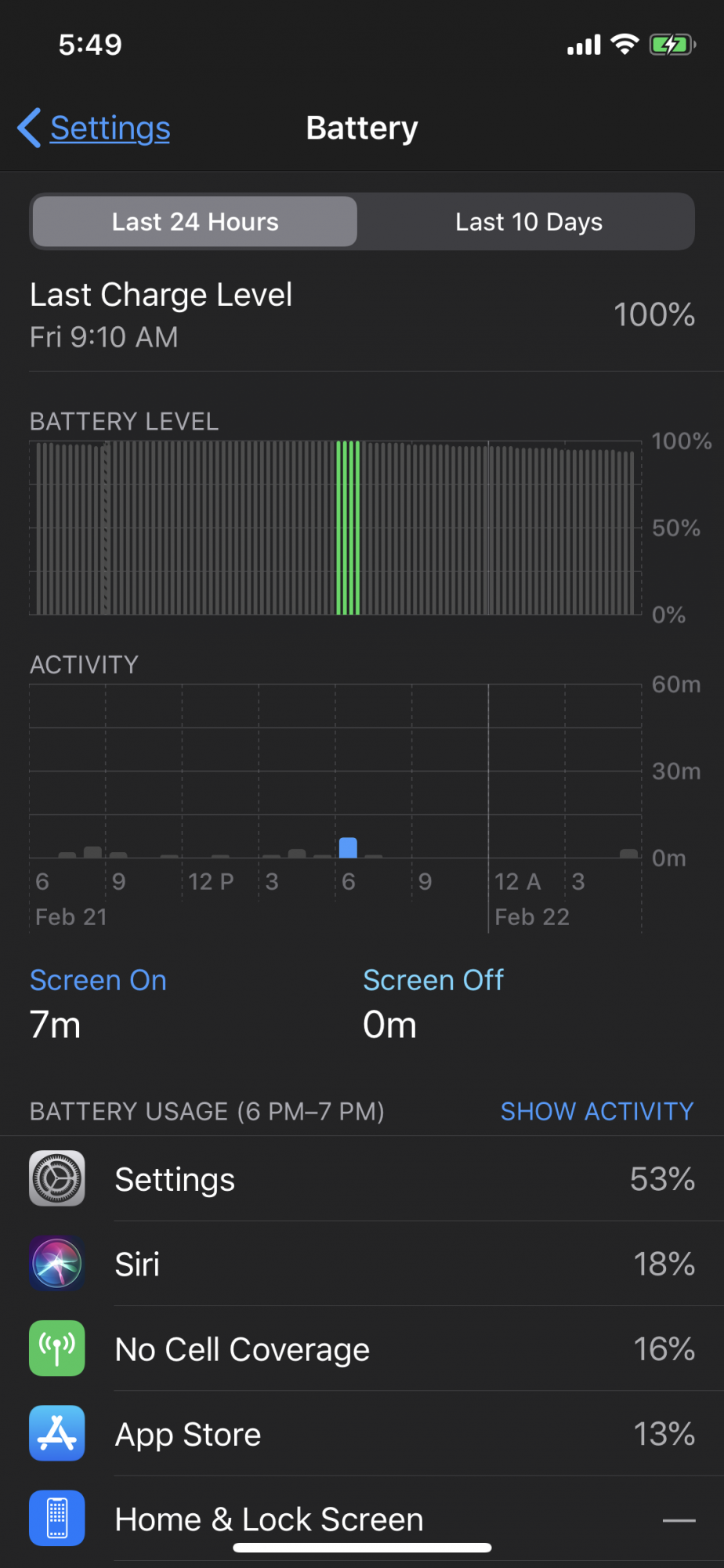

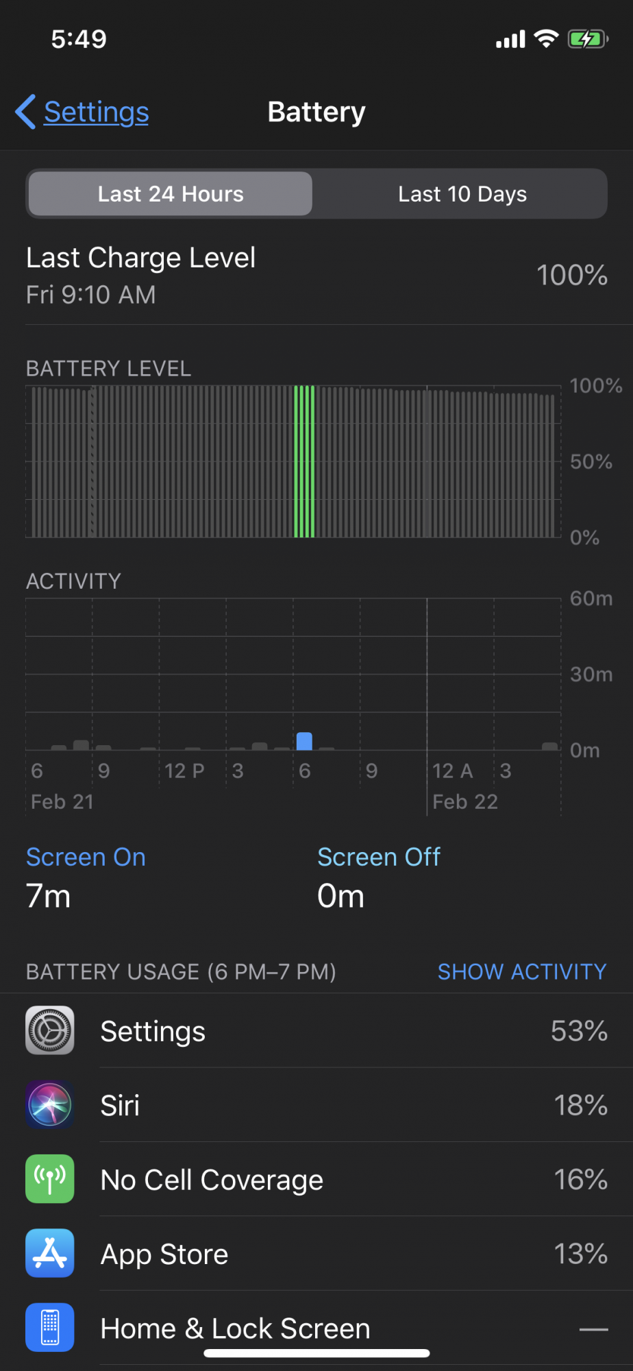

I didn't misinterpret the percentages. I know that it's proportional. But: I think it makes no sense that using Siri for just 1-2 commands + Siri listening for "Hey, Siri" drains the battery more than twice as much in 1 hour than playing an always-online game for 7 minutes.

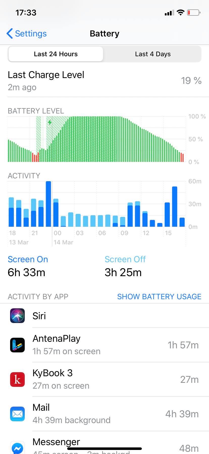

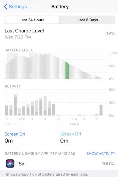

Also if you have a look e. g. at posts #5 and #9 clearly there's something wrong with the Siri battery usage.
I apologize if I came off brash, that wasn't my intent. However we are still looking at the 24 hour and specifically highlighting times with little to no activity for some reason. The is flawed because there is not only no sample size for a measurement but its cherry picking low energy consumption activities specifically.
There is a lot that goes on in the background with Siri. Voice recognition via machine learning through encrypted Apple servers is only scratching the surface. Siri is tracking your location for up to date search info and suggestions, scans thru your email to suggest contact information, when you type into maps and the address pops up with "Found in Messages"...etc etc
I too can cherry pick an hour where Siri was one of the few things or only thing that ran and therefore was the highest.
While Siri had the highest energy consumption during that hour the amount isn't even visible if you look at the battery life percentage during that time.
Those post you pointed out are excellent examples of exactly what I'm trying to convey.
#5 has 1 active process/app in the time span they selected. Exactly what I just did above. Since 1 process out of 1 processes is 100% its not surprising that 1 process is at the top of a list of 1 thing. Battery consumption during that hour is linear which indicates system resources (network connections, iCloud syncing, push notification, NAND garbage collection, etc etc etc).
#9 is the battery usage of someone that started at ~75% 24 hours ago. A side from 3 specific points there has been no measurable activity over that 24 hours. 75% of 24 hours is 18, 24 + 18 = 42 hours its been off the charger approximately. A battery killer/rogue app tends to kill the battery a bit quicker than near 2 days...
Pointing at activity percentages during the times we have little to no user contributed activity will only show you the activity that normally at the bottom. Serious the number two and three battery killer culprits here are Home and Lock Screen and the Settings menu. Lol.
Apple specifically made the battery menu so you can find the culprits that use average of a reasonably sized sample. Click on the 10 day tab if Siri is using battery day and night at unreasonably high levels then Siri will be right at the really near the top of the list under 10 day. However if Siri is <10% of your 10 day battery usage you are certainly looking in the wrong place.
Now I'm not saying there isn't room for optimizations or there isn't an exception and someone is experiencing a bug but I really don't think
Hard to say exactly because of the amount of variables.
The iPhone uses about 60 to 100+ mAh per hour just maintaining its core functions. It could be less than that if you keep your phone in AirPlane mode face down and with minimal apps. It could be a lot higher if you have everything on and have poor network reception.

But as can be seen in the picture the poster's phone battery got significantly drained overnight. That battery curve is not a normal standby battery curve when the phone is left idle overnight. And according to the poster the Siri process was responsible for that (so I assume that Siri is listed with 100% during all of the hours of the night).
But the battery level went from around 75% to almost 0% in less than 24 hours as can be seen in the picture especially overnight and the Siri going rogue issue is perhaps quite spontaneous.

It’s 18% of the battery that was and is still at 100% after that hour. What are you expecting to see?
Siri is a personal assistant and it’s going to show up in the battery. But if you’d completely disabled everything related to Siri including “Learn from this app” for every app individually too then that’s a different thing.
My expectation is quite simple: I don't want that Siri is working in the background if i disabled Siri. Right now Siri is disabled.
And even if I have Siri enabled and restricted to a manual use and do not allow to learn from apps i don't see a reason to pop up and consuming energy.

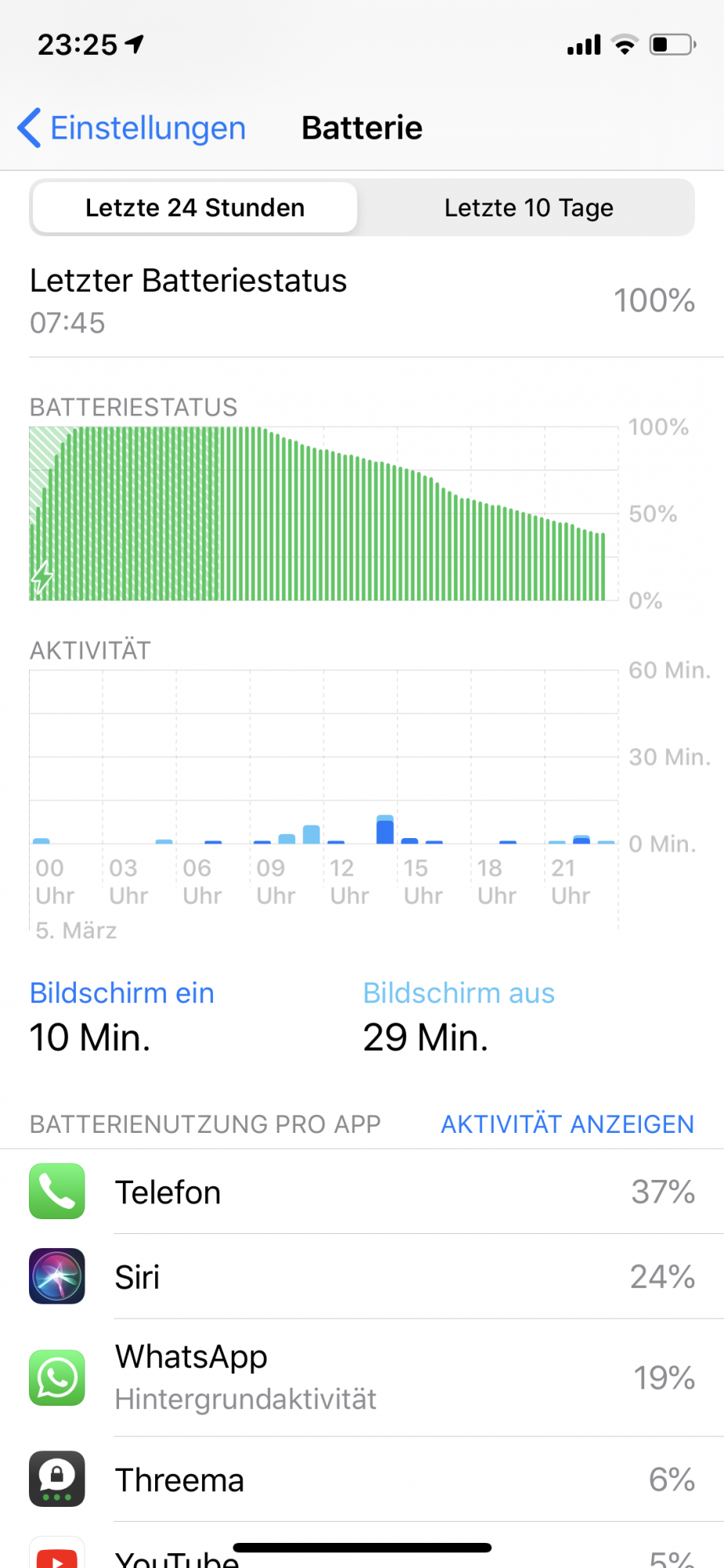

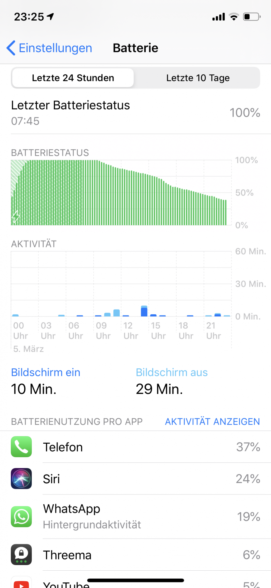

Yesterday I did an experiment and I tried not to use my phone at all. I had two 10 minutes phone calls and received a few messages (not read though).
Interesting is, that even Siri is completely turned off, it uses 24% of the battery. To me, something is seriously wrong with iOS 13.
Is this something that you experience often? If so, try signing out of iCloud and signing back in. Most of the times it's the iCloud syncing issues that keeps the iPhone awake and it doesn't even show in the usage.

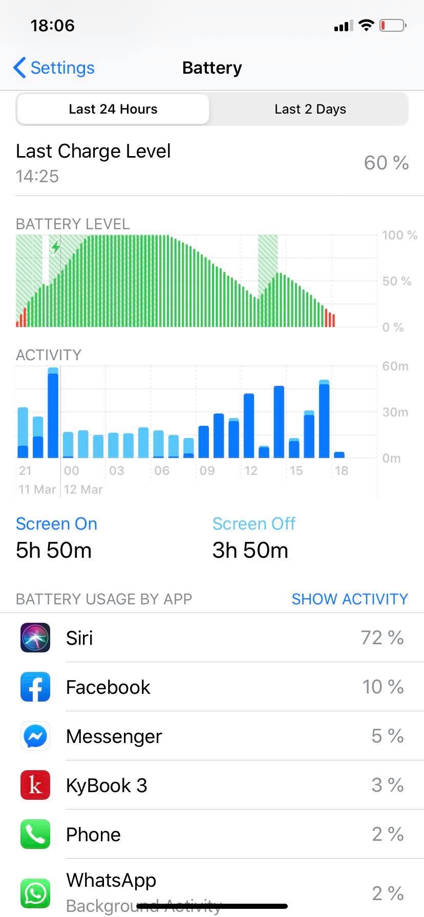

For me the issue started a week ago. What is really strange for me is the flashlight app eating battery while I didn’t use the flashlight at all. I see 4 hours of flashlight use in the statistics. Could it be a “hidden “ app that isn’t recognized by the system so crazy names appear in the usage list?
I had this issue with the flashlightin one of the earlier betas of iOS 13, right nowI haven't seen it again. Unfortunately i still havin the Siri Issue in the current Beta 4, so this hasn't been solved. Have openend a Ticket at Apple and we'll see what comes back.

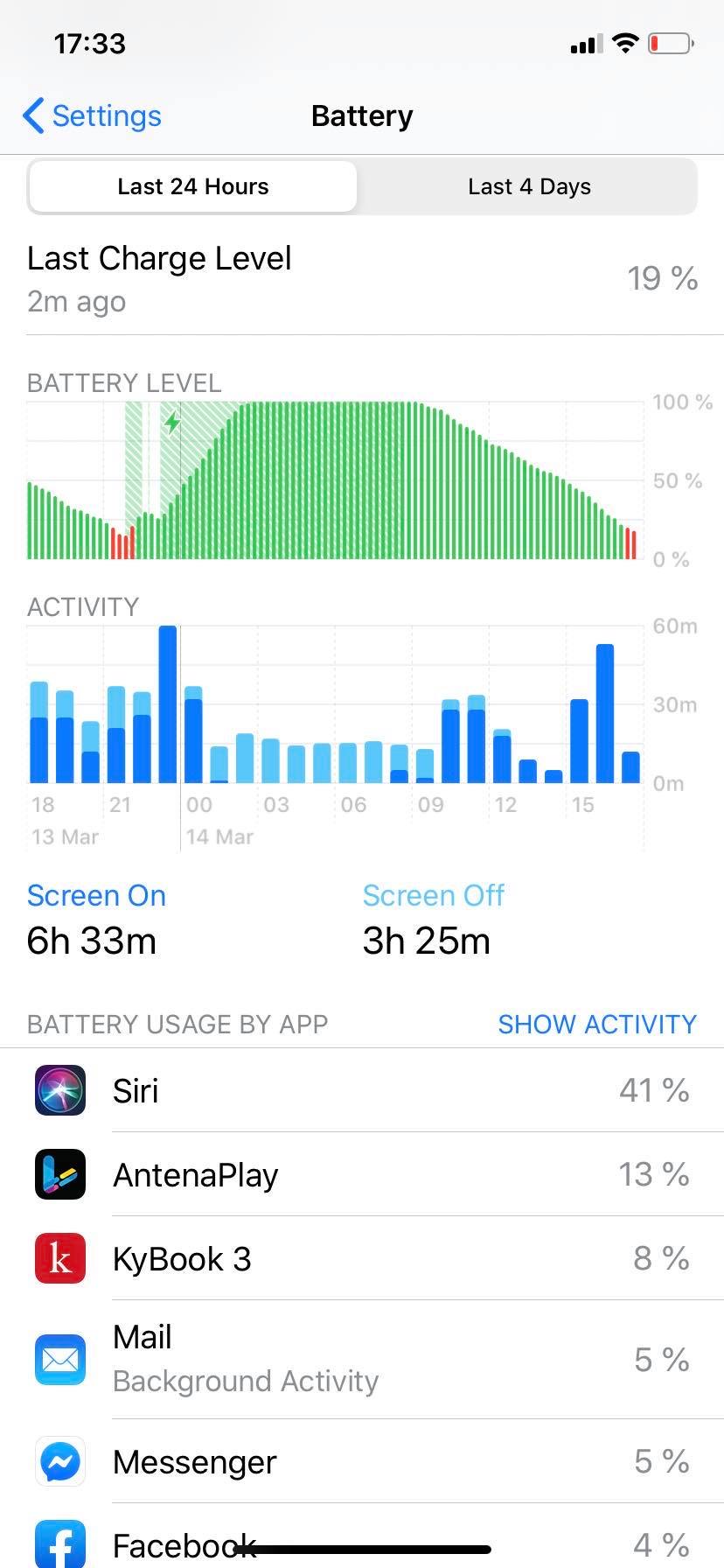

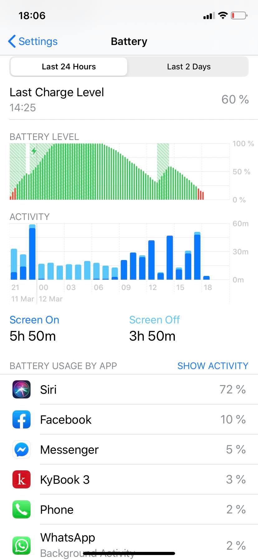

Hello.

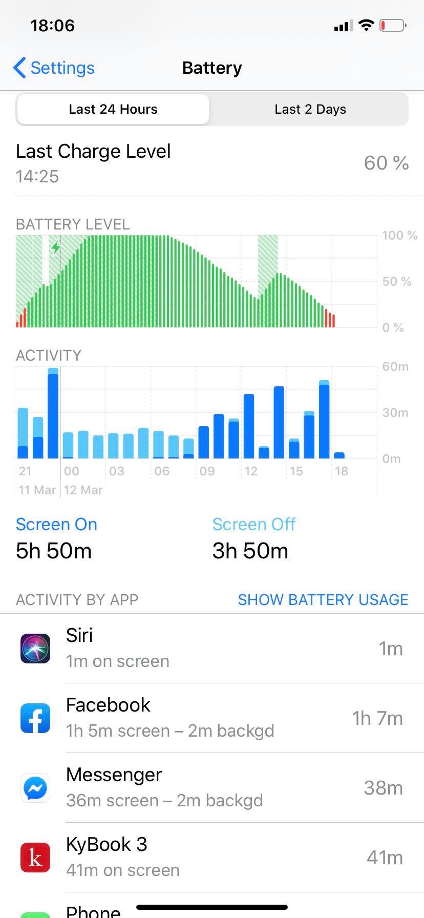

I had no problem with my IPhone X, but when I recently upgraded to IPhone XR this problem started. I posted the pictures below. I factory reset my phone after 2 days of Siri draining my battery in half a day. It did not resolve the issue. I am desperate. What is there to do, because it frustrates me extremely.A phone is for you to resolve problems, make your life easier, but this is exactly the opposite. What can i do?
Hello.
I had no problem with my IPhone X, but when I recently upgraded to IPhone XR this problem started. I posted the pictures below. I factory reset my phone after 2 days of Siri draining my battery in half a day. It did not resolve the issue. I am desperate. What is there to do, because it frustrates me extremely.A phone is for you to resolve problems, make your life easier, but this is exactly the opposite. What can i do?View attachment 898825View attachment 898826
ok so maby if i would instal the latest public beta? What do you think?
Hello.

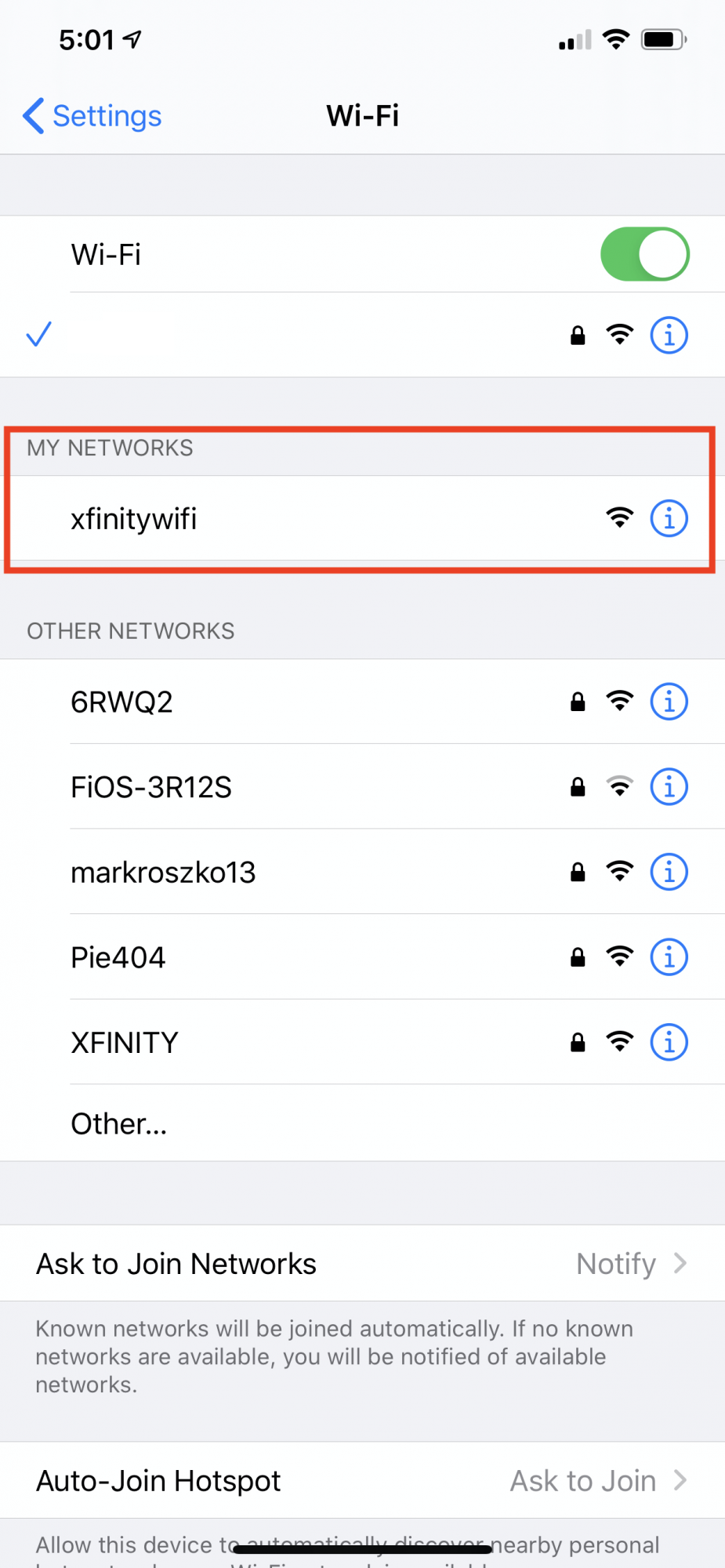

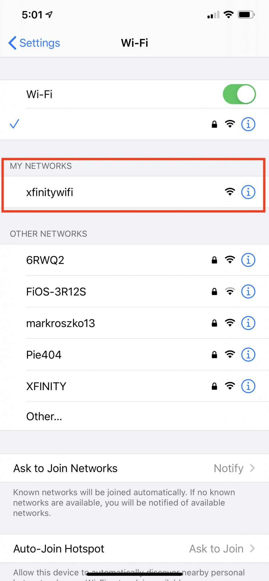

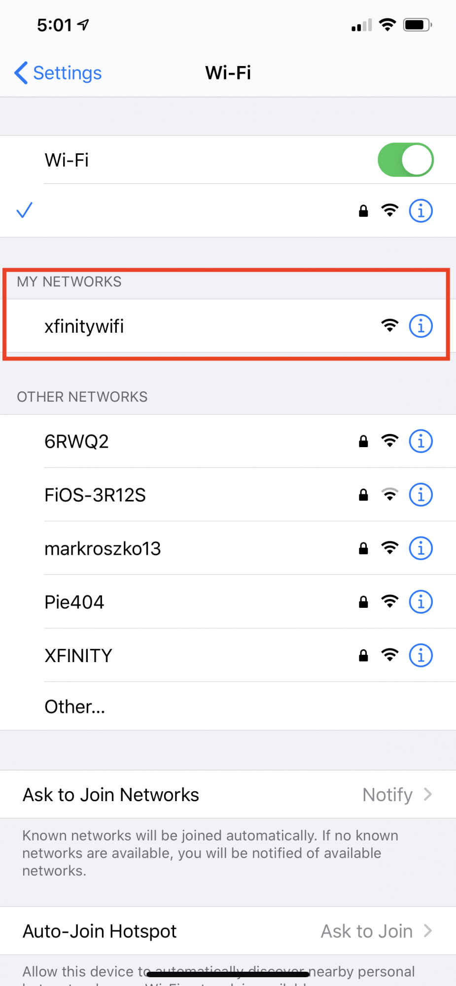

Your battery usage indicates an issue and it looks like high Siri usage from back in the day due to captive portals being ignored.
A captive portal wifi network is a network that requires you to use Safari to log in. These are networks generally found at gyms, hotels, restaurants, etc. But they can be found even at your house with many ISP's allowing their customers to connect to free hotspots.
Captive portals can become a problem with Wifi Assist. Being connected to a wifi network and refreshing login data while using LTE/4G because the network doesn't have a internet access can wreak havoc on the battery.

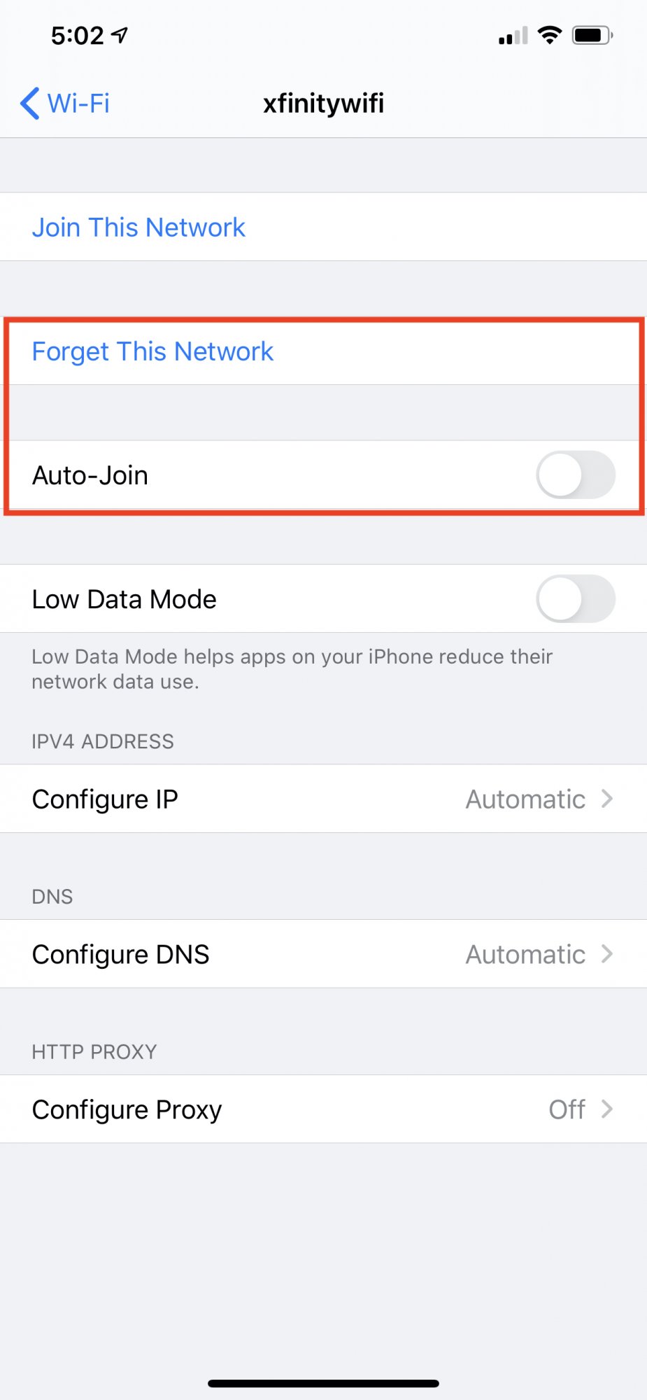

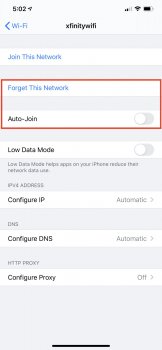

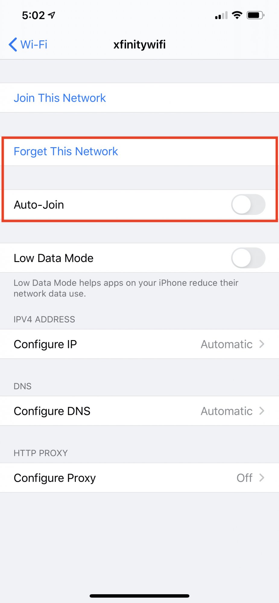

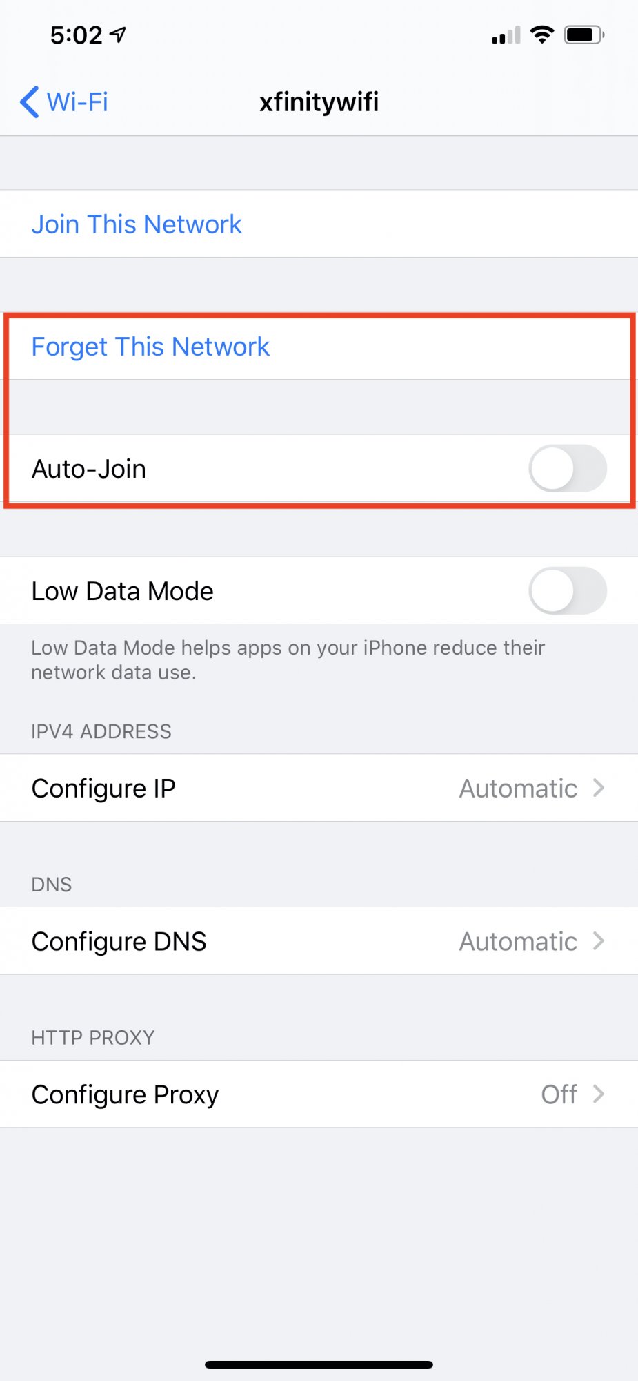

Go to settings > wifi and look for captive networks. For example...
If you don't use it tap "Forget This Network". If you do use it toggle off "Auto-Join".
If you don't see any captive portals know that the usage could be from another task after a restore from spotlight database rebuilding (SPOTLIGHT IS NOW SIRI BTW) or other iCloud services like Faces in photos. However it still might not be a bad idea to goto Settings > General > Reset > Reset Network Settings. From there only use one or two wifi networks (home and work) for a couple days to see if the issue improves.

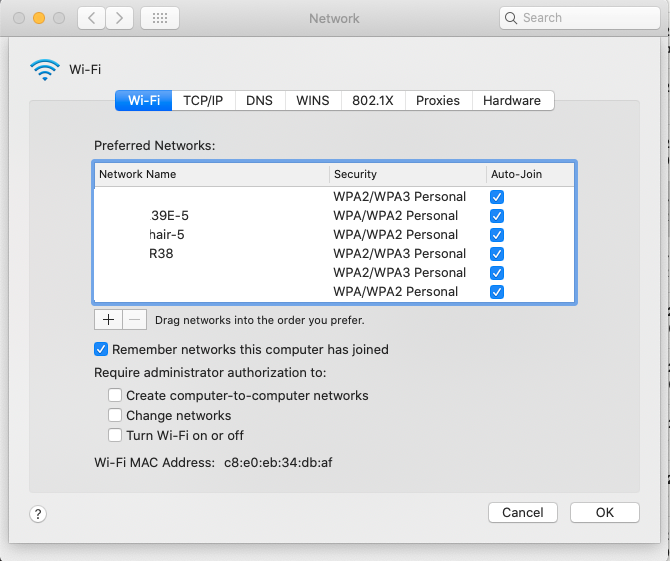

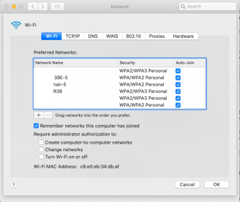

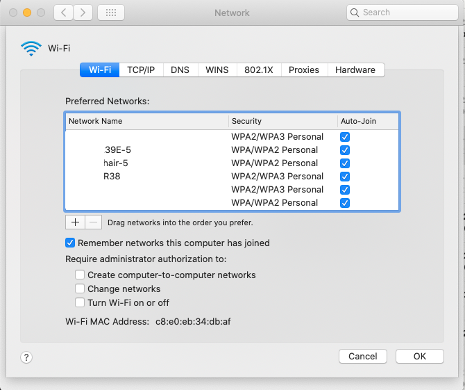

If you have a Mac using the same iCloud you can see Preferred Networks that aren't in range. Removing captive portals from there can prevent you from needing to do a network reset.
The above is just a shot in the dark but this issue (impossible Siri usage like using 1m of Siri more than 1 1/2 hours of Facebook) was a thing a few iOS's ago. Again this only applies to people that have high Siri usage with low time that are higher on the battery usage chart then obvious heavy battery using items like hours of Facebook or Phone.... It should be obvious since the battery can't discharge more in 1 minute then Facebook uses in 1 1/2 hours, the battery would literally over heat in a fraction of a second if that was accurate data.

Thank you so much my dear friend. This is by far the most comprehensive response i have ever received on any of my questions posted on any forum since like forever. So thank you. This morning took it off charger at 9 am. It is 18.00 pm and after using it at a normal rate i have about 50%. It is not perfect but still a substantial change in comparison to yesterday when following the aame pattern at 12 o’clock i had 20 something percent. So what i did was reset the network settings this morning. But last night i spoted that some of my apps had the small icloud icon with a small arrow pointing down in the bottom Left corner of the icon. So I figured that they did not download completely from the clod so Siri was trying to do what it does to index them, lern from them whatever and could not do because they were not installed yet. Sooooo i touched eeeevery one of them to download and go in app for a sec or two. Did that twice. Close all of of them. Restart the device. And this morning did the network reset. So not sure what worked. But something did. I will reply soon with updates.
Ok so I come with the update. It is still not resolved. Now Siri ussage is still there, not so high as before but still present even though i did not use it at all. I still have listen for Hey siri off. What else is there to do? Is it not done with indexing? Is it the new phone battery drainage simptom? It is driving me maaaad!!!! I am considering installing the public beta profile and see if this changes anithing. All though i will wait a few more days and see if something changes for the better and if not then i will go beta.
