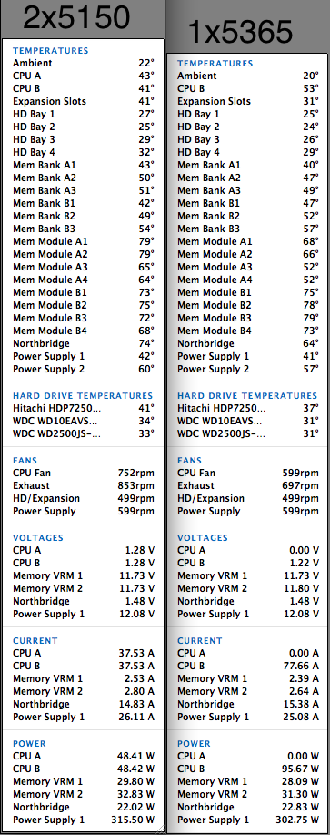

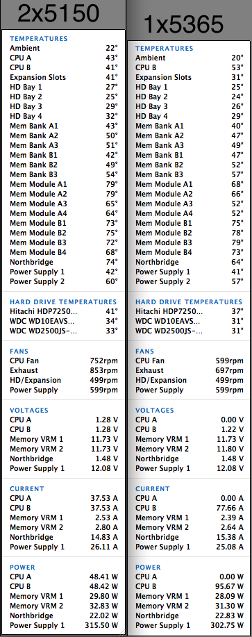

So far I have migrated from two dual core 2.66 to one quad core 3GHz. Speed has increased and temperatures have dropped across the board.
While at it I have found a cable at the bottom of the memory cage that had one of its wires' insulation stripped by sharp edge of the cage (during factory assembly) and making contact with the metal case [fixed now] :eek:
So overall I am very happy having moved from 2 x 5150 -> 1 x 5365.
Now I need to chase another X5365 but no pressure now.
Good side of such upgrade path is that you can buy one 5365 and then sell a pair of 5150s while looking for another 5365 (if you want full monty) and enjoy upgrade in stages...
Temperatures shown under continuous full load (4 thread CPUTest / glucas.) Notice how cool all memory modules "A" are now - as they are in the slipstream of inactive CPU.

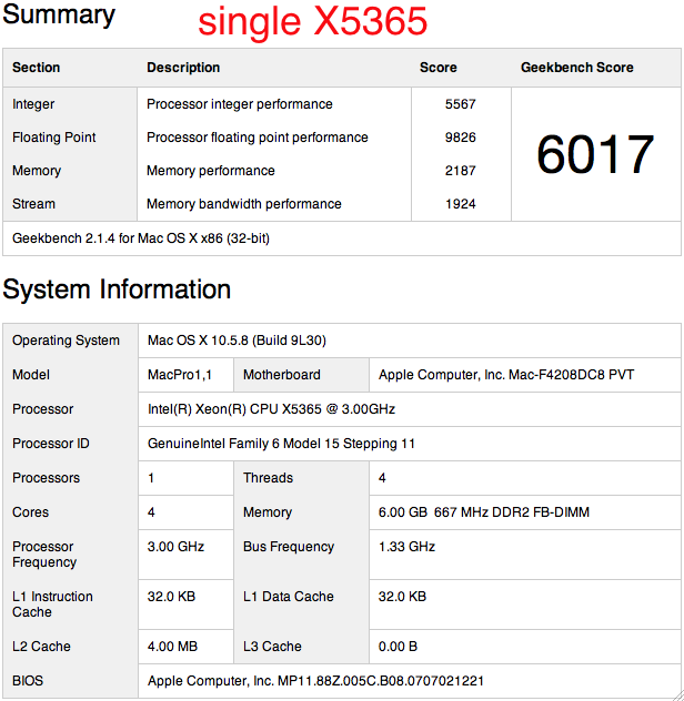

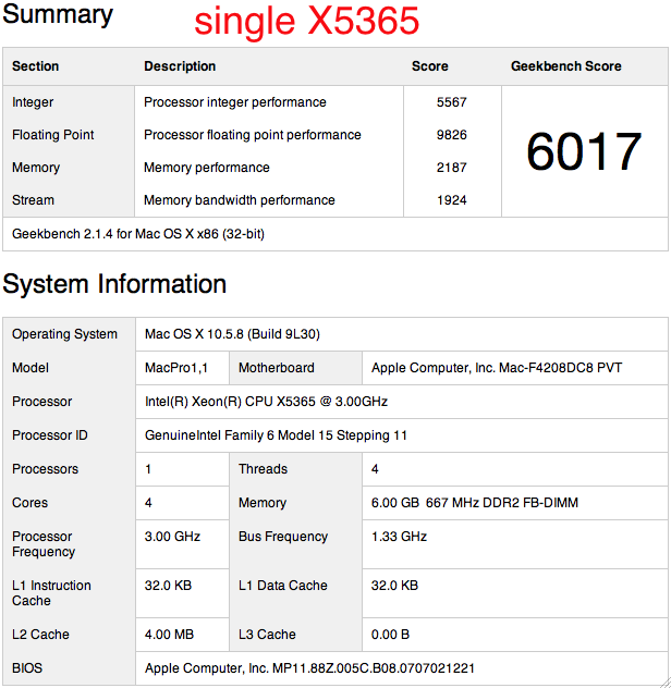

Geekbench test is about 6000 and before upgrade it was about 5200.
Cinebench has also increased proportionally. Apart from the speed increase I can't see much difference from previous 2x2.66 configuration.
When you do drop in the second processor, watch your temps. I upgraded my 2ghz quad to a 2.33 octo (sold it later) and my temps jumped 10 to 15 degrees. Had to bump up the fans. Would have kept it if there was a way to change the efi to 64 bit. Currently happy with my 2.8 mac pro.
Temperatures seem to be OK. SMC does a good job keeping them at bay. It speeds up fans to either keep RAM modules below 80ºC (for memory intensive tasks like CPUTest) or CPU case below 65ºC (for CPU intensive ones like Handbrake.) I have looked through X5365 datasheet and this is within spec.
In fact, my fan speeds have dropped after the upgrade and I am very glad to see my Northbridge running at 63ºC. I am not sure I really need second X5365 at all. I only do video compression once a month or so. Given the fact that I have bought X5365 on eBay for $100 shipped (with BuyItNow) :eek: this is not a bad reshuffle.

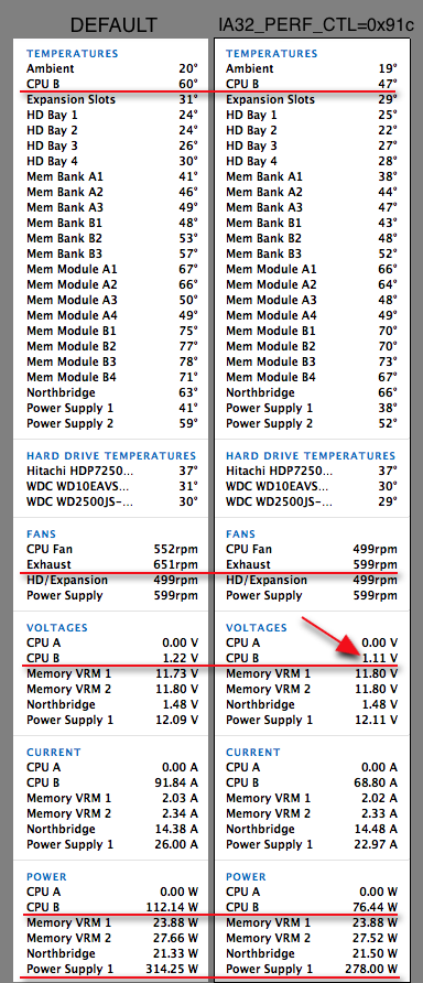

Some more interesting news. I have programmatically dropped CPU voltage a little bit and now the processor runs quite a bit cooler (but with computational performance unaffected.) Power dropped too and fans have slowed down. :)
To do that one needs to change the contents of IA32_PERF_CTL msr using e.g. reggie_se from CHUD tools.
Here is comparison between standard and reduced voltage operation with Handbrake running and all temperatures stabilised.
