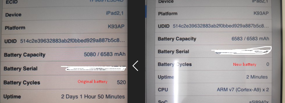

  1. New Battery (Original battery at 520 cycles and 77% capacity left)

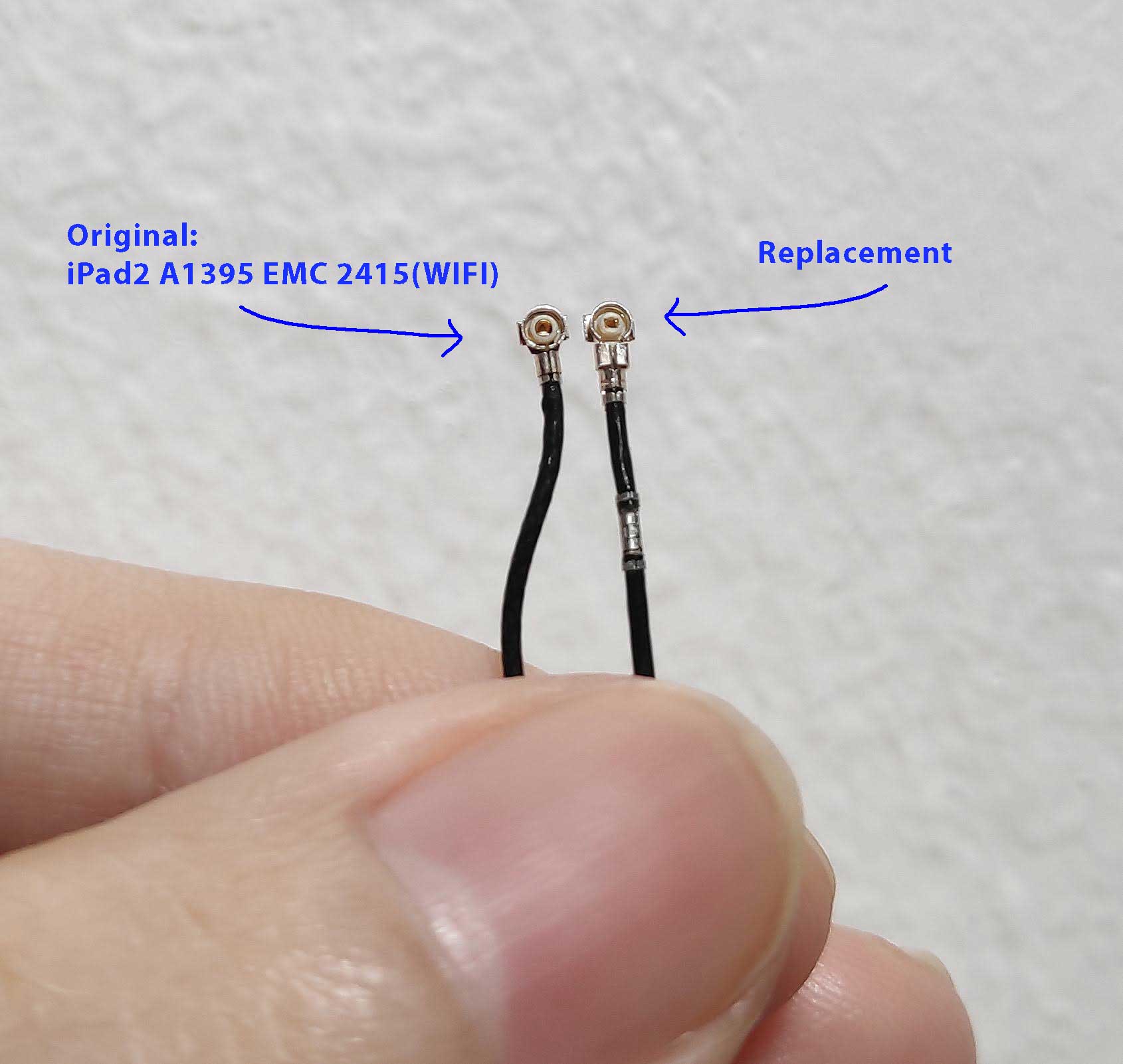

  5. WiFi antenna (I accidentally tore it a little, so the antenna screw holes are gone)

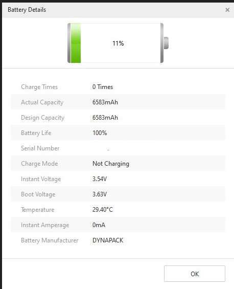

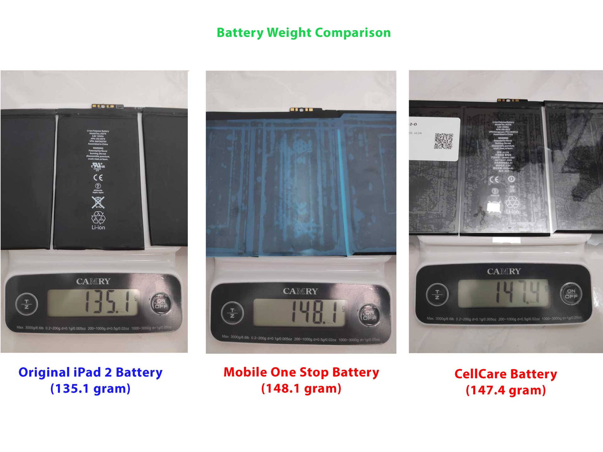

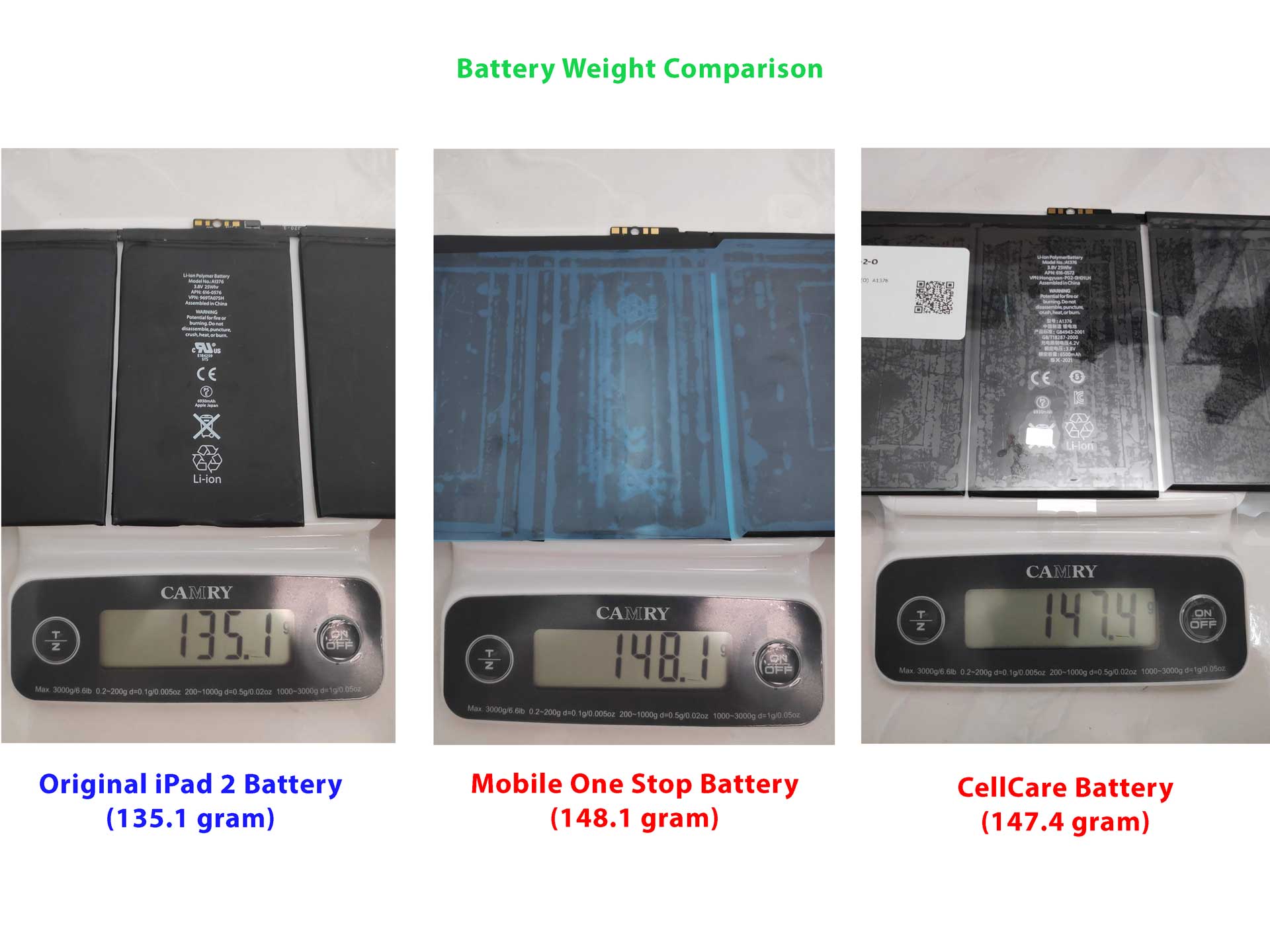

Replacement Battery:
Old vs New​
The new battery manufacturer is from DYNAPACK. They are one of the official iPad battery supplier for Apple. Some of the iFixit batteries also source it from the same manufacturer.

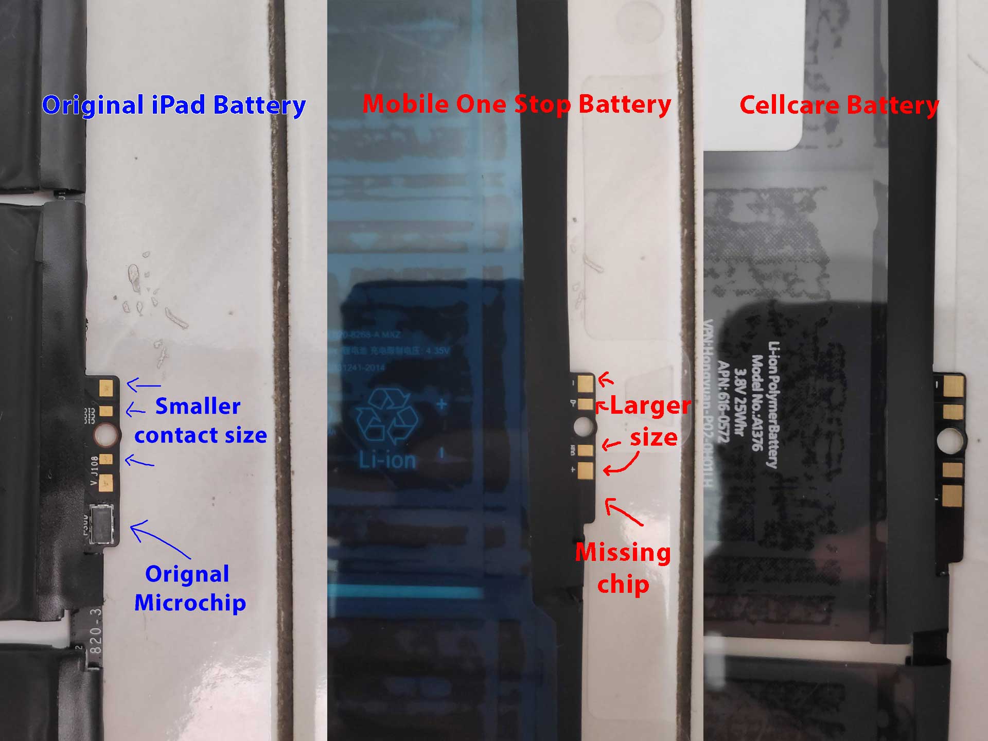

Battery comparison. I returned the middle one, because it cost so much more than the right one, and the seller ghosted me for no reason. The seller is freaking dodgy.
Ori vs replacements battery from 2 different sellers​
weight​

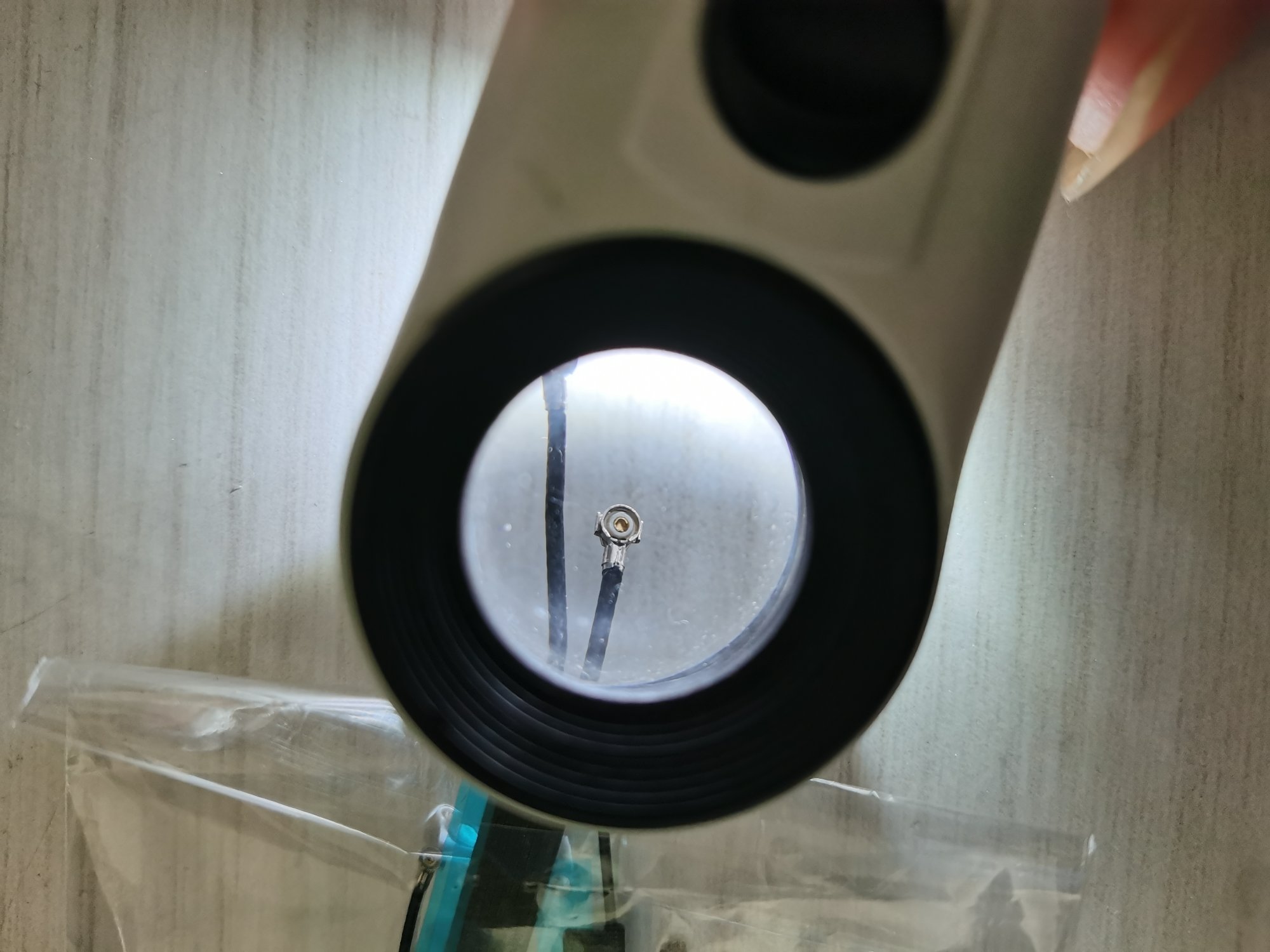

Replacement WiFi antenna:
If you never open up an iPad 2 before, 99% chances that you will tear it apart when you remove the digitizer, because it is using double-sided tape glue under the glass, you are extremely easy to tear it off when opening up. I also encounter an issue, the replacement antenna are using different connector. Original is round, replacement is square. After I can't find it locally, I got no choice, have to directly source it from China, It took 19 days using sea shipping. So I ordered 3, only 1 able to give me full signal bar. I spent 3hrs+ just to test the WiFi signal.
Ori vs replacement with wrong connector​
The correct connector that will fit on the iPad​

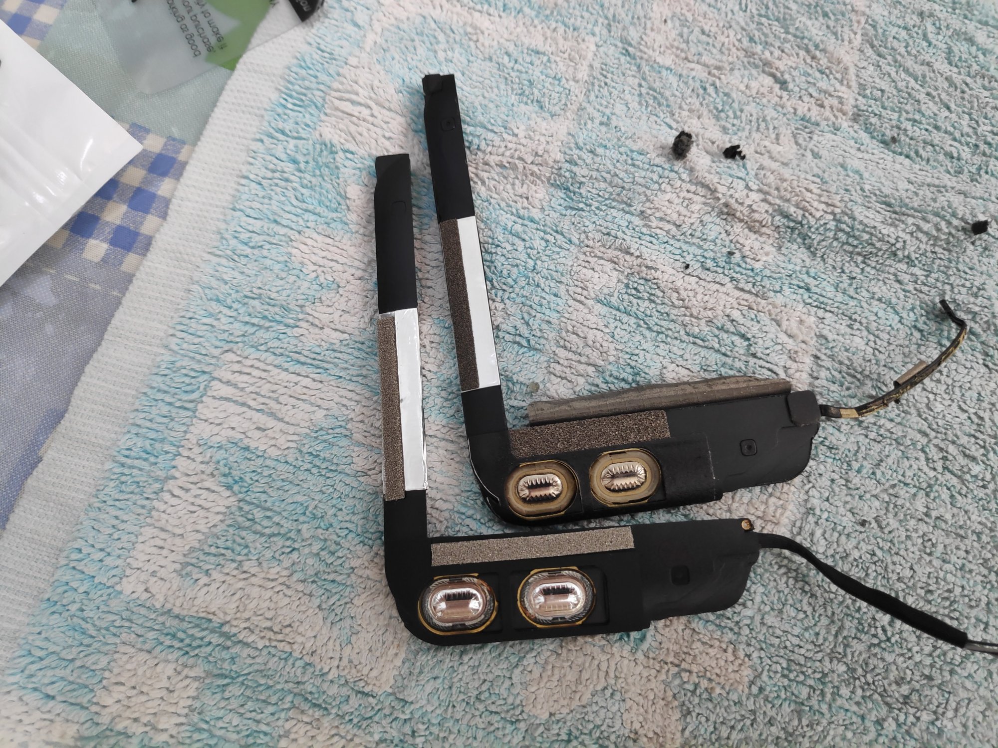

Replacement speaker:
All the replacement speaker on the market are slightly ticker than the original. I have confirmed with the seller, because the replacement speaker is a lot more durable than the original. But it is extremely hard to push it into the case. I have to remove the sponge on the back and push very hard just to screw it back to the case. My fingers were sore for a few days after that. But hey, at least it sounds good!
Top ori vs bottom new replacement

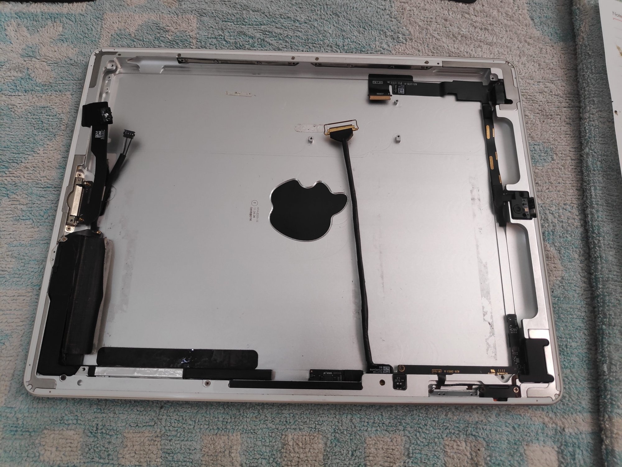

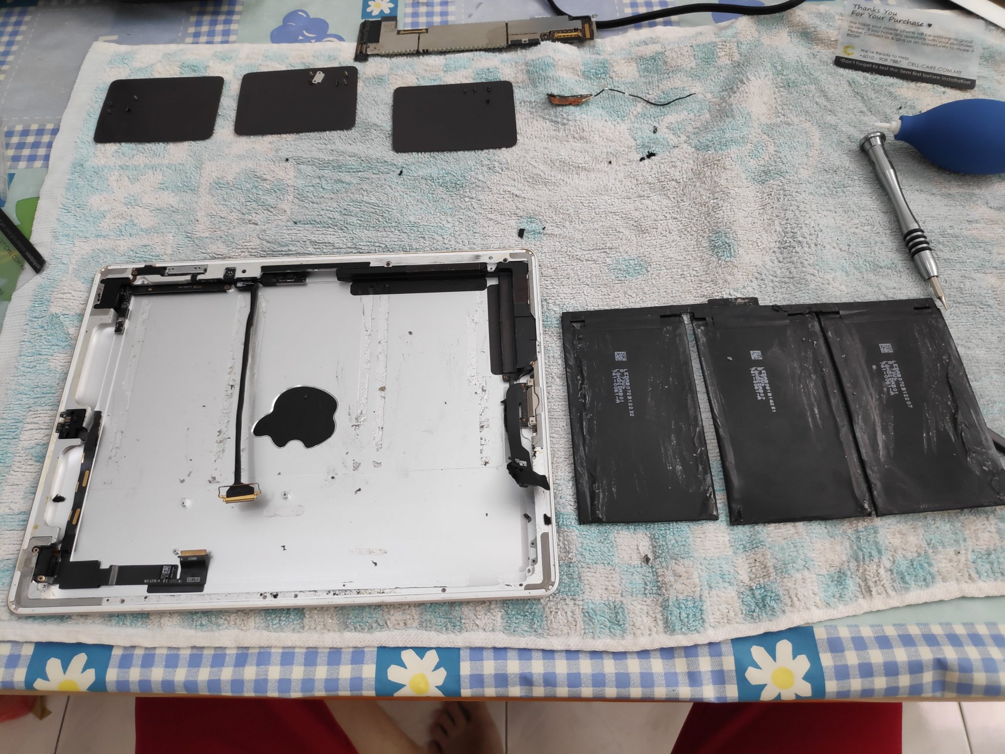

The cleaning process:

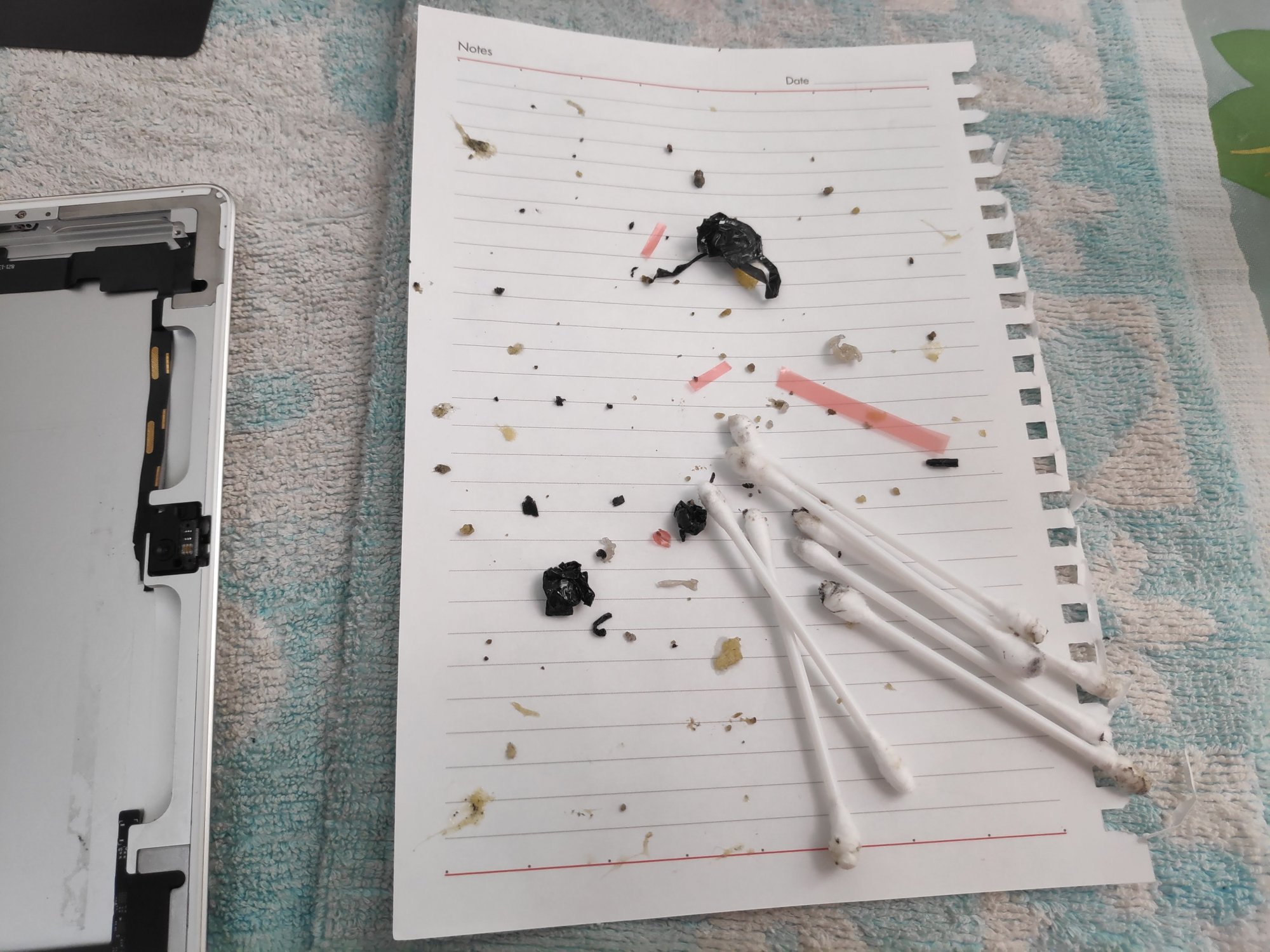

The image below is just part of it, the amount of glue that Apple use on iPad is just absurd. Seriously, wtf, they really don't want you to fix any of your device that you own. This is why right to repair is so important. I can assure you, no repair shop will clean it for you if you send to repair, because the process is just tedious and tiring. I spent 4hrs+ just to remove most of the glue on the digitizer and the case using alcohol.
The remaining glue remain on the case after removed the battery​
All the gunks
After clean up​

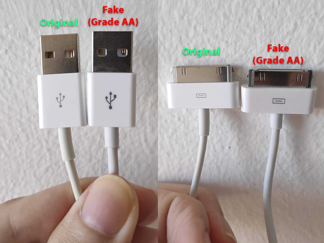

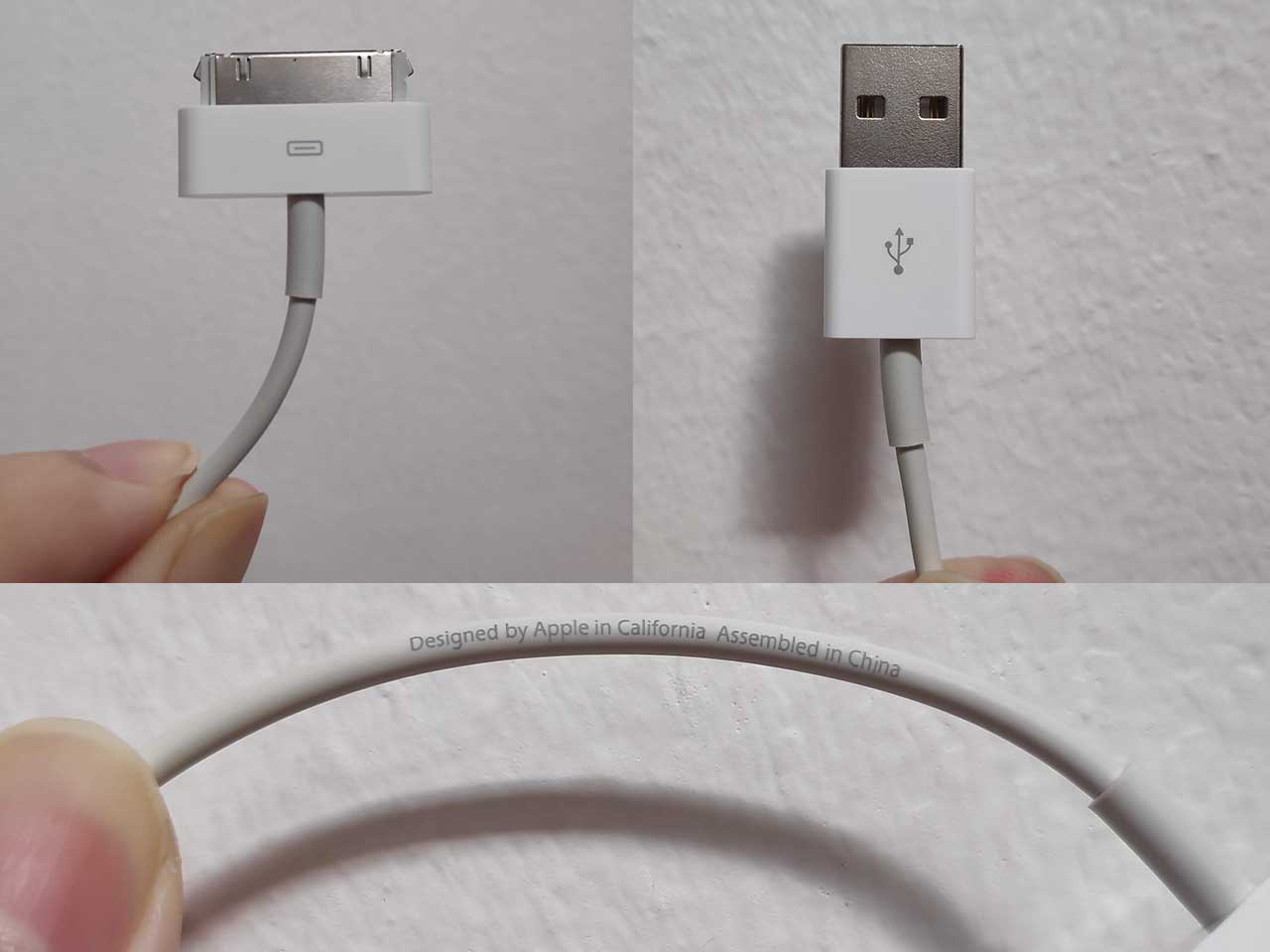

Since I'm sourcing parts from China, I'm also found a seller that still selling original 30 pins cable. Wow. I'm sure it is original, because I own replica cable as well.
Original​
Comparison

It’s possible that Apple changed some parts like the speaker and antenna during the lifespan of the iPad 2. Did you swap the antenna connector over?

Apple didn't change the wifi antenna, it's the supplier selling the antenna with wrong connector, I've checked with all my local suppliers all of them are using the wrong connector, many ppl complaint it's unusable, but they still keep selling it, smh. I source the correct parts from China, I ordered 3 antennas, but only 1 able to give me full signal.
The original speaker is not durable, the transparent drum layer will degrade overtime and die eventually. RN, you can only find OEM speaker, and it's slightly thicker should be around 0.01mm thicker, because really hard to push in the case. I believe they use different material, so it will not degrade easily like the original.
