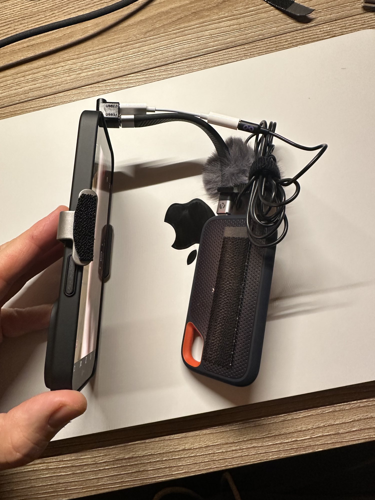

I know the goal is minimalism, but would there be a need to connect an external mic? I think this is the only other piece of equipment that would need a usb port. I can’t seem to find an ultra compact multiport adapter that would accommodate both this and the drive. Does anyone know of such a thing that would be flush with the bottom of the phone?
Yeah, check out this post, it has a working splitter:
Good find. Will order that https://www.amazon.com/dp/B0BRV4GNSL

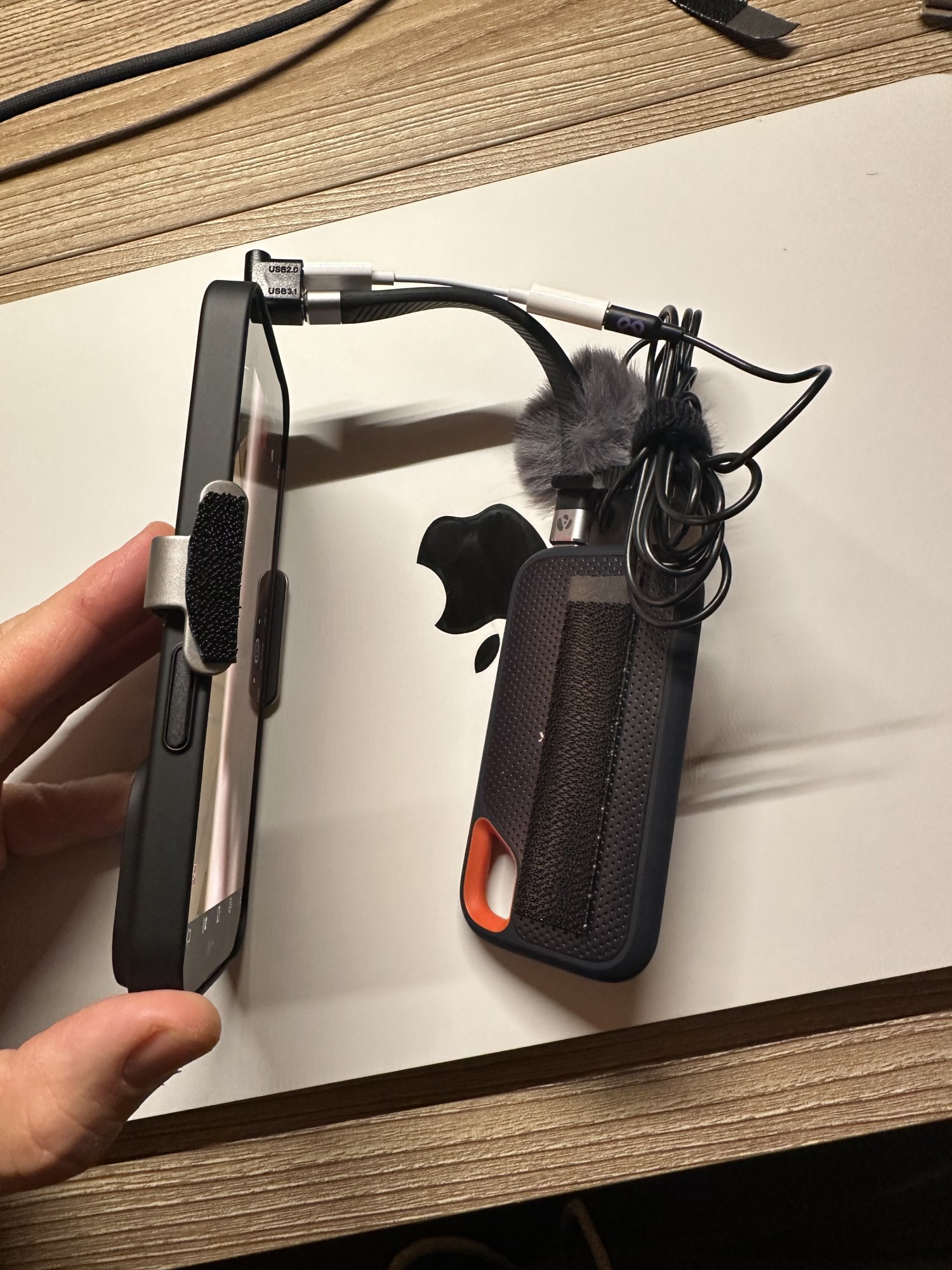

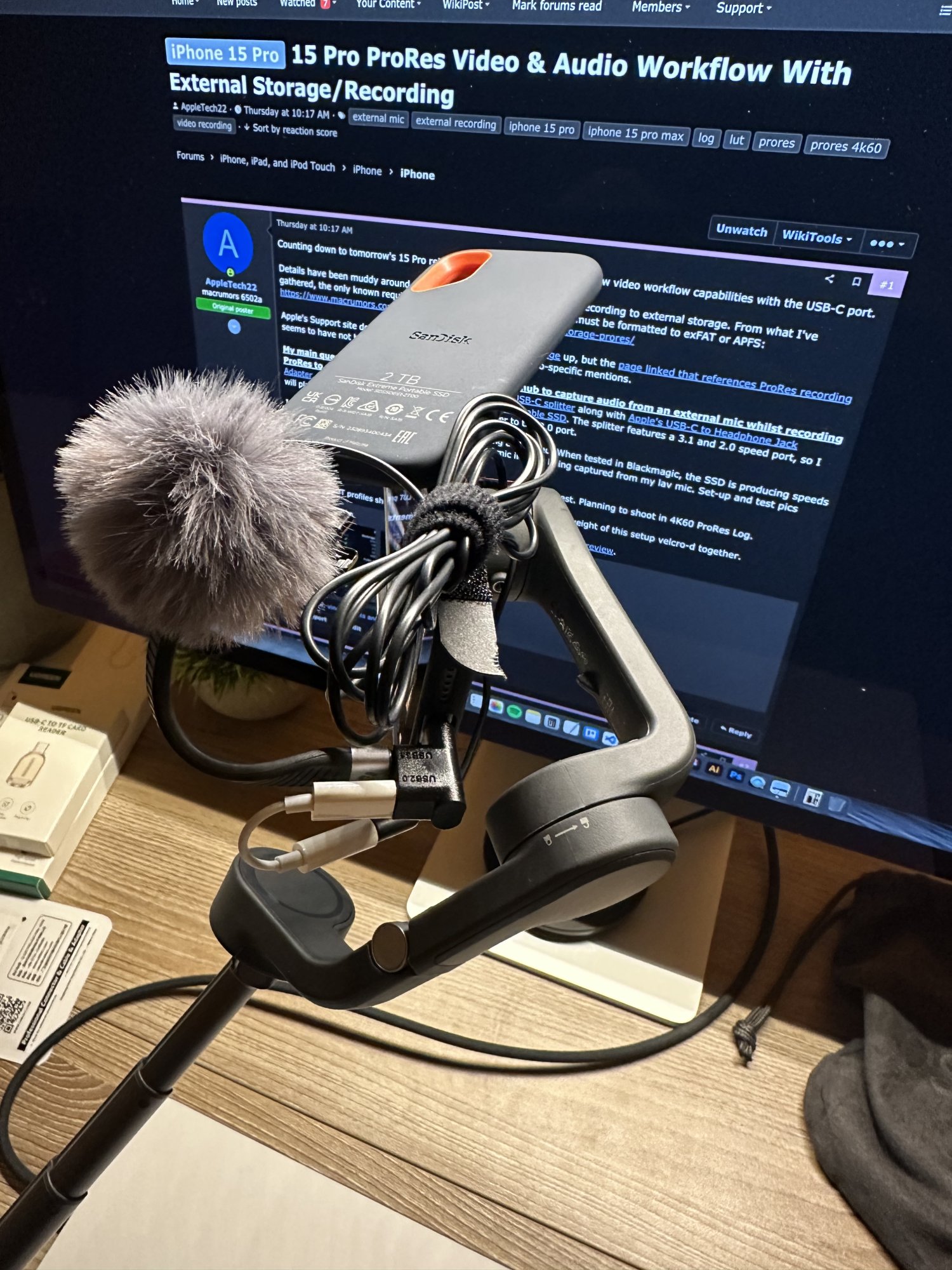

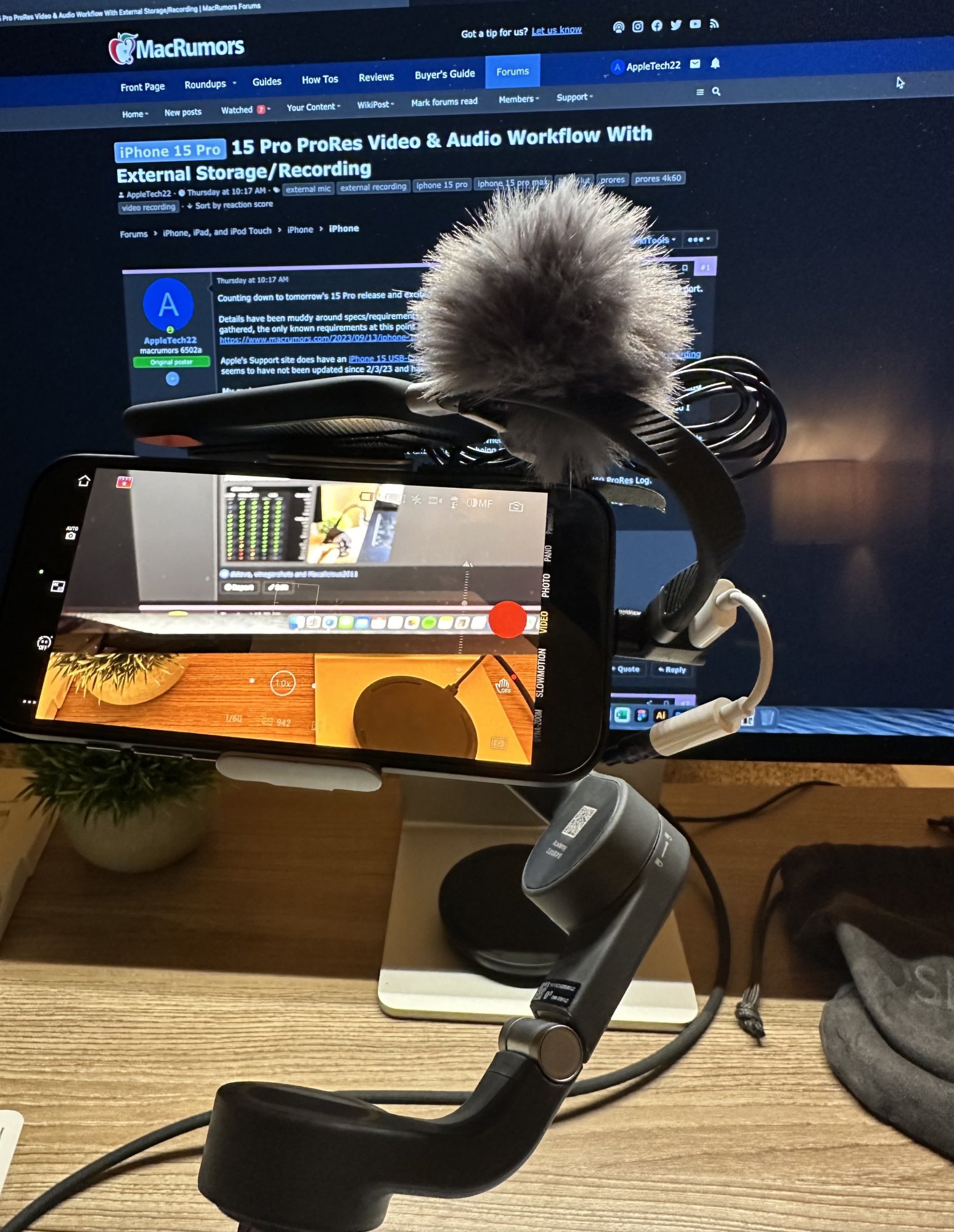

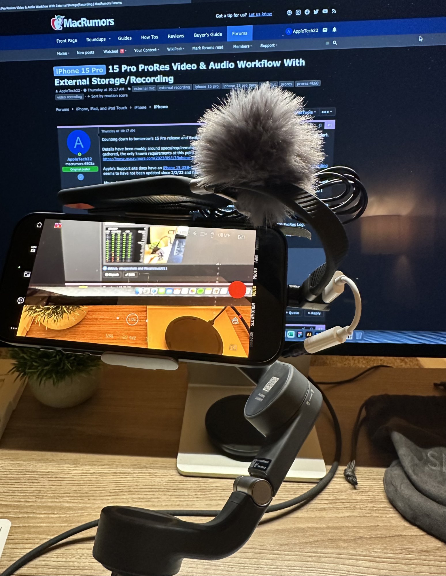

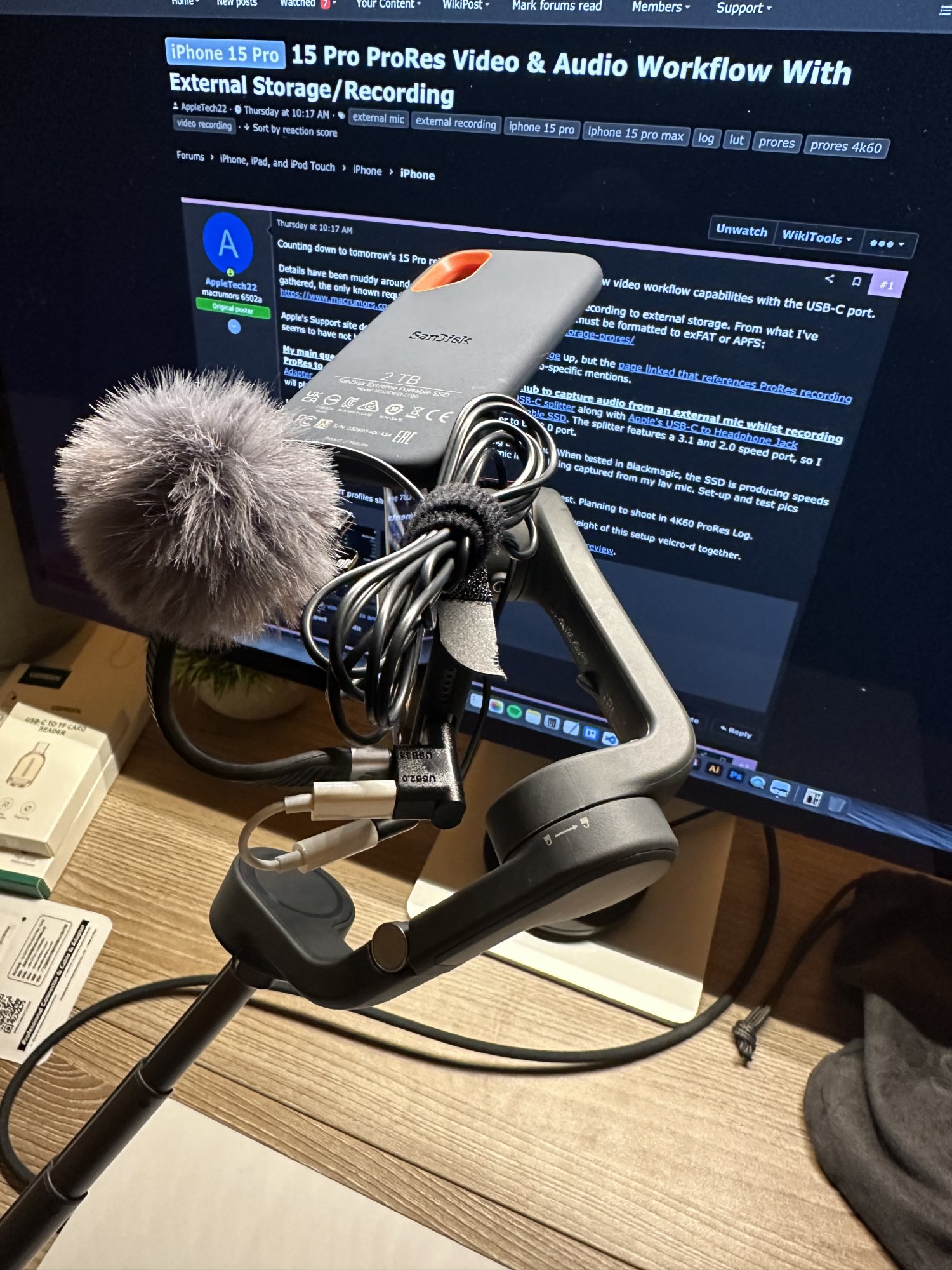

Love the setup @Ryan P. I have a thread testing some rig options as well, specifically with an external mic input using a USB-C splitter and on the DJI Osmo Mobile 6 gimbal. Haven't landed on a solution yet.
The one flash drive I could find with write speeds capable of 4K60 ProRes - the Kingston DataTraveler Max - is unable to sustain its 900MB/s speed and resulted in stuttery footage for me at times. Testing the drive in Blackmagic, speeds indeed dip to below 200MB/s rather quickly. Unsure if the drive is just defective or if it thermal throttles that much.
Ordered the flexible USB-C cable you mentioned and will give it a go. The gimbal clamp restricts my ability to mount the SSD directly on the back, but I might be able to velcro it to the top right edge of the phone (landscape orientation). Using the longer Thunderbolt 3 cable I have on hand was impacting the gimbal's stabilization, but I also ordered some other cables to test - the thinner/lighter the better in my case.

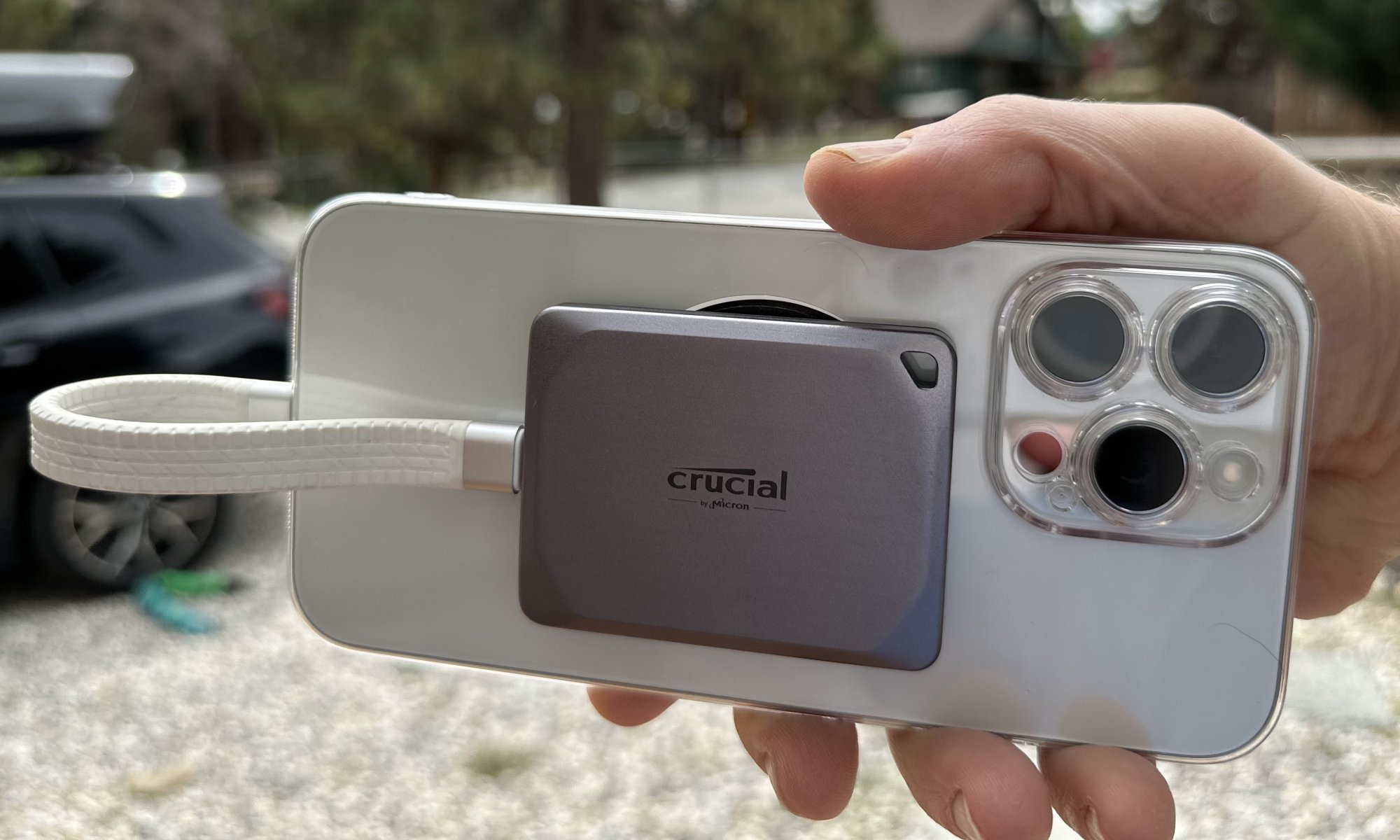

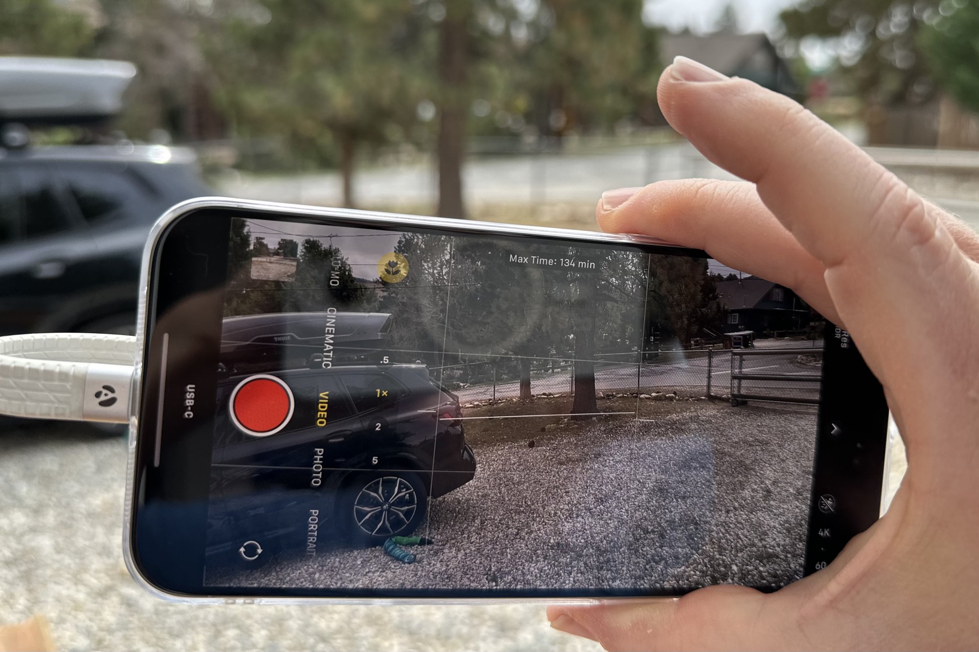

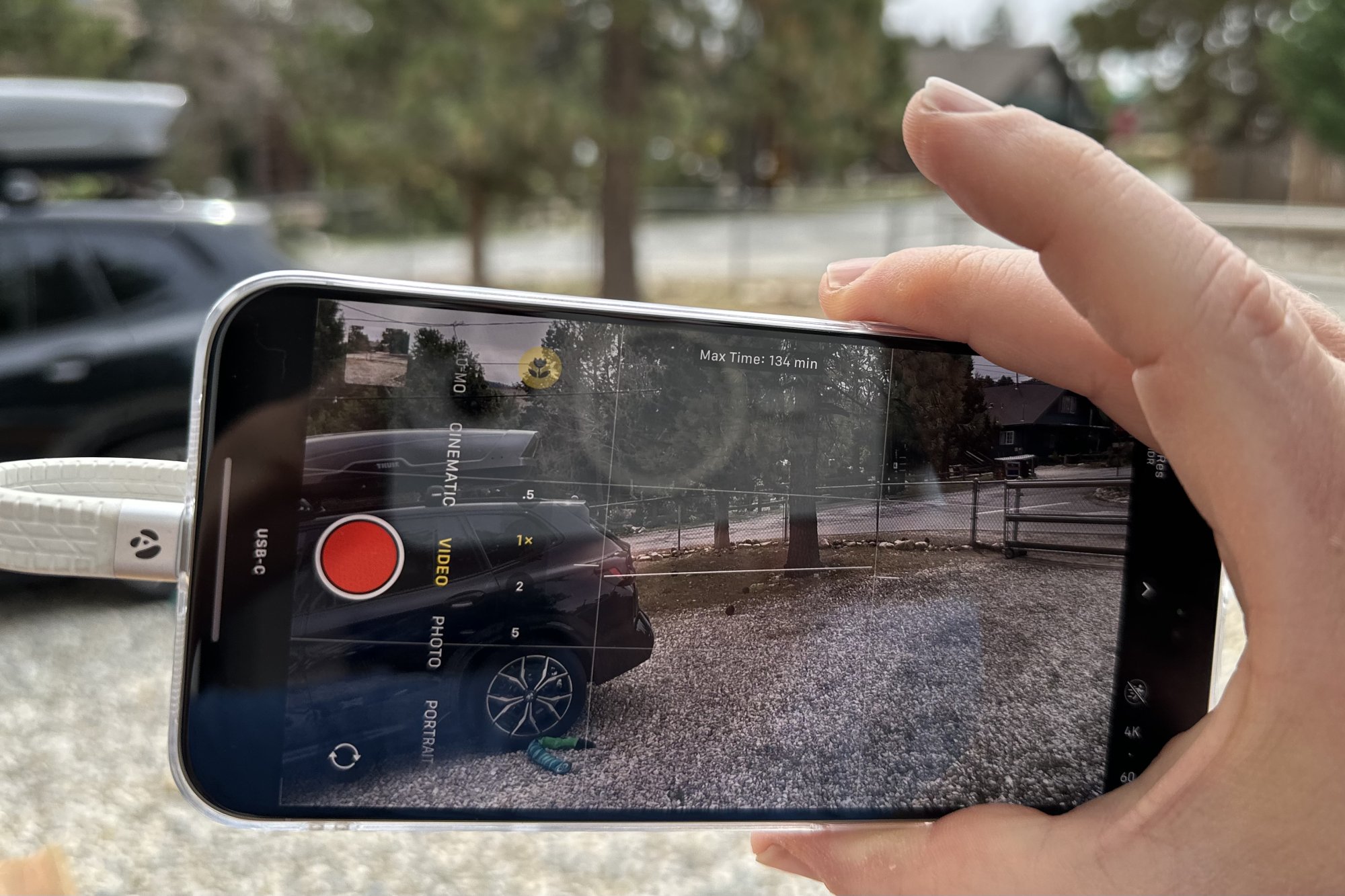

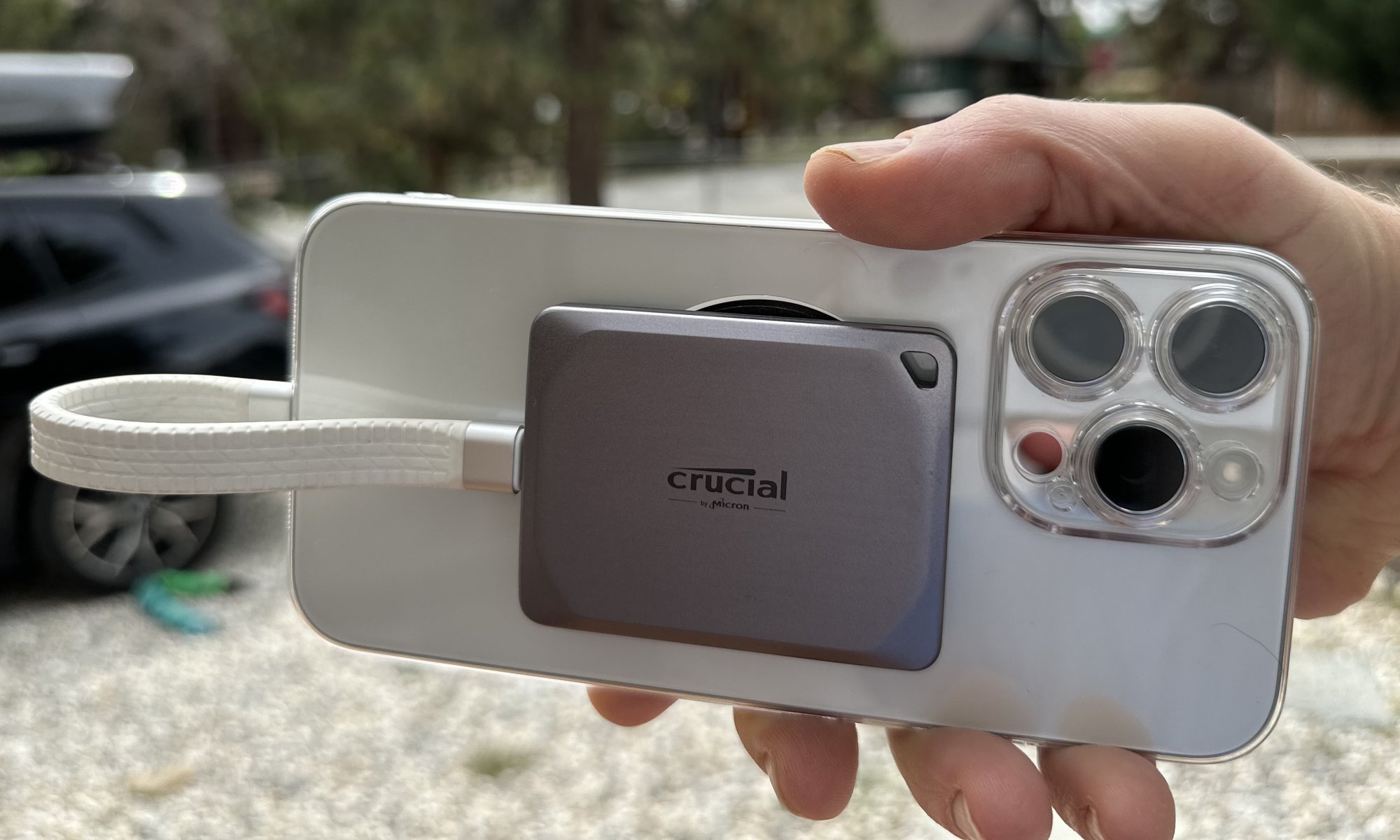

A super minimal 4K 60 rig. I’m using a Crucial X9 2TB, mounted via MagSafe. Can get 144min for 2TB. The X9 really good bang for buck. $70 for 1TB.
The mount comes with 2 options. A thick really strong MagSafe and a paper thin, probably strong enough MagSafe. Digging the ultra thin case as well.
If someone finds a 3.5” super flexible USB-C cable, let me know! It has to be flexible or it will pull the drive off the MagSafe.
