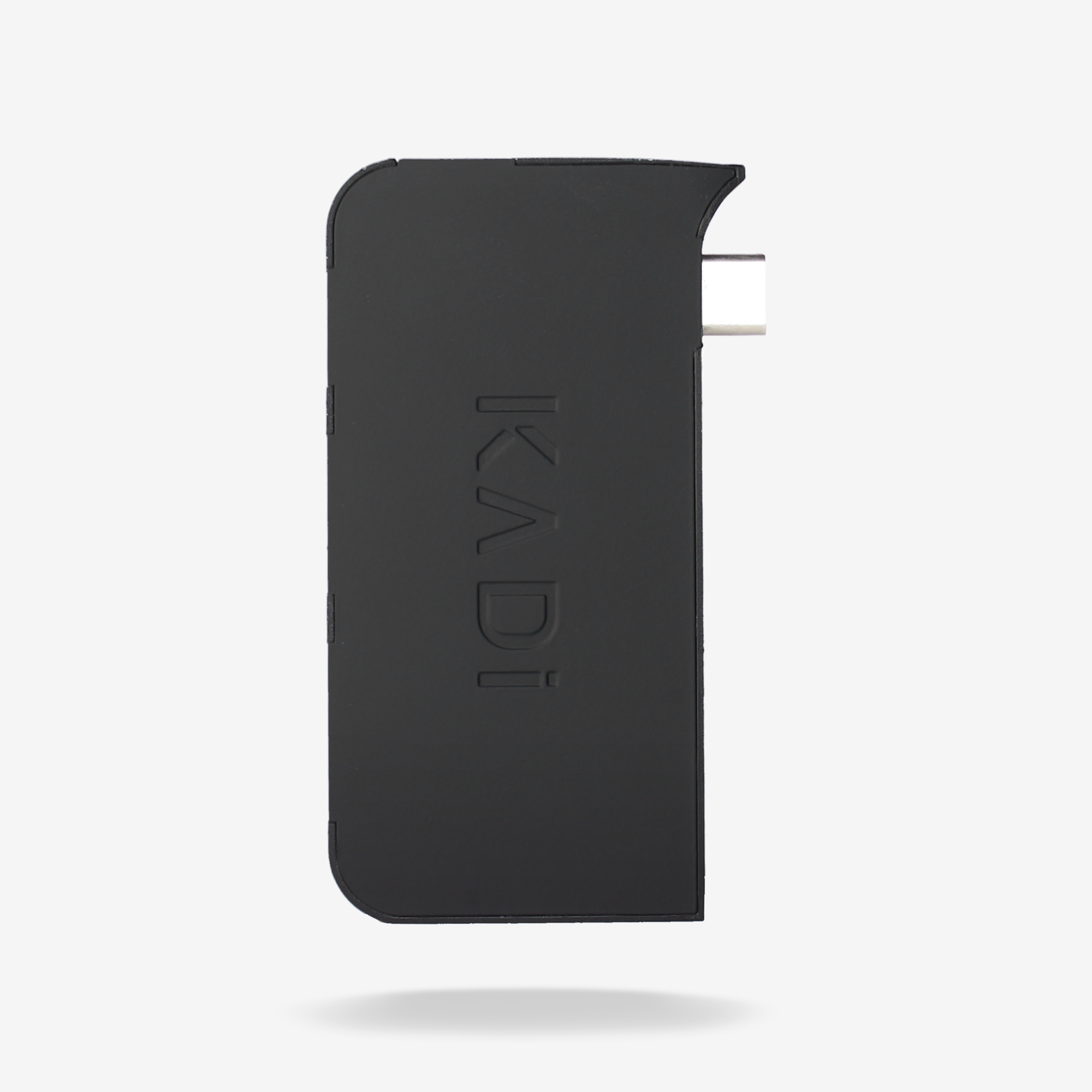

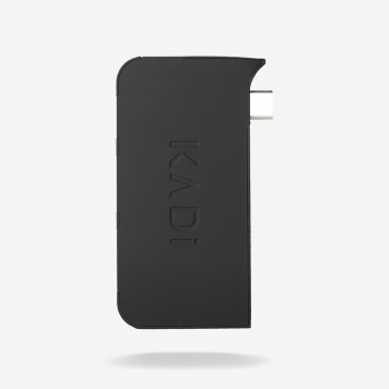

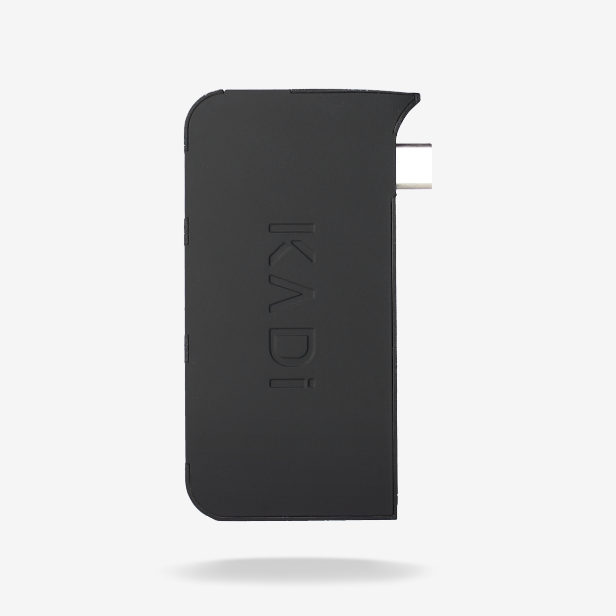

I've come across a company KADi CREATIVE after some hunting, small start up but have a portable hub option and a few neat cables, I picked it over the NEO because I can use my USB 3.0 to Ethernet adapter with it.
https://kadicreative.com/collections/the-kadi-collection/products/the-kadi-port?variant=14058610951
Do some review on the Kadi Port
I've found that its a really lightweight solution and good for travel, also looks great and fits with my Macbook. Downside is the extra USB C port on it isn't fully functional, so I cant link my Mini display port adapter to the spare USB C. Although I am yet to find a USB C so far which has 2 x USB C anyway, otherwise so far so good, It's also the best value I found for price (with HDMI).
I agree with the previous poster's comments. I'll add that my MacBook will recognize an iPad Pro 9.7" plugged into the USB-A port only if I have the charging cable plugged in, as well. Other devices, such as an iPhone, work fine without power. I've asked if this is normal but for now assume it has to do with the additional power requirements of the iPad.
Another potential downside is that it slides out of the USB-C port on the MacBook fairly easily. So for "desktop" use a box with a corded plug may be a better option. However, it seems like it will work well for traveling.
