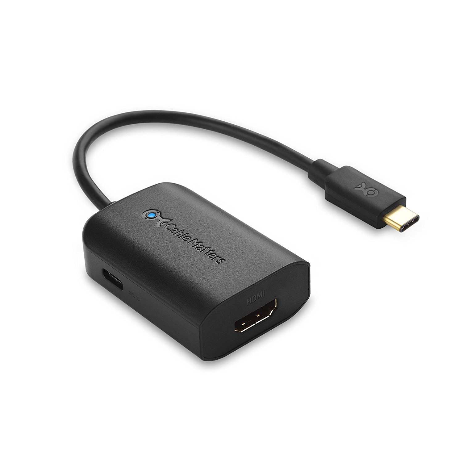

I've decided for my 12" MacBook, I don't like those all-in-on adapters with HDMI and USB and other stuff. For USB-A I use a simple adapter that I carry on my keychain, and for HDMI, I bought a separate 4K 60 Hz adapter that also has a charging port. The adapter is much smaller, and doesn't get hot. I don't need the charging port to run HDMI, but it allows me to charge the MacBook at the same time.
The one I bought is from Cable Matters (via Amazon):
http://www.cablematters.com/pc-893-...sung-galaxy-s8-thunderbolt-3-compatible.aspx#
Works great with my 2017 Core m3 12" MacBook. Apparently some adapters don't like the 2017 models, but this one works perfectly.
Here is Exposé at 4K 60 Hz on the 12" MacBook:
I am sorry to dig up your old post, but do you think this version could also work with a MB12 2017? This is the only version i can get in my country. https://www.cablematters.com/pc-899...r-delivery-thunderbolt-3-port-compatible.aspx Is there any alternative with DP 4k/60hz and power? Maybe not from Cable Matters. Thanks for your help.
Probably should work with MacBook, at 4Kp60.
The one I have for 4Kp60 has HDMI and power delivery but no other ports.
I know, i hoped that you might have tested others. So i roll the dice and order one. I will report about the results. Thank you.
CM has several in that "family" of hubs. They're likely all good choices. Mine is very well made.

The HDMI version only supports 4K@30Hz, while the DisplayPort version supports 4K@60Hz. This explains why the DP version gives you USB 2.0 instead of USB 3.0 ports.
