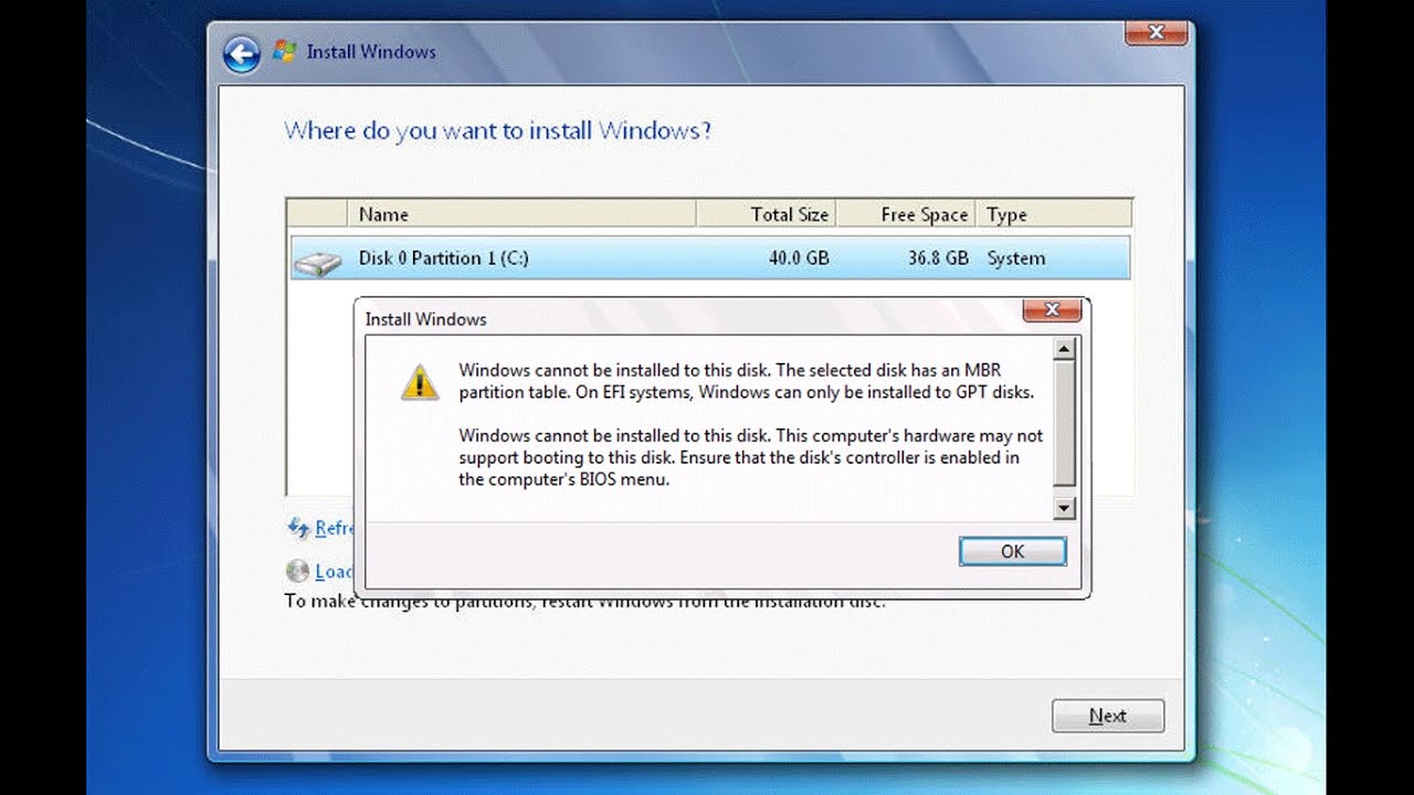

Once again:
The screenshot you posted means that you booted the Windows installer in UEFI mode, but have the disk partitioned in MBR or hybrid modes. Windows complains that you are trying to install Windows in UEFI mode on an MBR (or hybrid) partition.
I have not yet found a way to boot Windows in legacy mode through USB on cMP. If you are able to boot to the boot screen you will see various boot Options. Legacy Windows installer shows a disk image, UEFI windows installer shows the EFI folder. If you burn the Windows 10 installer on a DVD at the boot screen it shows you 2 options:
A DVD image (Legacy) and an EFI folder (UEFI).
