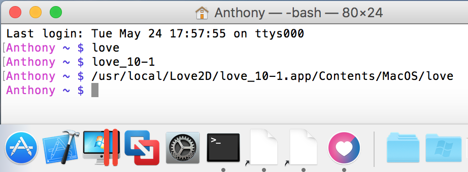

I've recently updated to OS 10.11.5 on my 13" Macbook Pro Retina and am experiencing an issue with symlinks. Whenever I open up a symlink pointing to an executable inside a dot-app package (or opening directly), the icon stays in the dock even after closing the application. I cannot force quit these icons out. These are the symlinks I have in /usr/local/bin in particular.
Code:
lrwxr-xr-x   1 root  wheel     9 Apr 14 17:15 love -> love_10-1
lrwxr-xr-x   1 root  wheel    51 Apr 14 17:14 love_10-1 -> /usr/local/Love2D/love_10-1.app/Contents/MacOS/love
lrwxr-xr-x   1 root  wheel    50 May 24 18:01 love_6-2 -> /usr/local/Love2D/love_6-2.app/Contents/MacOS/love
lrwxr-xr-x   1 root  wheel    50 May 23 12:39 love_7-2 -> /usr/local/Love2D/love_7-2.app/Contents/MacOS/love
lrwxr-xr-x   1 root  wheel    50 May 23 12:48 love_8-0 -> /usr/local/Love2D/love_8-0.app/Contents/MacOS/love
lrwxr-xr-x   1 root  wheel    50 May 23 12:49 love_9-2 -> /usr/local/Love2D/love_9-2.app/Contents/MacOS/love
As you can see, these symlinks all point to an executable within a dot-app package. These are different versions of the Love2D engine if you were curious.
Whichever way I open these executables, an icon is left stuck in the dock and I cannot force close it. The last command is different in that a proper icon is shown (whereas the symlinks show a blank icon). The only way I can launch the executable without it getting stuck is to launch the app itself. If I launch the app as a whole, nothing gets stuck. However, I need to be able to access this program from command line, that's why I set up these symlinks.

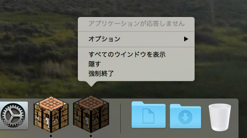

I'm getting very similar behavior, not from symlinks, but from Java programs. In particular, Minecraft, and also the Java control panel for Oracle Java (which I downloaded while trying to figure out the Minecraft problem). The thing that is common between both of these is that they are executing their own copy of Java from within the app. They both leave unkillable, non-responding "java" icons on my dock after the applications finish, and this started happening with 10.11.5. Force quit has no effect, and the system will not shutdown or restart once one of these is on the dock.
(After running and quitting Minecraft twice since boot, two instances of Minecraft's icon left on the dock, saying "This application is not responding.")
