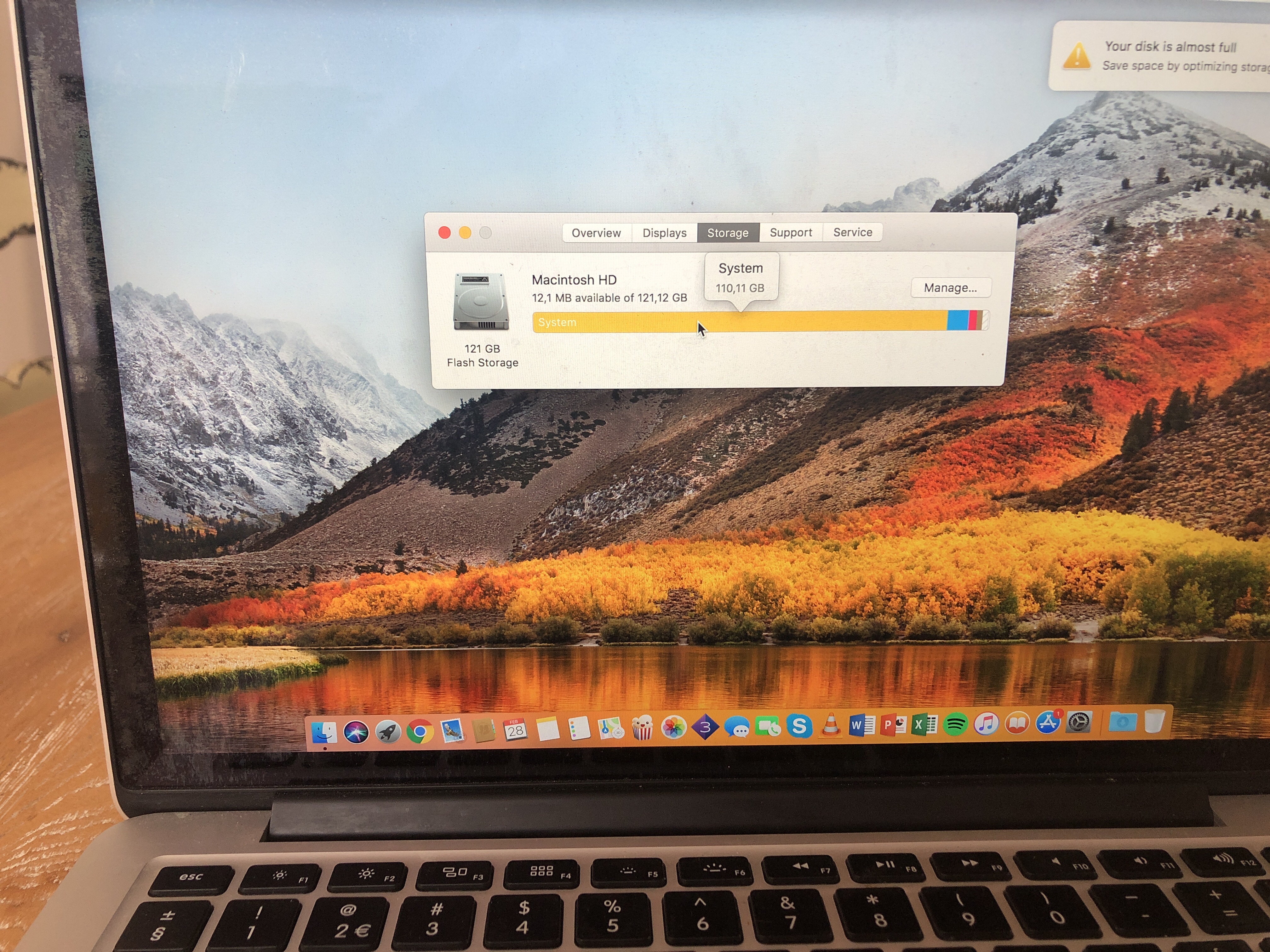

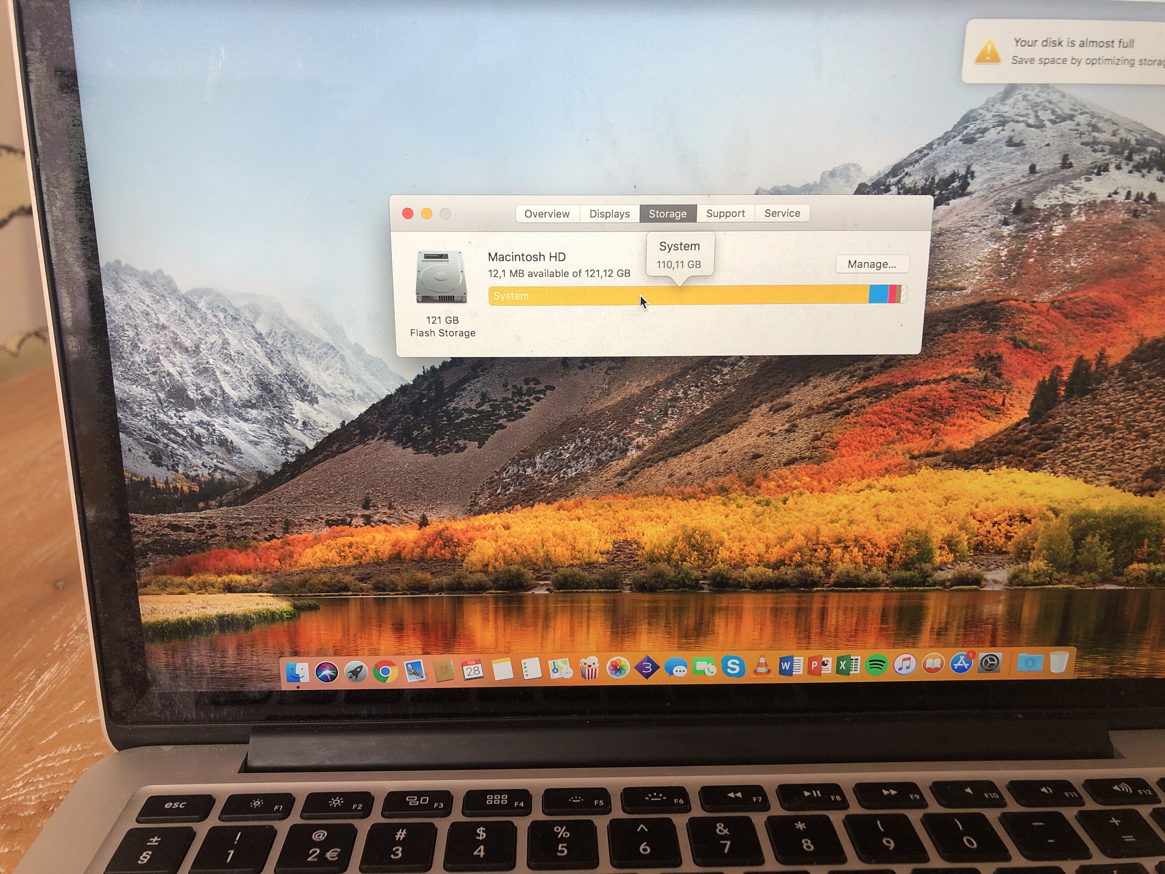

Hi all,
My Macbook Pro (13” Early 2015, running High Sierra 10.13.6)’s storage is currently taken up by system for almost all storage. I can’t seem to free space by deleting files as the system part only grows then. At the moment system takes up over 110gb of data. I’ve attached a picture of that. I only have 12mb’s left of storage so nothing works great.
Can anyone help me please? Really in need!!
Thanks!!
Do you backup with Time Machine? Have you backed up lately? TM saves "snapshots" to your boot drive when your TM disk isn't available.
If this is the case there are a few threads here on the subject already. Search for "snapshots" and "Time Machine".
I did use Time Machine. I tried listing all localsnapshots, without success. So instead I used this code in Terminal which I found in one of the threads here:
Code:
sudo tmutil thinlocalsnapshots / 99999999999 4
It finished in and ‘thinned’ the snapshots, without result in extra storage space. Any other suggestions?
I’m currently running OmniDiskSweeper to get some more info, but it takes a while with this limited space.

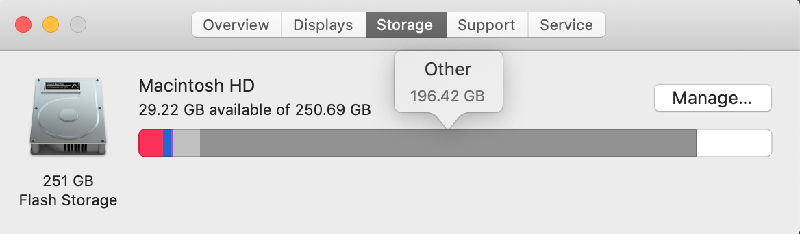

Hi there

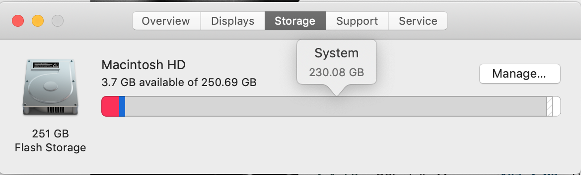

I'm having a similar problem with my Mac system storage. I'm currently on Mojave OS and system storage is taking up 230GB...
I've looked at all the forum advice I can find and have tried to follow it, but I can't see any files that would be taking up that amount of space. I don't use Time Machine, and I don't seem to have any snapshots from TM stored on the system.
I use Mail a lot for work but I don't have 'Log Connection Activity' turned on.
Using 'Get Info' seems to give the same information regarding storage (Ie; 3GB left):

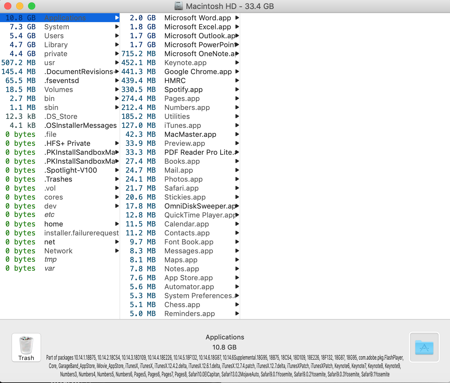

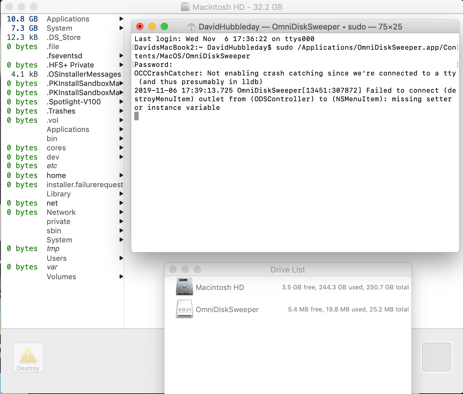

But when I run OmniDisk it seems to only be able to find 30GB of storage used...

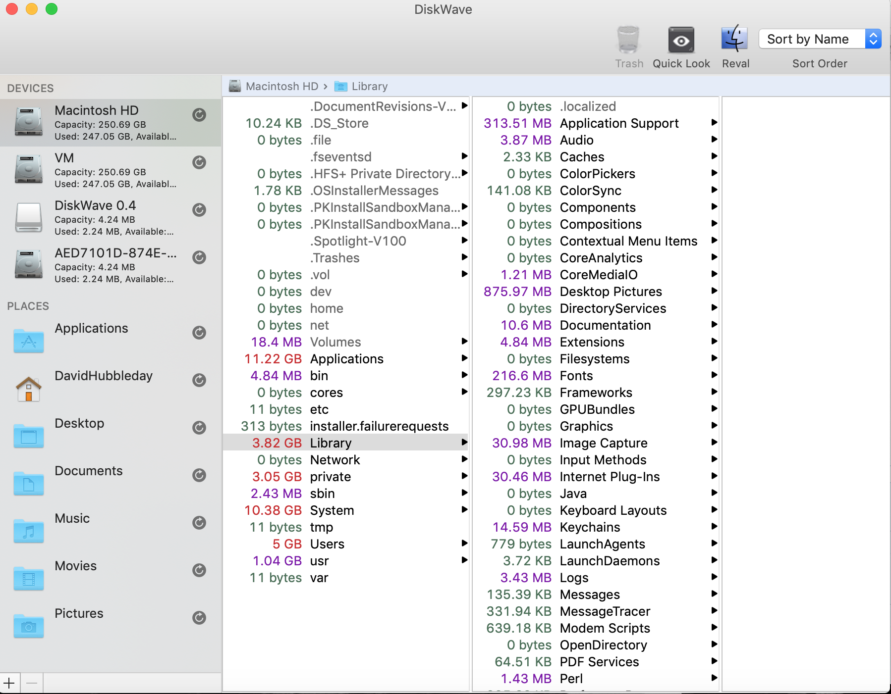

DiskWave also doesn't show any large files that are out of place as far as I can see.

Try running Omni with this command from Terminal so it can see hidden and system files.
Code:
sudo /Applications/OmniDiskSweeper.app/Contents/MacOS/OmniDiskSweeper
Reactions: hobowankenobi

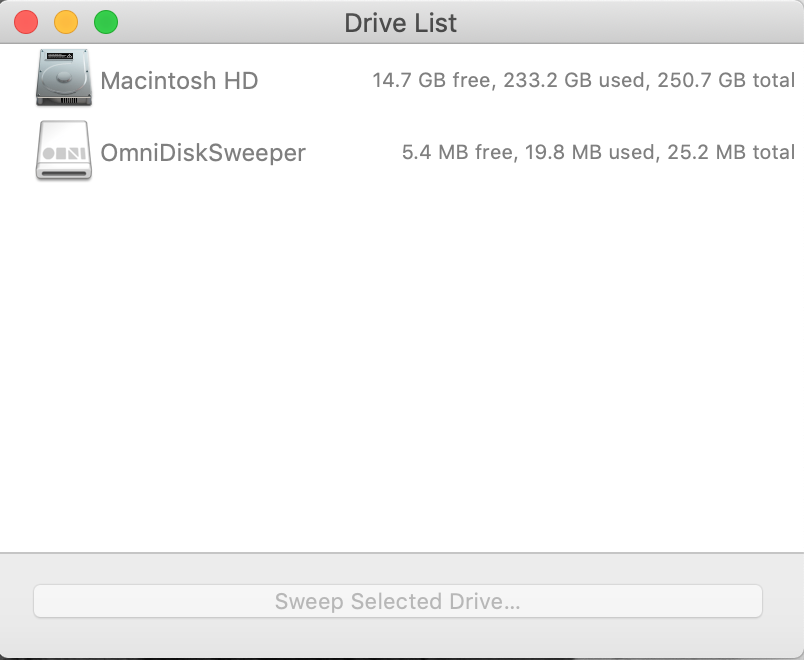

Thanks for your help. I think I've done that right?
But Omni is still showing 32GB on the sweep - but 244GB on the drive list - so I'm really confused? I don't know if the terminal error messages mean anything?
So Omni was not running... then when you ran that command it launched and ran okay? I just want to make sure it is running as sudo.
Hi. I've redone it this morning just to make sure...Omni wasn't running, entered the command into Terminal and ran the scan on Omni (once it had opened up from that terminal command). Is that the right thing to do? Apologies, I'm not overly technical.

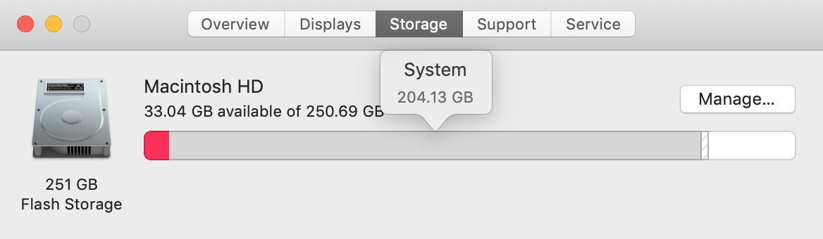

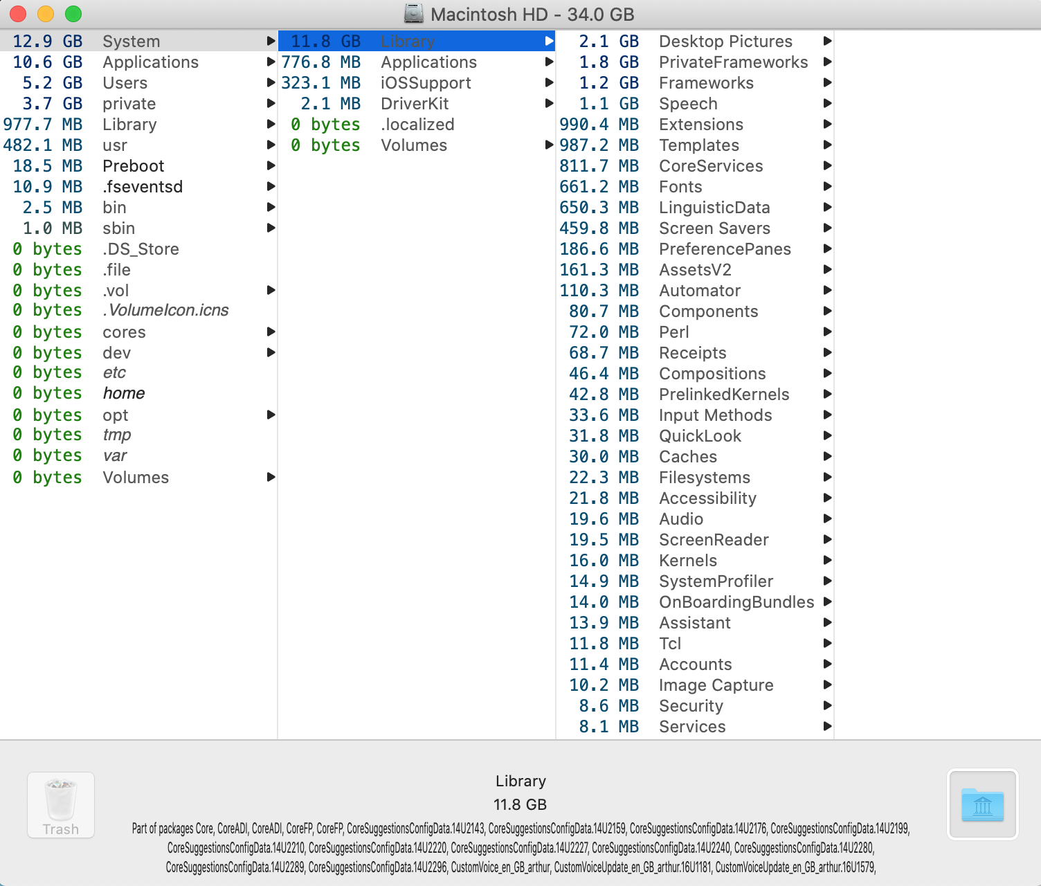

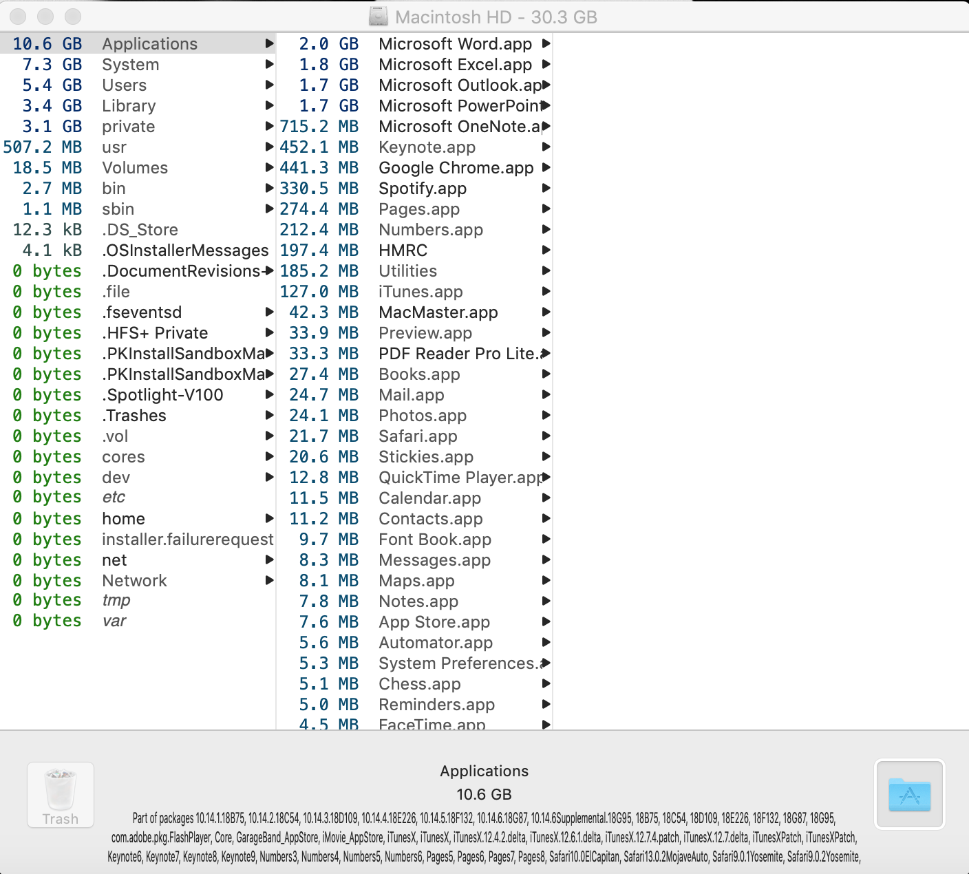

Weirdly, my mac now shows 33GB of free space, Omni Drive list shows 14GB free, and OmniSweep is registering 33GB of space used (if I'm reading it correctly). I haven't done anything other than what we've discussed here - so I'm not sure if that means anything to you or not?
Thanks
Here are the Terminal readouts too if that helps? Should it be having so many 'Operation not permitted' ?
I suggest doing a full backup to an erased external drive, using an app like Carbon Copy Cloner or Super Duper. Then see how much space is used on the external drive. Finally, boot from the external drive, and see what happens to the space over time.
CCC will tell you if it's unable to copy a file due to problems. You should make sure to check its log, and confirm everything gets copied. If it shows something that doesn't get copied, then that may identify a problem file that's related to the missing space.
There's a possibility that the disk with the missing space has some file-system damage. That damage would be a large number of blocks that are marked as allocated, but aren't actually in use by any file. The technical term when this happens in memory management is a "memory leak". For disks, I think it's called "lost blocks".
If the cloned drive shows the same amount of space being used, then you might be able to identify where the space is used. Above, there's a large number of "not permitted" error messages. Those could be masking problems where the space is being consumed. On an external drive that isn't booted, you can disable permissions on the entire drive, which should then let any scan proceed without receiving "not permitted" errors. The procedure to disable permissions is described at the end of this post:
It's the section that describes using the Get Info window.

Really need help with my Mac.. I am on high sierra and i have 130gb on system files and cant delete them. I have gone through most of the commands as stated on these feeds but when i run
sudo du -d 1 -x -c -g /Users/admin/library
it comes up with the following but then wont let me enter into Application support
56 /Users/admin/library/Application Support
0 /Users/admin/library/Maps
1 /Users/admin/library/Assistant
1 /Users/admin/library/Saved Searches
1 /Users/admin/library/Saved Application State
1 /Users/admin/library/IdentityServices
1 /Users/admin/library/WebKit
1 /Users/admin/library/Calendars
1 /Users/admin/library/Preferences
1 /Users/admin/library/Messages
1 /Users/admin/library/Keychains
1 /Users/admin/library/Sharing
0 /Users/admin/library/ColorPickers
0 /Users/admin/library/ColorSync
0 /Users/admin/library/Application Scripts
0 /Users/admin/library/Assistants
1 /Users/admin/library/Mail
0 /Users/admin/library/Compositions
0 /Users/admin/library/GameKit
1 /Users/admin/library/Google
1 /Users/admin/library/LanguageModeling
0 /Users/admin/library/Favorites
1 /Users/admin/library/Passes
0 /Users/admin/library/Family
1 /Users/admin/library/iTunes
0 /Users/admin/library/iMovie
0 /Users/admin/library/CoreData
0 /Users/admin/library/FontCollections
0 /Users/admin/library/Sounds
1 /Users/admin/library/Personas
1 /Users/admin/library/com.apple.internal.ck
1 /Users/admin/library/Printers
1 /Users/admin/library/SyncedPreferences
1 /Users/admin/library/Audio
0 /Users/admin/library/Keyboard Layouts
1 /Users/admin/library/Logs
0 /Users/admin/library/PhotoshopCrashes
0 /Users/admin/library/Internet Plug-Ins
0 /Users/admin/library/Voices
1 /Users/admin/library/Accounts
1 /Users/admin/library/Safari
0 /Users/admin/library/Colors
0 /Users/admin/library/PreferencePanes
1 /Users/admin/library/FileProvider
0 /Users/admin/library/Mobile Documents
1 /Users/admin/library/PubSub
1 /Users/admin/library/Suggestions
1 /Users/admin/library/LaunchAgents
1 /Users/admin/library/Pioneer
1 /Users/admin/library/Group Containers
1 /Users/admin/library/Dictionaries
1 /Users/admin/library/Containers
1 /Users/admin/library/Frameworks
1 /Users/admin/library/Fonts
1 /Users/admin/library/KeyboardServices
1 /Users/admin/library/Metadata
0 /Users/admin/library/Screen Savers
0 /Users/admin/library/CallServices
1 /Users/admin/library/Spelling
0 /Users/admin/library/SafariSafeBrowsing
0 /Users/admin/library/Input Methods
1 /Users/admin/library/Cookies
0 /Users/admin/library/Services
1 /Users/admin/library/CoreFollowUp
1 /Users/admin/library/Caches
59 /Users/admin/library
59 total
also wont let me delete snapshots
Please please help
