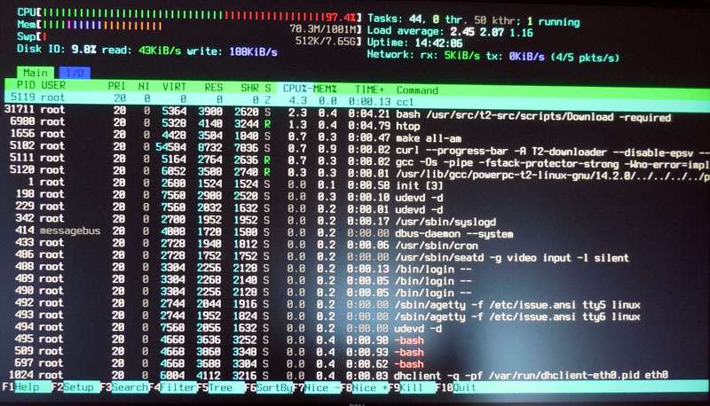

I wanted to see if gcc14 is any better than gcc4, or if it just has 10 more layers of bloat. I'm now compiling different things to compare against the same code compiled with gcc under Mac OS X 10.4...

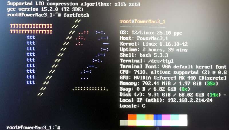

Can confirm that it works, helped the distro maintainer with pre-testing last month:

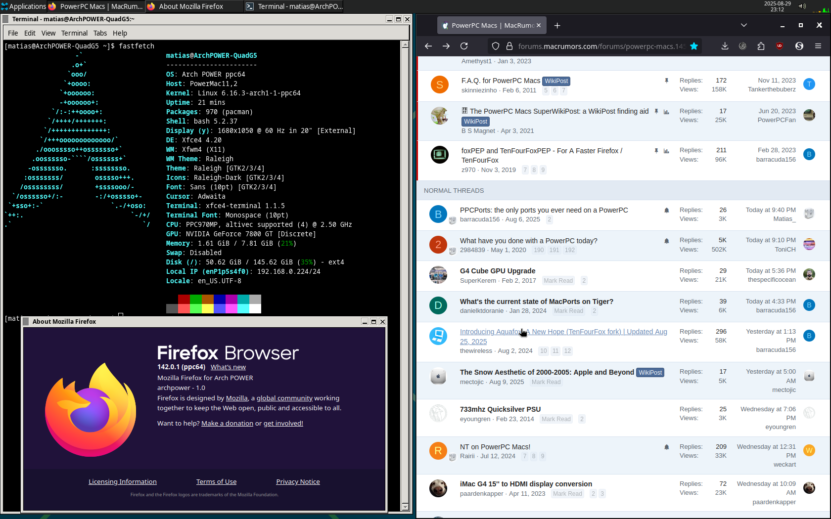

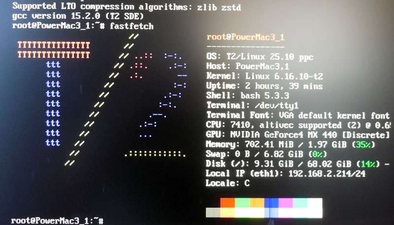

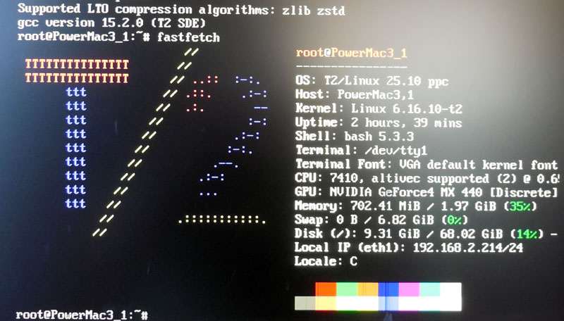

T2 is up to date on PowerPC (and a whole bunch of other architectures). I don't have a G5 to try firefox; I think it is still broken on 32bit. Arcticfox works though.

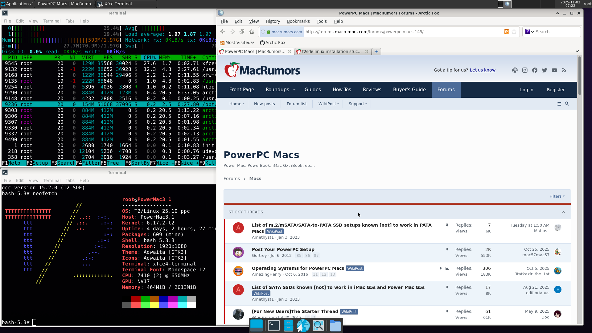

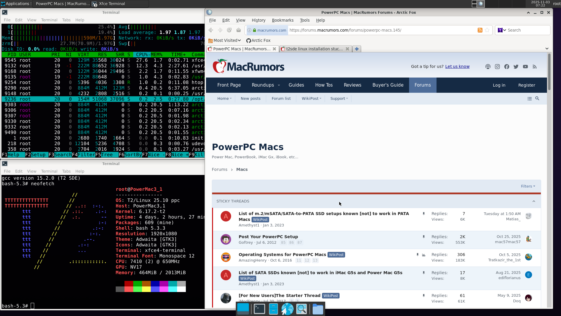

I got xwindows to load with the frame buffer. I'm not very good with linux and I'm not sure how to get the accelerated drivers to load. Searching on the error messages hasn't turned up anything useful so far.
I think firefox 136 should build for 32-bit (at least there is a version for 386). I may give that a try.
