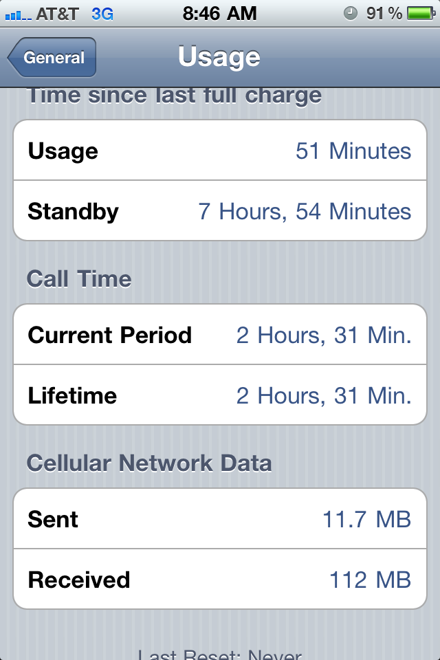

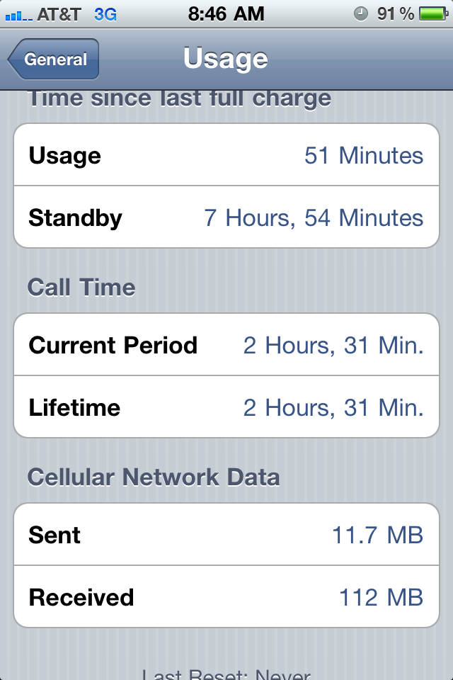

Well my battery is 100% worse than before jailbreaking. I haven't changed any settings and the first three days I had the phone I charged the battery to 100% and when I woke up it was at 99% with 3 to 4 min usage. Now after jailbreaking and having my3g,sbsettings , and 5 columns. After charging it to 100% for the past 3 nights my battery is actually getting worse. Now it's at 51 min usage and 90% battery. I have EVERYTHING turned off just like the phone was when it wasn't jb.
