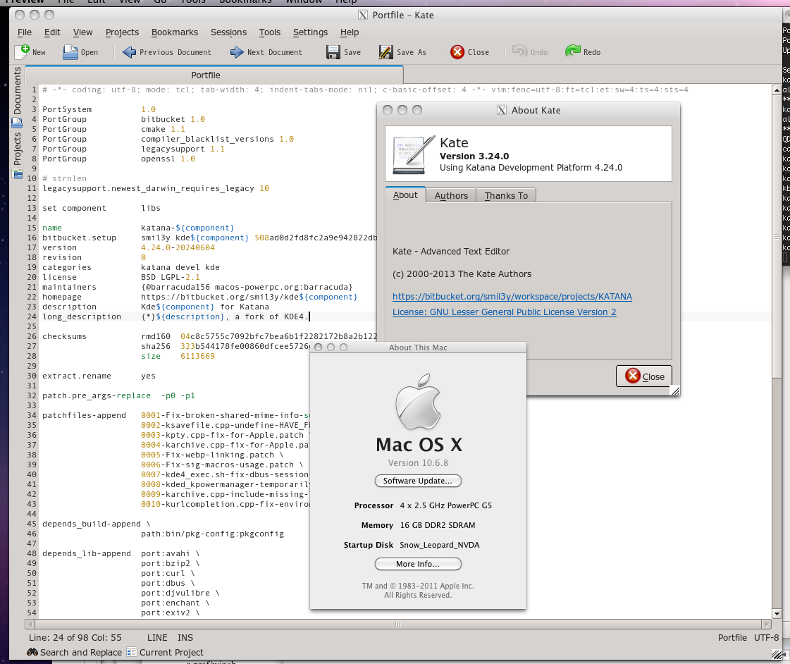

haven't tried it, didn't know there was a Kate build for Leopard (so PowerPC, right ? not Snow Leopard/Intel, on the Kate web site only ARM and Intel are mentioned, not PowerPC, maybe you'd have a link ?).
It is not Qt6-based [yet], but I have fixed Katana version of it.

If you wanna try:
1. Assuming you have Xcode, install these two: https://macos-powerpc.org/PPCPorts/curl-Leopard-8.13.0-ppc_ppc64.zip
(The final stage of installation takes time, since the script runs indexing of ports. It is not frozen, let it do its thing.)
2. If you had MacPorts installed earlier, edit `/opt/local/etc/macports/sources.conf` so that it looks like this:
Code:
rsync://macos-powerpc.org/macos-powerpc/PPCPorts/powerpc-ports.tar
rsync://rsync.macports.org/macports/release/tarballs/ports.tar [default]
3. Run `sudo port -v sync` to make sure everything is coherent.
4. Install the port which has Kate: `sudo port -v -N install katana-workspace`.
It will build a lot of stuff, if this is done from scratch. If something fails, please open an issue here: https://github.com/macos-powerpc/powerpc-ports/issues

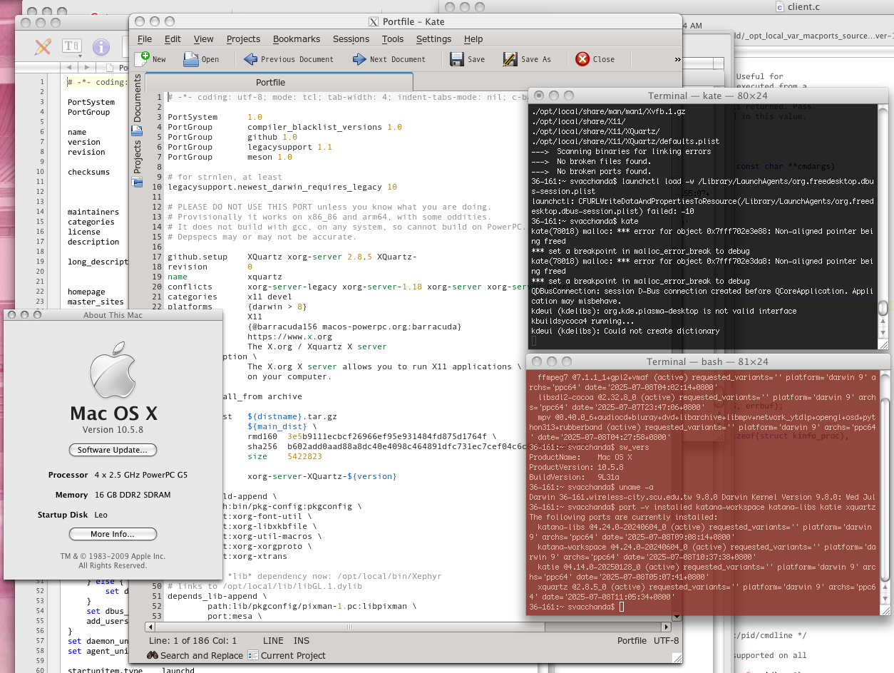

@barracuda156 this might not ping you due to it being edited in, but kate on the katana-workspace port appears to not launch for me due to a broken dbus (throws a session bus not found error).
Did you launch dbus session though? All KDE needs that. You can get the command from `port notes lollypop`, for example, if I forgot it in Katana. Run the command from normal user, without sudo.
Make sure you have either xquartz port or xorg-server-legacy installed and running (reboot after installation). Katana uses X11.
Ended up with a "Couldn't stat" error with no such file or directory. Will open an issue on repo (so that this thread doesn't get hijacked any more than it already is)
