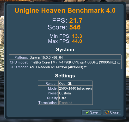

Old 2014 maxed-out rimac, (i7 4GHz/295x). Ran it through a couple of times to get the GPU up to temperature and then benchmarked when it was stable, with the fans very slightly on and the temperature steady at 99. Surprised you haven't had one of these on here yet. I only bothered doing this because I was surprised the 295X beat the 395X at Cinebench just slightly. Same results with Heaven:
weirdly, your 775 unigine score is higher than the 780 scores??
and it cant be due to any throttling/heat issue, cos my 780 never got over 80c during the test.

The results all over the place, but at least its more clear. The thread is doing its work. Maybe we should try different benchmarks, or find a game a lot of people have and benchmark that?
All the cards are scoring within 2-3 frames of each other on unigine. The cinebench scores seems to make much more sense.
Indeed. Will be interesting to see the lower spec cards' results. But the 395X looks seriously underwhelming from here, especially given the price increase (the current top of the range imac in NZ is $1000 more than it was a year ago).
I can confirm I get the same Cinebench results as the french website review, too.
They might be close, but the percentage differences are the same between the two tests for the results that are in so far. There's a big difference between 17fps and 21fps. The exception is the 680 score on unigine, which seems very strange indeed given its Cinebench score.

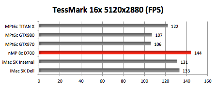

GPUtest- TessMark
This benchmark measures tessellation processing speed. The more levels, the more GPU processing power is required. We tested with 16 and 32 levels. (RED graph bar means FASTEST in FRAMES per SECOND.)
http://barefeats.com/mpt5k1.html

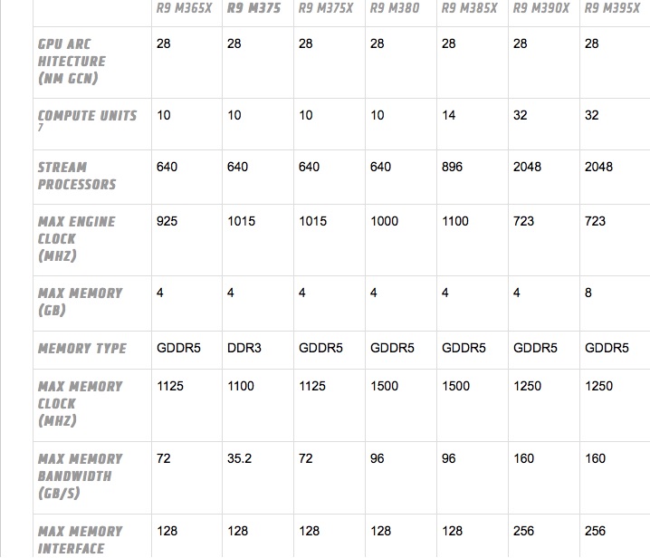

Thinking about it and looking at the benchmarks more, the M395X is most likely a rebrand of the M295X so the performance increase shown is likely all due to Skylake update over Broadwell (which is the chip I believe is in the 2014 5k iMac).
