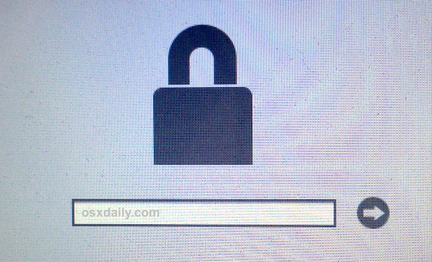

Hi Everyone.
I've got myself into a not-so-great situation and I'm hoping someone here might be able to help me out. I went out and bought myself a replacement secondhand MacBook recently, so that I could retire my dying 2012 MBP (display issues, can't justify fixing). I thought I was relatively cautious, ensuring that it wasn't signed in with an Apple ID etc. I even ran a stress test just for the sake of it. Everything looked good so I decided to grab it.
Long story short, I got it home and created a bootable USB installer (My 'new' MBP has MacOS Catalina installed, and I want to downgrade it to Mojave to use some old 32-bit apps that I have) only to discover that it's locked with a firmware password. I've been in contact with the previous owner and they have given me a few things to try, but they haven't unlocked it. I've also taken the appropriate avenues to ensure it wasn't stolen (or at least reported stolen) in my state by taking it to my local Police Station and having them check the serial # etc.
So, now I am in talks with my local Authorised Apple Service Provider to try and work out what my options are - I know their 'standard practice' to remove the password is to have proof of purchase supplied, but I'm hoping that since the laptop is older (2013) there might be some leniency or another way that I can go about it. The device isn't iCloud locked or anything like that, it just has this firmware password set.
So, my question for the forum is simply whether I can somehow 'get around' this firmware password and downgrade the OS. I've considered a VM and may take that avenue if I have to, but would much prefer to just install the older OS on the MBP itself.
I apologise if this has been asked/answered before - I did some searching before making this post but there wasn't anything that answered my question specifically. I know the Firmware password cannot be removed and I've accepted that, hopefully Apple can help me out with that!
For the sake of including it (not that I think it will be of much help) my 'new' laptop is a 2013 MBP 15".
Thanks in advance!
