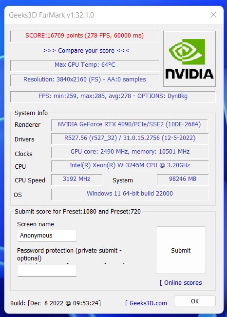

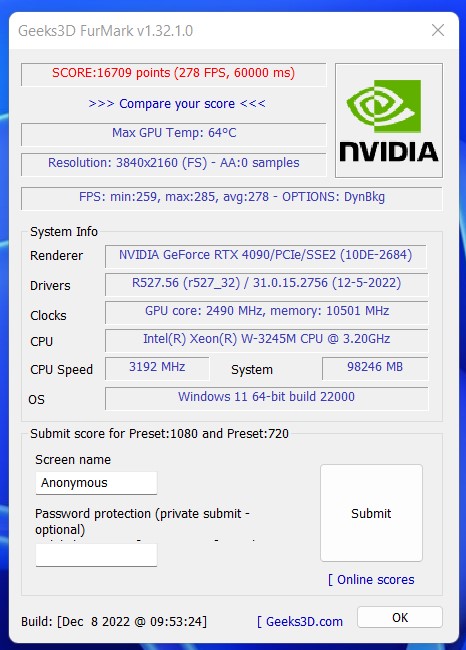

Well i have it up and running, and here is a screen shot of furmark at 4k and results.

Well i have it up and running, and here is a screen shot of furmark at 4k and results.View attachment 2129402

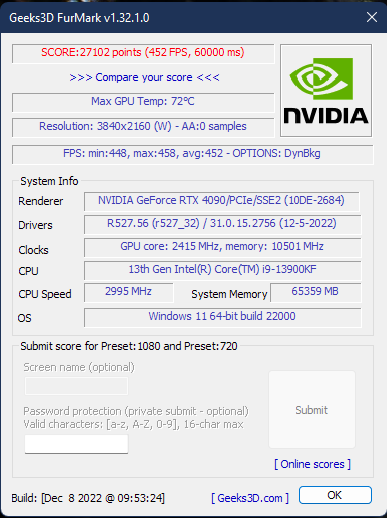

Replying to this post for anyone wondering how much the 4090 is bottlenecked by the Xeon... The answer is, quite a bit! Here's my PC build with a 13900k and a base Zotac 4090, which is power-limited to 450w. Running this on my 34" ultrawide, so I had to run it in 4k windowed, vs 4k fullscreen, so not quite apples-to-apples, but it's rendering the exact same scene, at the exact same resolution.
A really important thing to note - the 4090 was a fantastic upgrade from the 3090 for me. Yes, it's faster, obviously, but I honestly wasn't aching for more speed, but what really surprised me is how quiet the thing is. It's the quietest air-cooled video card I've owned in decades, by a huge margin! Honestly quieter than most of the water-cooled cards I've used, as well. Overall, my desktop sitting on my floor, running at full-tilt, is quieter than my loaded Mac Studio doing the same - mostly because of the pitch of the noise. It does remain quiet regardless of what I do - I've not gotten it to be loud with gaming at all, and even running Furmark was surprisingly quiet. Overall VERY impressed.

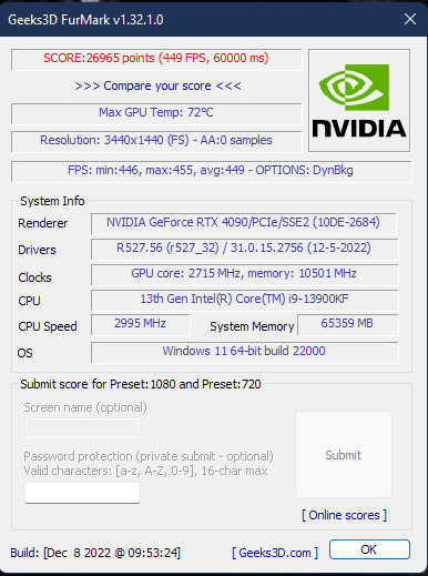

I also ran it fullscreen at full resolution (3440x1440) to see the result:
