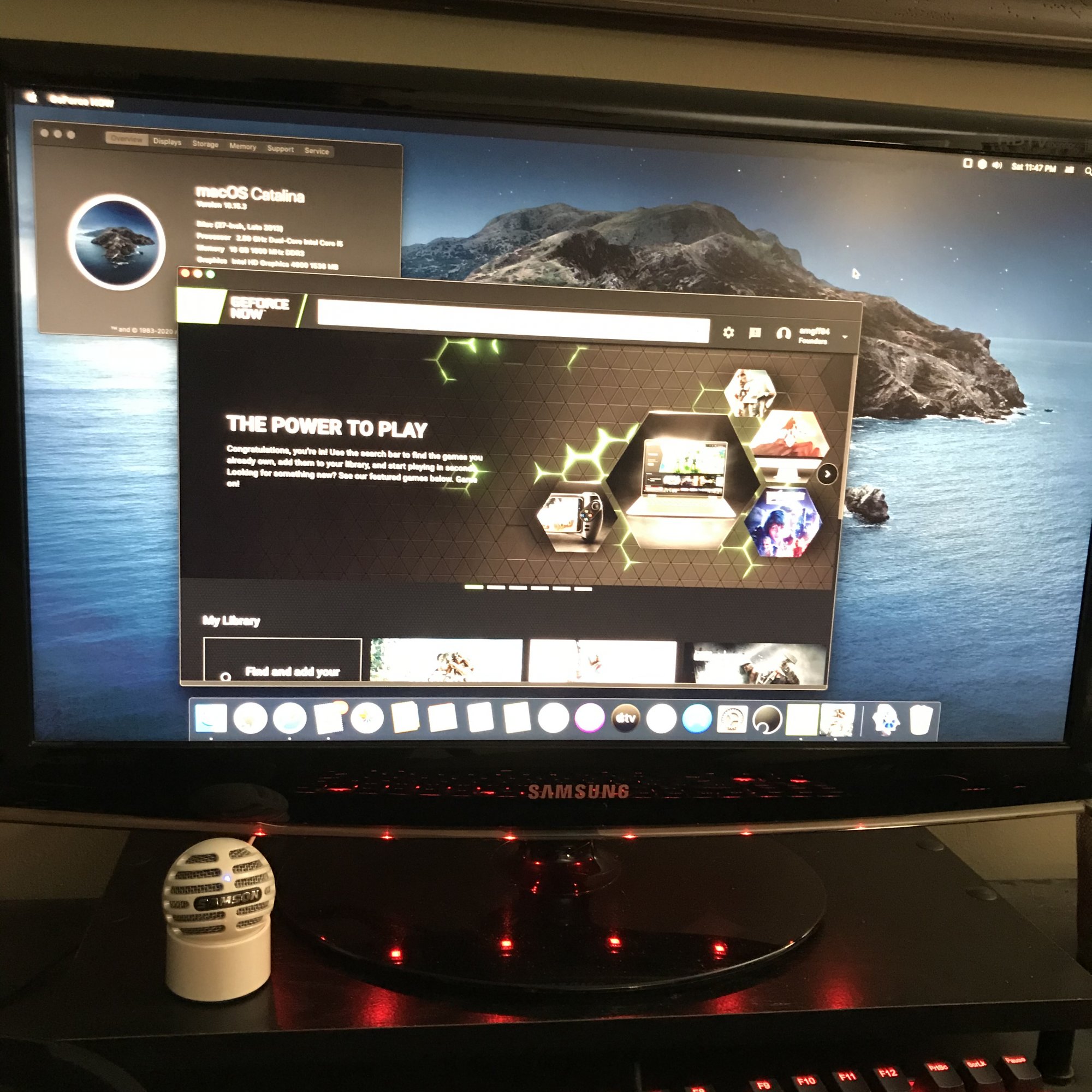

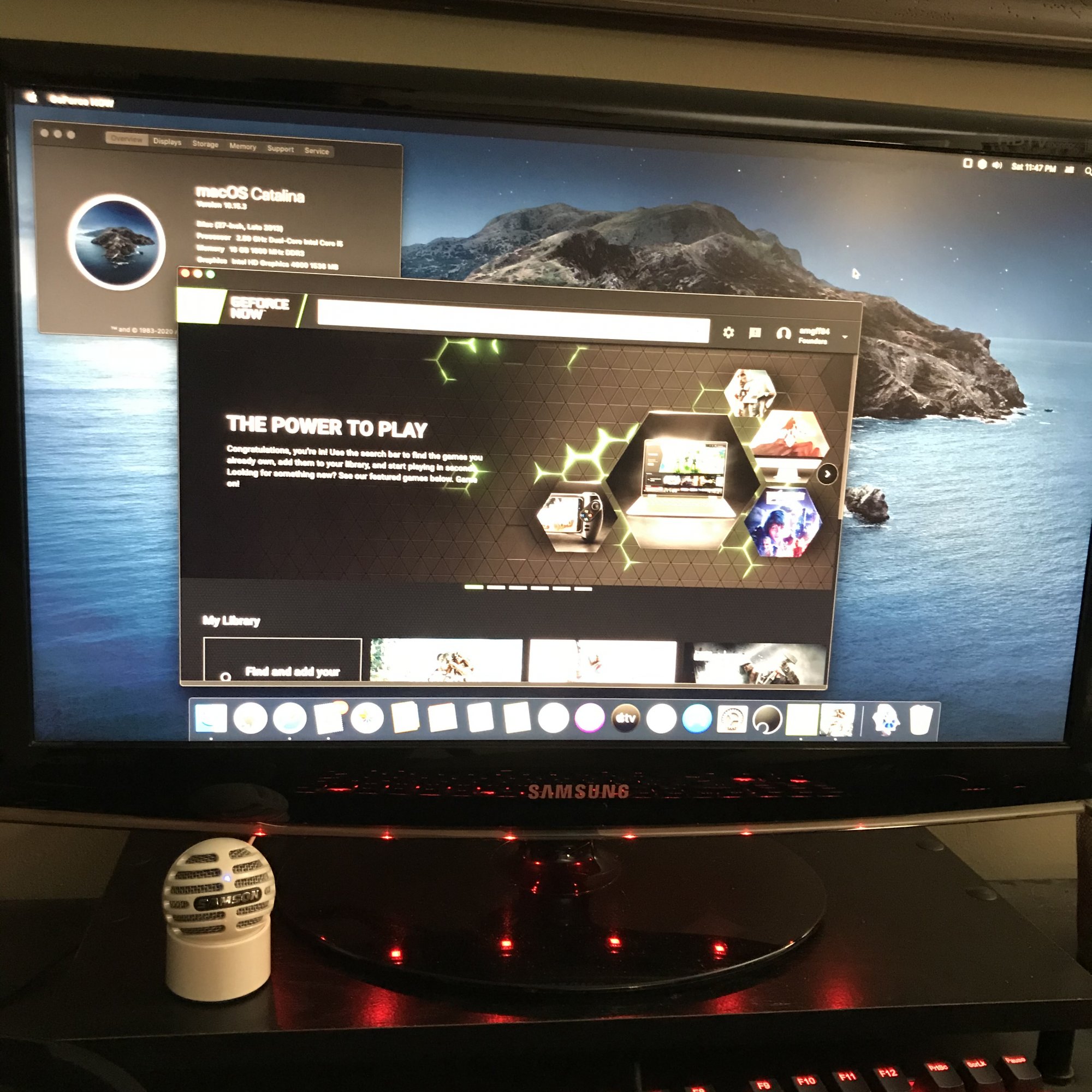

I've just swapped out my Nvidia card for a cheap RX570 from eBay to try and get off High Sierra. Having some trouble with the Catelina installed: I get a kernel error trying to boot it. Think it might by apfs.efi related
I had a lot of trouble after this switch with graphics freezes. Enabling the IGPU fixed that so at least my current OS is working fine again
I had the 570 in my gaming pc for a bit. It performed well under windows and was able to take a hefty overclock. I think a lot of the 560/570's are just 580's that weren't up to the task of a 580, as I also had a 480 that was flashed to a 570 for comparison of performance and there was little to no difference.

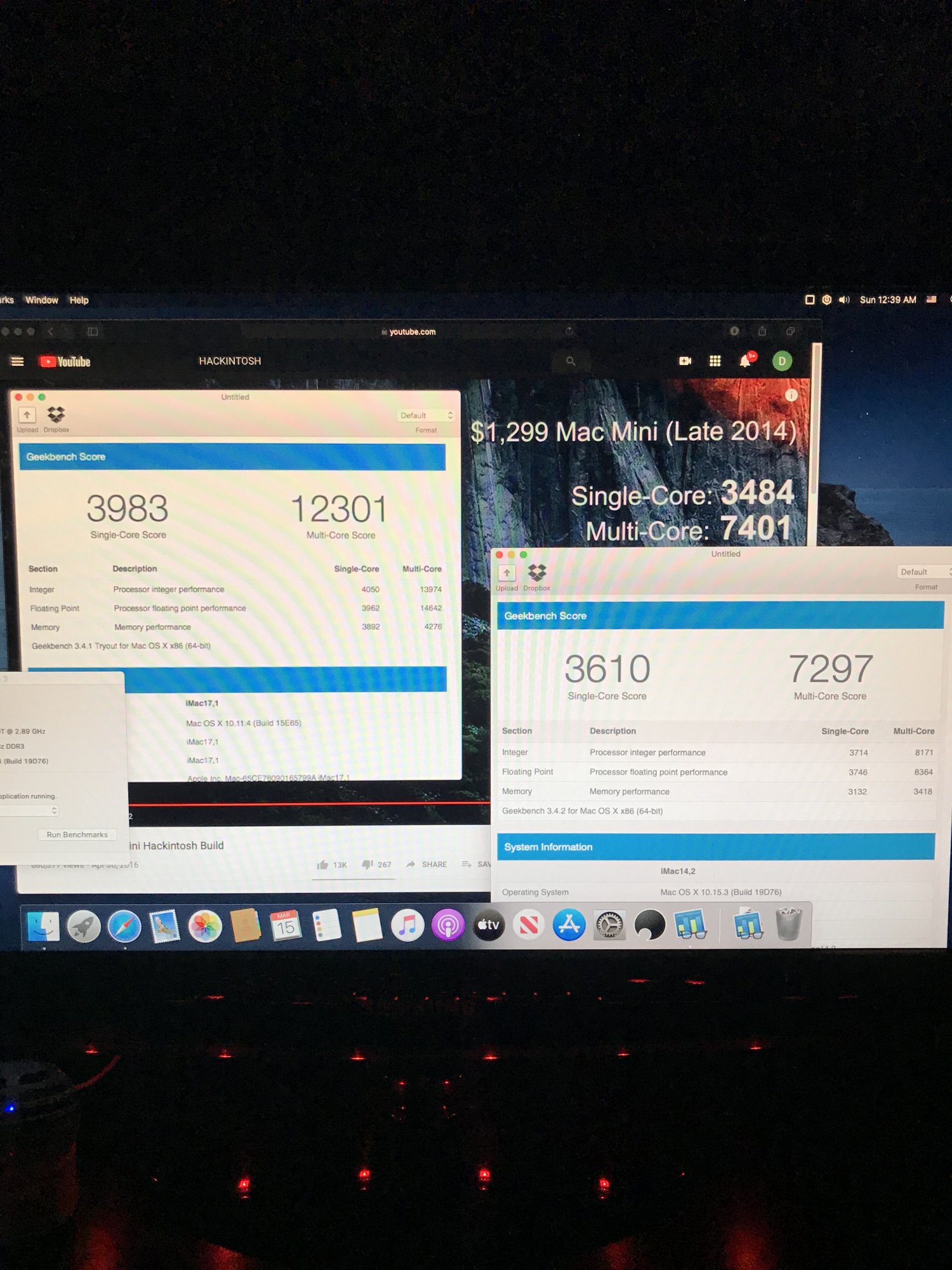

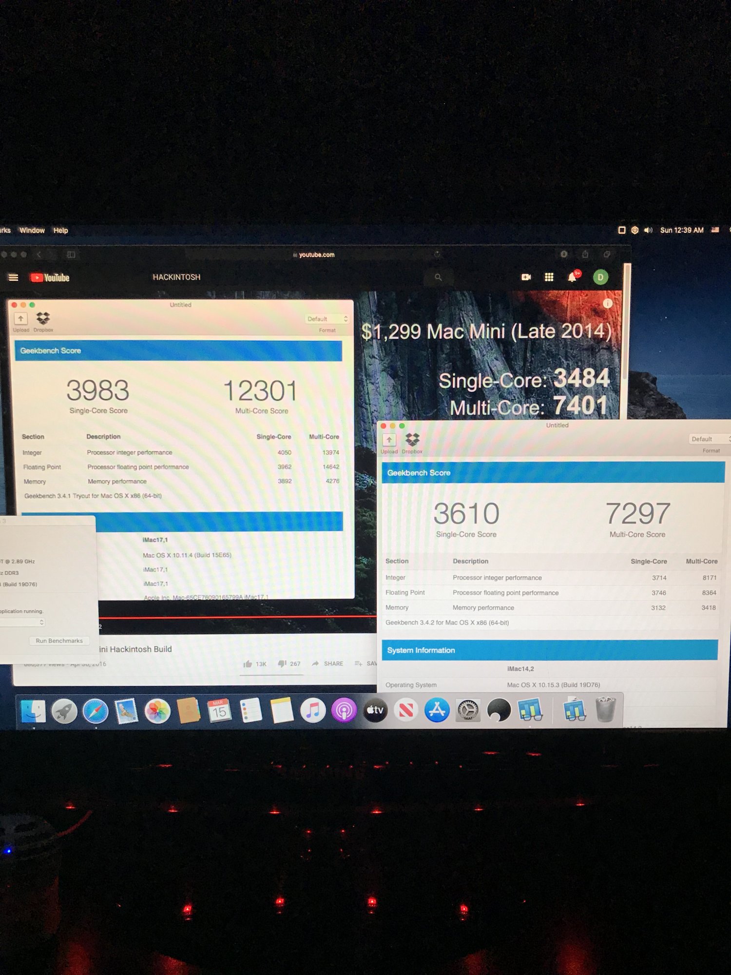

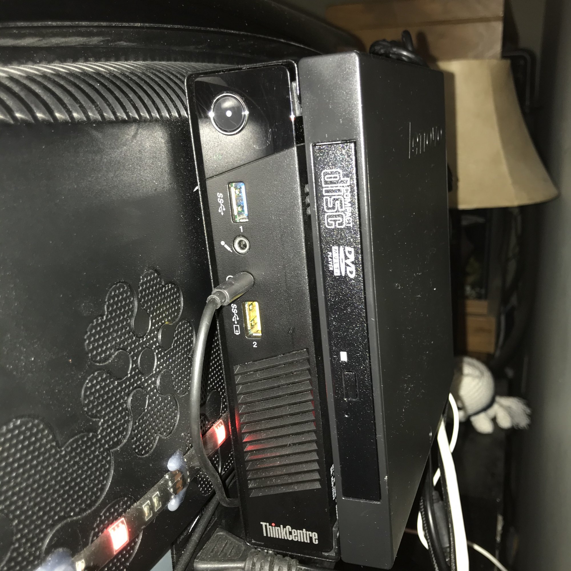

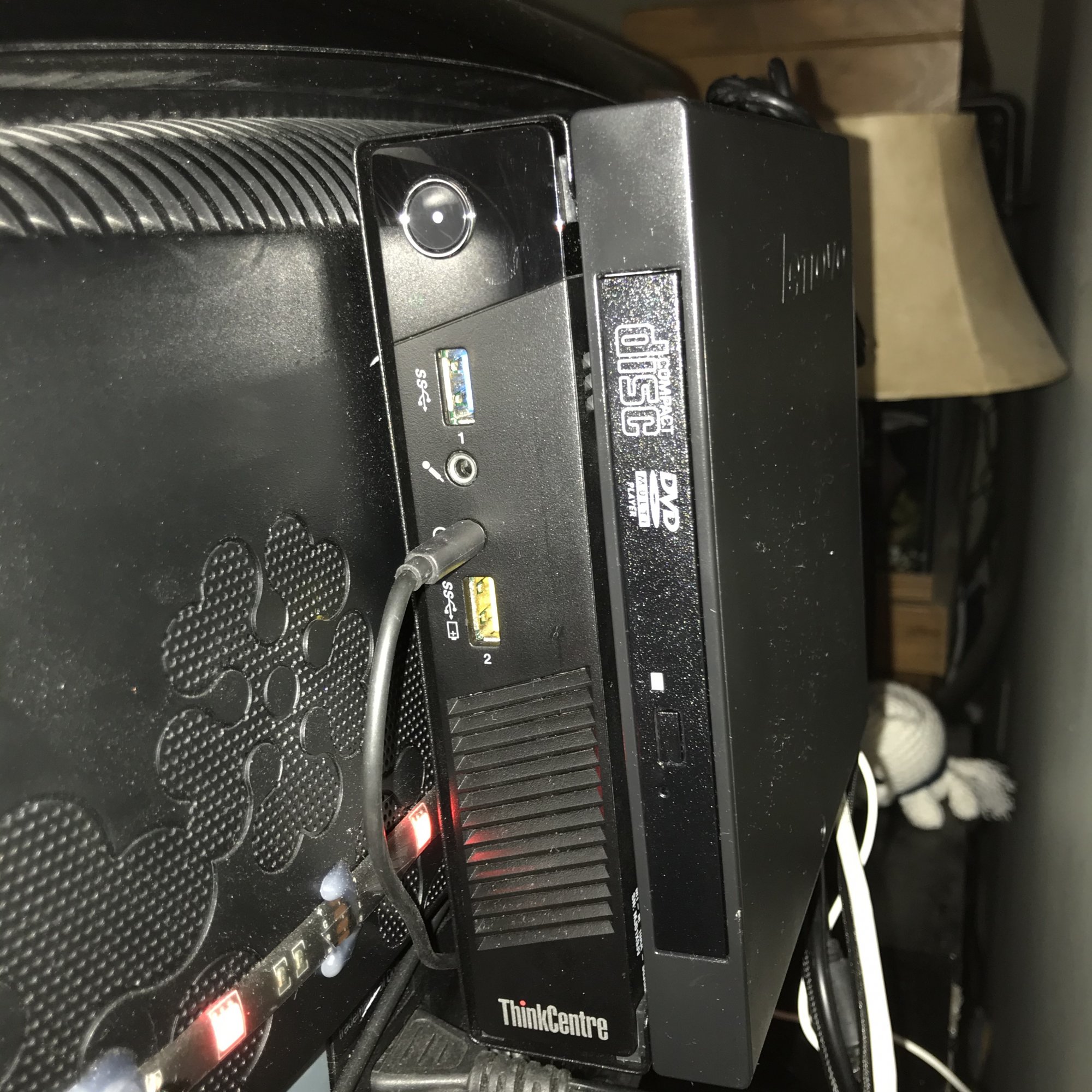

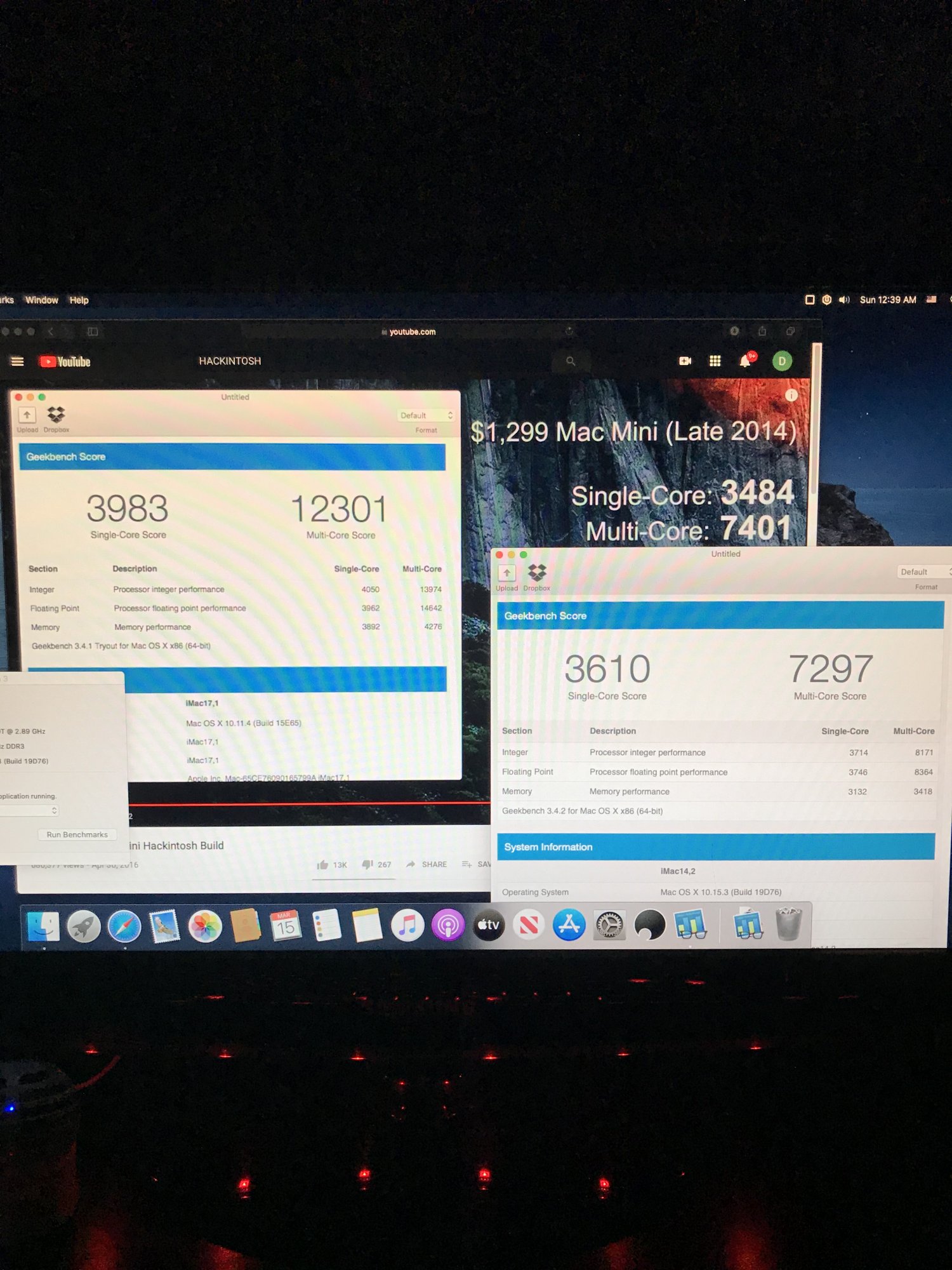

So my first Hackintosh build was a success thanks to Technolli over at Youtube.com, and a post on tonymacx86.com by giggamax. Other's too, through random google searches.
The machine is a Lenovo M93p Tiny. It is slightly smaller than the Mac mini, however it includes a VESA mount with DVD add-on, so it becomes taller than a Mac mini. Specs are respectable being a dual core i5 4570T, with an optional upgrade to a quad core i7 4765T. 16gb Ram, HD4600 (1.5gb VRAM) graphics on the i5 but the upgraded 4765T has Iris? Maybe? I forget... Anyhow, a 480gb SSD... I think I got everything there. Also, it is running macOS Catalina and quite nicely as well. No wifi or bluetooth either, but I don't use those features anyways, but it can be added easily.
The only issue I have is wake from sleep, as it will restart after it wakes from the sleep and returns to either desktop or login screen. I have found some fixes but so far the two I have tried have not worked. This isn't a huge issue as I just disabled computer sleep and enabled monitor sleep as usual. If anyone has a fix for this, it would be cool. I am new to hackintoshing, so be easy on me.
I started the process following two guides from Technolli, one making the USB stick, and the other adding in the proper plist file and installing the system. I then did a little research into a few things and discovered the guide on tonymac by giggamax. This updated clover and added better suited kexts, however, I have seen no difference between the two sets of kexts, but the updated plist worked well and as a bonus it simplified the boot loader screen. The "wakefromsleep" issue persisted throughout all of this. Nothing has seemed to remedy it. Not deleting the power management plist, which allows the OS to recreate it after reboot, nor did changing a few settings in bios.

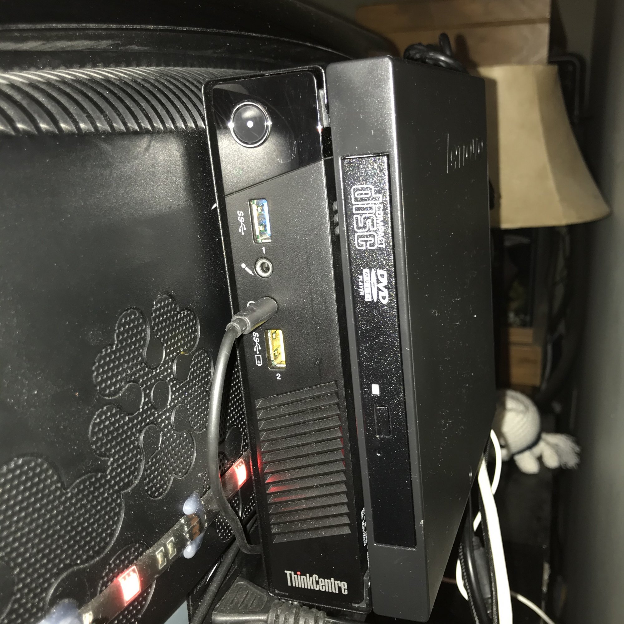

View attachment 899330View attachment 899331View attachment 899332
Just an update, but using an Opencore boot loader and the system is flawless.
Even the sleep issue?
Yes! Same guy from YouTube, Technolli, has an opencore haswell video. I followed along that and the end result, everything works as it should. Haven’t tested updates but I installed the latest anyways. If you need help finding his video lmk. This guide should work for all major intel generations and I can help find the website I used, which is also provided in the video.
I forgot to mention, it's possible that you can somewhat repair sleep by eliminating hibernation via the terminal.

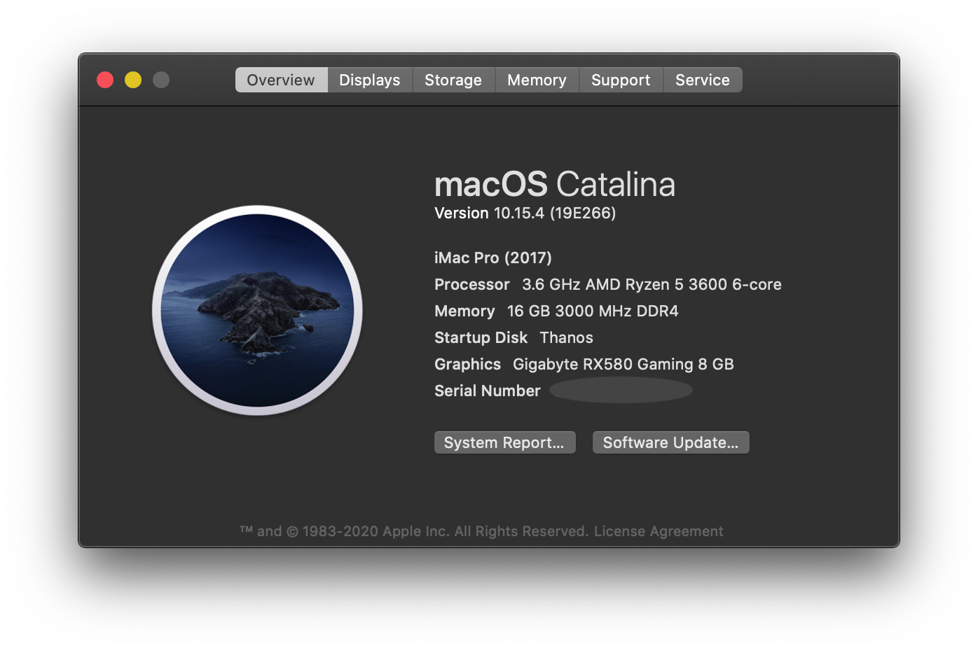

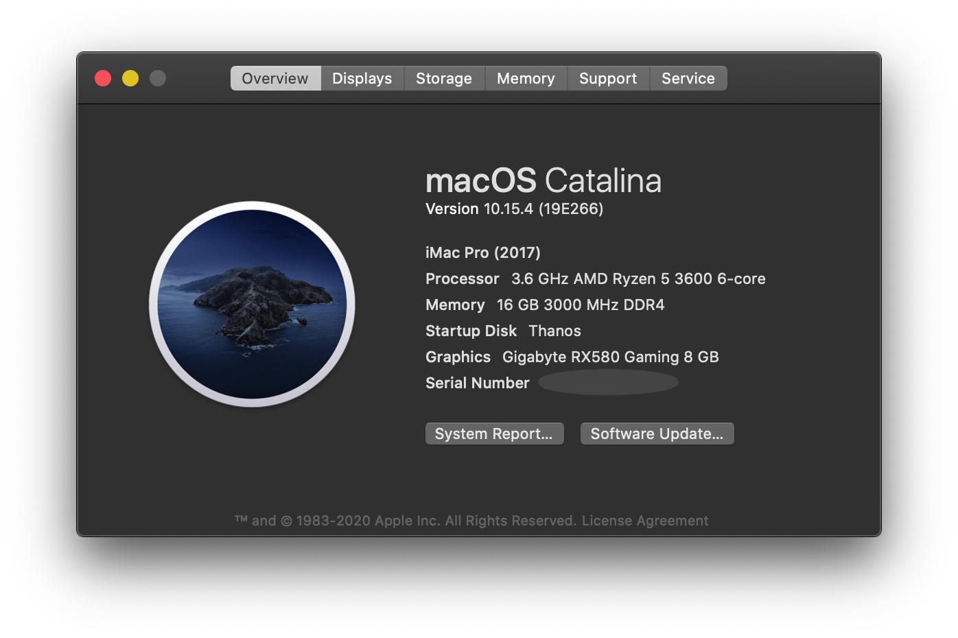

So, I bought an inexpensive walmart special as backup to my hack. Wanted to see how hard it was to hackintosh an AMD Ryzen...... It was super easy......
These are impressive specs for a BUDGET Hackintosh. Nice!
Reactions: peanuts_of_pathos
It came with 8 GB ram and a 4 GB MSI RX580, still not bad for less than $850 out the door. I spent twice that when I built my Skylake rig 4 years ago. Since I use the new one more I swapped the video cards 😎

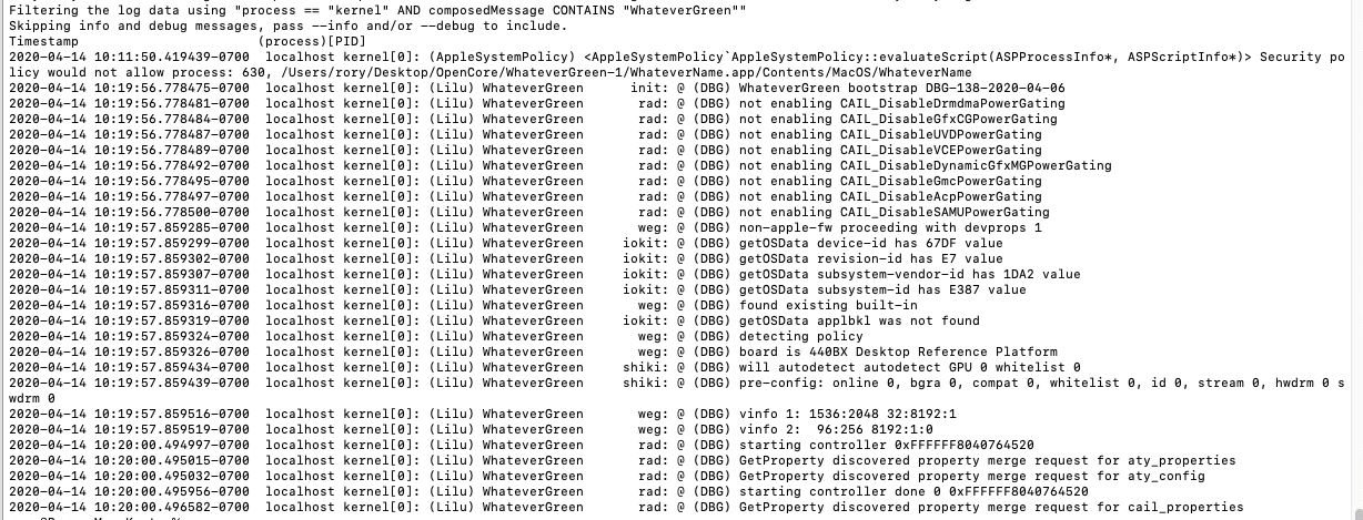

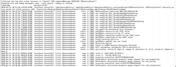

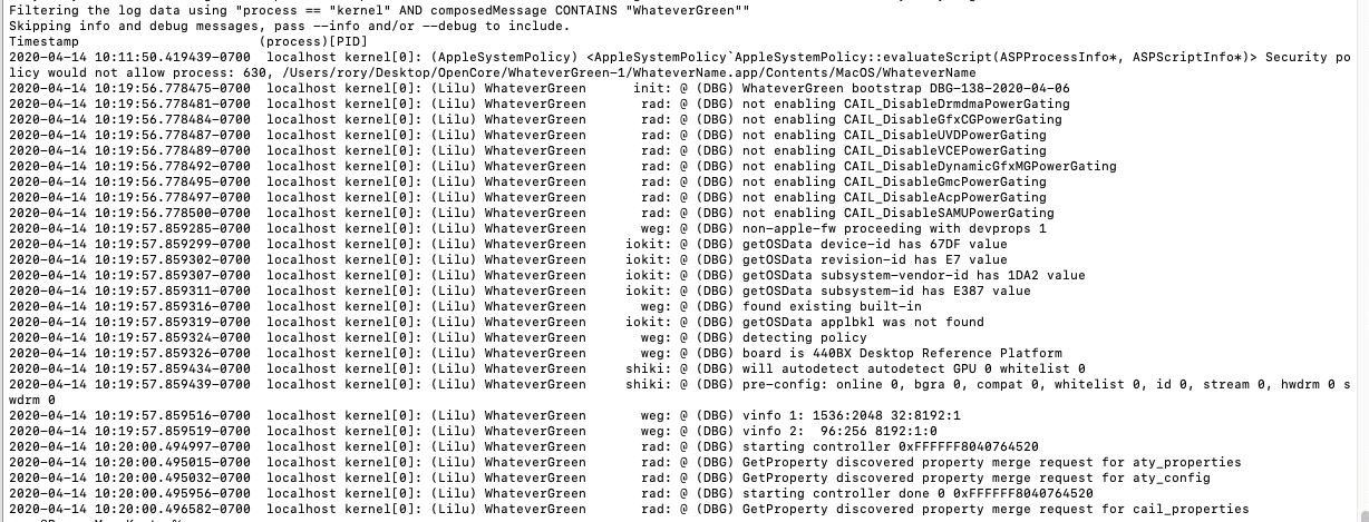

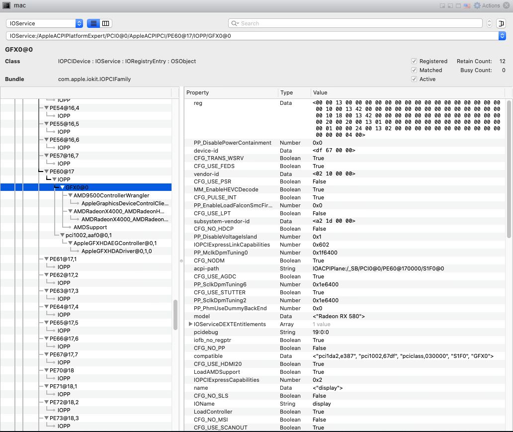

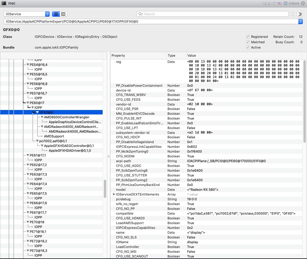

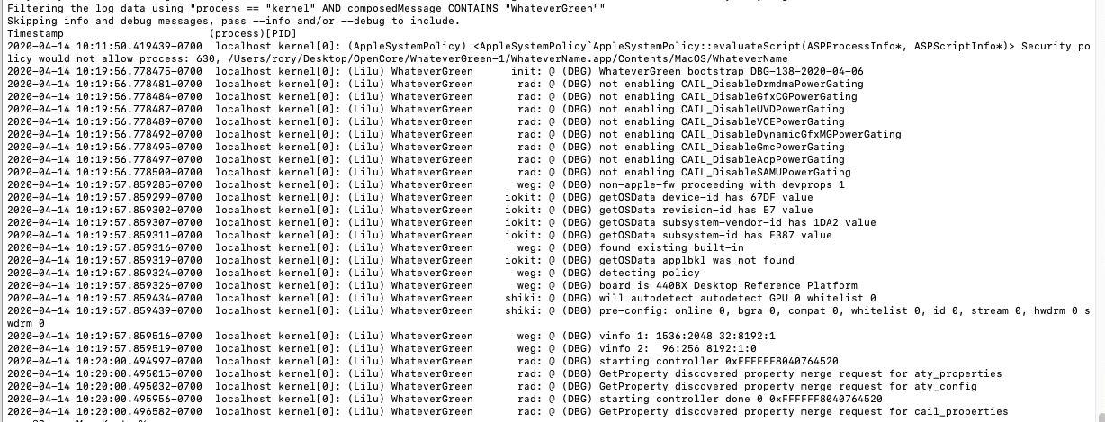

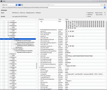

The work on OpenCore for the 5,1 to support Catalina has inspired me to try to fix GPU passthru for ESXi...
Background: GPU passthru for ESXi has been broken since Mojave, I am trying to see if a combination of OpenCore and WhateverGreen can fix this.
System : Dell server with E5-2600 V3 series processors, ESXi 6.7u3, unlocker 3.0, AMD RX580 video card. As a baseline I configured passthru for a windows 10 client and it works perfectly...
Step 1: Configure a Catalina 10.15.4 guest with passthru: system information lists the "display" adapter as a GPU on PCIe, correctly shows vendorID and board ID. Does not detect attached monitor and no video output.
Step2: Install OpenCore, Lilu, and WhateverGreen. VIrtualSMC and -no_compat_check are not needed. System boots to OpenCore boot picker, after timeout or hitting enter the system boots to Catalina. System information now shows "Radeon RX 580" GPU on PCIe, but again does not detect attached monitor and no video output
Step 3: enabled WhateverGreen debug output. See attached logs.
Any help/pointers on what is going on wrong would be appreciated. I am new to WhateverGreen; hopefully the attached output will reveal an obvious problem to someone more familiar to WhateverGreen...

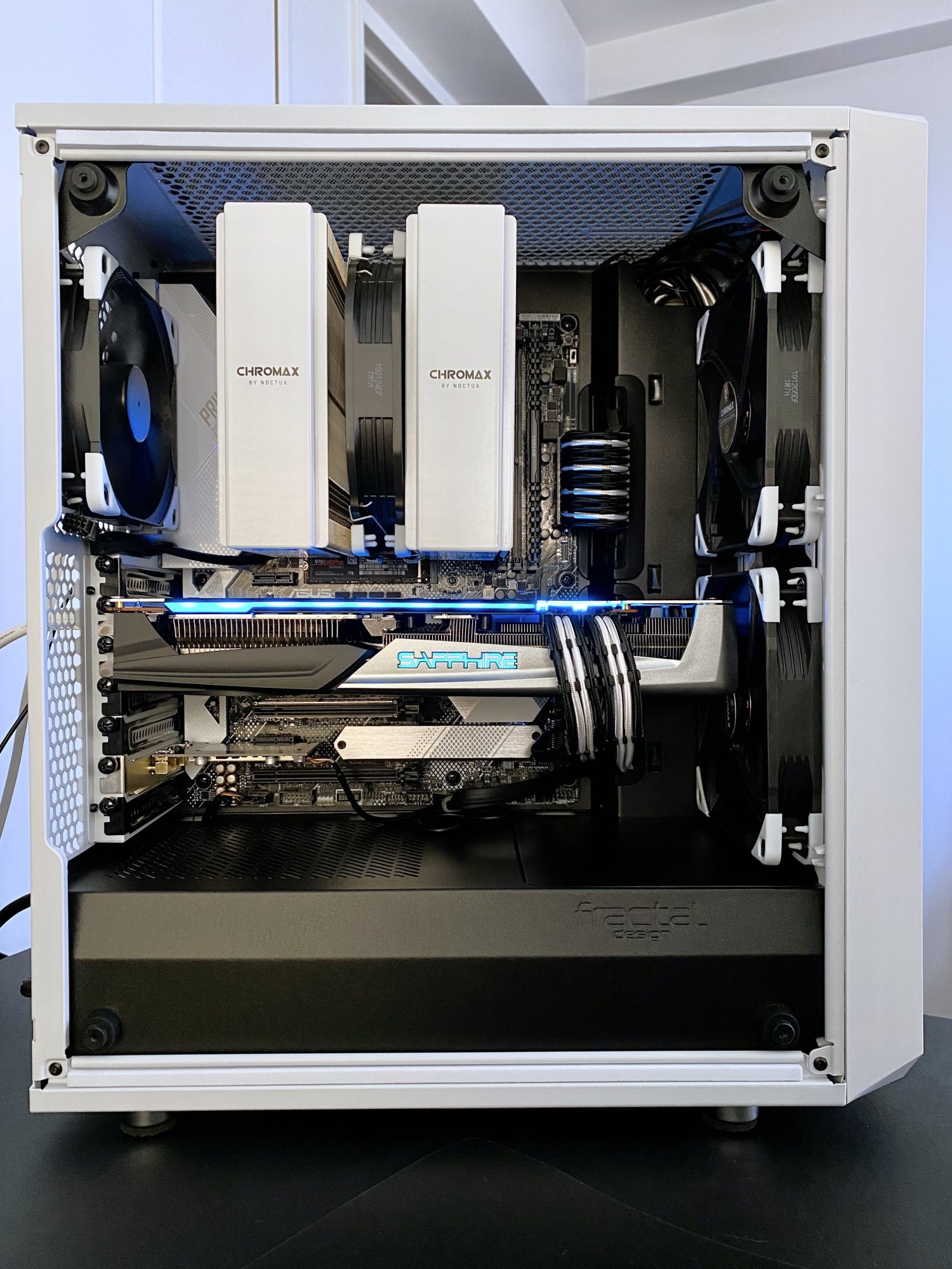

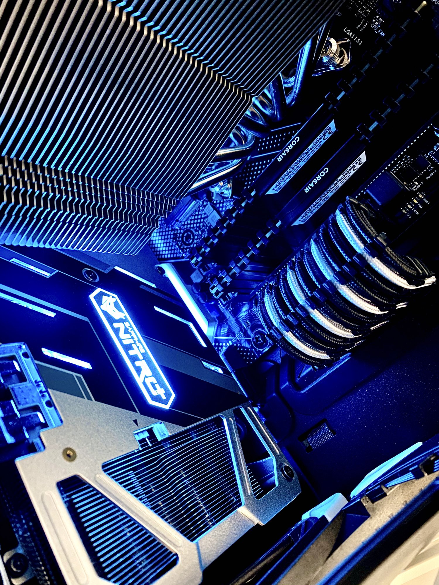

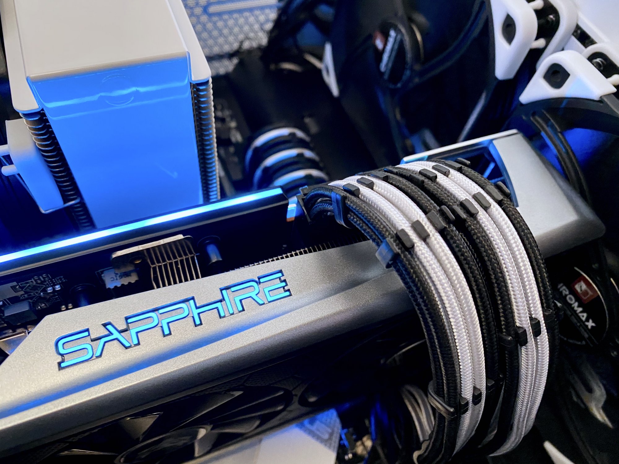

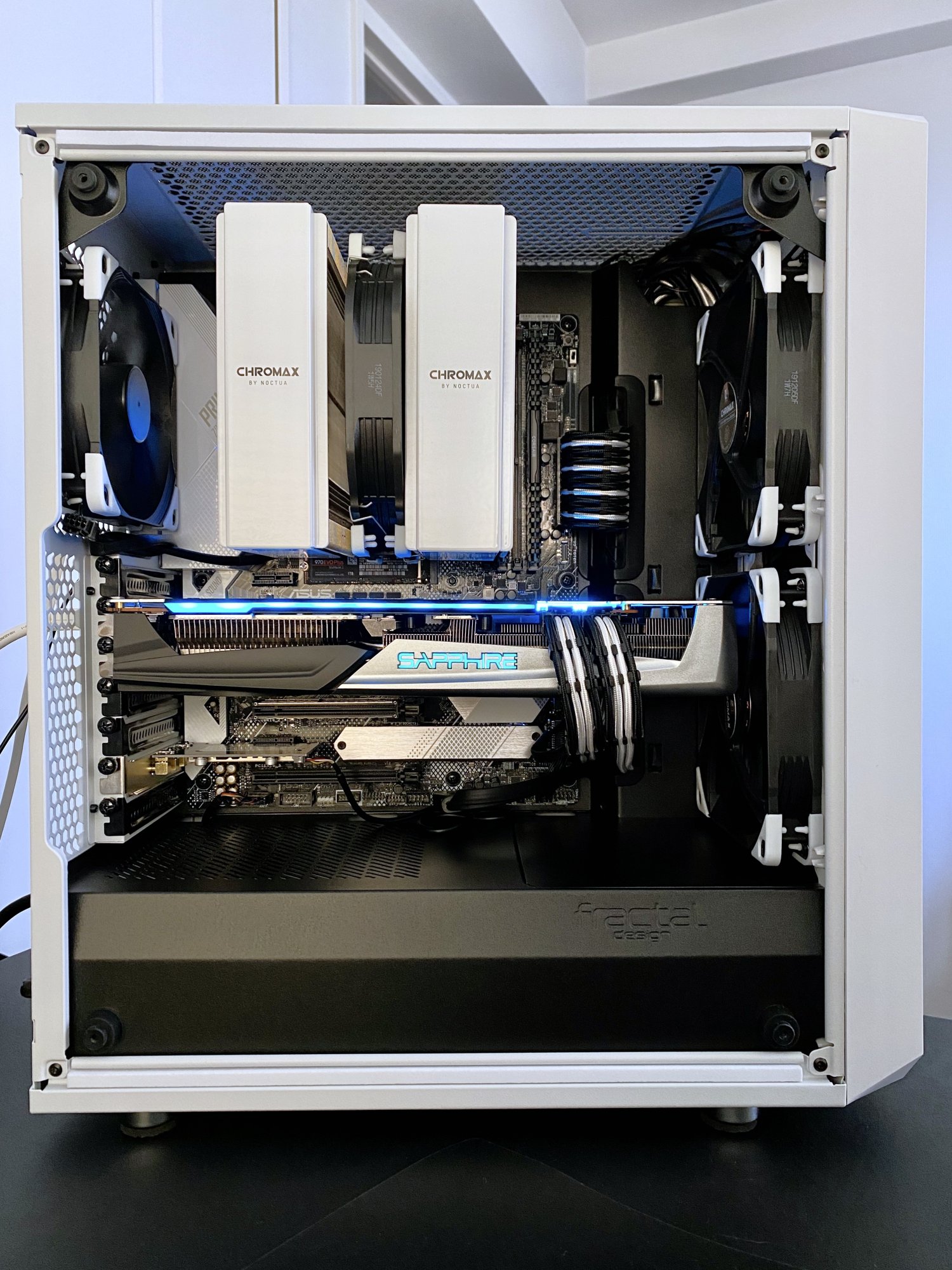

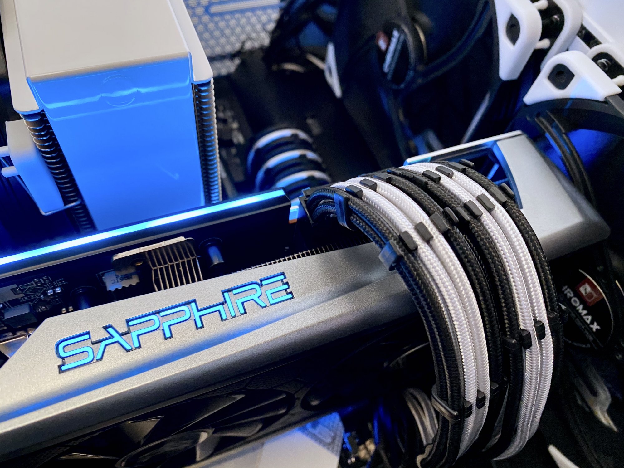

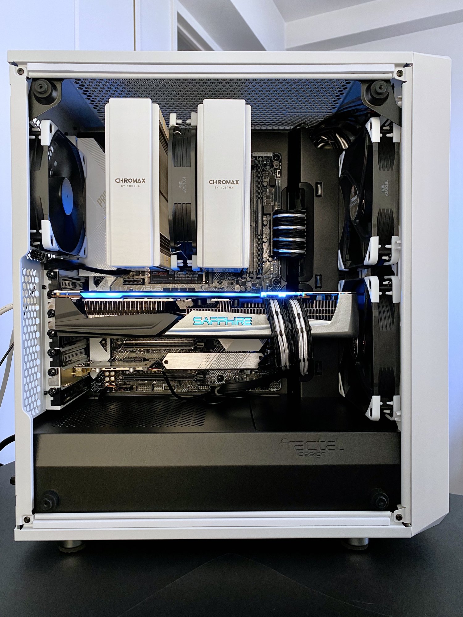

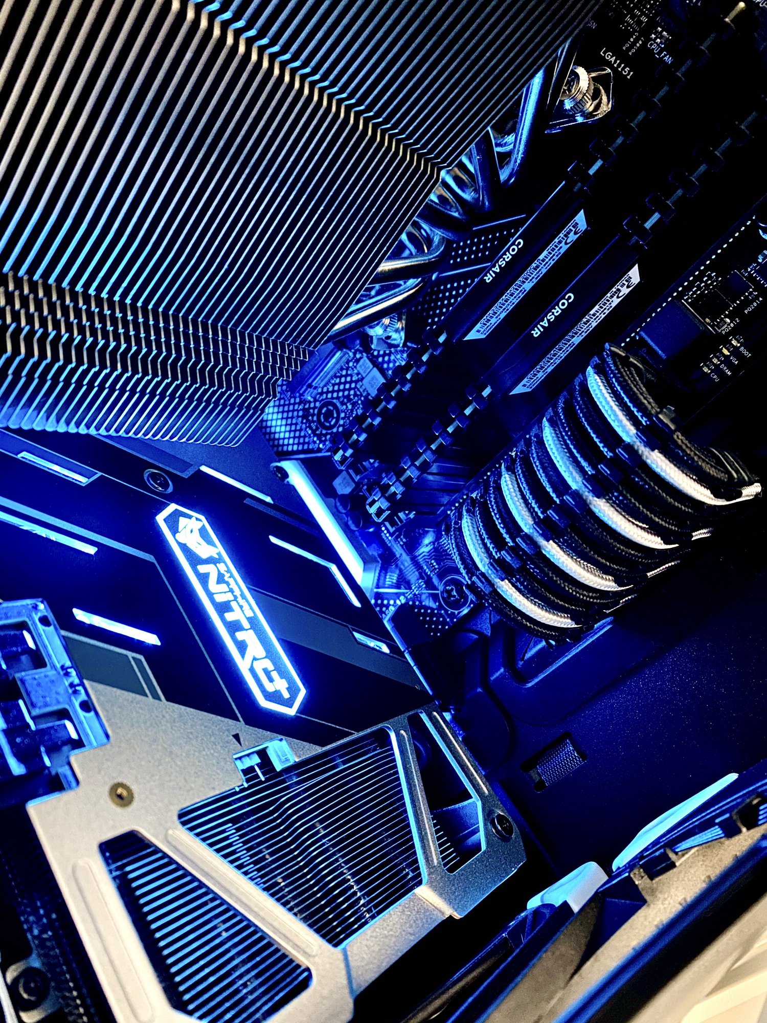

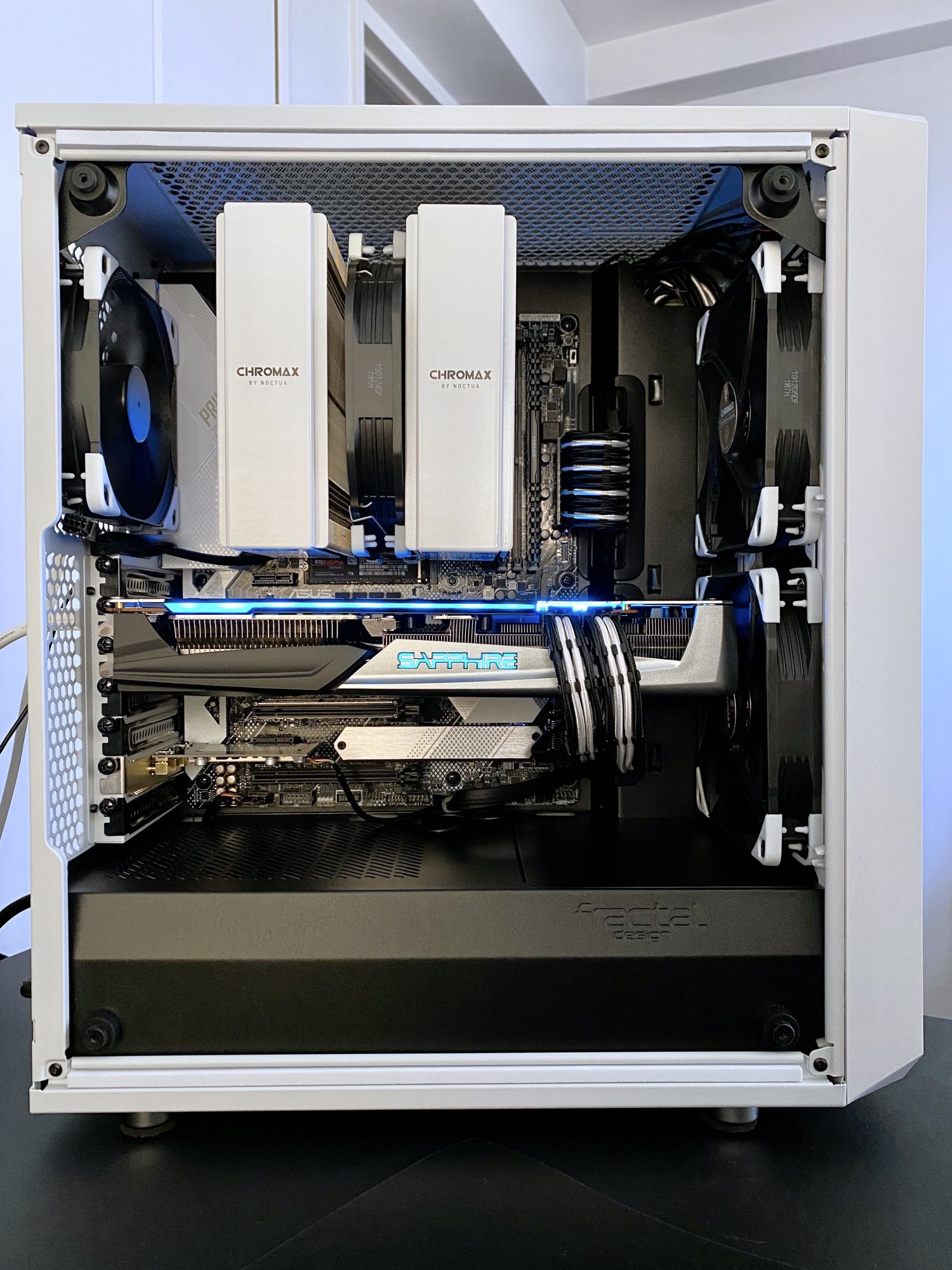

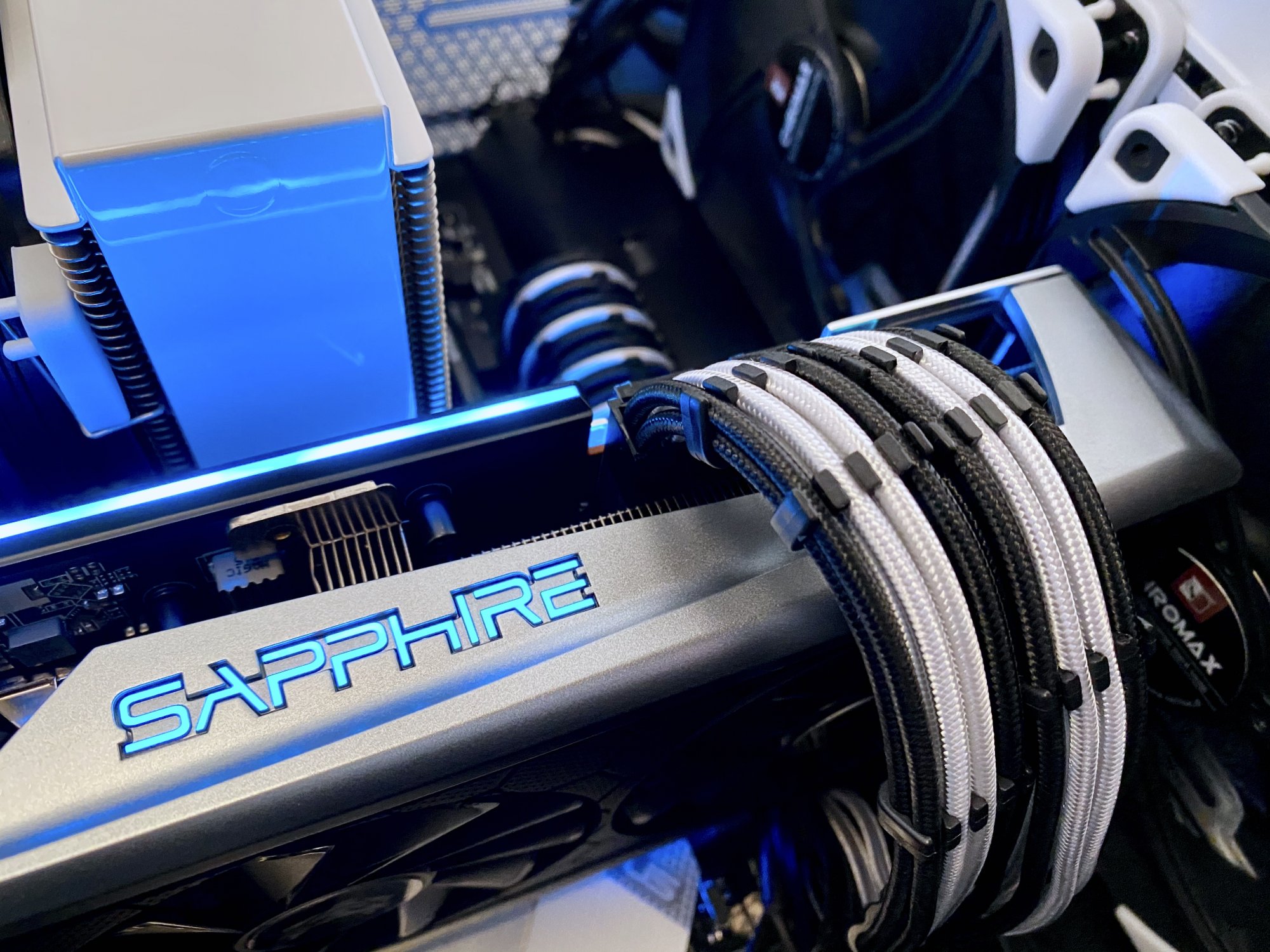

About a month ago I built my first Hackintosh in over thirteen years, to replace an aging maxed-out late-2012 iMac.
I started with Clover and 10.15.3, but have since moved to OpenCore on 10.15.4 - it has worked perfectly since day one. Also, it handles 1440p~4K games with ease, in Windows. And cost less than half what a comparable iMac Pro would have. SO, yay.
  • Asus Prime Z390
  • Core i7-9700k
  • 32GB Corsair DDR4-3200
  • 1TB Samsung 970 EVO Plus (x2)
  • Sapphire Nitro+ Radeon RX 5700 XT
  • Fenvi T919 (WiFi + Bluetooth)
  • Corsair rm750x
  • Noctua NH-D15s
  • Meshify C case (white)
  • assorted internal SSDs and SSHDs for backups, etc
And here's what it looks like:
My kids (10 and 12) helped put it all together, which was a lot of fun for them and scared the hell out of me. lol. But they did a great job. And at the end of the day, we have a great machine that we put together ourselves that runs Catalina far better than a lot of real Macs. 🙂

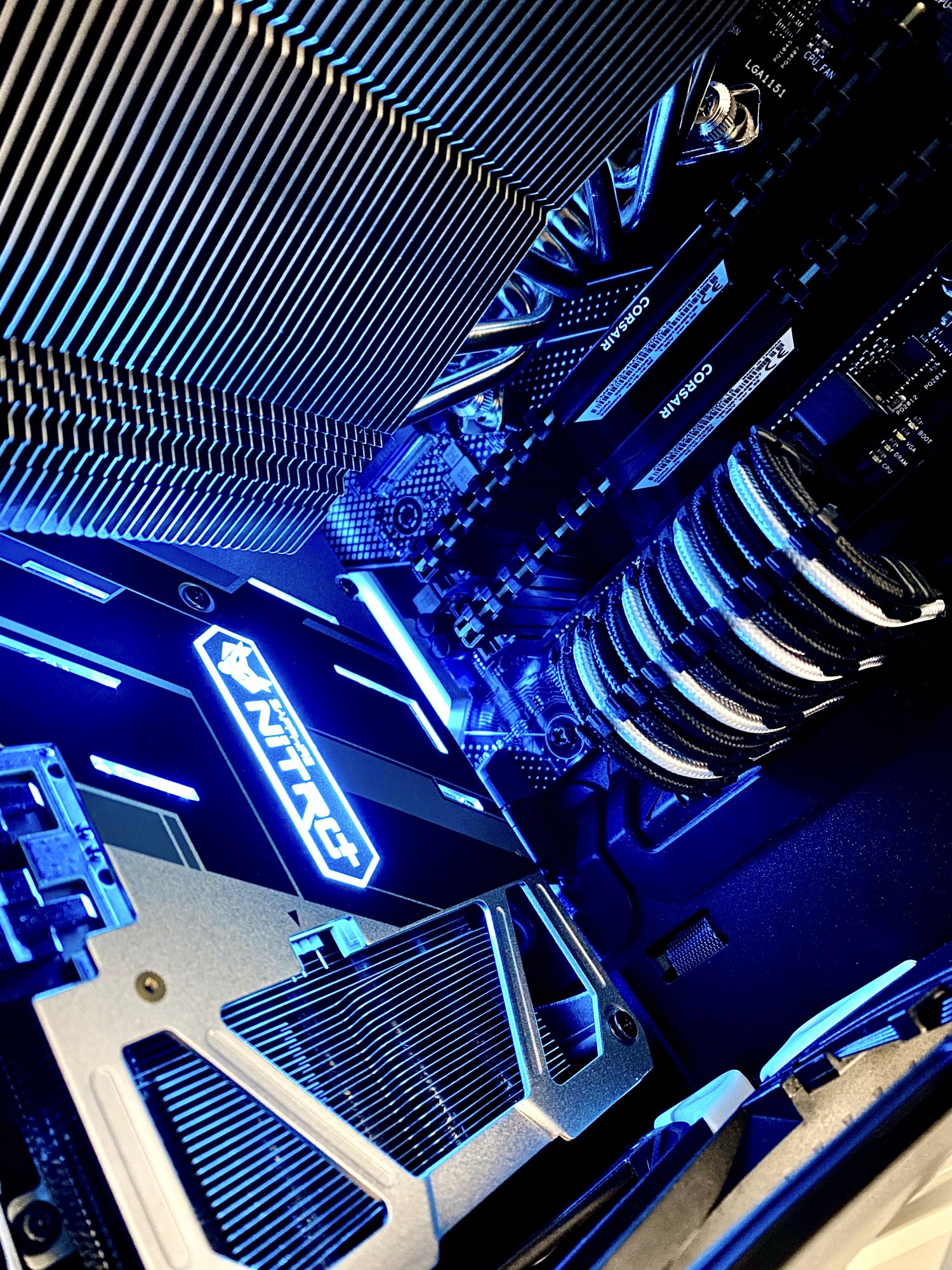

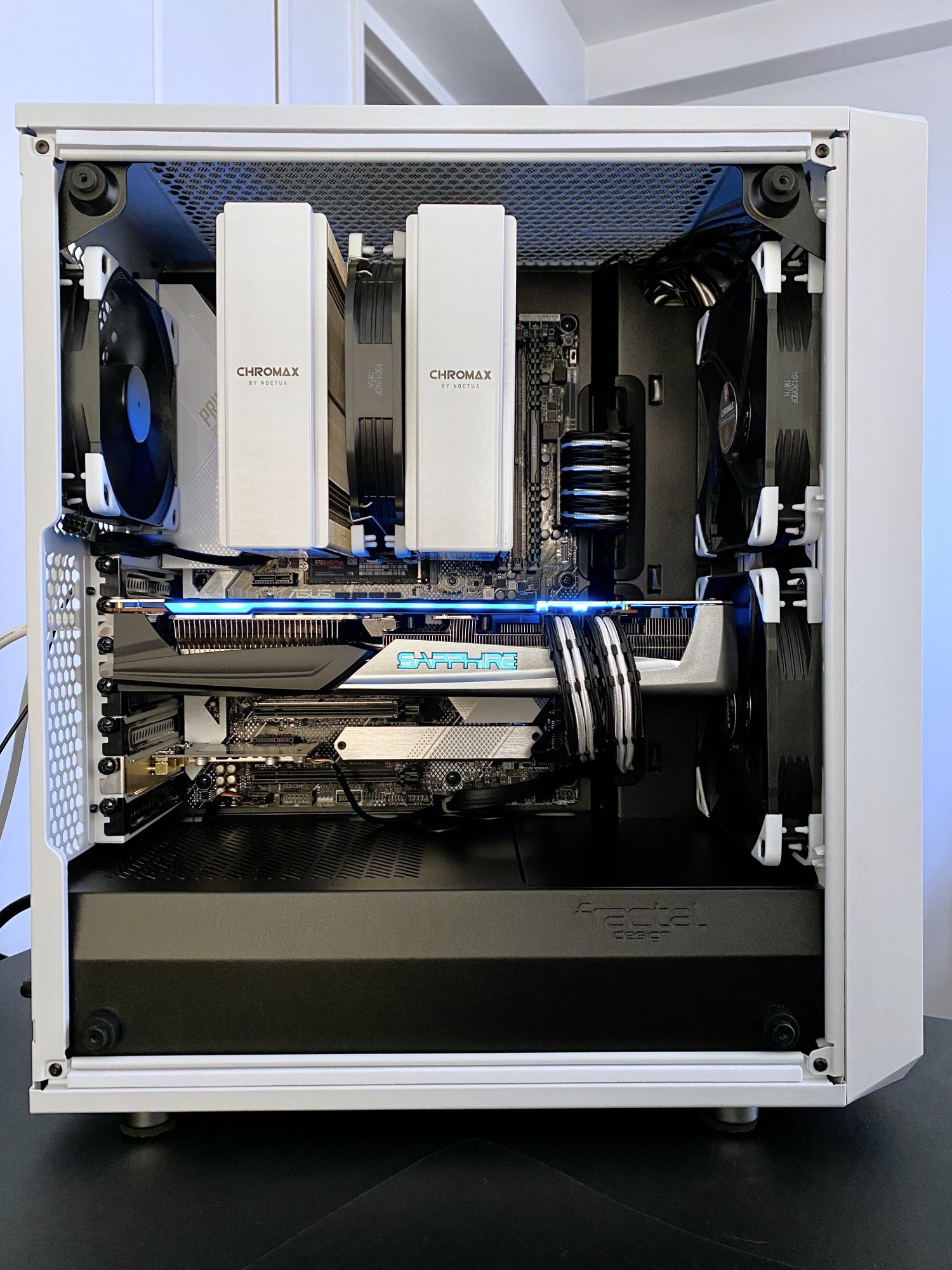

  • Asus Prime Z390
  • Core i7-9700k
  • Corsair rm750x
  • Noctua NH-D15s
That is beautiful.

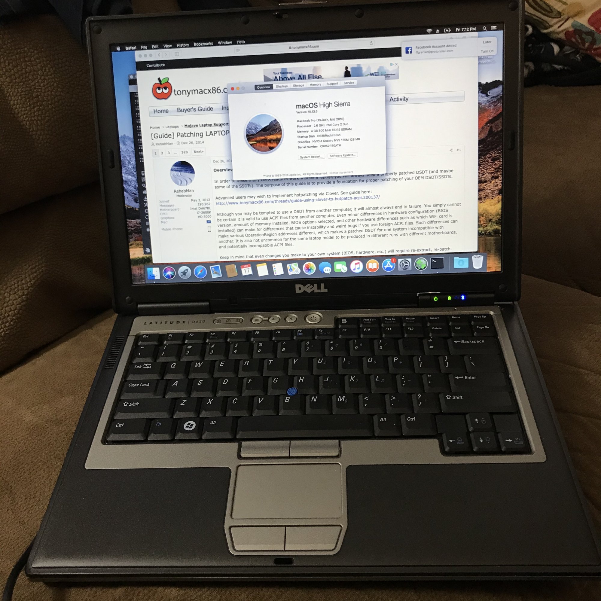

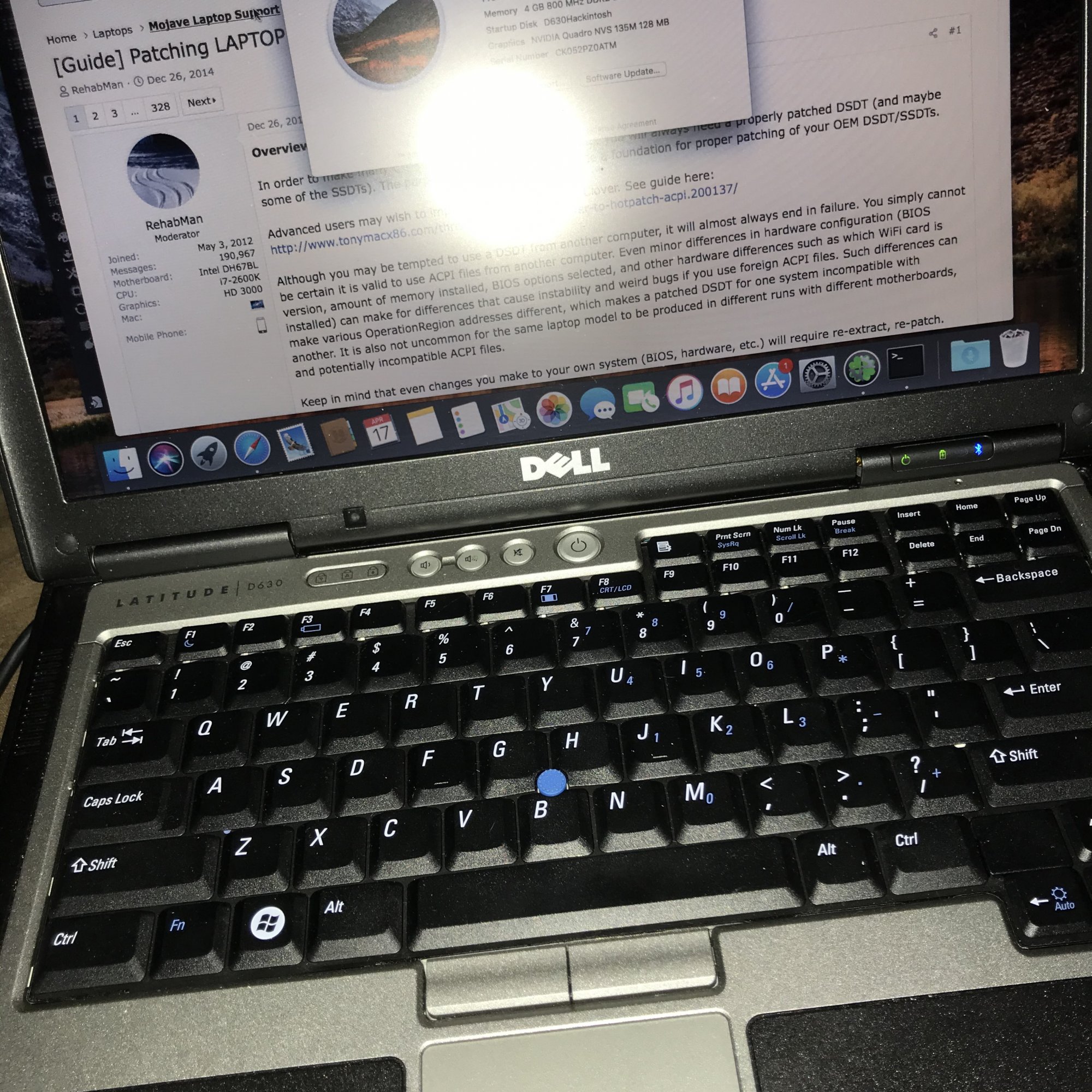

Practicing my Hackintosh skills. Finally found a use for this old girl.
Dell D630C w"upgraded" T9500 C2D @ 2.6ghz, 128gb SSD, 4 GB 800mhz DDR2RAM. This has the NVidia Quadro 135m OB graphics. I figured this would be a fun practice project while I wait for parts to come in for the Hackintoshiba. I haven't tested all the ports but USB's seem to work. Only real issue is the touchpad works...ish. The touchpad kext in there now is the better of what I tried so far for this ALPS touchpad, but no options in preferences. I can't be too picky with a 13-year-old machine. I will say my first 2 installations worked smoother but the 3rd finally got all the specifics right however, there is a choppiness to it even though I used supported and known working graphics.
Can't complain old but cool.
