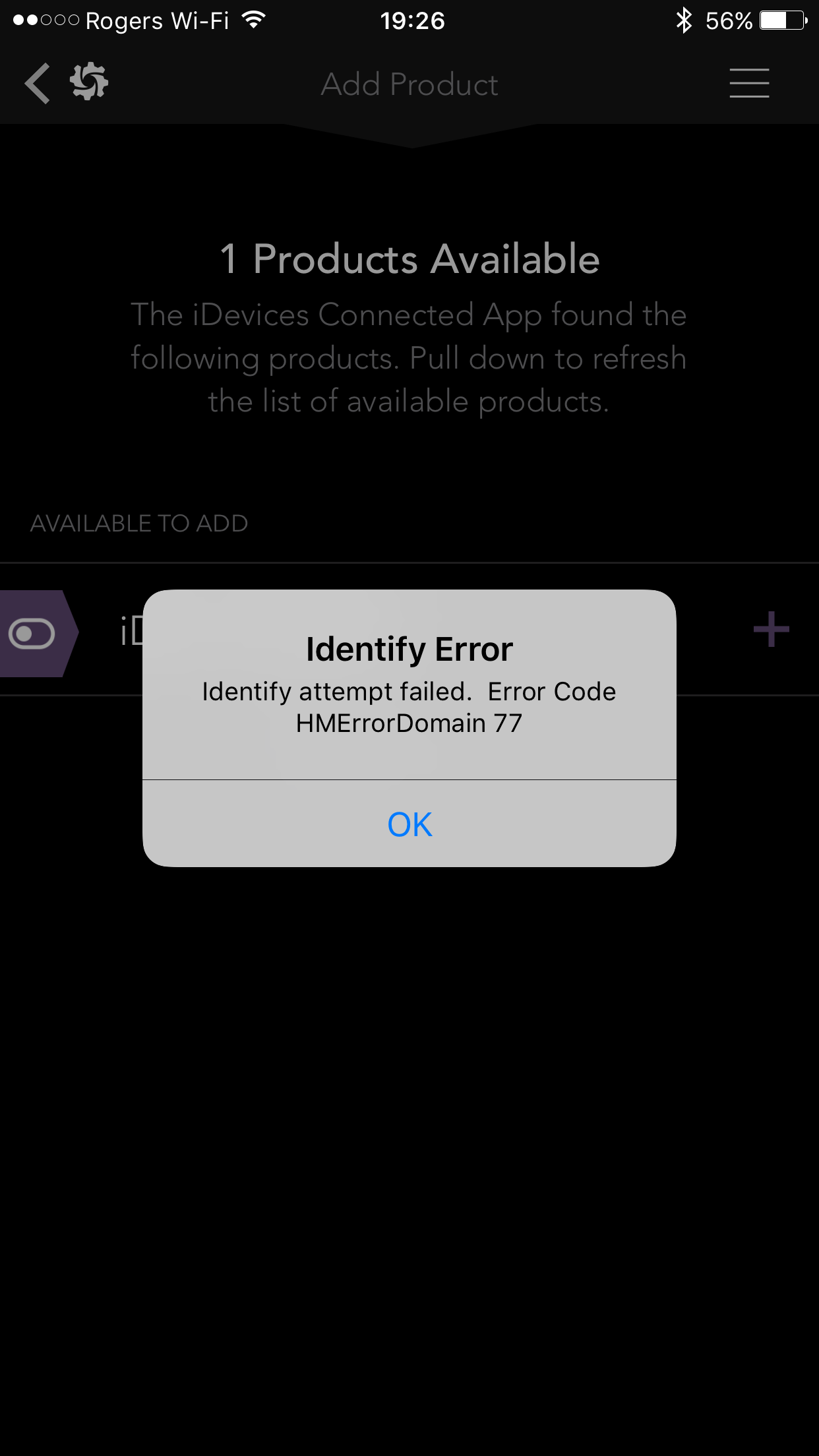

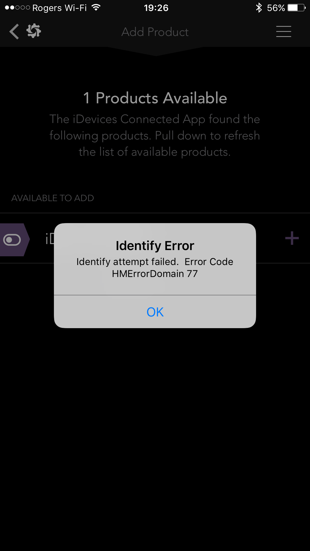

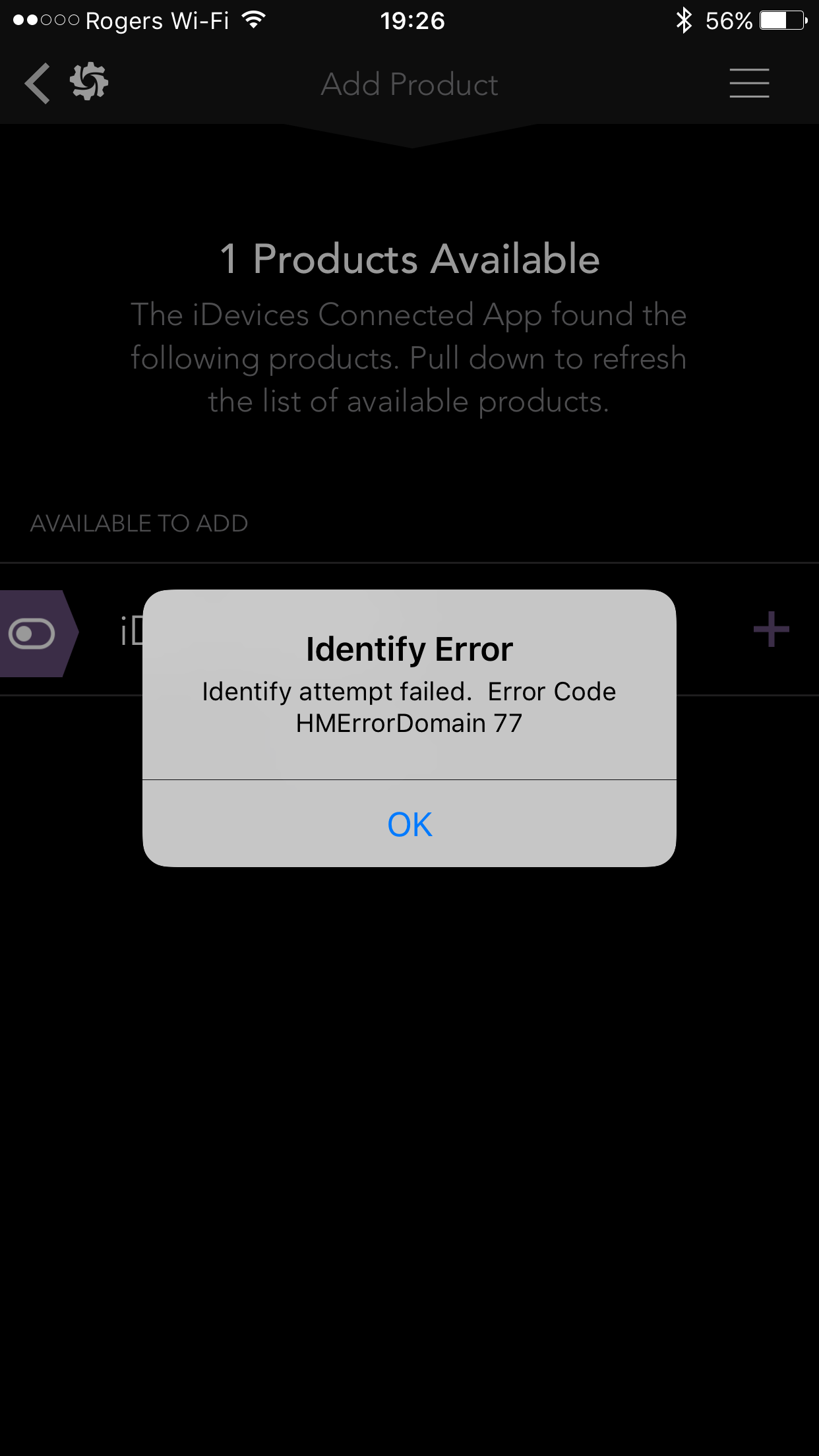

Tried to setup my iDevices switch since the beta 2 update and still no luck. I get the 77 error which relates to (in their guide) a "iCloud still in syncing process". Proposed resolution: Log out and then log back in the iCloud account...
