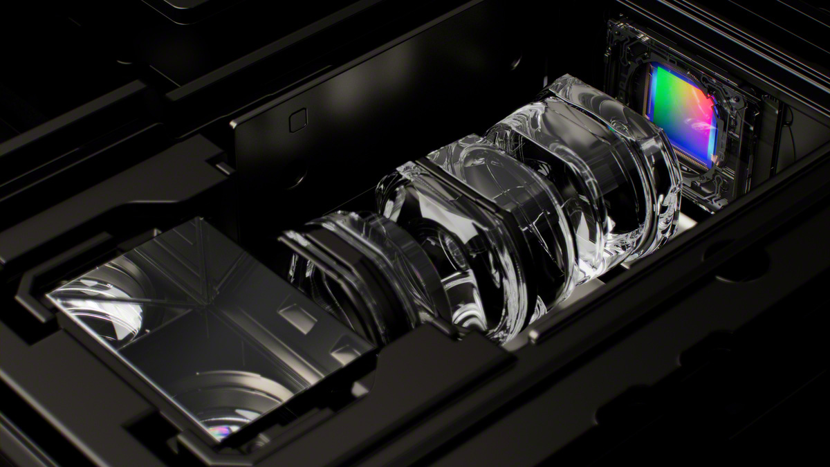

The S23 Ultra uses a 10MP, 1/3.52" sensor for its 10x periscope telephoto camera. Which gives it a focal length of 230mm in 35mm film equivalent.
It's not a progressive "zoom". But 10x is achieved optically.
As far as I understand Apple is doing the same, except it's 5x optical zoom. Equivalent of 120mm.
15 Pro Max has 3 cameras:
  • Ultrawide, optical 13mm
  • Wide, optical 24mm
  • Telephoto (periscope), optical 120mm
Transition between these lenses is achieved digitally, but each "stop" is optical. I thought this was common knowledge?

Funny thing is:
Even though this is a "true optical zoom", the reviews say that you actually loose quality when you zoom all the way. I'm sure this will improve over time, but currently it doesn't seem to be worth it.
So even though OP would consider this to not be "a scam", the end-result seems to be worse.
Here is the deal. It's great that Sony has developed the continuous zoom-capable lens, and we have our fingers crossed for those making an impact and being upgraded in the future. Stepless zoom is the way for sure. But the difference in the FoV between the 3.5x and the 5.2x zoom is small, and, in our opinion, it is not worth it shooting at 5.2x because of the worsened quality. You can do just fine with the default 3.5x 12MP photo and crop if needed. We don't want to diminish Sony's work here, it is commendable; it's just a bit pointless at these zoom levels for now. But we hope they make it better and offer us continuous zoom between 3x and 10x, for example.
"Even worse news comes from the 3.5-5.2x optical zoom lens, which is the same hardware as found in the 1 IV and despite claims that the software has been tweaked to improve performance is still disappointingly soft and smudgy. The 85mm end of the lens produces the best results, but the 125mm is best avoided unless you’re only using images at very small sizes and don’t intend to scrutinise them much, if at all."
Tech is not quite ready for primetime.
